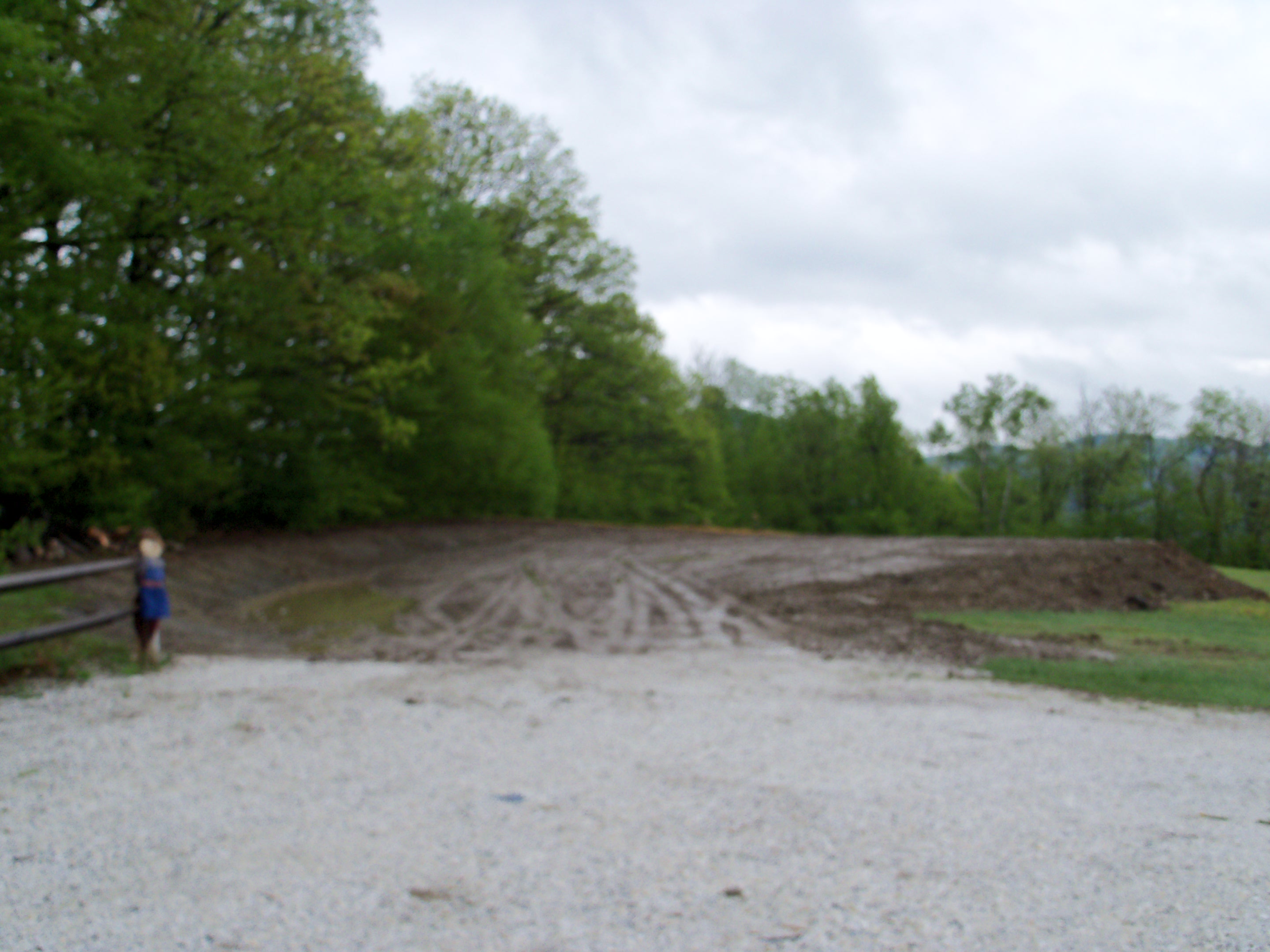

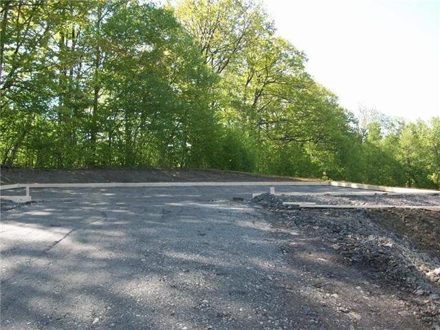

Be careful thinking a dozer compacts well. I have a Case 550 (not much bigger than that JD450). It only puts about 5.5 lbs/square inch of ground pressure--that is the same as a normal walking human.
It would be worth going over the area with at least a vibratory roller with the area moist but not soaked--the bigger the roller the better. A jumping kack would also work but is very tiring over a large area. You can rent one of the larger rollers from the bigger equipment rental places (Volvo, Cat, etc) but sometimes hiring it done is about the same $$. I would just hate to have you build a great new building and have one corner/side settle on you. If you water it regulary for a while it will settle faster also but I think compacting is still recommended. Good luck
Peter
/ My Barn..... Finally !!!
#42
Good Evenin Guys,
I thank all of you guys that have concerns about the compaction issue !!!
Im also concerned, and have a call into my contractor to get a better idea of whats being done on that front ! I did question him once on it, and he stated that he would be dumping the gravel on the barn floor base and then compacting.
At this time Im not sure what type of compactor he will be using, but will hopefully find out more in the near future.
My problem right now is that Im in Ct, and all the work is being done 176 miles from here, so its a bit difficult, other than asking my Uncle Dave who is just up the road, or putting calls into my contractor !
What I do know is that he is very reputable and done many such jobs as this, so that fact alone makes me feel a bit better...
As the pad is staked out, and forms erected, and stone is delivered I will updating with pics and commentary...
Thanks all again ! :)

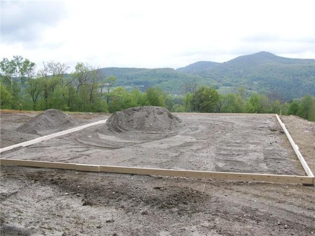

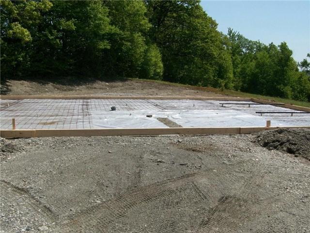

#43

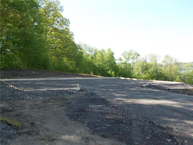

Good Afternoon Guys,
Well last week I had a call into my contractor on the compaction issues and he assured me that he was addressing my concerns, and that he was spreading gravel with the tractor and using a large vibratory compactor, not only on the inside of the barn footprint put a few feet out in all directions !
It made me feel a whole bunch better about this whole project ! :)
Here are some updated shots from this past week and some of his progress !

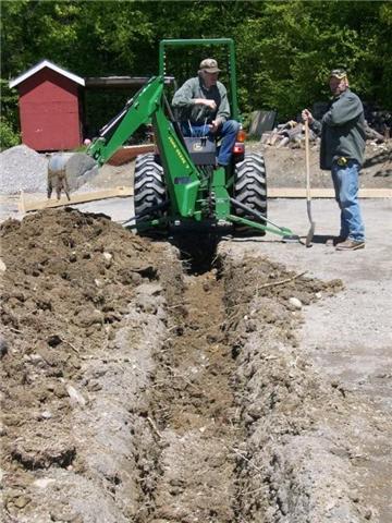

#45
My neighbor Neil was good enough to come over today and dig the trench for my floor drain, with his little JD ! :)
Thanks Neil, nice to have good neighbors, and took care of my puddle problem ! ;)

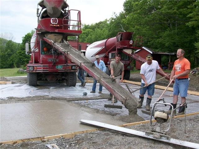

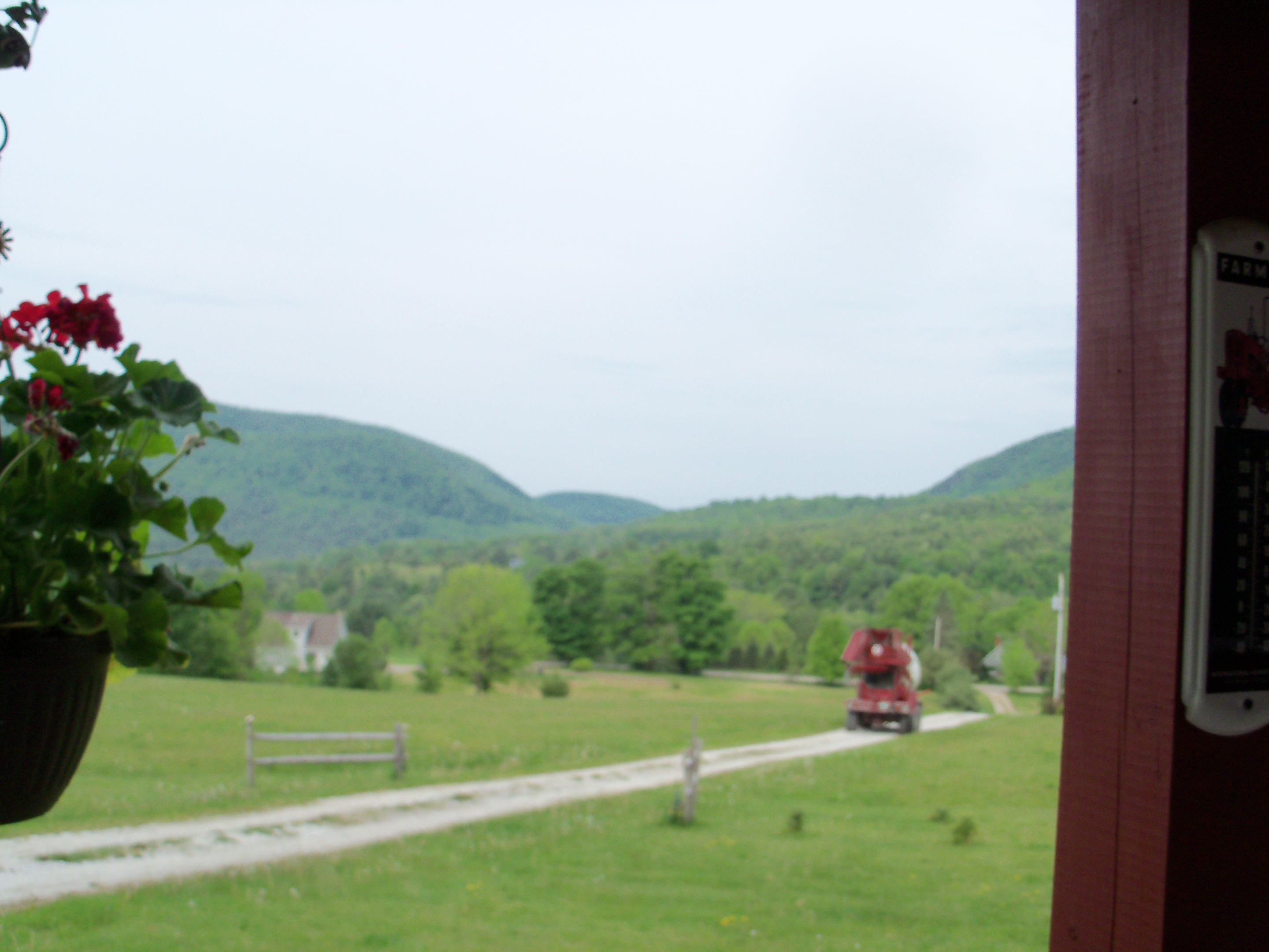

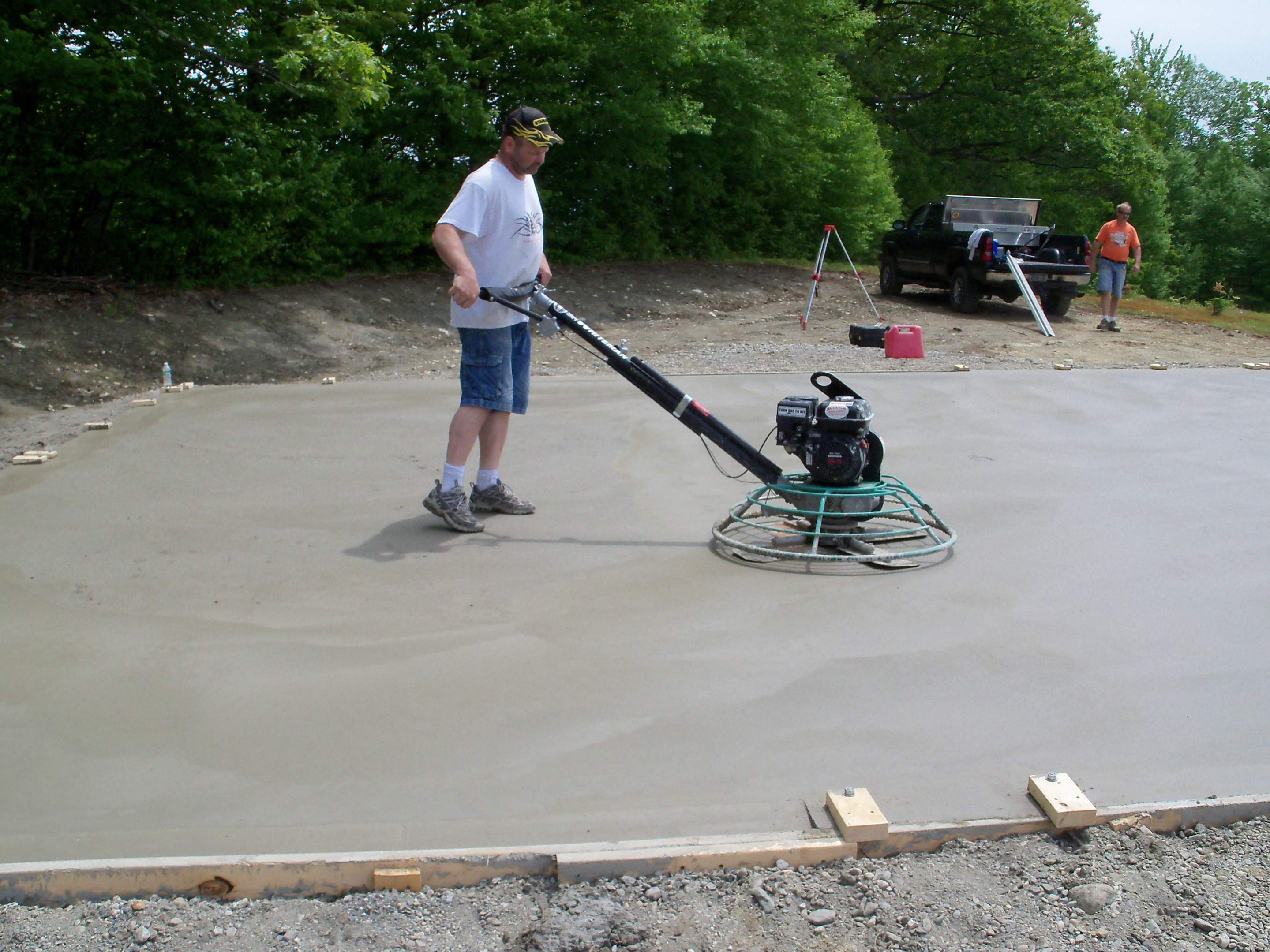

#46
Good Evenin Guys,
Well here is this weekends work...
Poured the concrete yesterday, all went well other than all the trucks showing up about the same time ! :confused2:
We used the power screte and the power trowel to make work a bit easier...
I did the J-Bolts and helped with assorted other stuff ! :)
Im quite happy with the pad, and this morning we cut the floor with the concrete saw into 9 sections about 3/4" deep...
Of course the beer tastes better after all the work is done ! :licking:
/ My Barn..... Finally !!! #47
Looks good. It's always nice when the concrete is complete, now walls can go up and it will really start taking shape.
/ My Barn..... Finally !!! #48
Scotty,
Congrats on your slab. Looks like a heck of a basketball court!!!!
I'm enjoying your progress and seeing your dream turn into reality. It's been a long time coming, and you have done a heck of a job in making it happen.
Eddie

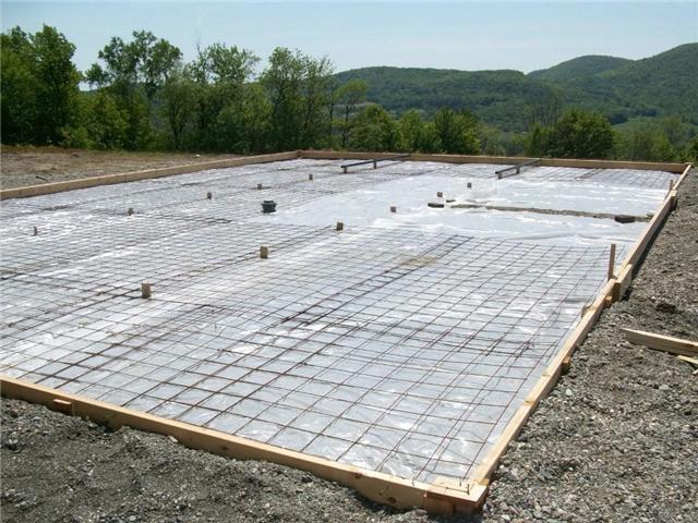

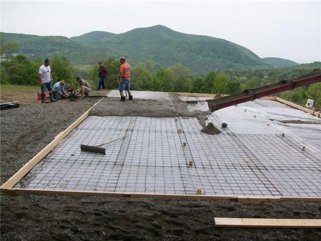

#49
Good Afternoon Bill and Eddie,
Yes thanks guys !
We will be starting to frame up the long wall closest to the driveway this weekend...
Here are a couple of more concrete pouring shots ! :)
Do you have any idea how long it took me to save for this project ? ;):)
/ My Barn..... Finally !!! #50
Looks good. How thick is it? Looks like maybe 6"? I'm building a garage but doing most of the work by myself. It's going to be 28 by 32 two floor gambriel with a steel I-beam down the middle so the first floor will unobstructed (no posts). I'm going with an Alaskin slab with the outside edges being about 18" think with a 5"ish center slab (6" plus where the two post lift is going). I've got the spot leveled and the 3/4" stone down to improve drainage under the slab down but doing by myself it's slow going with this weather. I'm kind of jealous on how fast yours is going.
#51
Good Evenin Al,
Yes its 6" plus and about 12" on the outer walls. I went with the 4000 lb mix with the fine stone, and yes we used the gravel and crushed shale for the base, and compacted well.
Your building sounds good, and of course no posts make life much easier! :)
We just felt that any heavy equipment, tractors etc, that the thicker floor was the way to go ! Dropping the bucket or the concrete barrel on the 3 pt hitch, lots of weight there...
Anyways Al, good luck with your building !

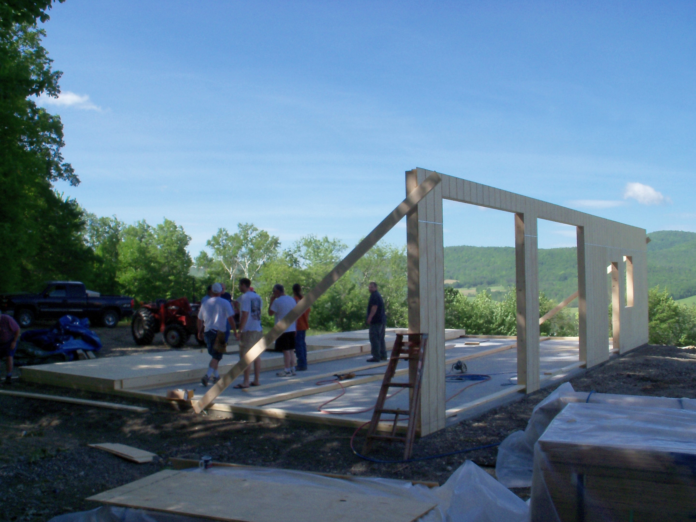

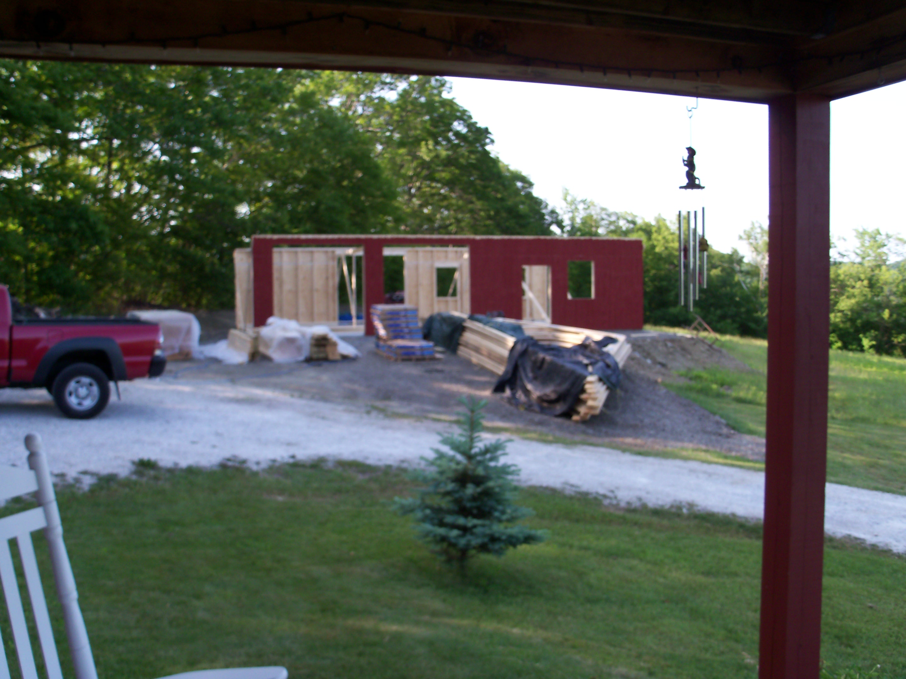

#53
Looks like things are coming along well with your dream! I have a tiny shop that I built over 20 years ago, and it has been great to have it. I don't know if you will ever have kids around, but one thing I did was to wire the outlets that were going to be used for power tools to a separate wall switch so the power to all of them could be turned off easily. I leave the light on my drill press on, and that tells me if there is power to the other machines too...... Of course my machines are small, and that makes it easier to do that.
Good Evenin Chuck,
Yes thats an excellent suggestion... I dont have any small kids around but Im sure at some point that we may find a grandchild or two ...;)
I have the light on my drill press also, so that would work out well !

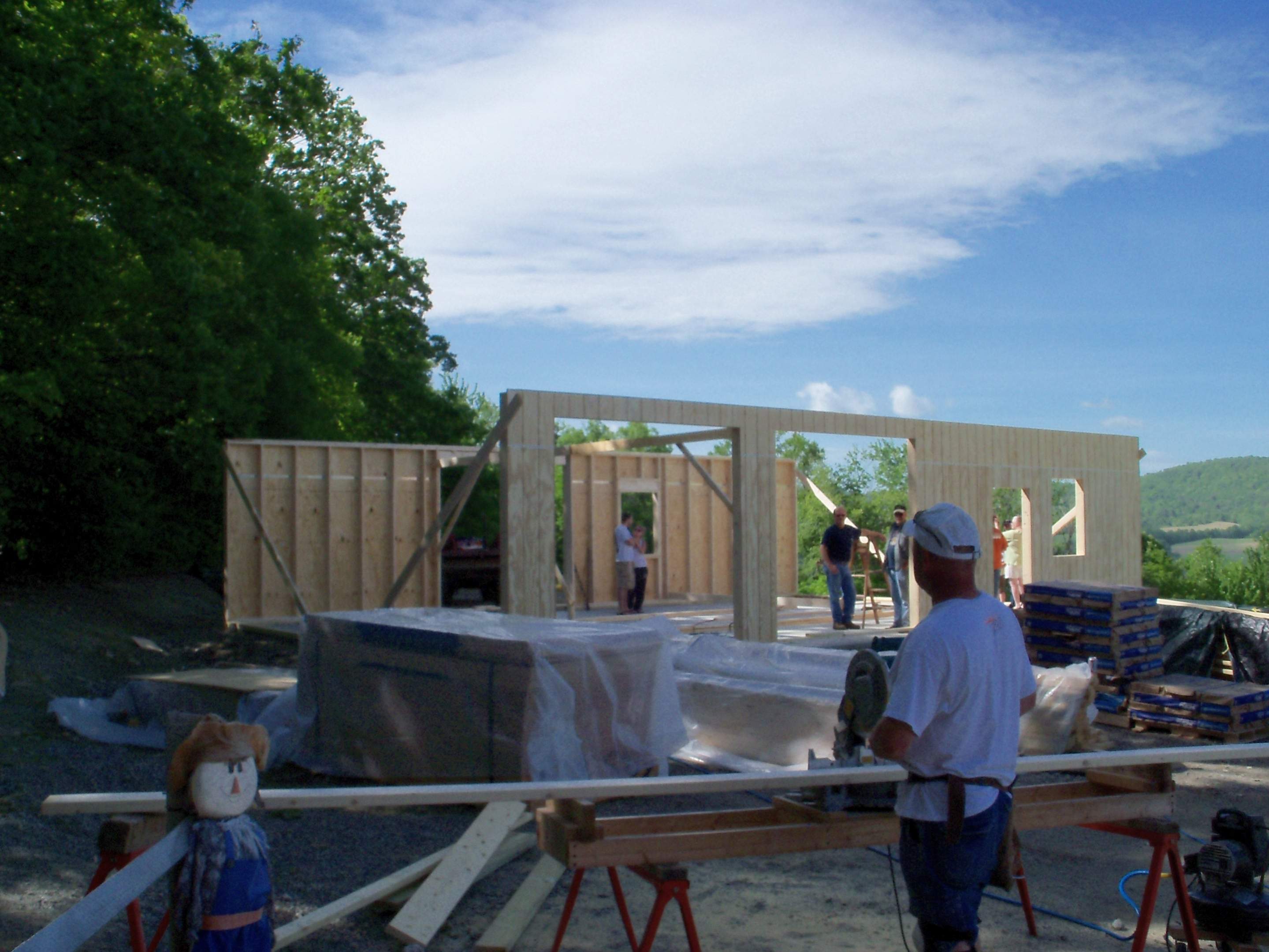

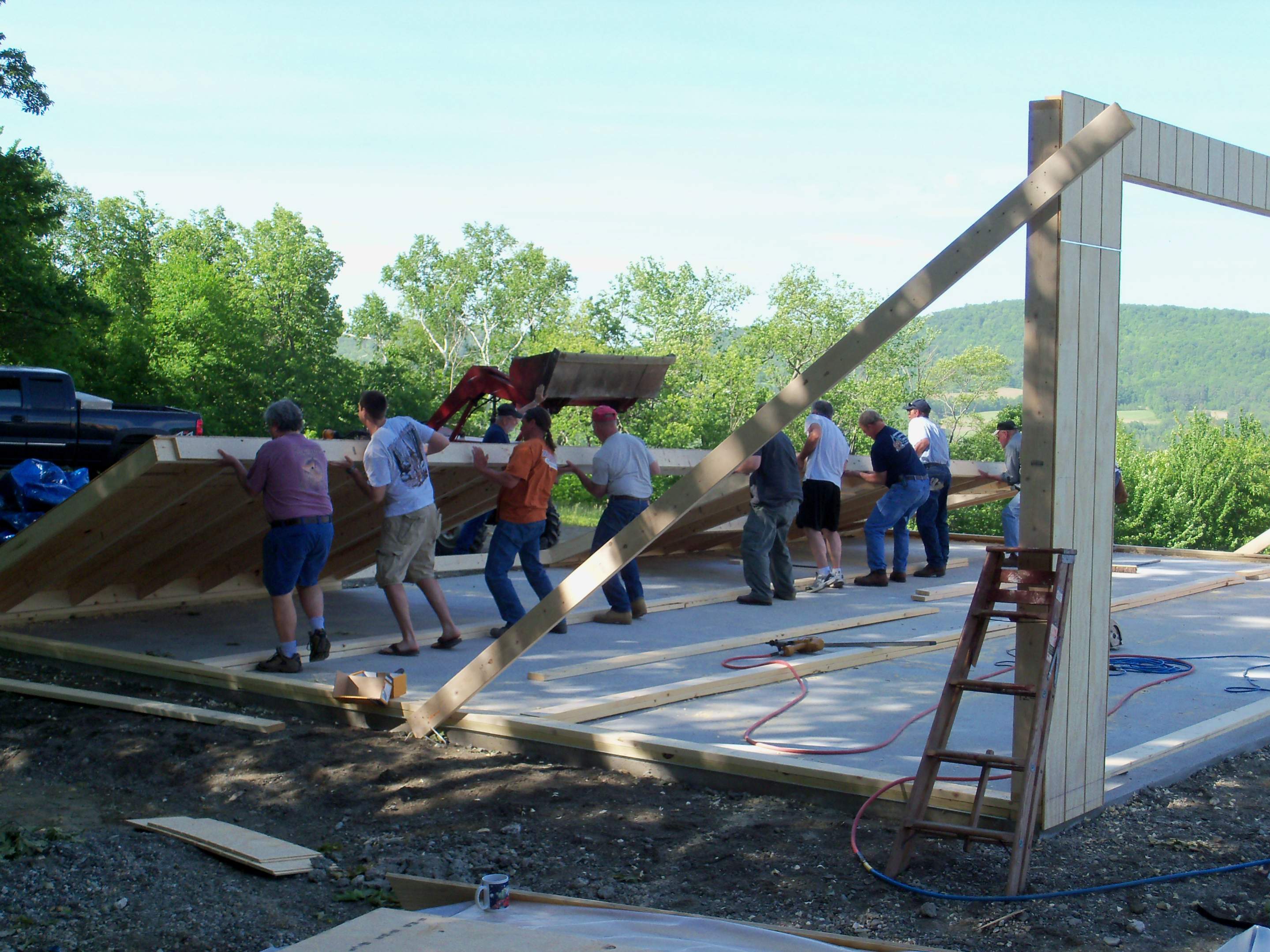

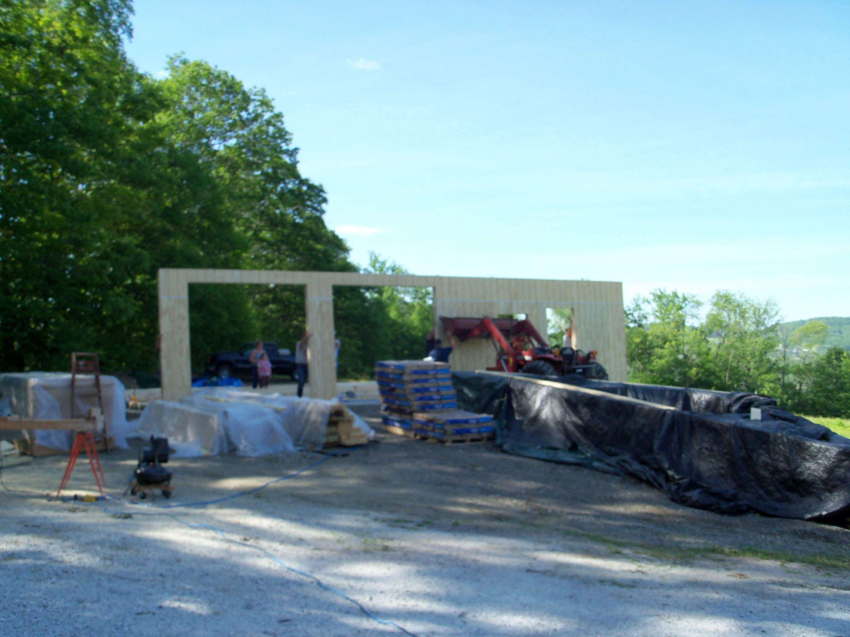

Here are some more pics from this past weekend, we rounded up a bunch of guys and got the 42' walls up, I didnt think we had that many guys in the area ! :confused:
So far so good !
My friend Neil also stopped by with the command car that he just restored ! :)
BTW those boys can drink some beer, they cleaned me out at 10 am ! :confused:
/ My Barn..... Finally !!! #54
Good to see your walls up Scotty. It was a great weekend for drinking - er, I mean building :) I was hoping you could take advantage of the weather and I see you did.
Dave.

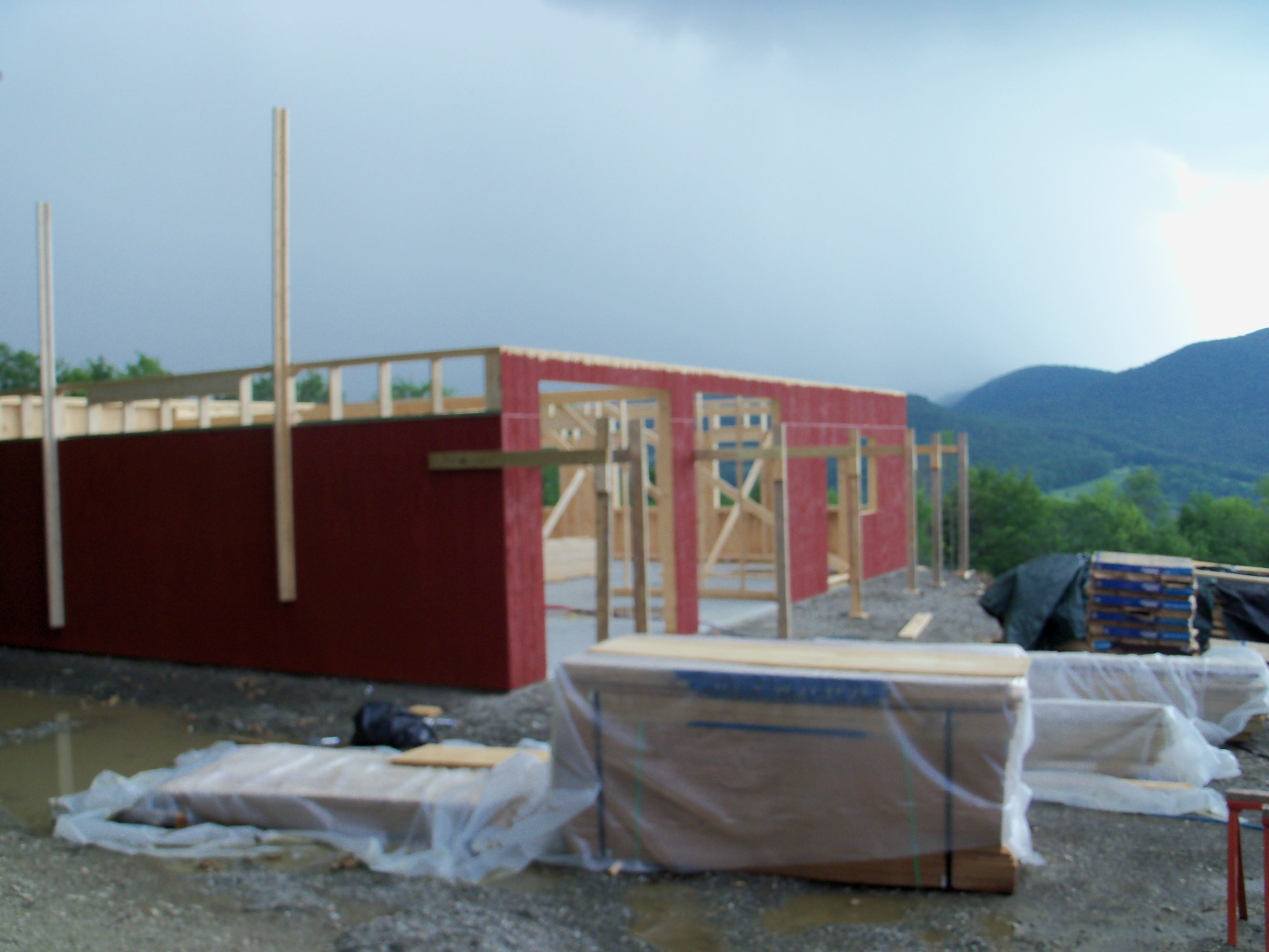

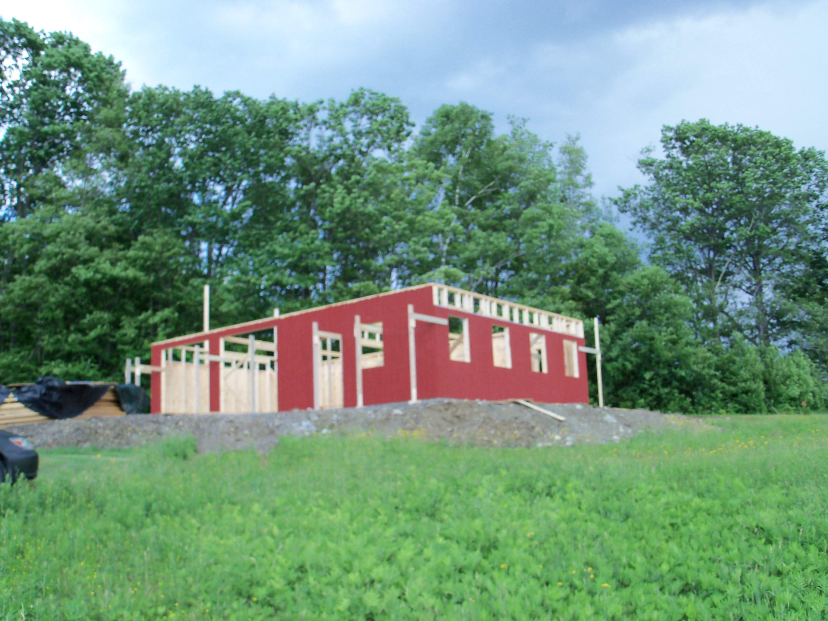

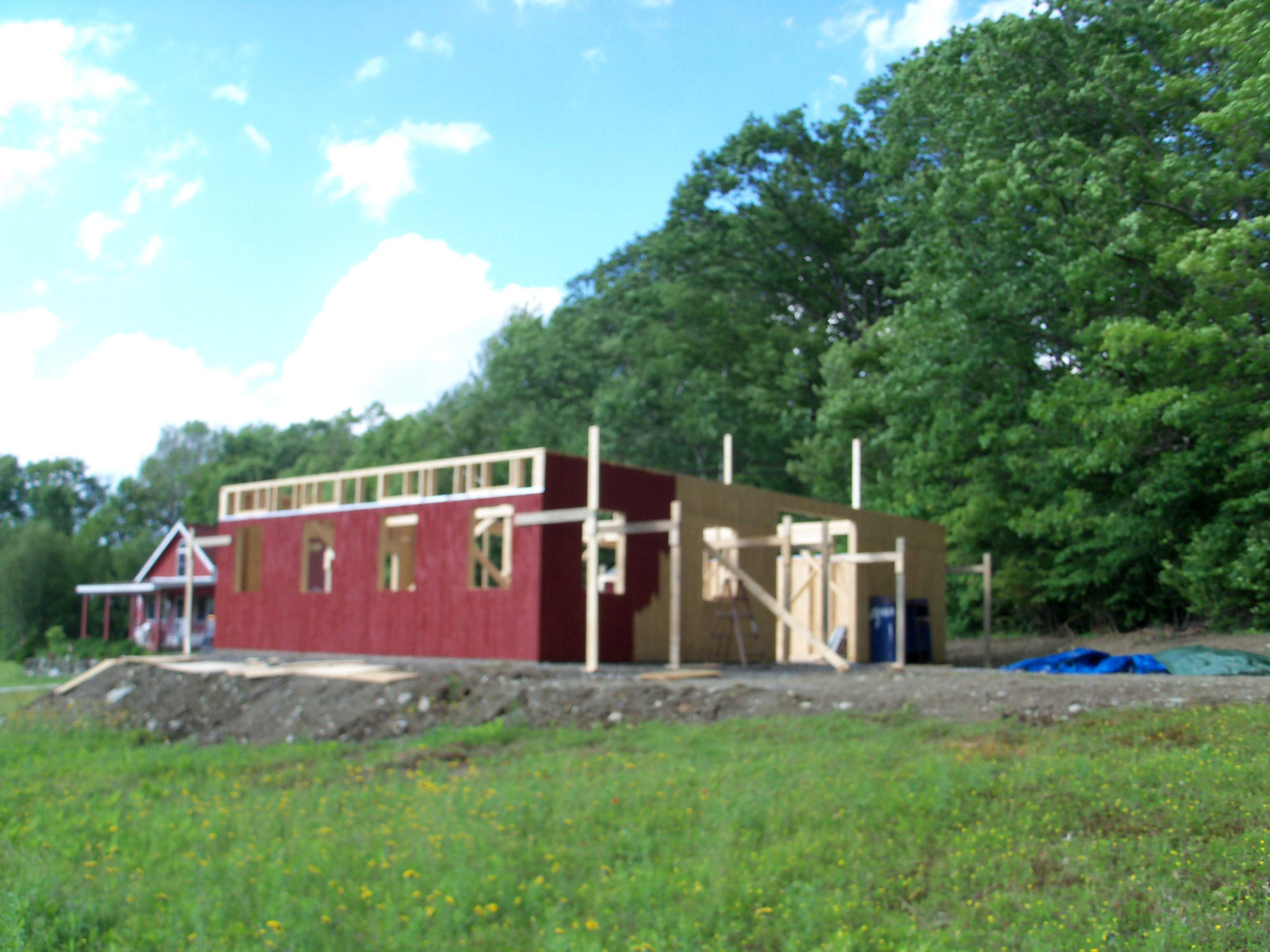

Good Evenin Dave,
Yep a bunch more of that beer consumption again...:)
All four walls up now, scaffolding being built to install the trusses, that should hopefully happen this tuesday ! :)
And of course there is me doing all that staining, wearing out my right arm and hand and other things... ;):)
Some up to date pics for the guys ! :)
Oh yes and a bonus shot... the storm that chased us up to Uncle Daves for more beer and some food late saturday afternoon ... :)
