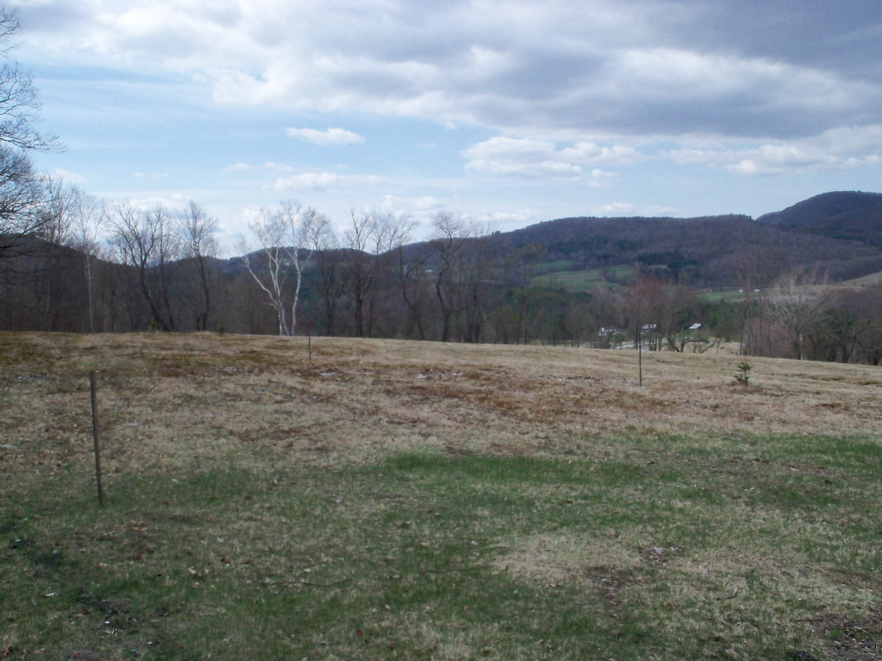

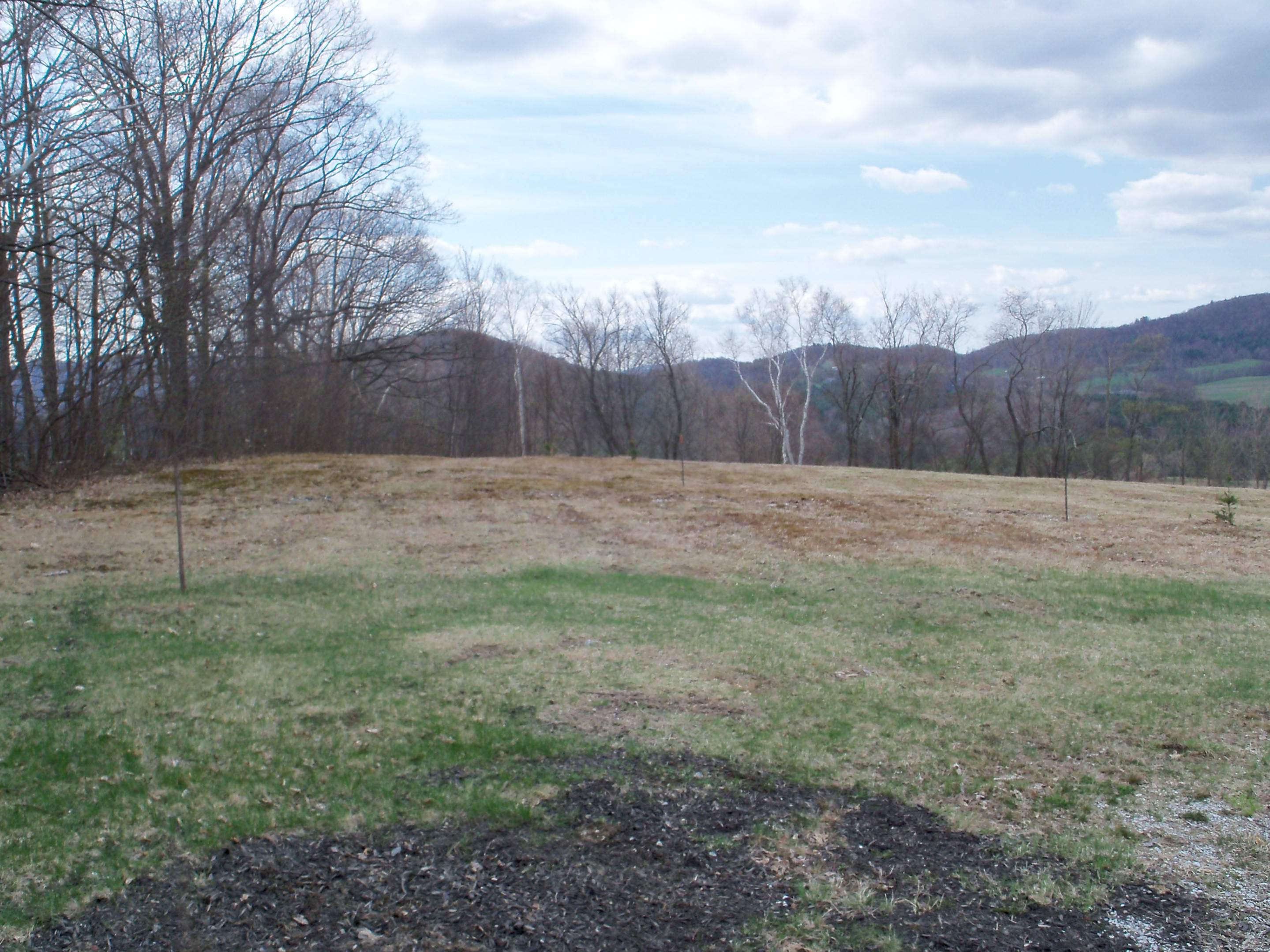

Good Evenin Guys,
I have been dreaming about this day for the past few years ! Finally the day is fast approaching, instead of reading about other projects, many of them my friends on TBN, its finally my turn ! :)
Here is what I will be building, yes I know it should be bigger and have this that and the other thing in it, but this is what my pocket book can bear ! ;)
It will be a 28 x 42 ft building. It will sit on a concrete slab, alaskan slab, 1 1/2 ft around the perimeter, and a full 6 " thick floor. The walls will be 10 ft high and 2x6 construction. I will have 3, 9 ft by 9ft doors with one drive through bay. The drive through bay will have a floor drain. So along the 42 ft wall facing my driveway, I will have 2 - 9ft doors. The remaining part of that wall willhave an 3 ft entry door and a 3 ft window. I at some point will partition the end of the building to accomodate my wood shop, which will be about 19 x 28 ft. The end of the building which will overlook the mountains across my field will have 4 windows spaced evenly across that wall.
I will be using trusses with a 1 ft over hang all around, the 8 x 12 pitch truss would give me a 10 ft wide room the length of the building with a 7 ft ceiling, although I may spend a few more bucks for the 9 x 12 pitch trusses and gain 2 ft in width and another 10 " in headroom...
On the backside of the building on the shop end I will have another window. and of course I will have the drive through bay door...
All the doors will have windows in the fourth panel up I believe...
Im going to go with and exterior staircase on the left side of the building, 4 ft wide with a landing up top to avoid using up any interior space. Both that door and the entry door into the shop will be glasson top for light and to see whats going on outside... ;)
Concrete wise we are looking at about 20 yds, and one of my neighbors has promised me a very competative rate... will see...
The Room upstairs will also have two large windows that overlook the mountains...
Electrical and insulation will probablly have to wait until next year...
We are up to about 19 K in materials and it looks like labor will be running about 15 K so Im hoping the project falls somewhere in the 34 to 35 K range...:licking:
I have included some site pics, thats all I will be posting for photos for the next 3 weeks or so, until we get the bulldozer up their to level things out, thats about it for now ! :)
BTW one bonus shot of Kathleen having a glass of wine looking out into the hills ! ;)

i agree dont eat up space in side how ever have you thought about a hole on end so you could hoist things up from the finished space.
and sounds like a great project
/ My Barn..... Finally !!! #4
Also, with a view like you have, I would have to build a small deck off of one end of the 2nd floor. Doesn't have to be any more than a 10ftx10ft deck. That would be a great place to sit and sip on some more wine!!:thumbsup:
/ My Barn..... Finally !!! #5
Glad to hear you are getting your shop/garage. Sounds like a nice building with good uses. Nice view you have across to the hills.
I thought of two things -
If you do staining and finishing in the wood shop, you might want to frame in an exhaust fan opening while building your walls. The fan sizes don't change much, so you could look up the rough opening of fan and frame in that size to make life easier down the road.
All your overhead doors are on eave sides of the building if I understand it correctly. With a steep pitch maybe you won't have too many mini-avalanches coming off the roof, but you will get a few. You may have to climb over or wade through a snow slide to get to your man door. They always come 30 minutes after you put the tractor away :D Once you partition the wood shop off, your garage area is basically a square, so gable end or under eave is about the same in terms of good space use and access. I would put two overhead doors on the gable end, nix the third overhead door and use the money elsewhere.
That's my .02 :)
Dave.
/ My Barn..... Finally !!! #6
+1 on the Deck suggestion , somethin big enough for 2 chairs a small round table and an Ice chest of Beer and maybe even a tiny Hibachi grill. :licking: love the deck days !!!
Keep the pics coming as your project progresses. :thumbsup:

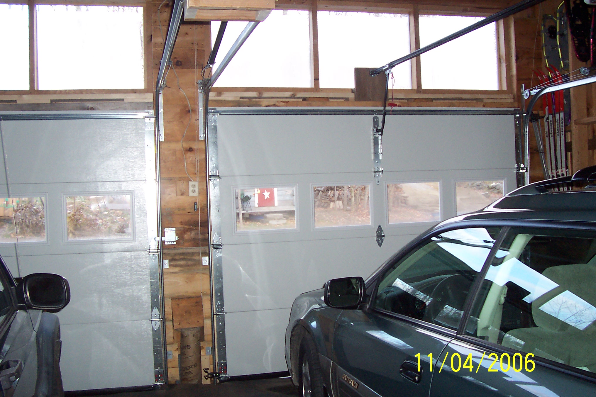

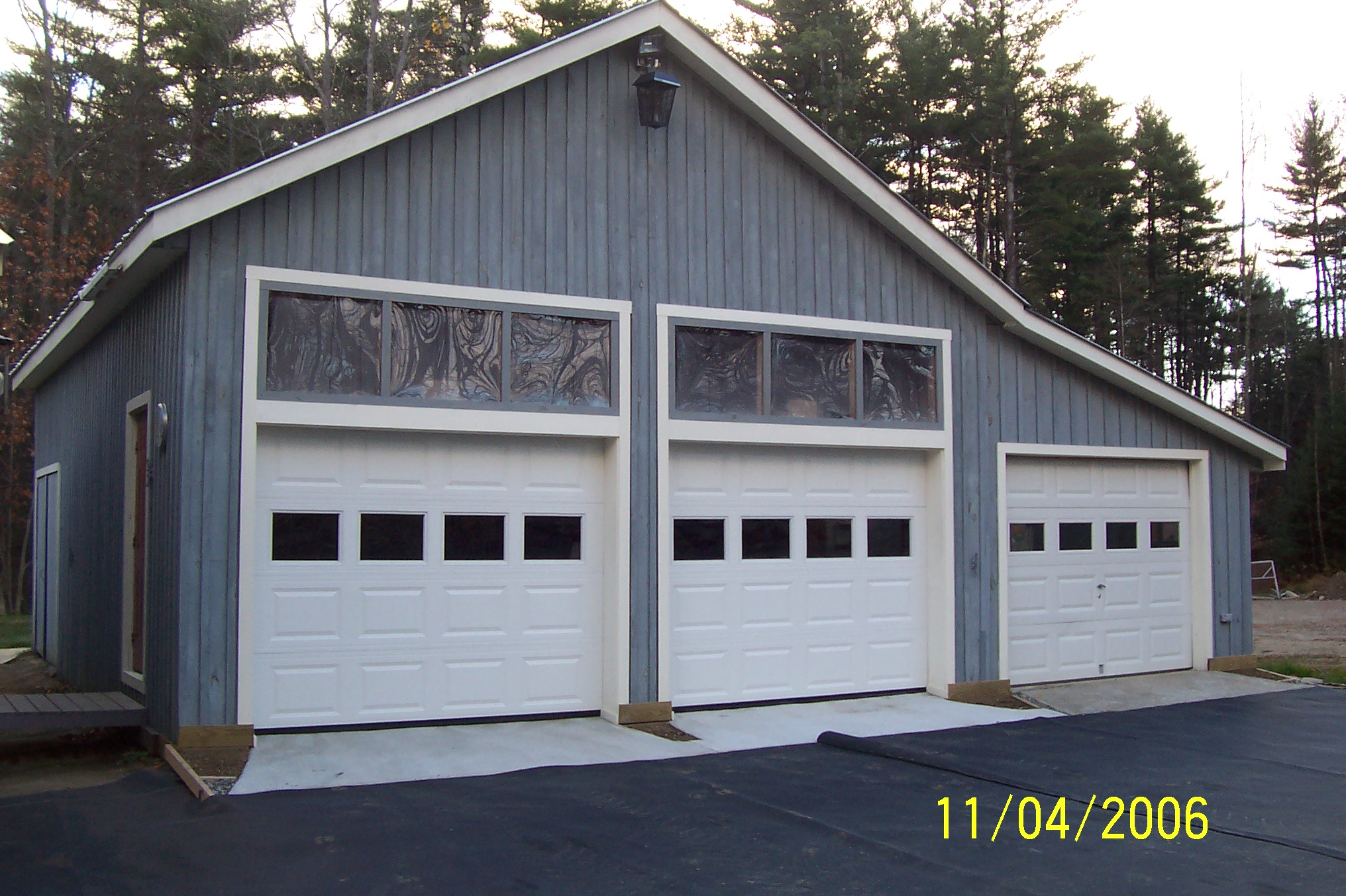

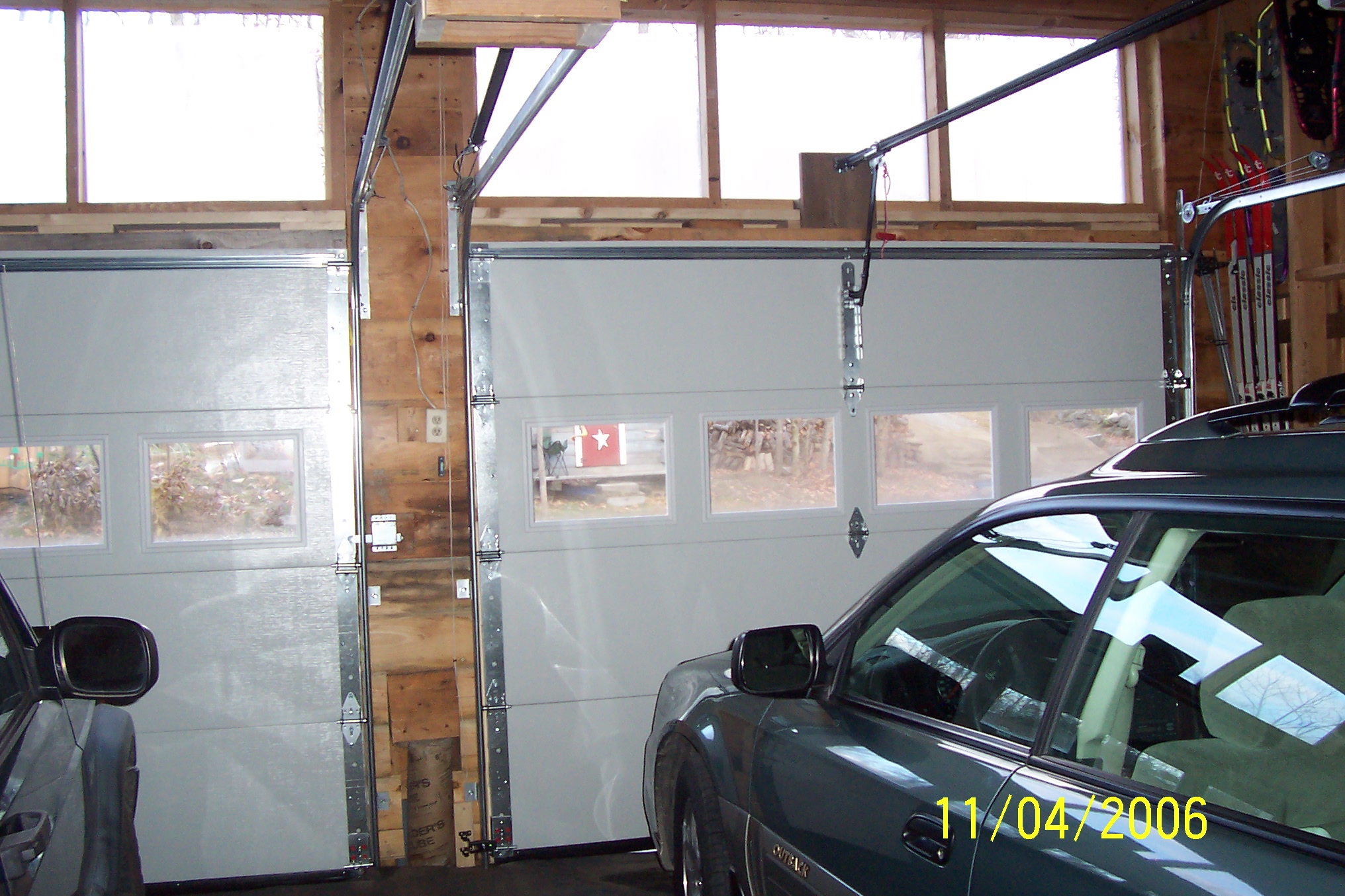

Sounds like a great project .My barn originally was 24 by 36 and it has 10 ft to the bottom of the trusses.Ioriginally had 2 9 ft wide by 10 ft high barn doors in it for years.Inever really needed the high door height,so after years of opening the barn doors driving out the vehicles then closing them,i was pressured by the better half:pto install regular garage doors and openers.I went with 7 ft high and made some transom windows for the top.Istill have one large swinging barn door 10 ft high in the rear for the tractor.
About 10 years after the original build i added another bay ,which is heated,and i use as my mechanic garage and welding area,i call it my man cave:D Building it tall like you aregives you lots of opportunities for adding on..good choice
With tall walls keep your studs close togeather [mine are 16oc] and i reccomend a row of blocking between the studs mid way to stiffin things up.A poorly built building with high walls ,has alot of shake and rock and roll to it.Good choice on 2 by 6 mine are all hemlock,i obtained at a mill i worked at years ago.
thought id shoot a COUPLE pics of mine,yours will be about the same height i think ,but the footprint of my "original BARN is much smaller than yours.
I also spent a whole winter in my spare time ,building my own trusses,crazy huh:confused2:;)
Cant wait to follow this project ..good luck SCOTTY
