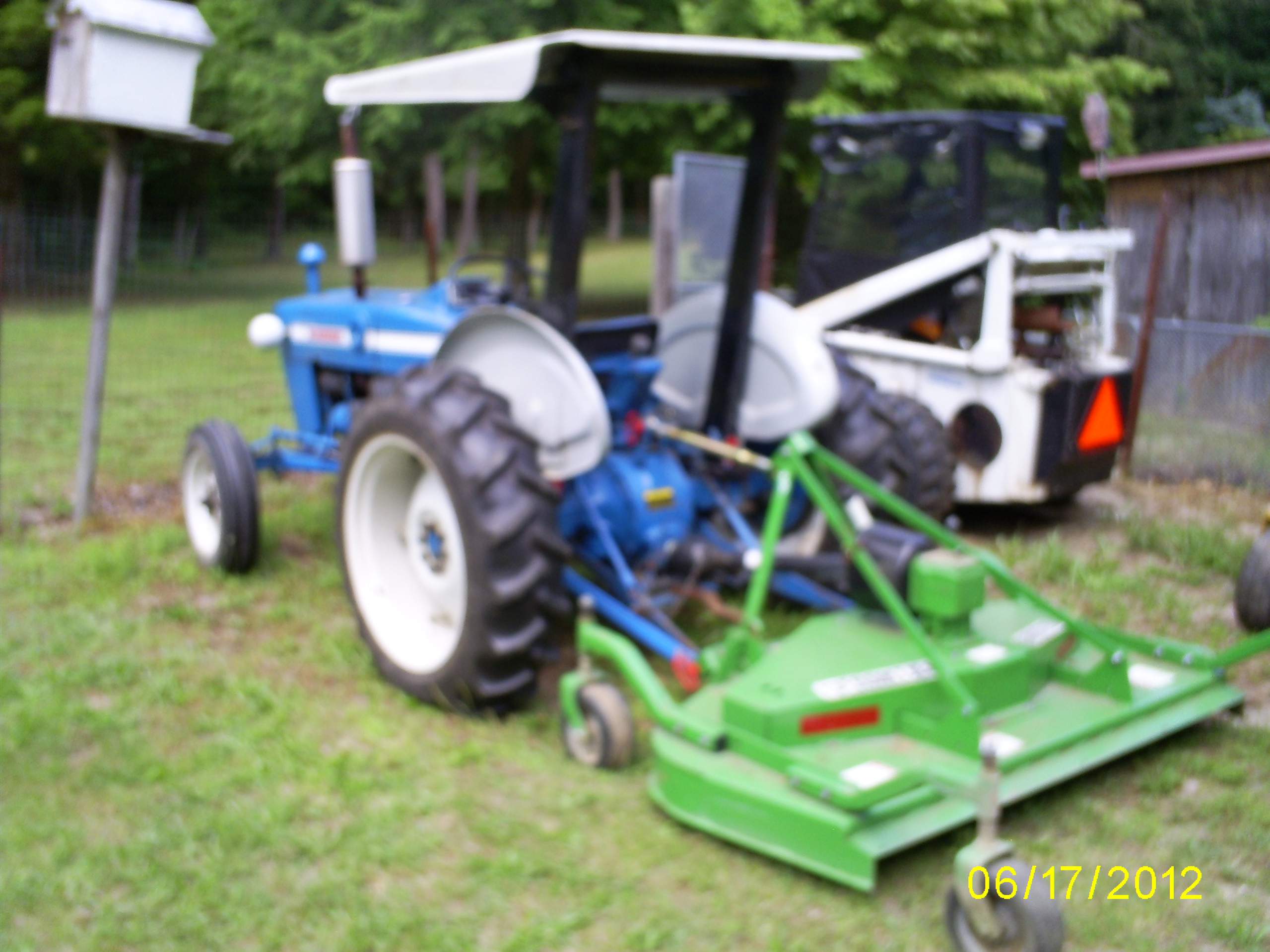

I've found using a lawn tractor or a zero turn with a 50"-72" deck just doesn't work well when mowing 3' tall stuff. The deck simply pushed the weeds down and made a ragged cut at best. Requires another pass or two for it to look right and is slow going.
A lawn tractor deck may be 72" wide but its may not be but 3' long at most vs my 6' Rhino rotory mower that is also 72" wide but the deck is 7'-8' long which lets the weeds stand up and get chopped off the first pass.
Try a pass or two and see what happens.
