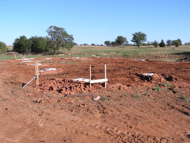

I have prepared a pad to receive this building. This is located just east of my 3 car garage approximately in line with the long dimension of my house. There are 10 each 6 5/8 OD pipe columns supporting 5 trusses plus there are C purlin columns framing the doors and taking a small load.
The pad has been prepared with 14 piers that are 18 inches in diameter and 12-15 feet deep with larger (flat topped mushroom shaped) upper ends affixed with weld plates set into the top of the rebar reinforced piers with J bolts. The weld plates are were adjusted by LASER level to the same height.
When the building is moved it will be set down on these piers. There is no slab floor at the new location and there may never be one. As the existing slab has provision for the siding to extend a few inches down lower than the top of the slab (for rain shedding and weather seal) I will have to extend the columns sufficiently to not "CRUNCH" the siding when lowering the building into place.

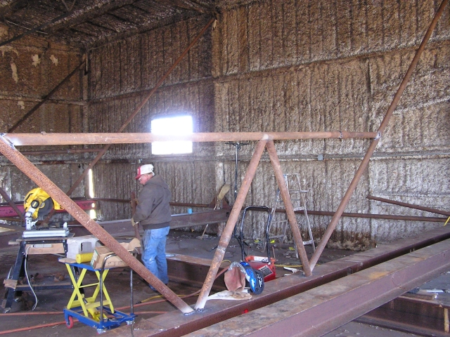

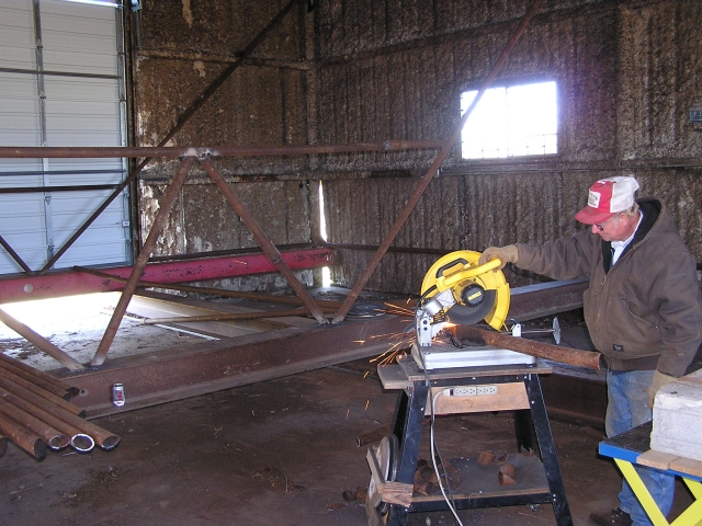

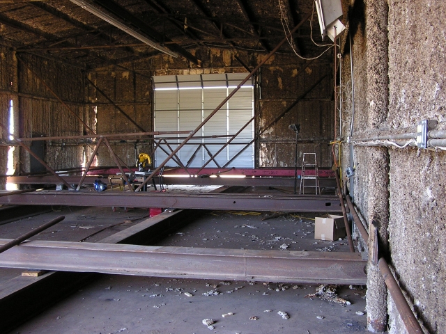

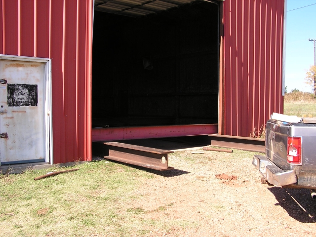

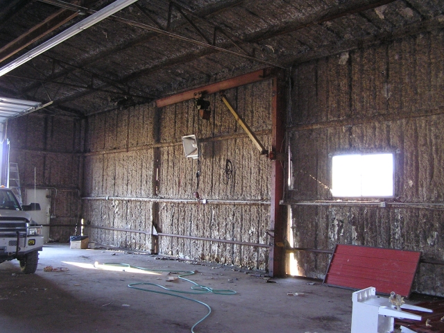

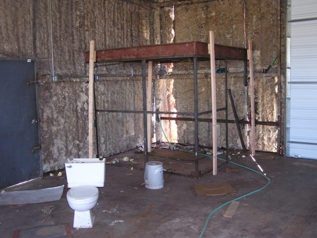

The building movers came and placed large I beams through the building as wide as the 14 ft door opening would allow. Then they placed I beams transverse to those with one under each of the trusses except the center truss which got to transverse beams.

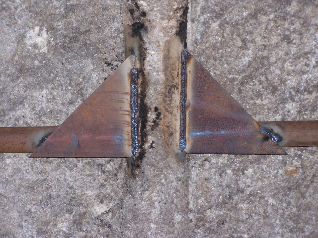

The top of the transverse beams is in contact with a horizontal pipe welded with its bottom extent at 25 inches above the slab. These horizontal braces encircle the entire periphery of the building connecting all the vertical columns. In addition I have welded 20 ft pipe/braces from near the top of the wall to the transverse I beams. That is 10 diagonal braces. Another brace runs horizontal about 5 feet above the transverse beams and has two triangulating braces down from it to the transverse I beams. The mover requested the diagonal braces but I added the additional horizontal brace with 2 each diagonal triangulating braces to reduce the flex of the transverse I beams near the center of the span.
The vertical columns are cut about 70% of the way through at the level of the top of the slab. We will cut the rest of the way through just prior to lifting the building as it is not prudent in Oklahoma to hope for a long period of light wind and just take your chances.
The movers will jack up the bottom beams and insert sets of wheels. They wile then drive across the pasture 1/4 mile south and set the bld with long dimension again running E-W but turned 180 degrees so what was the south side will face north. The office has been cut free and will not be moved. I will disassemble it for materials. The siding will be used to patch the holes cut for the over length transverse beams.
For those of you who are still awake... there are some attached photos.
The picture showing red siding is of the east overhead door opening. You can see the I beams which will be used to lift the bld. The "cage" in the picture with the photogenic toilet was the angle iron frame of the bathroom after the walls were removed. (New location will not have water and no toilet but will have electricity.)
The picture with the glaring window in the middle shows the "W" bracing between the 20 foot diagonal braces.
The close up of the two triangles shows the details of how the horizontal pipe braces were attached. The gussets and the bottom of the pipes are both at 25 inches above the top of the slab and provide the point at which the lifting I beams will contact the bld.
The guy with the red and white cap is a helper who was cutting angles on the ends of the pipes to make welding easier. We used a Harbor Freiight electronic protractor to set up the saw and check the cut ends and so forth. It works really good.
The picture with the white rectangle in the center (overhead door 14x14 feet) also shows some of the bracing we welded in.
The picture of the south wall shows the jib crane as well as the horizontal bracing 25 inches above the slab.

Not much to see but pier tops and batter boards but here is shot of pad.
Careful observers will see my "catfish" pond that I stocked with 200 channel cat at about 4 inches in length. they are about 16 inches now.

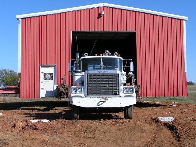

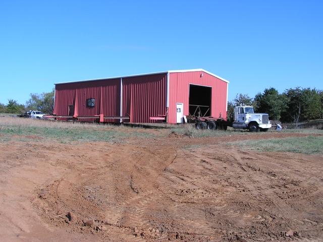

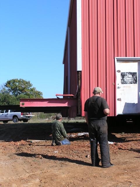

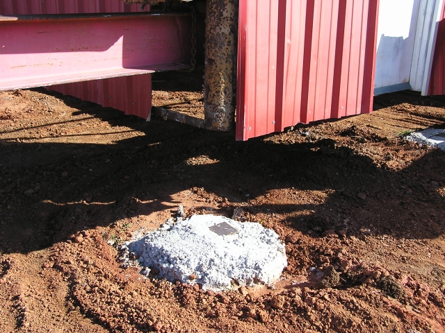

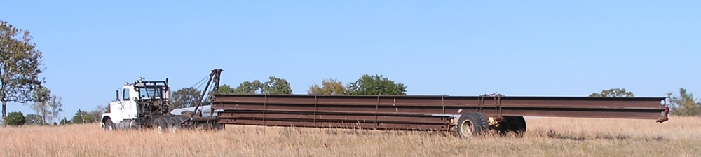

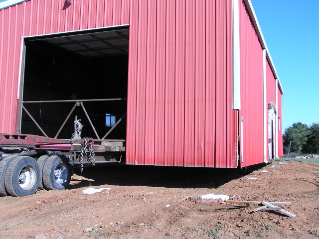

So here are some pix of the barn move.
1. Barn in tow coming through pasture
2. Made the turn to align with the piers (Big truck, huh)
3. Getting lined up over piers.
4. Checking to ensure cut off column bases are in alignment with the piers. Note excess steel I beams sticking out.
5. Pier is 18 inches in diameter with "mushroom" top. The 6x6 weld plates were not well located by cement guy's low dollar help so some were dead on and some were off by varying amounts. I devised a mating system that accommodated considerable imprecision in weld plate location. Pix to follow on that.
6. Here is the Mac after the steel was removed from the building and reloaded for transport. The longer beams were 80 feet and the shorter ones 50.
The longer ones were running longwise of the bld with the shorter ones transverse atop the long ones.
Lateral resistance to wind forces was supplied by the 3 ft of 6 5/8 inch pipe columns (5/16 wall thickness) buried below the slab surface into a large footer. As I attached the bottoms of the severed columns to the top of the piers (will act like a hinge) there is little wind resistance and the entire bld could be collapsed like a parallelogram by a decent wind. So... I welded braces between the columns and the roof trusses to form triangles to resist lateral loading. These are high enough up to not get in the way of most operations.
Another issue is the 2 ton pivoting jib crane with traveling car and electric chain hoist. Down forces on the crane when supporting a load (with crane at right angles to the supporting wall) are converted to a torque trying to pull the central column to which the vertical I beam supporting the crane is attached out of column. The torquing moment translates to a compressive force trying to force the roof truss to push the column over on the other side of the building. To stiffen the building to accept these forces non-destructively I will place even more and heavier triangular bracing between the central roof truss and the central column opposite the crane.
It will be relatively easy to test to see if the bracing is sufficient. I can just hoist successively heavier loads and take a succession of measurements to see how much deflection there is in the structure. So long as I do not approach the elastic limit of any of the structural components there will be no permanent deflection/deformation of the structure. Hopefully with my by guess and by gosh beefing up of the structure it will be stronger than needed to support the 2 ton rating of the crane. I don't want to have to add buttresses to the structure or dead men on chains or cables to handle the crane's loading. I'd limit my hoist weights before doing that. I really don't anticipate needing to go over 1000 lbs on a routine basis and 1 ton rarely, much less 2 tons.
It would seem that many a year ago I went through through this same type of situation when pouring pad's for a batch asphalt plant. I had squared forms at the top and one reference point was moved unknowst to me by one of the fellows helping me.
Doing it again there would be grid for the square framed top cap with a template with the bolt hole pattern and bolts added after the concrete was poured.
It was more than a little embarrassing.:mad::mad:

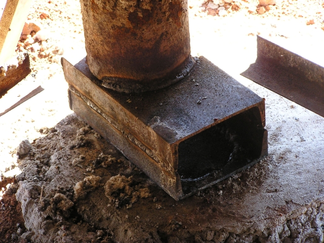

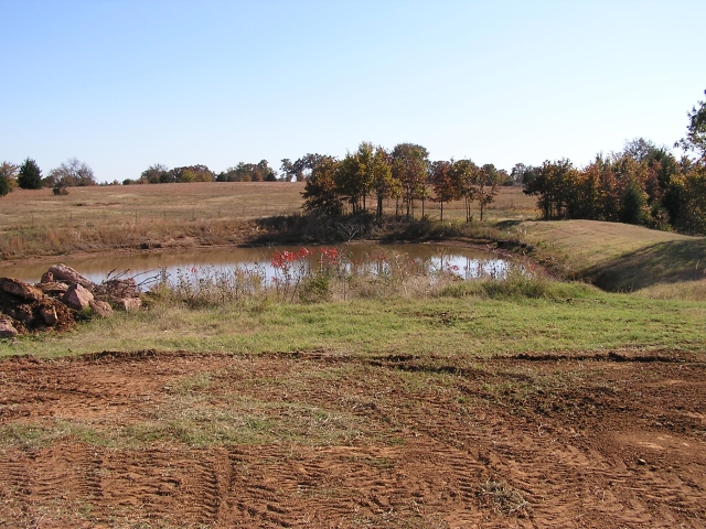

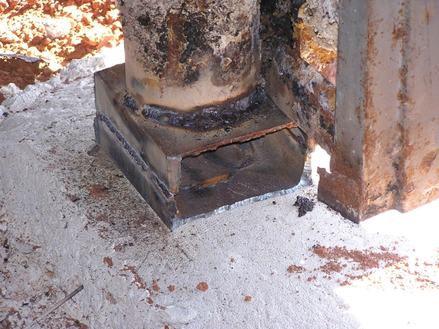

Here is some detail on how I "fixed" the mediocre weld plate placement. (and other stuff)
1. In this view you can see inside the box formed by two pieces of 2x8 inch HD channel iron. Inside the box the careful observer can see the 6 inch diameter hole in the channel iron. This allows turning the channel in any direction so that the column will rest on the box. The circumference of the 6 inch hole is then welded to the weld plate affixed to the concrete by J bolts. In this first shot the fit is just fine, the column came down right directly above the weld plate.
2. This shot shows a column not directly over the weld plate but it rests firmly on the channel iron box and the weight is carried by the pier. Lateral strength is more than adequate given the pipe is 3/16 wall and the channel is way heavier (overkill actually but I paid only $2/running foot for the channel so what the heck.)
3. This third shot shows the location of the barn WRT the house. Perspective is quite distorted in the picture as the barn is well over 100 feet from the garage.
4. This is the view from the east end of the barn looking south across the catfish pond (they are gettin' rather big and eat like horses.)
