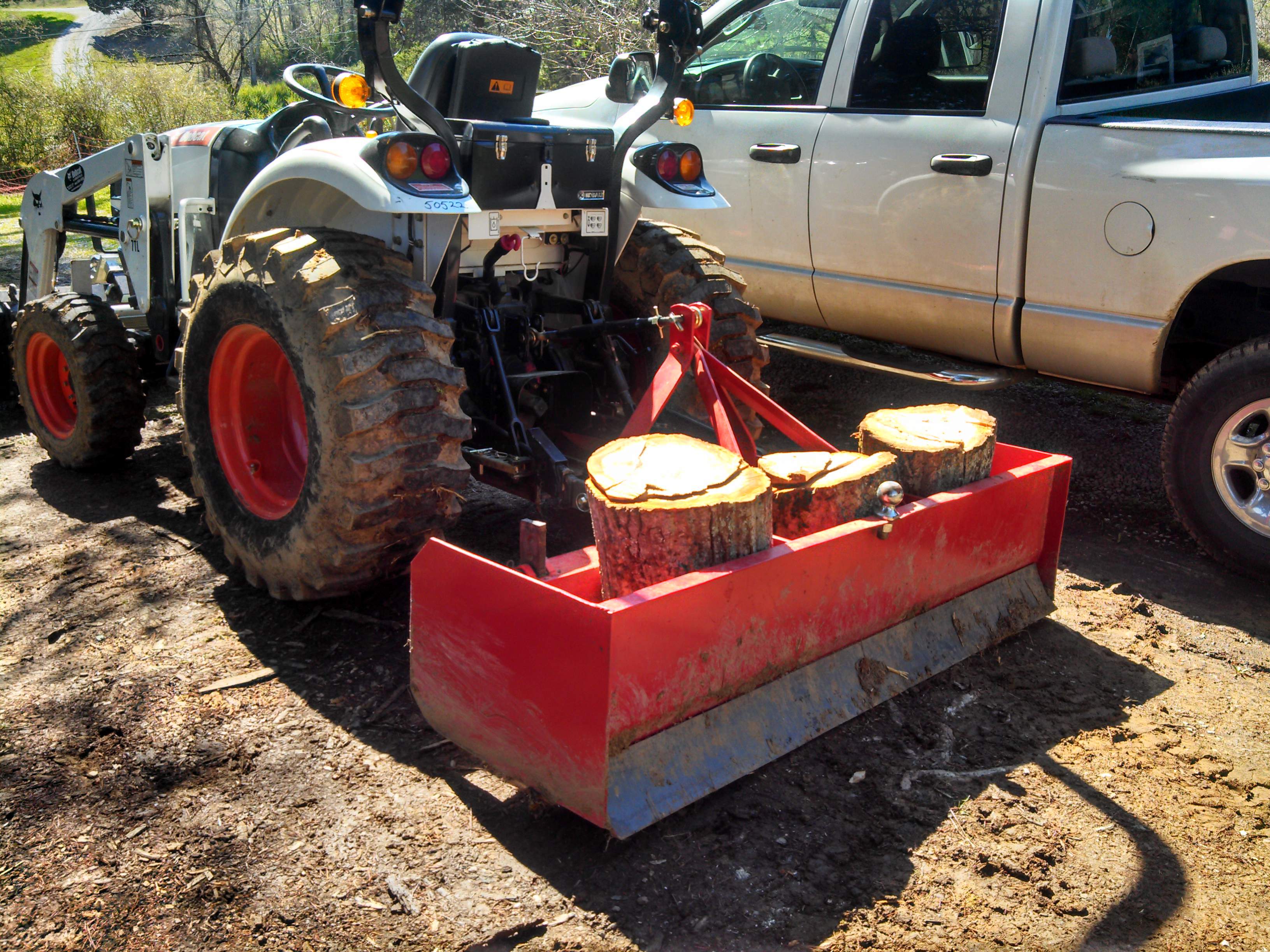

Above is my improvised ballast, to try to counterbalance the extra weight on the FEL. I dumped some heavy rounds into the box blade.

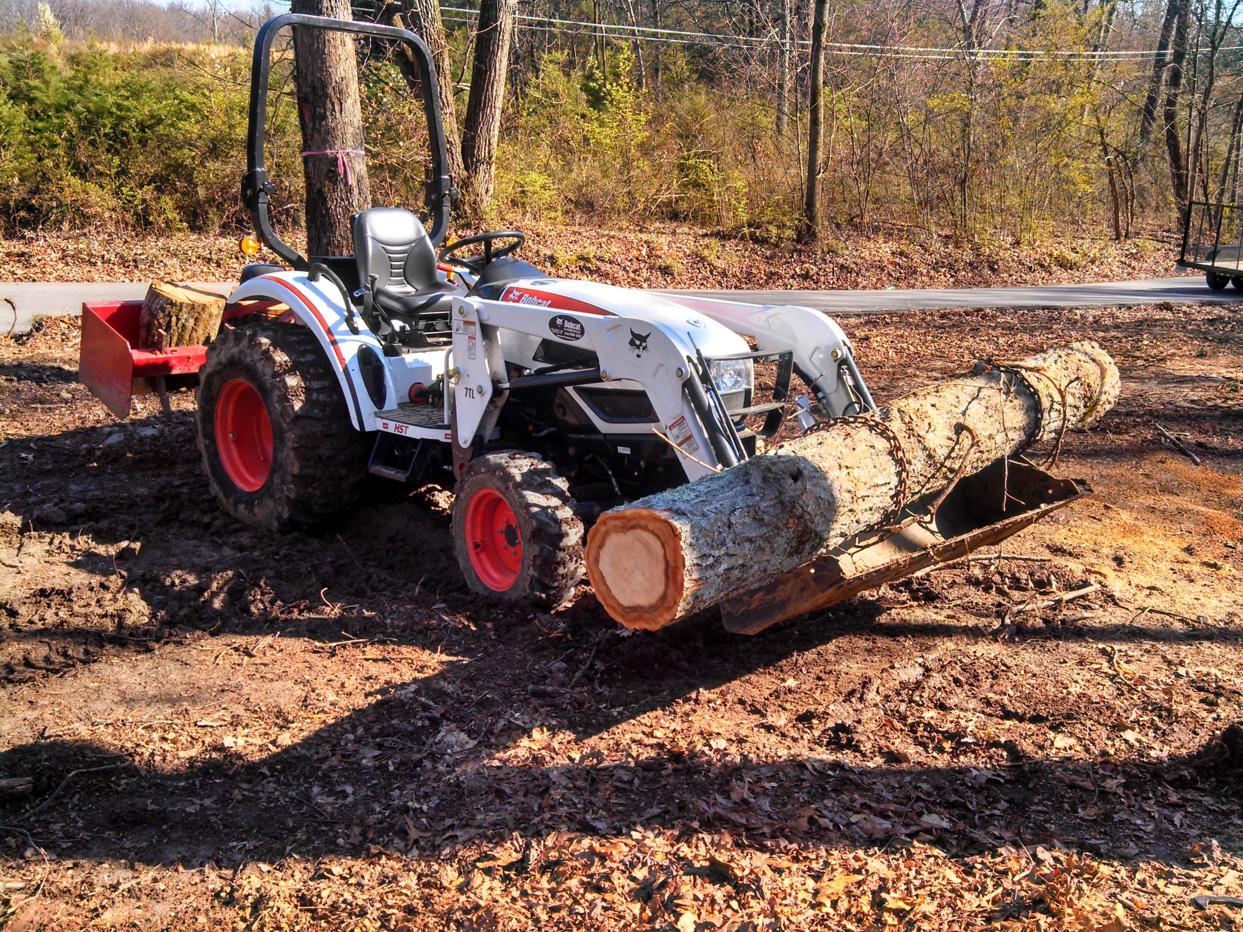

Here's one of the smaller logs, picked up in the bucket. I loaded about three of these logs, and a few smaller (maybe 8" x 10' long) ones before I finally ran up on one that gave me pause. It was 16" on the large end, 12" on the small end, and 15' long. The Internet says it was about 1100 lbs. The loader easily lifted it, but the ground was uneven, sloped, and very muddy, and I just didn't trust myself to make the final move of raising it up 5' in the air to clear the trailer's side rail. I ended up borrowing the homeowner's saw, cutting up half the log into rounds, and carrying the other half home in the bucket.
I will also call this a trial-by-fire of the bucket hooks that I welded on. They held, which is really the least I could ask of them. Woo hoo!

Fun, yes, but there were a few scary moments too. Those big long logs sticking out in uneven ground! I gotta build a real ballast box before I try anything like that again!

A heavier counterweight will definitely help, but you may want to consider a forklift attachment. With forks, it's a lot less scary to lift bigger logs. Once you get the load raised, and angle the forks up all the way, it somewhat locks the log into place at the junction between the forks, and the back plate. That seems to really cut down on wobbling, and swaying. R,

I did find myself wishing for forks at one point, but for a slightly different reason: ease of loading/unloading. Once the log was chained to the bucket, it was pretty secure, but getting it chained and unchained was a real pain. Having to fish the chain under the log, having to de-tension the chains to unhook, and so forth. If I would have had pallet forks, it would have been easy to pick the log up, tilt back like you say, and then slide the log off onto the trailer right where I wanted it. I even think that forks attached to the front of the bucket would have been helpful, since the load rode close to the bucket once it was picked up.

Another safety thing to be aware of when lifting a log in the bucket is the risk of it rolling backwards onto the tractor and the operator. Using those chains was another good decision.

Where there is a will there is a way. Must have been fun driving a couple miles with your load. A heavy 15' log on uneven ground would be trouble no matter what. Good job. As mentioned the thing to watch when you have to lift logs high that are chained on the bucket is that they don't role back on you. Sometimes I hang them under the bucket if there is enough lift room. They are easier to unhook in the trailer.

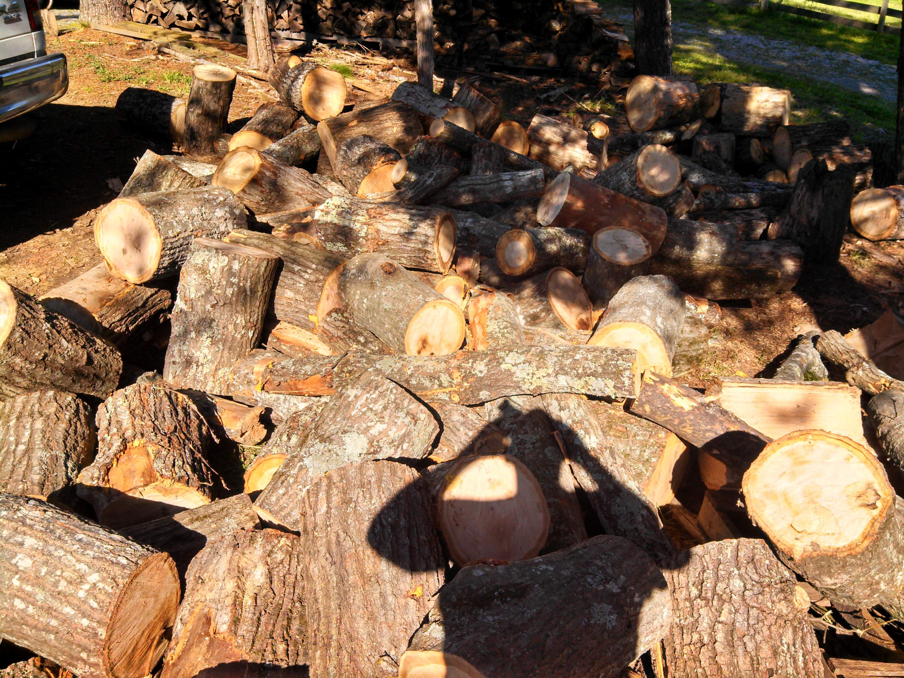

Just about a week later, and I estimate I have cut and moved about two to two-and-a-half cord of wood, when it's finally split. Cutting the logs into rounds on site and moving them one truck-load at a time seems to be about 1/3 faster than moving them with the tractor, not even counting transportation time between home and the site. I'm doing one or two short-bed loads a day, depending on how much stamina I have.
The picture doesn't really do it justice, but it'll give you some idea.

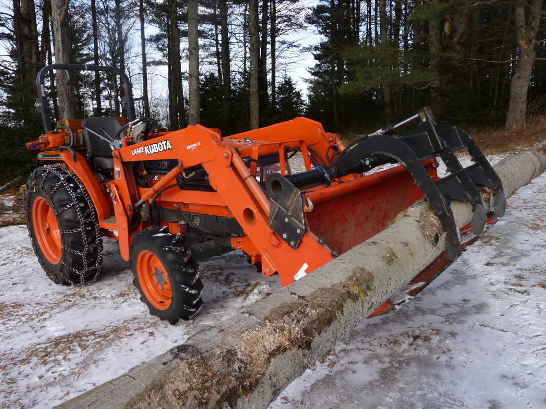

After using my fork lift attachment to load logs I decided a grapple works much better. I have much better control picking up and putting the log or whatever else where I want it. With the grapple I just drive up, open the grapple, rotate the bucket, close the grapple, and lift.
If I did it right you can see the grapple in the attached photo. It is a simple one I bought off eBay. It has proven to be a very useful attachment.

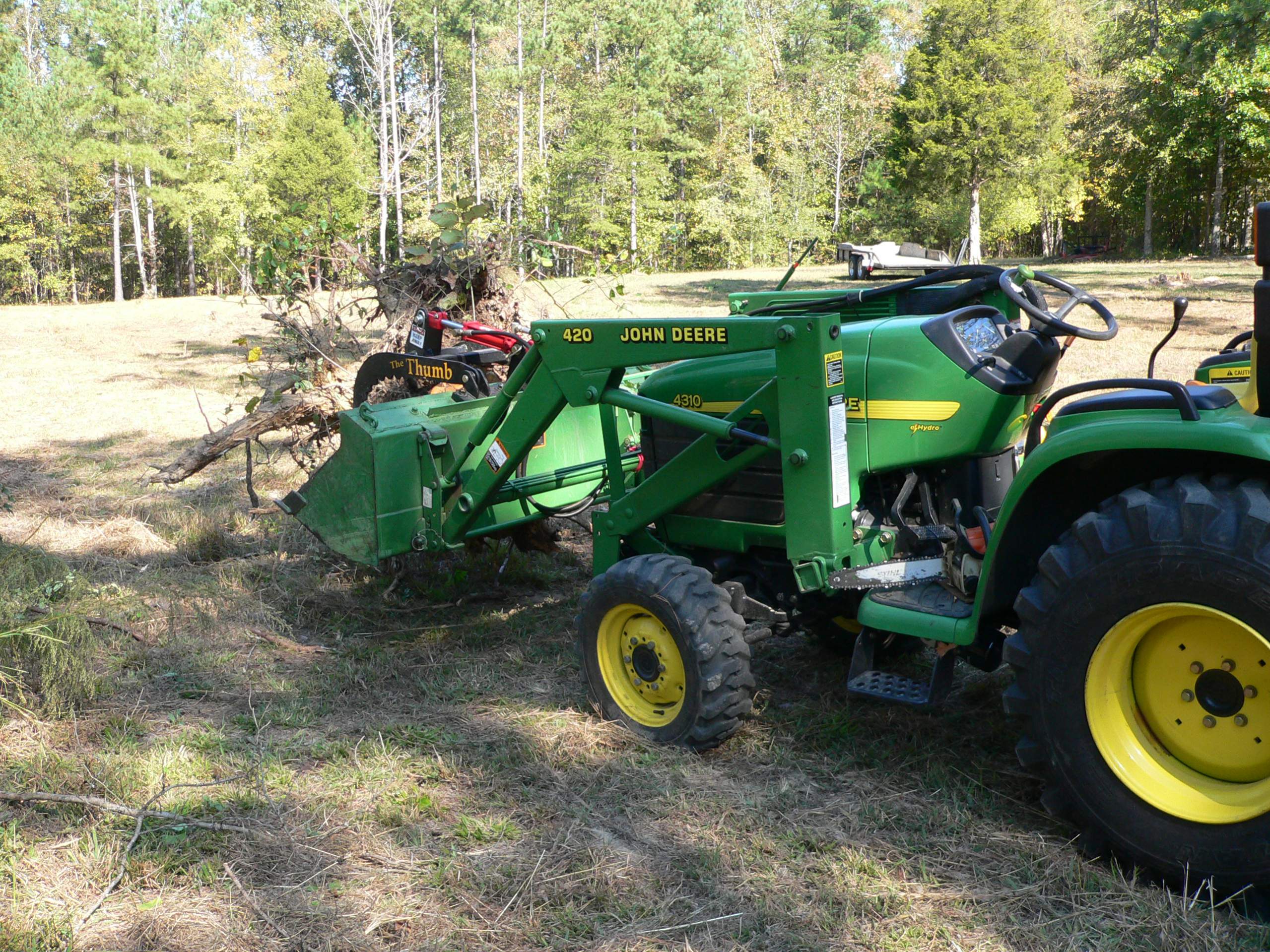

jmckelvey, I have a similar grapple on my bucket and.you are right they are very useful
