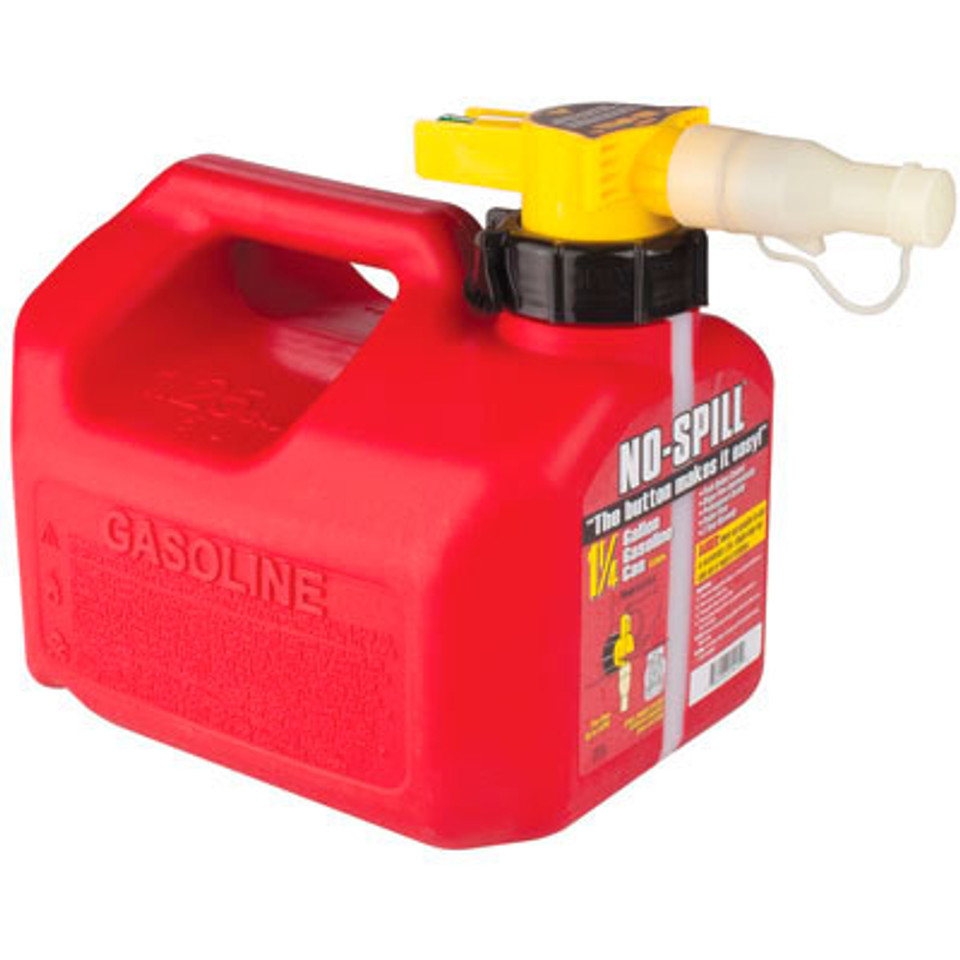

I’m just guessing here but the op must be mixing the gas from a larger container. When I do it I’m filling the can at the pump I just stop when the pump says I hit the amount I want. None of my gas cans have a mark for the amount of fuel except one I just bought, and it’s pretty close. Most of my diesel cans have a mark but it’s hard to see the amount of fuel in the can.
1.25 Gallon Gasoline Can – No-Spill These cans work great and have marks for the quantity of fuel in the jug. It's easy to pour from a larger container into one. Anyway, easiest way to do it is just fill the can like you do and mix in the correct amount of oil. Use it up in a year or two, if it's non ethanol. If you can't use it in the saw, use it in something else.
