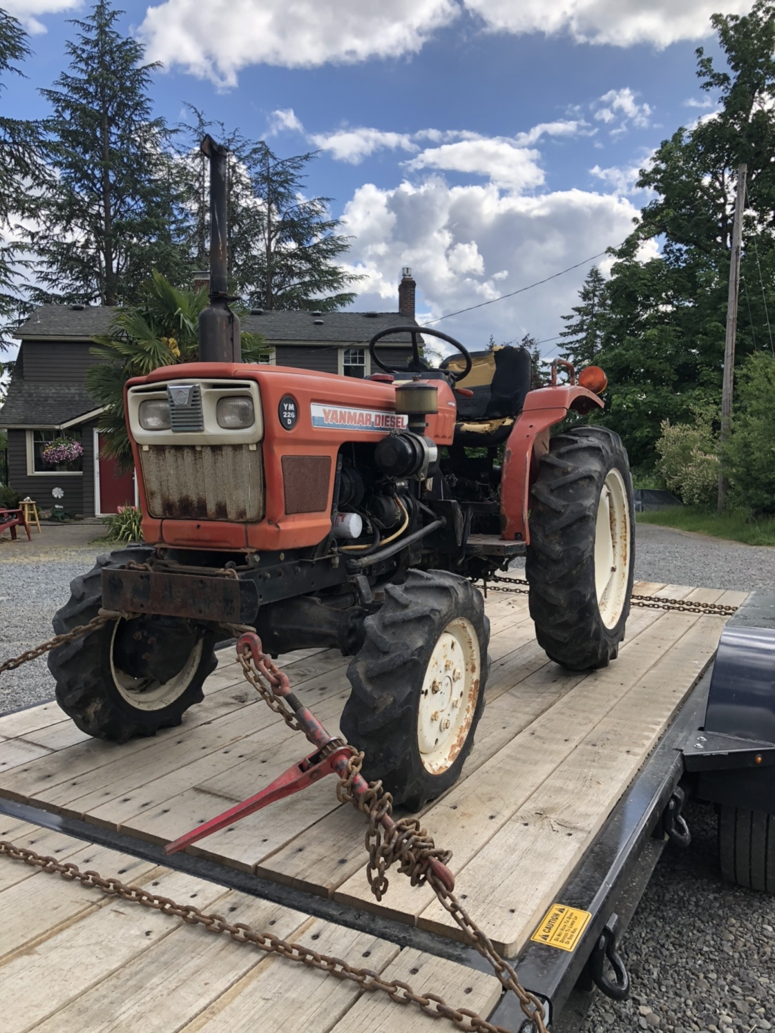

Love the tractor...but had a setback. I'm a novice user and with the hills here, want to add a roll bar to the YM186D for extra sanity check and safety, especially for my teenage boys to drive.
I had already seen that Hoye and Fredericks sold them and figured it would be OK to buy the tractor as roll bars were readily available (so I thought). Went to place an order and out of stock. No problem I think, but alas, they had a ROPS mfg build 50 only and all have sold out. I called the mfg and the tooling is long gone, no more production samples. Fredericks and Hoye have no plans to order anymore.
I then started hitting the salvage market. Found Farmland down in Tangent, OR near me had a 186D with a roll bar. Great I thought, but they wont sell it to me because the original nursery owner modified it.
Found a Gray market supplier next state over "Tractor Co" that was selling 1510D's (gray version of the 186D I believe) with some sort of ROPS on them. I asked the guy if he would just sell me a ROPS, but have not heard back. He did say probably not worth it for him, but to send him an email with the request anyways.
Supposedly Hercules via justtractorparts.com has a 1500 series ROPS that might work. http://justtractorparts.com/rolloverprotectionstructuresropsforyanmarymseriestractors.aspx but they have not called me back...said they are going out of business, but still plan to sell manuals and ROPS. That is my last hope.
I left a message with Yanmar corporate to see what can be done, as this was a US model that had the ROPS as an option. I heard that John Deere started making ROPS for older 650, 750, 850 models and selling them, maybe Yanmar might someday follow suit.
I am going to keep looking at the salvage market. You never know what is out there. I am sure I can become comfortable driving it without the ROPS, but such a fairly straightforward piece of equipment seems like a no brainer if easily obtainable. I would not let my boys drive it without a ROPS though.
Not sure of my plan right now...the machine may end up in new hands that lives on flat land or with a more experienced operator. It is such a nice machine! I would just be more comfortable as a novice to have a ROPS.
Any thoughts, suggestions or input would be appreciated.

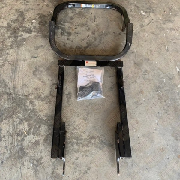

Fredricks has this on their site for an OE ROPS type system.
IF you had to DIY, some of the ZERO-TURN and other machines would have something very close for the top section. The bottom section looks more like thick SQ tube with welded plates.
If it was a JD version, it would just be one solid goal post setup in GREEN. This one is a mere $175+shipping. You would need to take measurements. ;)

That is the for the family-2 ROPS which is out of stock and no plans for new production. It is for both 1510 and 186.
Here is the install for the Fredricks' ROPS made by Custom Products. The images would help and the 2D drawings.

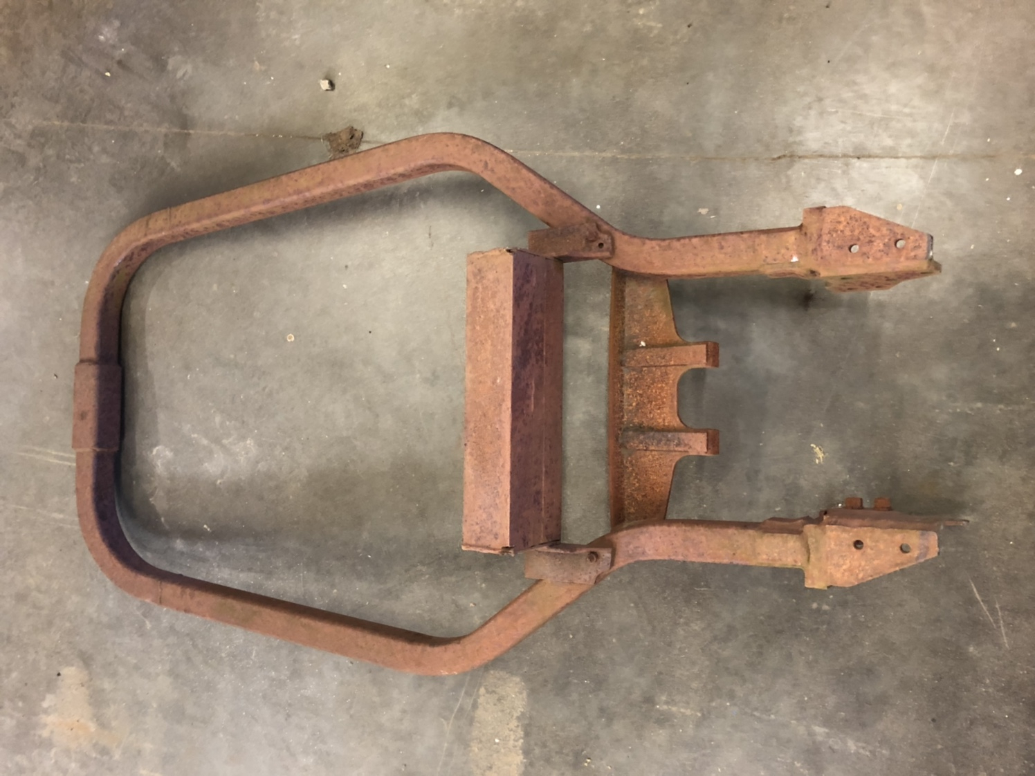

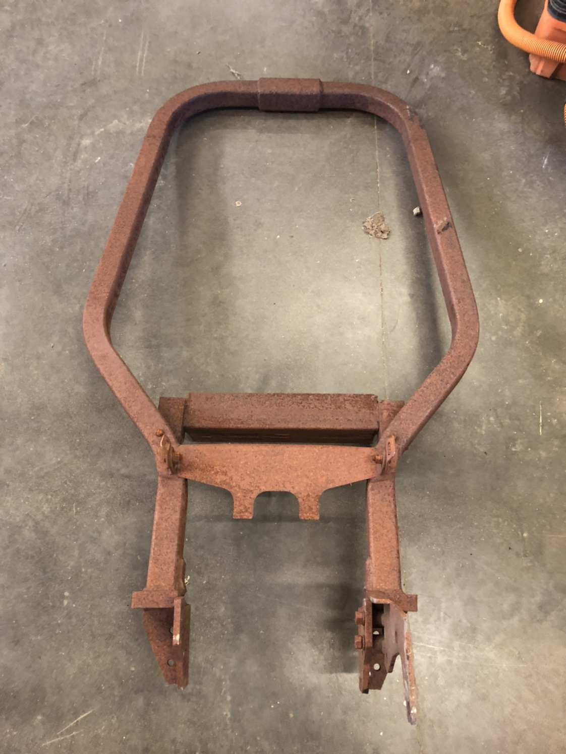

Cpy911 I think Ive got what you’re looking for. I’ll fill everyone else in. Today I went down to farmland tractor in Albany, OR to get a driveshaft tube for my 226D. When I got there I asked if I could see everything they had for Yanmars since there were a couple other things I wouldn’t mind getting such as ROPS for my 226D as well as the side panels that sit below the hood. Everything they had would fit on about 3 pallets and covered a number of models (155, 169, 186, 187, 226, 336). For those wondering they had more 155 parts than anything. Nonetheless upon browsing out in the yard I found a set of ROPS that definitely came off a Yanmar and I bought them even though they didn’t have any markings indicating what model they were off of. Now that I’m back at the shop it’s becoming more and more clear these are the ROPS for a 186. Ironically enough I’m doing some brush cutting for Cpy911 next week so as long as the dimensions I texted him match his tractor I think I’ve got his ROPS search coming to a close.
Last picture shows the pallet with the most Yanmar parts in the salvage yard. Please contact Farmland Tractor in Albany, OR if you see a part in the picture that you need. (Picture taken 7/8/21. Phone is acting up so there’s also a picture of my 226 in it’s current state.

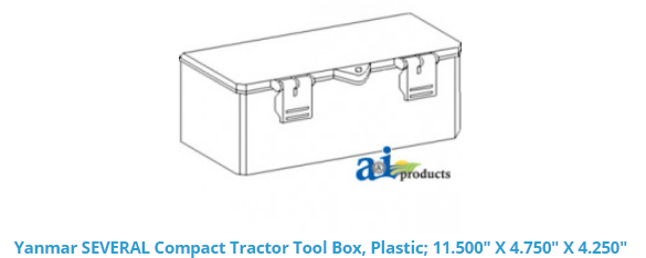

But WAIT, now you are going to make him look everywhere for the official Yanmar tool box that fits in the ROPS holder right there. :ROFLMAO:
Would this one fit ???

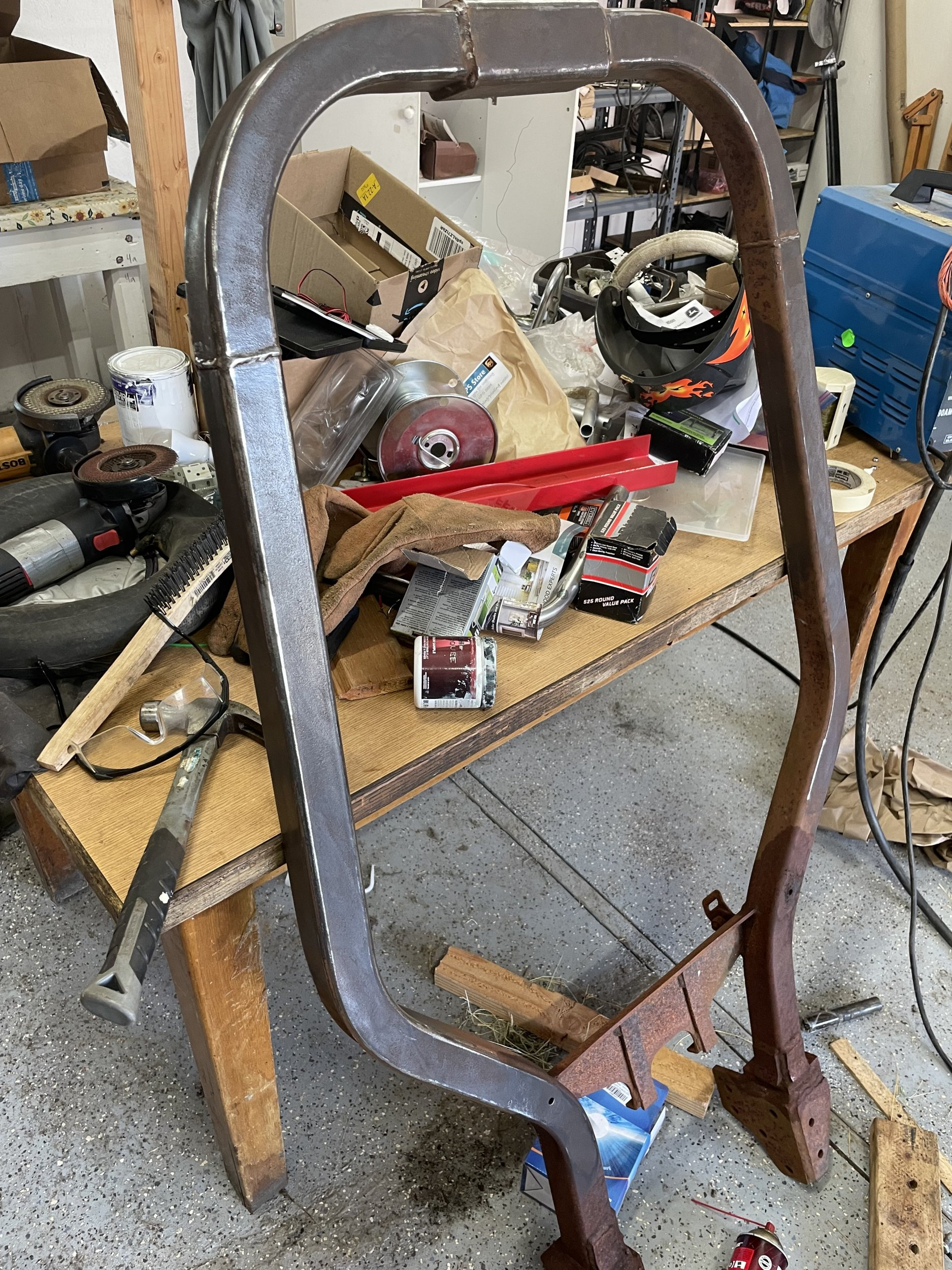

Johndeere3720 came over last week to run his Bobcat T62 + brush hog over a lot of blackberries on the property we bought last year. He got a lot of the brush down to a level where the little Yanmar 186D can maintain it with a rotary cutter.
The roll bar he found is indeed the original factory ROPS. It is missing a couple small brackets, fasteners and needs a strip and paint job, but it is SOLID. Will post pics of progress.
/ Might be getting back into a Yanmar #79

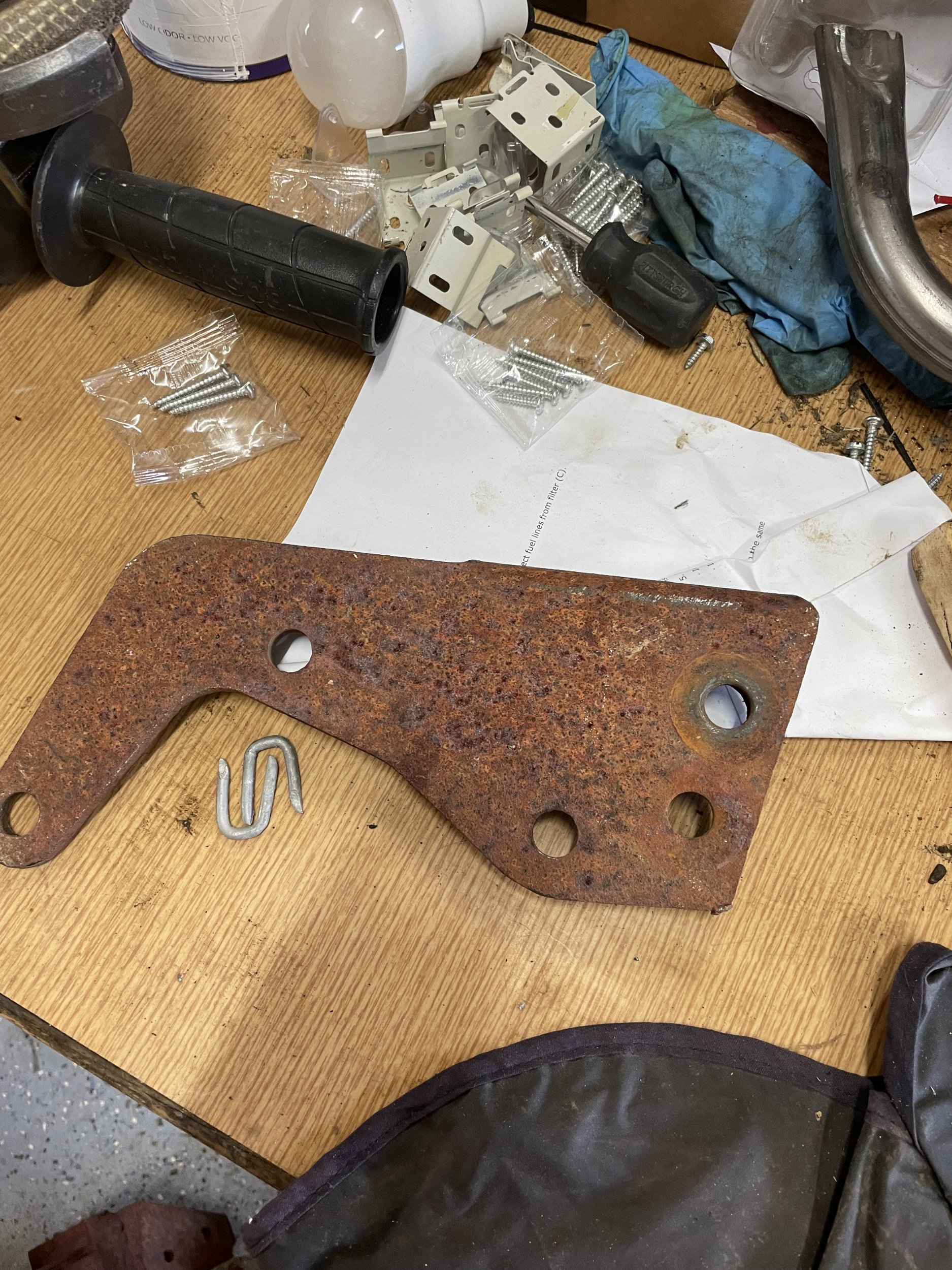

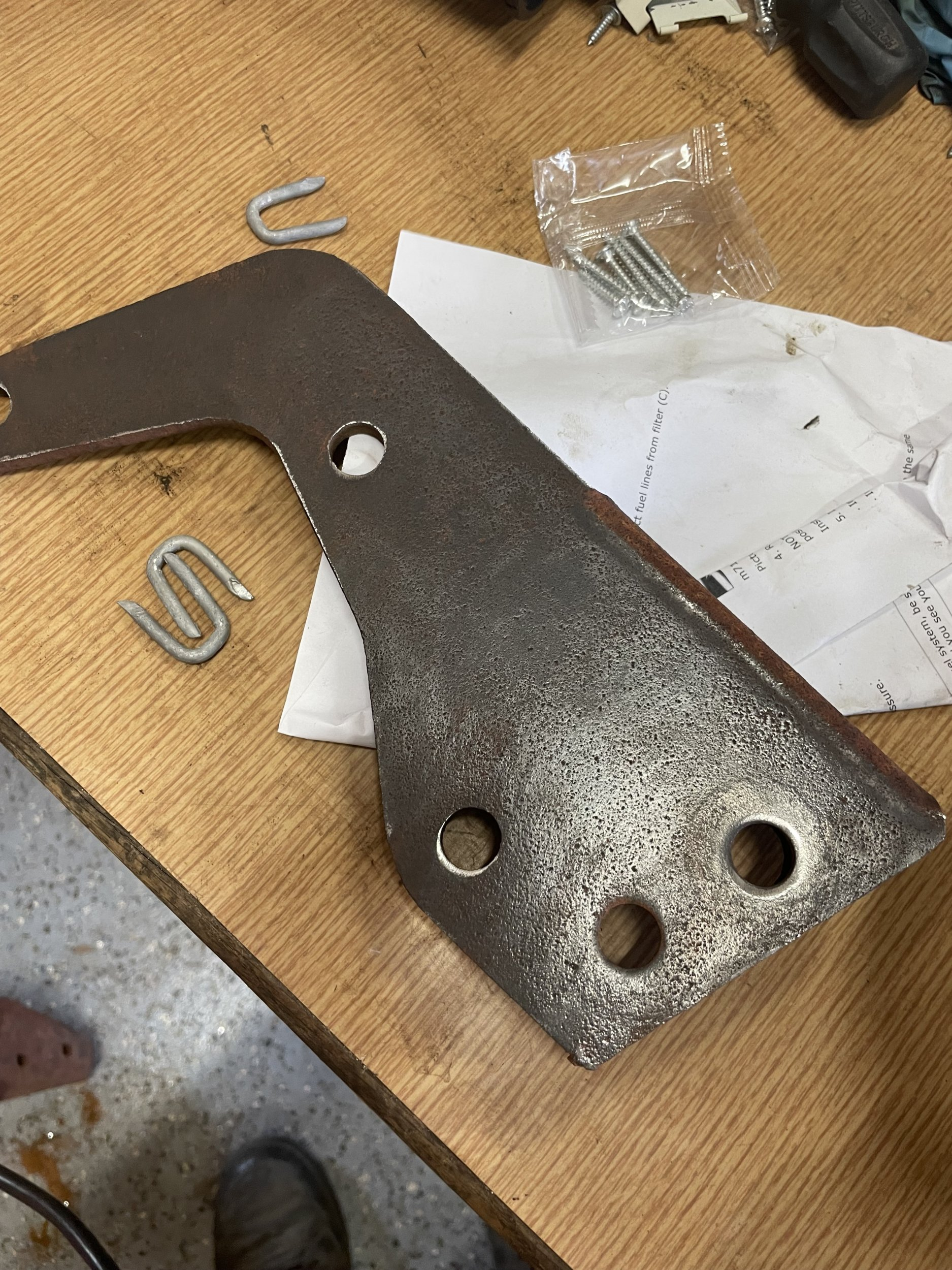

Got out the flapper disc to see what might happen...I think it might work. A little bit of naval jelly and some steel wool should finish off the tight spots. I am thinking of painting it Yanmar red.
