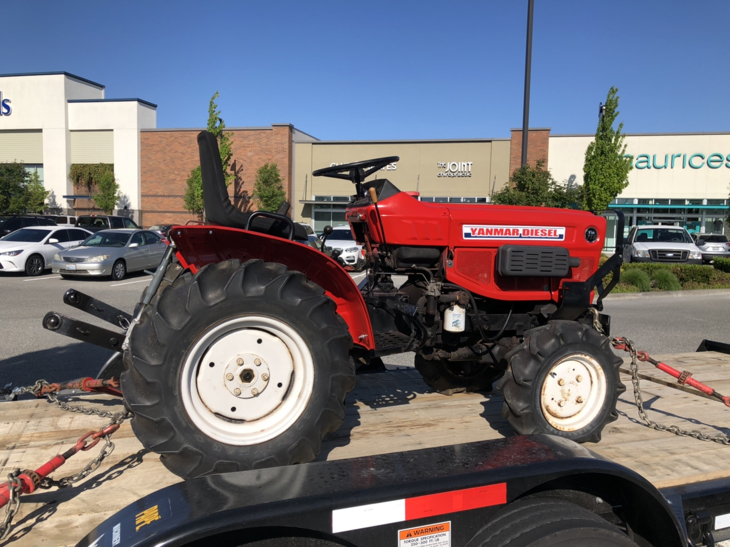

Well it ended up on my trailer this afternoon
Needs a little work but it’s a great running, driving little tractor. More to come soon

That fender style would accept many of the tractor soft-fabric cabs out on the market. NICE.

Wow, its gorgeous!!! And welcome home!
If the charging is erratic and you've cleaned the connections, replace the regulator. It's a near-universal one matched to the later pancake alternator, the one that needs external diodes. If its six-wire then it will fit. About $30 on Ebay and may say for some mower, excavator, Kubota, whatever, all the same regulator. The OE ones were flaky.
Here's the YM186 Wiring Diagram and the Regulator troubleshoot diagram.
If it were mine I would put an exhaust tip on the muffler aimed outward before it smokes up that beautiful paint.
You'll love the YM186D. Dismounting with the space so tight is the only flaw I can think of. Transmission whine in 3rd range like an old Jeep is apparently harmless. Aside from those two minor aspects its a flawless design.
I was out today towing a 2500 lb watering trailer up, down, across some significant slopes with mine. It's a real workhorse.
One comment - I mounted the rear wheels dished out, and external to the axle-end flanges. I think this extra width improves side slope safety.
