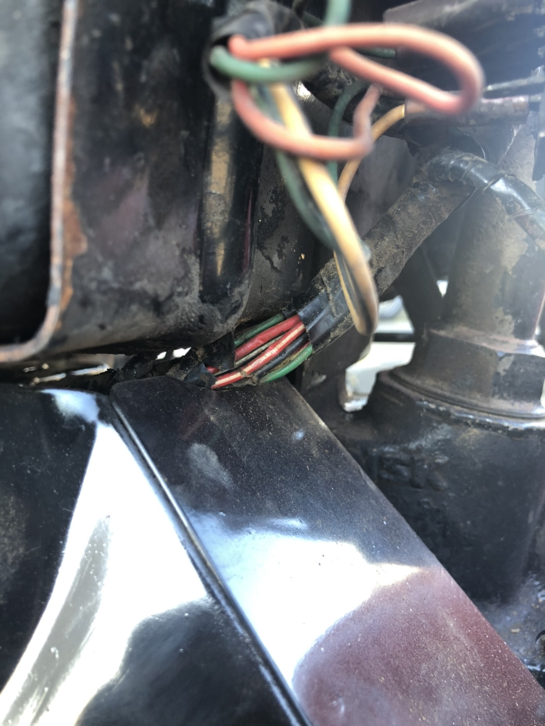

Little update for the day:
Upon testing the regulator I got continuity on pins that I shouldn’t have so I picked up a new regulator in town.
I also found the main wire loom had some chafed wires due to the steering lever shield. I repaired the two wires that had been exposed and started to corrode.
I’ve got these wires that I have not yet identified, hoping to figure out what they’re for. Also attempted to hook back up the pto and clutch safety switches however neither seemed to work and just prevented the tractor from starting so I just unhooked them again.
After all of this I still have the same problems, battery sits at 12.5V while the tractor is running yet the battery light is always illuminated and gets brighter as you idle up. Driving home from the shop I think I figured out why, I don’t have a charging wire going from the regulator to the battery, so that’d probably explain why it won’t charge. 🤦🏻‍♂️

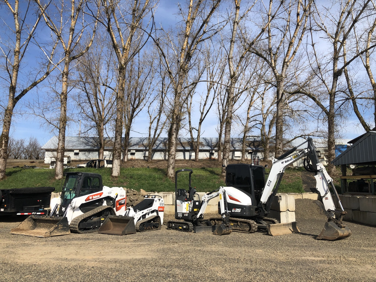

Of course after messing with the tractor I had to take it out and mow some grass. I should probably set up more shelving so the yanmar will fit all the way in the barn with the bobcats.
