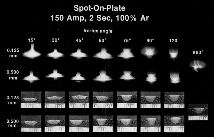

I am far from any kind of expert, but I have never heard this. Could you elaborate please?
Here is a nice little chart.;)

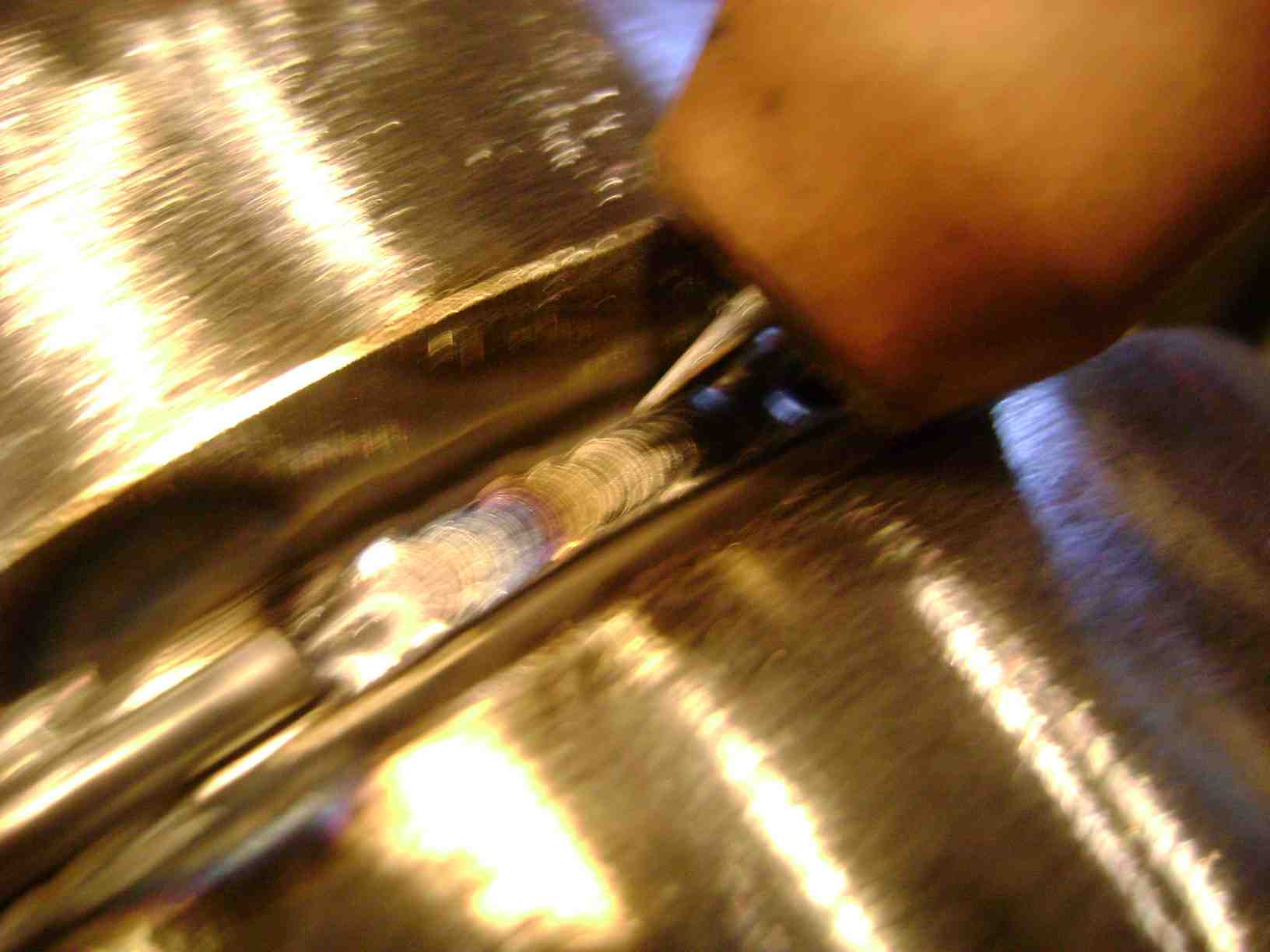

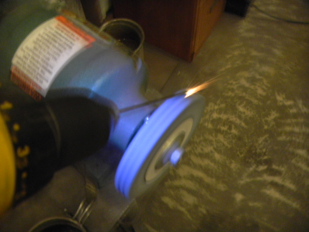

Zap over on Welding Web let us in on how he uses a drill motor and bench grinder to sharpen tungsten, works really well.
