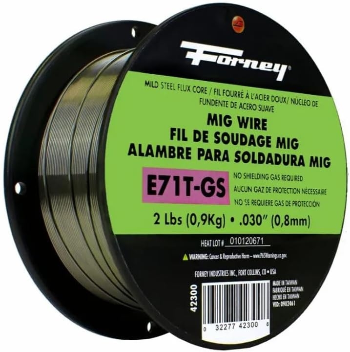

I generally have bought my flux core from Amazon and have read those reviews.
I also buy name brand wire, not the generic brands.
My last wire was Forney 42300 mild steel.
Very little splatter to clean up.
