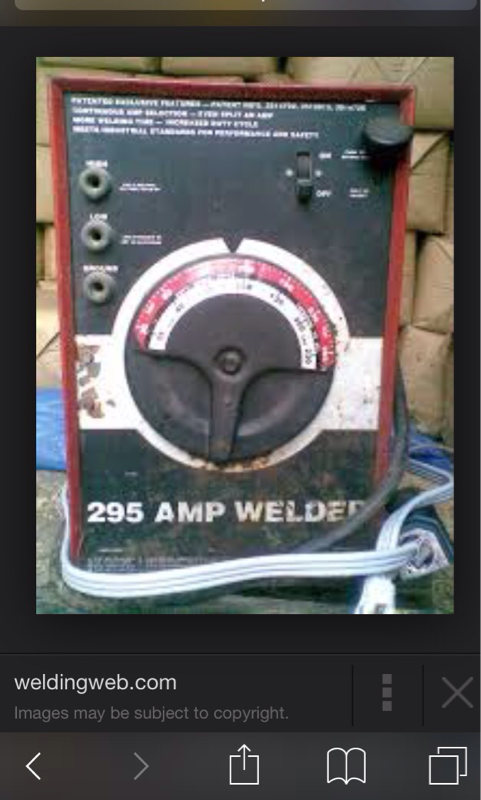

When I started welding I bought a Century 295 stick welder at a flea market because it came with a 100' welding cable extension cord, 25' ground and 50' stinger cable. The seller said the high circuit didn't work so I got it for $180. (the extension cord is worth that much). I fixed the high circuit problem but I couldn't weld with it. I had no experience and had a heck of time trying to strike an arc. I took a welding course in the evenings at the local college but even after that I still had a heck of a time striking an arc.
I bought a Lincoln 180 mig welder and that problem ended immediately. Now I enjoy welding instead of cursing it. The mig just makes it so easy for a novice to use. THAT is what I love about mig. I still have the Century but haven't used it since getting the mig. I do however use the extension cord on occasion.:) I'm sure the stick is better suited for thicker materials but I have welded a fair bit of mild steel with the mig, mostly 1/4" or 5/16" and it has produced very strong joints in my opinion. I even welded some 1/2" for my 20 ton long splitter and it has held together for about 6 years now, even though I sometimes think it will break with all the stress pinging I hear when the splitter slows down in the very hard woods or knots. The 1/2" weld took a lot of prep work and multiple passes but I would trust that weld a lot more than a stick weld that I can produce.

I entered 295 into jdparts and two models showed up. Mine is the first model in the parts book. Thanks for the picture and info Terry.
I enjoy welding with mine. I weld with mostly 1/8th 7018AC. They aren't the easiest rod to weld with but if I use them every time then when I need to make a critical weld at least I don't have to learn to weld with a new rod first. Over the years I've come to exclusively use Lincoln rods because they weld so nice. Hilbilly that might have been your problem as not all rods weld the same. Plain 7018 (no ac) rods are just about impossible to weld with
I also have an ArcAir model K2000 that I use with this welder. I needed to buy ac carbon rods but it works. It a pain to keep the arc going but it works. For a few years I couldn't afford to buy an acetylene contract so that's what I did all my cutting with, that I couldn't do with a chop saw. The ArcAir uses the full 295 amps. I tried it with a Miller 225 but the juice just wasn't there.
