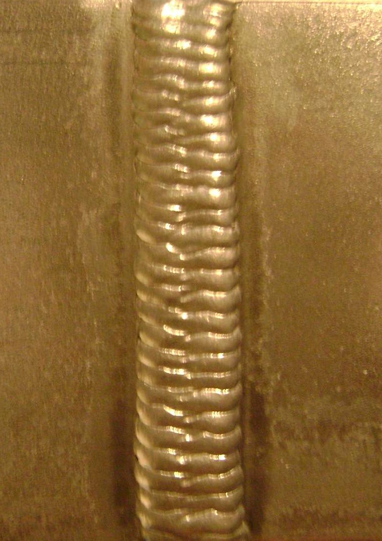

I could not get rid of the porosity in the weld.
What type of flux core / dual shield are you using? Some of them require up to 45 cfh of gas. Can you post some pictures?
Here is a vertical up with ESAB's 710X.

Thanks for the tips scooby. Those would be the two main companys here in Fredericton as well.. I may bite the bullet and buy a small tank and switch to soild core..
dang those look good compared to what i can do..LOL.. I was around 20cfh with my borrowed bottle and the flux core wire is genuie Lincoln brand. I will go grab a few pictures and check..

I haven't run much dual shield in years, use to get a pretty steady diet of it at times.
Proper gas flow, and stick out, make all the difference in the world with dual shield. Some wires require 3/4-inch stick out.

dang bottle ran out of gas while i was laying a bead to take a picture..I need quite a bit more practice so i think i will just keep sluggin away with the flux core..The welds arnt the prettiest but they get the job done 90 percent of the time..
/ Mig gas Bottle Questions #20
If your using the same flux core wire for both gas shielded and self shielded, I think thats your problem.
