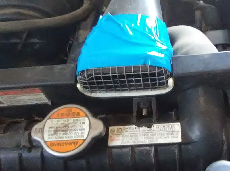

Finally put some 1/2” SS screen on the intakes. Used leather hole puncher to make some holes to lock screens in place.
I think a mouse could go right through those holes
I used 1/4" Hardware Cloth and color coordinated duct tape. ;-)
   / Mice #132
1/4" far better choice IMO. 1/2" mesh will keep biggest mice out, but the beasts don't wait till their fully grown to mate.
Today I took the time to get some 1/4'wire mesh like you have. Removed the cowl on the F450 to make sure there was no nest under it..and there was none. Cut some small pieces mesh and screwed them under the rubber flaps at the sides of the cowel...Cant see any other access point where a mouse could get in anywhere else. Hopefully this ends the problem in the dump truck. I did notice a slight mouse smell even with a new filter..I believe the mice were under the hood on the inner fenders for a while pissing and crapping..once its pressure washed I hope the smell is gone from the hard surfaces.
