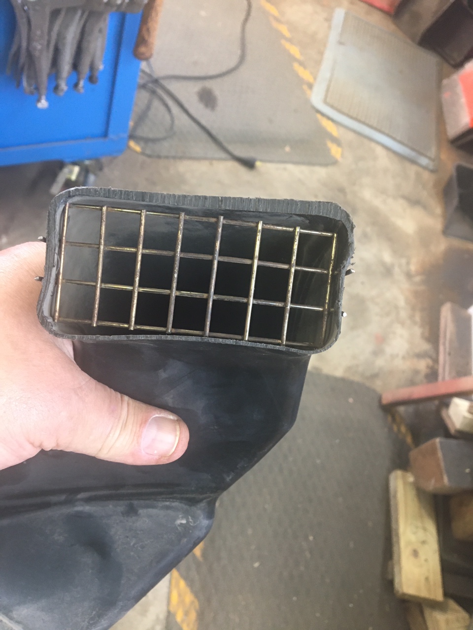

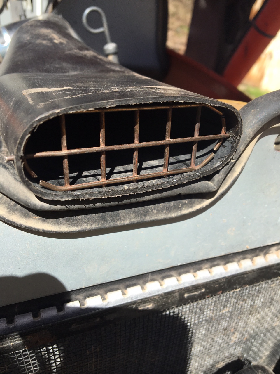

Our furry friends are active. As previously stated had an air cleaner box stuffed full acorns last fall. Mice or ground squirrels?
Finally put some 1/2” SS screen on the intakes. Used leather hole puncher to make some holes to lock screens in place.
B26
M59
Spread open plastic plenum to fit screens which countered any restriction from the wire.
Tied a dryer sheet inside nose cone. No new nests over the winter.
   / Mice #123
B26
M59
I think a mouse could go right through those holes

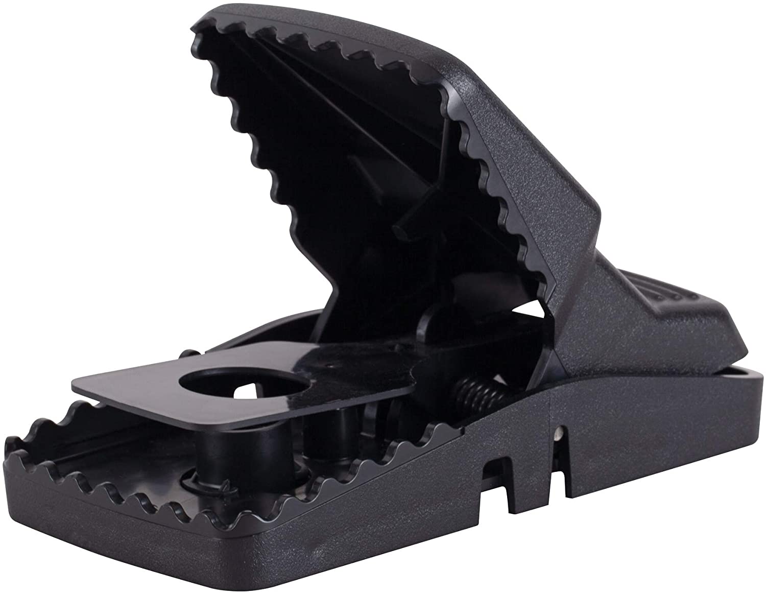

Red squirrels will live like mice, invade similar spaces, stow similar snacks, might even chew off a wire to a fuel injector to gain more room to stash acorns 'neath an upper intake manifold. DAMHIK :laughing: Keep a hood open on parked vehicles as much as possible, it's called the "TBN Trick" by many. ;)
Consider using a few of these, also from Home Depot or TSC. https://www.amazon.com/dp/B012RGM7BO/ref=twister_B07T276CMS?_encoding=UTF8&psc=1
Don't put 'em in the open to invite birds and bait 'em with black oil sunflower seeds for NO ANTS or moldy people-food bait if they may be ignored for days and/or to minimize non-target kills. I confess some of these shown were caught using pieces of hot dog impaled on the trigger wires of 110 connibears but you didn't ask ask about trapping anyway. :) Still, you may get this in a handful of these between New Year's and Spring.

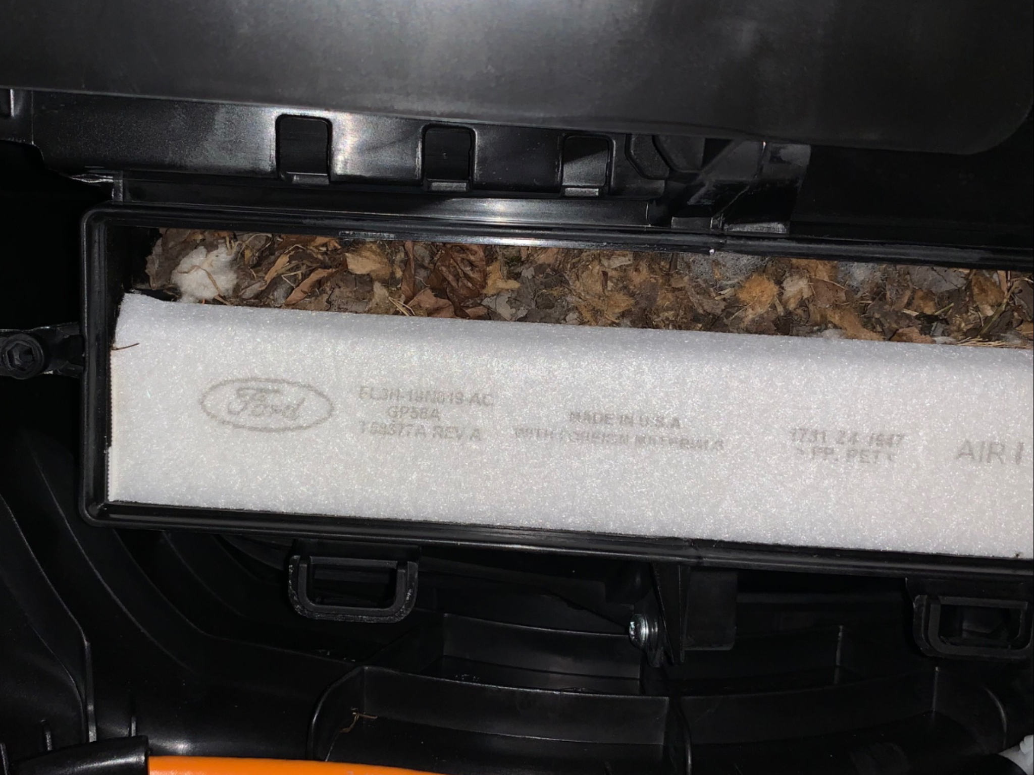

Had some work to do today with the mini x .. got in the truck with the intent to hook up the trailer when I smelt mouse..again. ..it was just a couple months ago when I posted last on this thread. And I changed the cabin air filter then..then again today..they got in and built another nest on top of the air filter. .. the truck had only been sitting about a week and they took full advantage. .. got that all cleaned and de smelled.. then got in the mini.... more mouse smell...they actare my gloves that were in the minis cab. Fortunately no nest, just a matter of degreaser and power wash to get rid of the mouse **** and smell. .. things are relentless.
