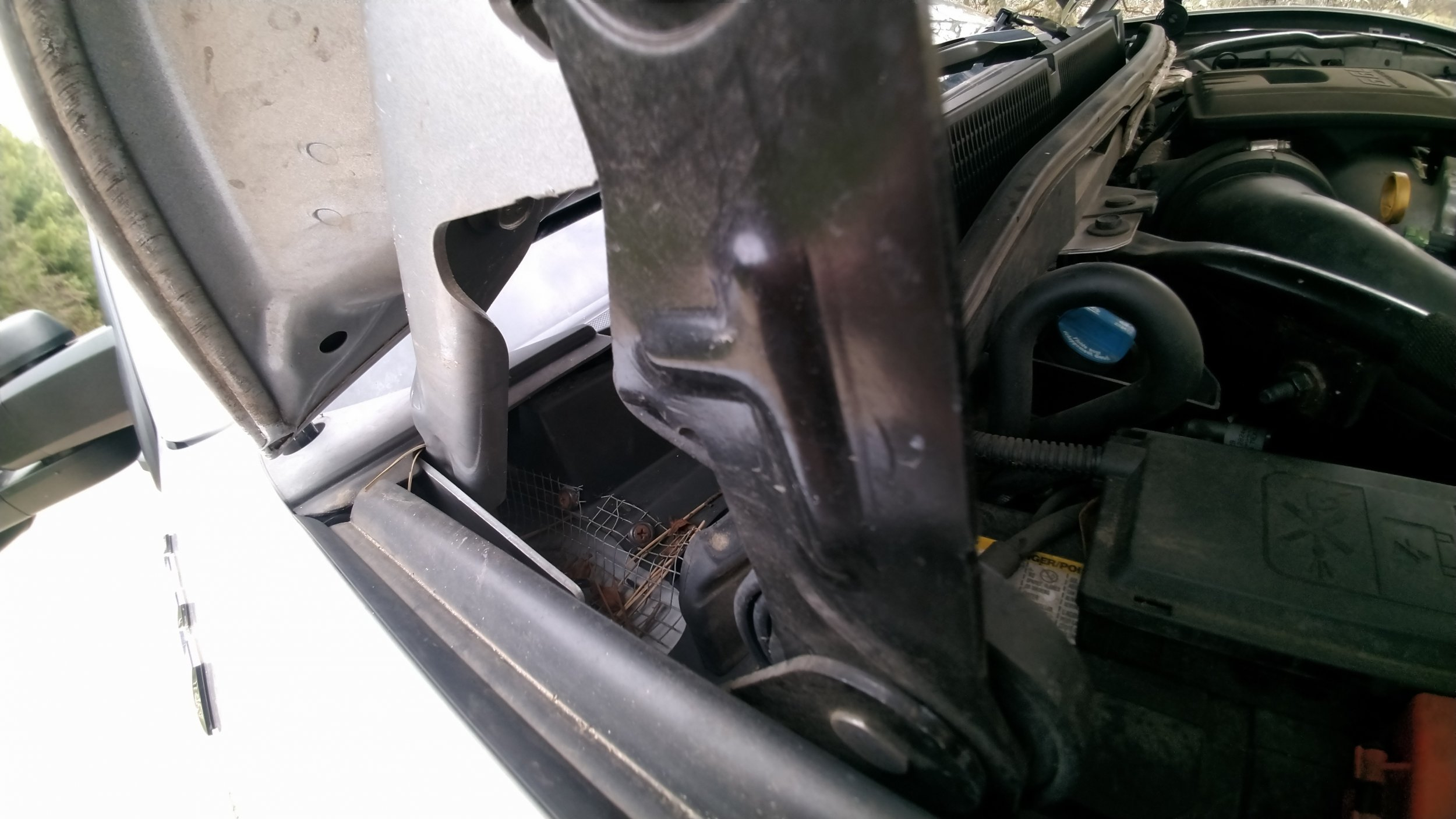

Not trying to hijack but less than a year old 3/4 ton gmc I was hauling old bales of hay. A week later AC was struggling, Mice decided to make a nest in cabin air filter. Ended up pulling apart all floor lining, and entire dash to rid myself of them. According to a GM shop they probably got in on sides of intake to cabin air filter so I put this mesh on both sides and below that is copper based steel wool 5 yrs later no more unwanted passengers.
