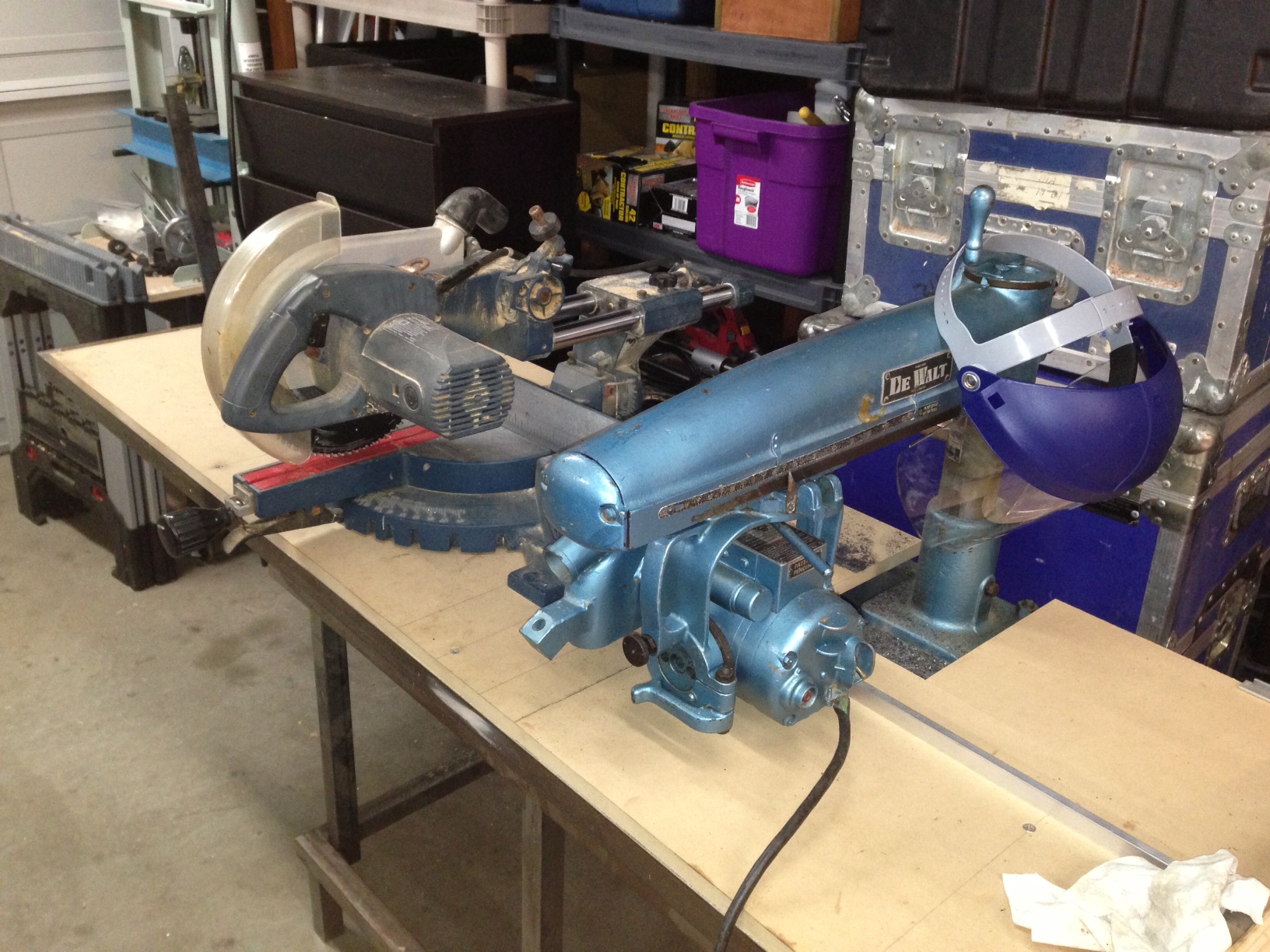

Before closing this chapter, there is a question that has puzzled me for years and I never found anyone with a good answer. Based on the conversation we just had, the TBN community might be just the right group to ask.
Both sliding miter saws and radial arm saws use crosscut blades with low to negative hook. So, same blade.
Here is a picture of the two machines side by side.
If I go to the machine on the left, hold a piece of wood against the fence with my left hand, and push the motor head through the work with my right hand, my technique is good.
But if I go to the machine on the right, hold a piece of wood against the fence with my left hand, and push the motor head through the work with my right hand, my technique is bad.

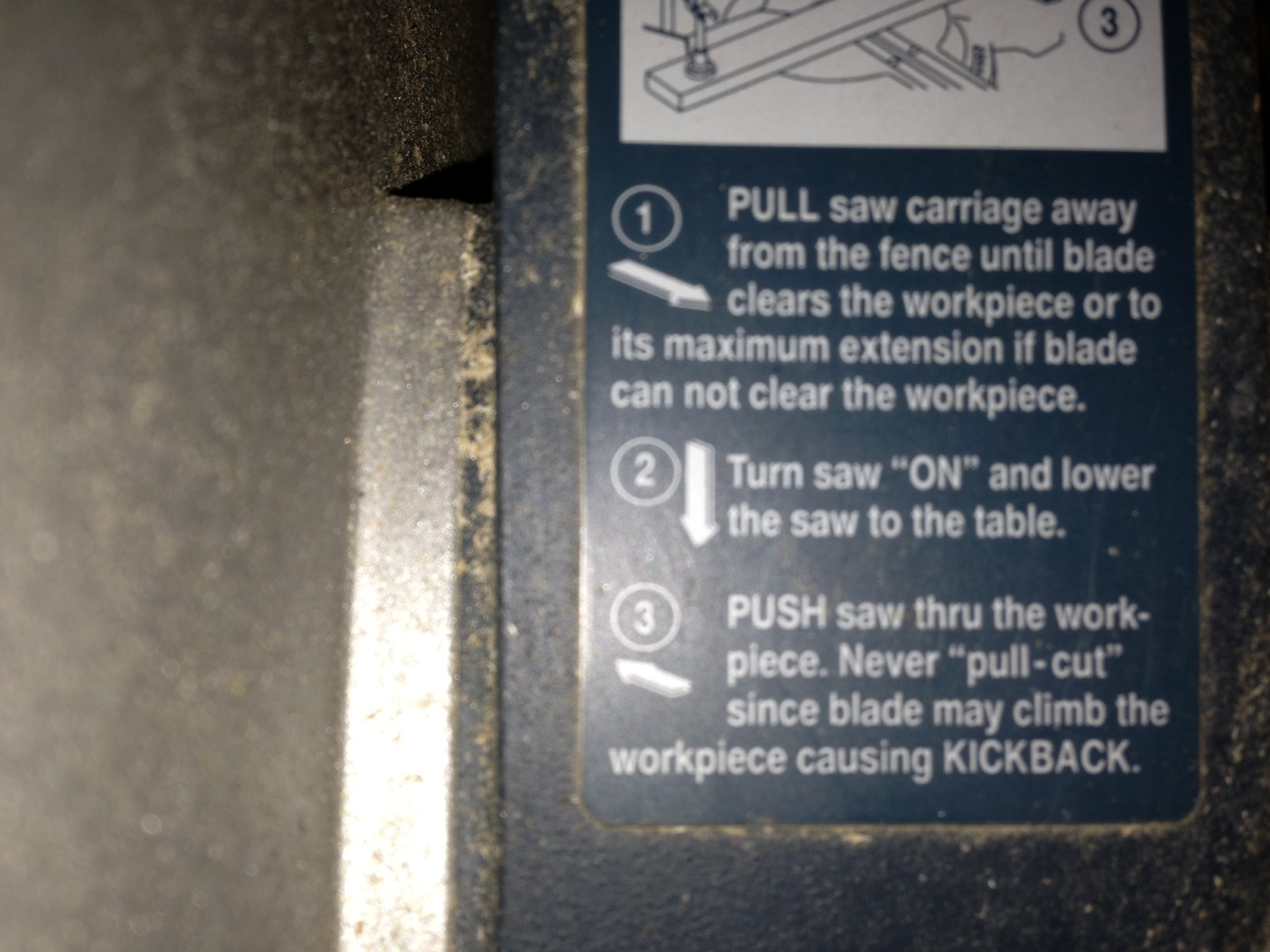

We know the instructions for radial arm saws say, always pull through the work.
The Bosch of course says just the opposite:
So the question is, why is pushing good form on the miter saw but bad form on the radial arm saw? :confused:

Pat, I'll give this a shot - let's assume a pretty wide board in each case, since that's where more of the differences lie.
Chop saw - You start off with the blade ABOVE the surface of the board, so initially there would be a DOWN pressure on the board along with the blade pushing INTO the fence. Once the blade has plunged thru the board at the outer edge, the force would be trying to LIFT the board at the outer edge but still PUSHING it toward the fence.
A good hold-down would help control this, but I've yet to see a saw that offers a MOVABLE hold-down that can be located at the FRONT of the cut, where the lift is more pronounced. So YOU need to be that hold-down.
Lift force doesn't seem to be so drastic that this isn't doable. Board width is limited to about 12-14 inches, even on the 12" saws - I have two chop saws, a 10" Hitachi and the 12" Dewalt slider.
Radial Saw - You adjust the blade depth BEFORE you start the cut, and there's no SAFE way to CHANGE that during the cut, because you're using BOTH hands - one to control the saw, and the other to hold the work piece.
This means that, if you PUSH cut, the blade must be all the way toward you so there's enough room to get the work piece between the fence and the blade, WITHOUT the blade in contact with ANYTHING until the cut has started.
Sooo, if you PUSH cut with the RAS, you will START with maximum UP force (with some force toward the fence), giving the work piece the most chance of being LIFTED by the blade - especially if you get impatient.
Keeping the saw BEHIND the fence keeps the blade further away when the saw is started, makes sure the piece is NEVER subjected to lifting force, instead it's ALWAYS being pushed DOWN and BACK.
In the event that you use the prescribed method and DO get impatient, the blade will try to climb the piece and "take a run at you" - I've had this happen a time or two over the years, and it has NEVER MADE IT THAT FAR - I guess if you were cutting stuff thinner than maybe 1/2 inch that it COULD happen - but normally it just stalls the saw and "wakes you up" that you were getting too impatient.
That last part is probably NOT true of the fire breathing, TRUE CONTRACTOR saws with maybe 5 horse motors - they most likely COULD overcome the resistance when the operator gets in a hurry and the saw tries to climb the work - and since contractors are pretty much ALWAYS in a hurry, I can see where some of the stigma on RAS's probably came from.
Another minor plus for the RAS - marking. IF you have the saw properly aligned, you can set the miter to zero degrees, park it behind the fence, make ONE LITTLE TIC MARK on your piece, and with your fingers NOWHERE NEAR THE POWER SWITCH, pull the saw forward til you can align one left-leaning tooth with your tic mark, then push the saw back CLEAR of the work, power on, hold the board against the fence, and pull thru the cut.
If you've done everything right and the saw is aligned properly, you should have a perfectly square cut.
Try that with a chop saw, whether fixed or slider - good luck finding the right distance from the edge of your board so you can line up the left-leaning tooth that's actually in CONTACT with the board to get away with just a tic mark. I've done it, but it's always a guess unless you're **** enough to make some sort of jig to mark your boards with. Of course, if you're just using your chop saw for framing, close enough is a lot easier than if you're doing cabinet work.
I've looked at a few lasers, and wasn't impressed. Marketers will put a laser on a DONUT if they think it'll sell more donuts.
Recently I saw a possible exception to this - DeWalt has a "shadow" type dual laser on the new 12" sliders, appears to be retrofittable to older 12" saws. Don't know much about it yet but sounds like it might eliminate the laser-blade alignment issues most of them seem to have.
There's probably more that could be said (and I'm sure it will :rolleyes: ) but this is getting long enough already... Steve

A radial saw, at beginning of cut if pushed, uses up most of its travel, aside from that, the teeth lift the edge of the board. Once it lifts off the table, its about impossible to control. A sliding saw is lowered into the board the teeth push the board toward the fence. Like a chain saw, a circular saw doesn't kick until teeth stop severing wood fiber and stick in the wood. This is why big chain saws are less likely to kick than smaller saws. Extra power keeps the chain moving at speed through the wood, saws with less power can't maintain speed allowing teeth to stick to fibers. If the tooth is stuck in the wood and the chain keeps moving, an equal but opposite reaction occurs the bar is thrust up toward the operators face.
