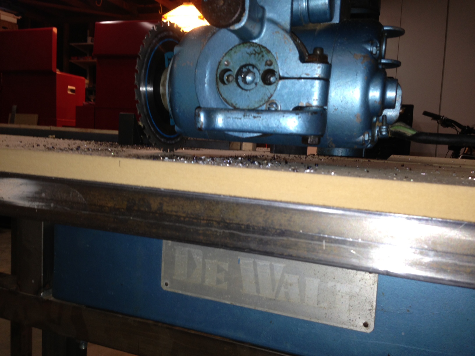

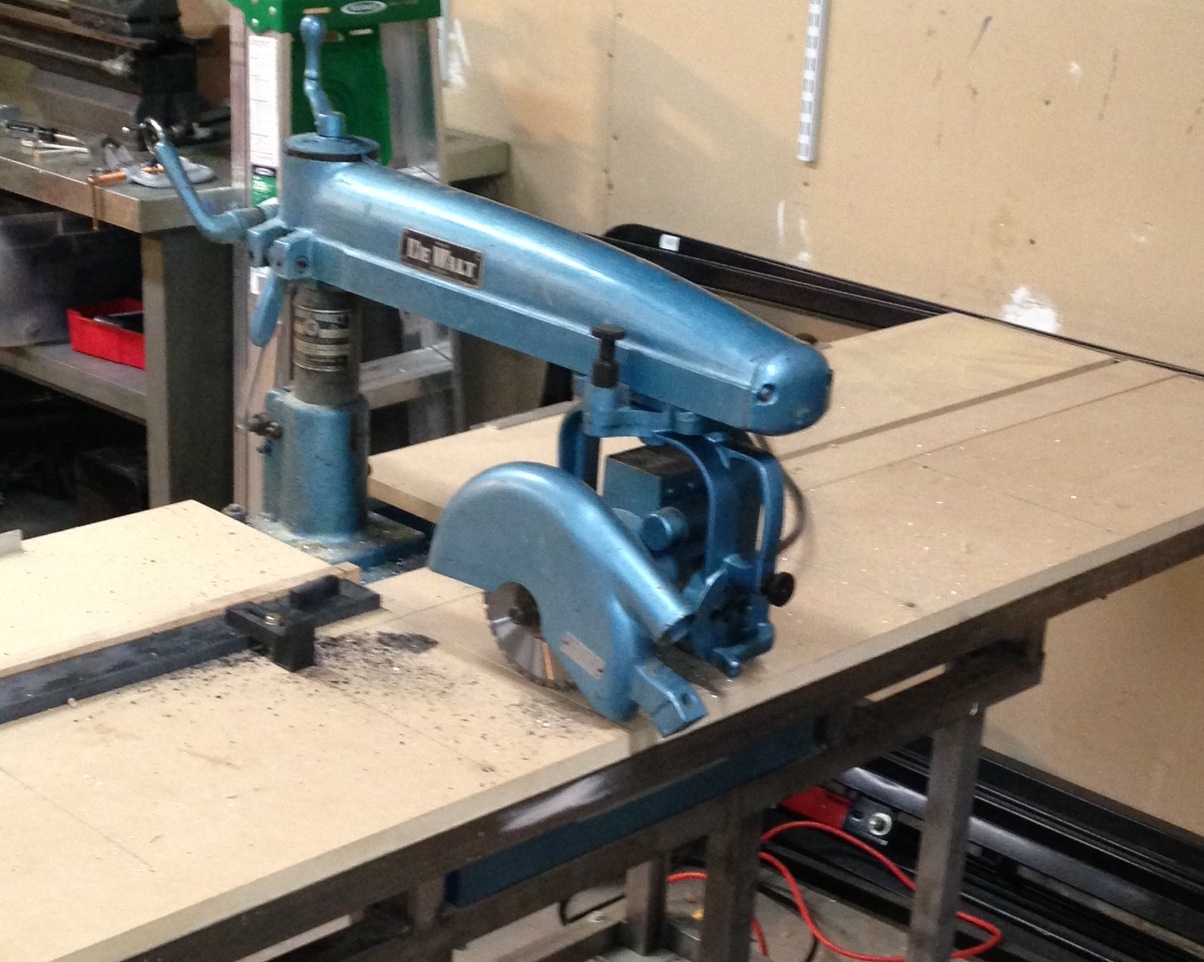

I've been using a Makita cordless metal saw (5 3/8") for a while, it works great. Clamp a speed square to run against and get a good cut every time. But I wanted a setup similar to a sliding miter saw, to make repetitive accurate square cuts on fairly wide stock without a lot of setup. Didn't see anything on the market. Wood cutting miter saws spin too fast. Dedicated 14" metal saws such as the Makita and Milwaukee are limited to about 4 1/2" width of cut. And costly. Same goes for horizontal bandsaws. I did see one metal cutting miter saw advertised, but it was a bit pricy and I couldn't find one to look at. Didn't want to buy it sight unseen, especially since it didn't seem to have a sturdy clamping mechanism. I have a Makita 14" abrasive saw, which is fine for many purposes, but it is noisy, dirty, hot, and none too accurate.
I used to have an old MBC DeWalt radial arm saw, but gave it away a long time ago, shortly after I bought my first sliding miter saw. The miter saw was a lot more useful for the work I was doing at the time. After considerable thought I decided the DeWalt would have made a decent metal cutting saw. The motor turns at about 3400 rpm vs 3600 for the Makita cordless. It is built very well and has adjustments for everything. It has a 5/8" arbor so could use the Makita or other modern metal cutting saw blades. It took a while but I found a 1952 DeWalt MBC in the back room of a theater production company, used for making sets. It is on a nice 9 ft welded stainless steel table, perfect for my intended use. Everything was out of adjustment and sloppy, and the ways hadn't been cleaned for years, so it didnt cut at all well and nobody wanted to use it. But it was essentially in new condition. I don't know if the old DeWalts could ever wear out in normal use. Anyway I got the saw and table for $120. About the price of a tank of gas. After cleaning and adjustment, and with a good Freud blade, it makes glass-like perfectly square cuts in pine and hardwood.

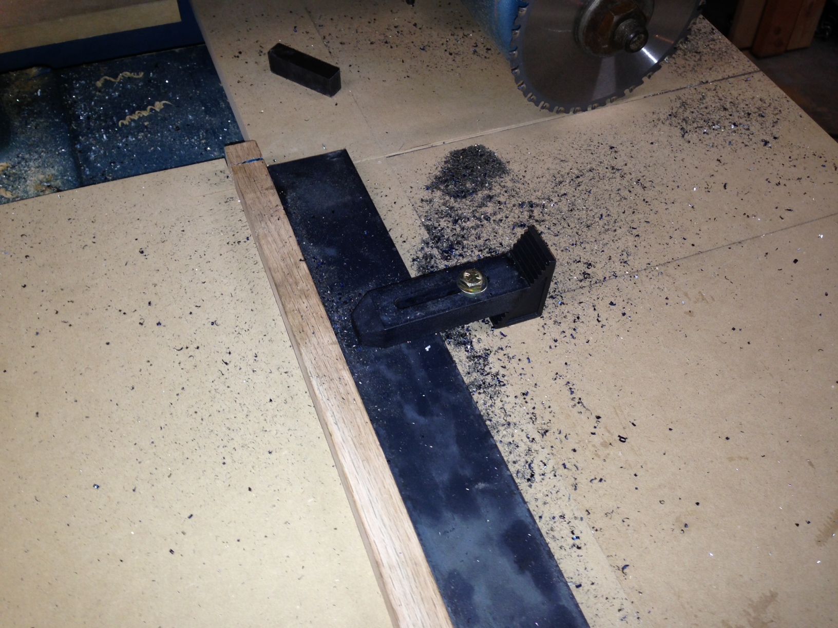

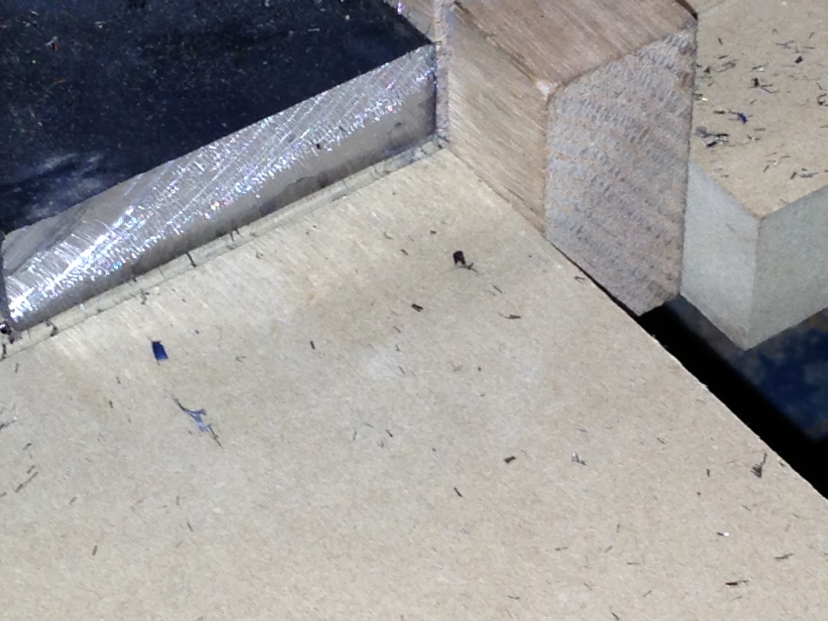

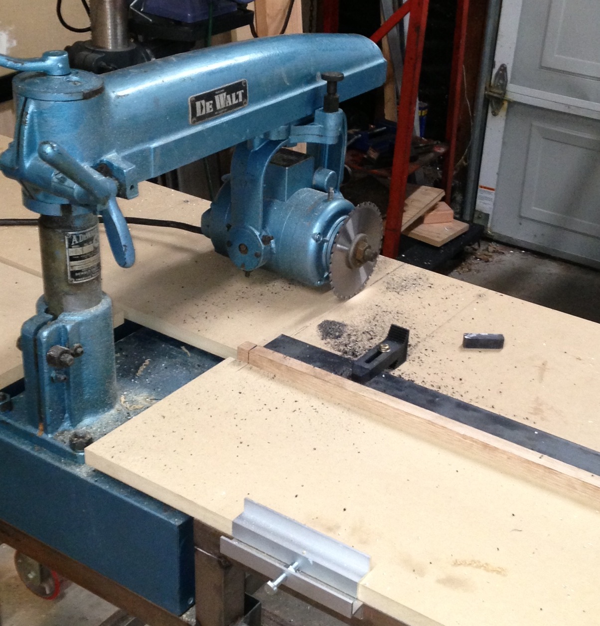

I made a few changes to set it up for metal cutting. These are shown in the pictures. First a continuous sheet of good quality 3/4" MDF, screwed to the metal frame to make the front table. Second, a strong clamping arrangement at the back of the saw to hold the back table and fence solidly. Third, an arrangement similar to a milling machine for clamping the work near the blade. The clamping screw goes through the welded metal frame so it does a good job of clamping. The pictures show a length of 1/2" x 4" mild steel. The saw cuts quite smooth and fast, with little vibration, although from the cut it looks like I need to fine-tune the "heel/toe" of the blade a bit. With the 5 3/8" Makita blade the saw has about 7/8" clearance under the motor, plenty for me as I can't imagine needing to cut steel thicker than 1/2". The Makita blade is very thin, minimizing chips. The chips seem to stay on the table for the most part although I will fabricate some kind of collector.
I'm posting this because I have read a fair number of threads on cutting metal. This is an option that I haven't seen written up, although I am sure I am not the only one to give it a try.

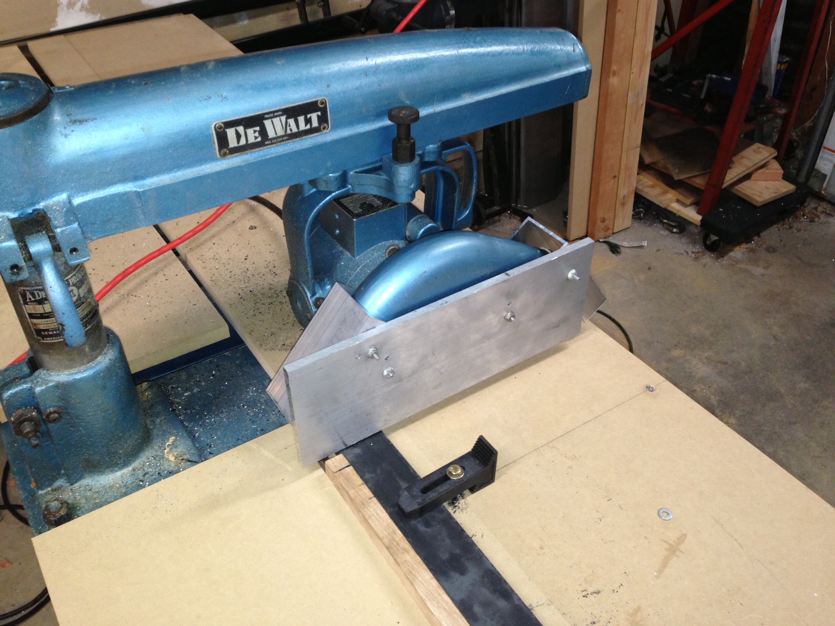

On the guard, yes I use it. I have been using wood saws of every description much of my working life and still have all original parts in decent condition. Saw safety for me is Rule 1, 2 and 3. For this application, now that I now it works, I will make a full shroud to contain chips and possible loose teeth.

Another point on saw setup. Radial arm saws were always a bit finicky. All adjustments need to be well snugged up to avoid jumping, chattering, wandering. That goes double for metal cutting. I set it up a bit tighter than I would have for wood. For anyone considering this application I would recommend Jon Eakes book. He provides detailed setup instructions and photographs for DeWalt, Rockwell, and Craftsman radial arm saws. It costs about $15 on his website and is worth every penny. Radial Arm Saws

Very true. Keeping the material locked down tight is important. One of the pictures shows the milling machine clamp I use. Tightening up all the adjustments of the saw also important. No movement in the material, no movement in the saw. Then a slow steady cut into the material.

Here is an update showing the blade shroud I put together this morning. An aluminum plate covers the open operator side of the guard. It is carried on studs attached to the original guard. The studs make use of existing 10-32 threaded holes probably intended for a lower guard of some kind. The shroud can be adjusted up and down and rotated to suit the work. The side plate carries two guard extensions front and rear, made from aluminum channel. They can also be adjusted to suit the work. With the shroud in place, chips stay under the shroud or go out the front. A few drop out the back at low speed. Now that this essential safety element is in place, I can start to use the saw as planned, for flat wide steel and aluminum. Thanks for various comments focused on safety, I appreciate that.
