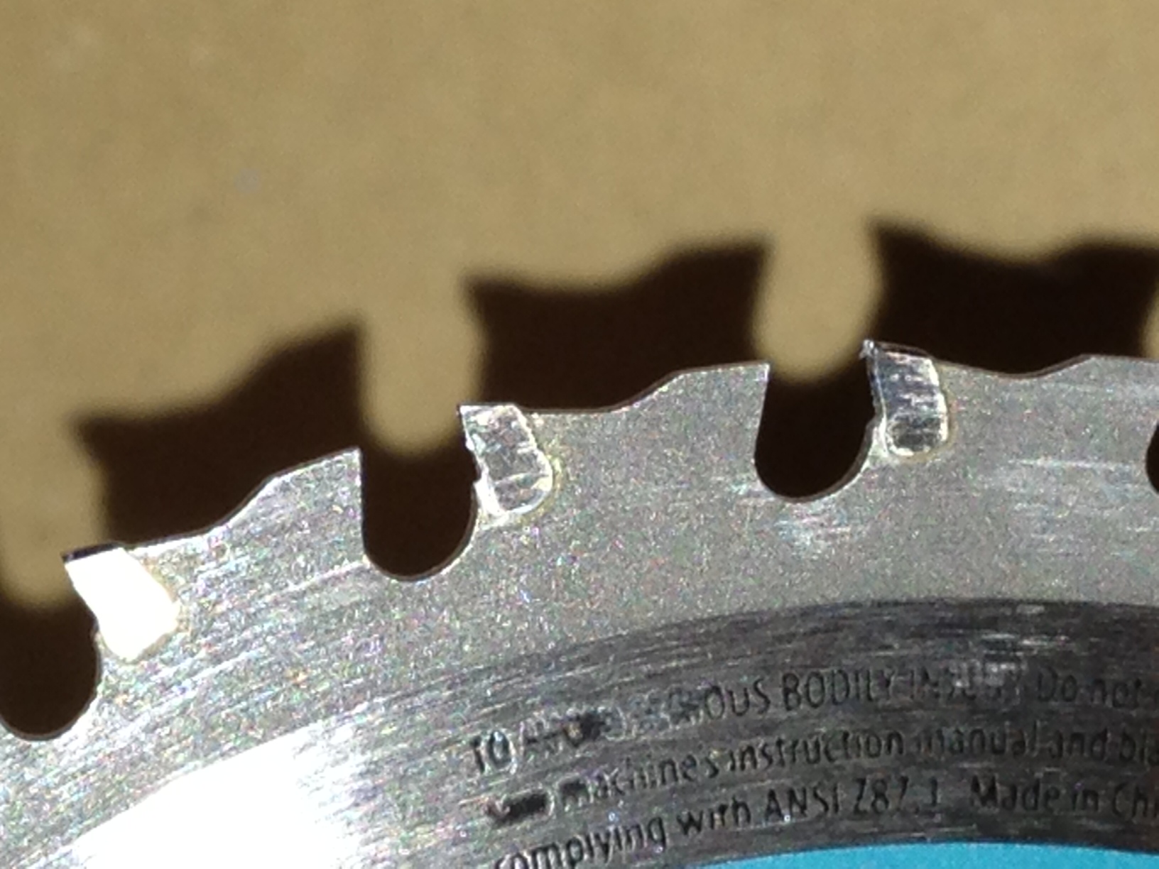

Willie, check the rated rpms on your saw (probably 3600 or so) vs. the rated max rpm of the blade you're looking at - I've seen a few that are rated at high enough speed for a normal chop or radial saw, but haven't tried 'em to see how long they last.
What I DID do, and it was a success (until it wasn't :=( was to buy a "closeout" blade from Hazard Fraught, it was a 14" carbide tipped "metal cutting" blade - it listed max rpms at around 2400 IIRC, and my abrasive chop saw is 3650 or so - I got stupid, put on my heaviest welding leathers/gloves and face shield, clamped a piece of square tube down, stood with ALL body parts AWAY from the plane the blade runs in, and gave it a shot -
The cut was perfect, no burrs, looked like it had been polished after cutting. Same with the second cut, up thru about the 15th or so (IIRC, it was 2" .095 wall tube) -
Then, it got harder/slower to make each successive cut.
By about #25, it was done. Blade was clearanced out @ $50, so each cut cost me $2.
Typical "cold cut" chop saws like DeWalt, Milwaukee, etc, run at around 1750 rpm and the blades are typically rated at maybe 2000-2500 -
Like I said, I've seen a couple 8-10" blades that are rated at high enough rpm, but they're anywhere from $60 to $100, and I'm not sure I want one bad enough to take the chance it will last.

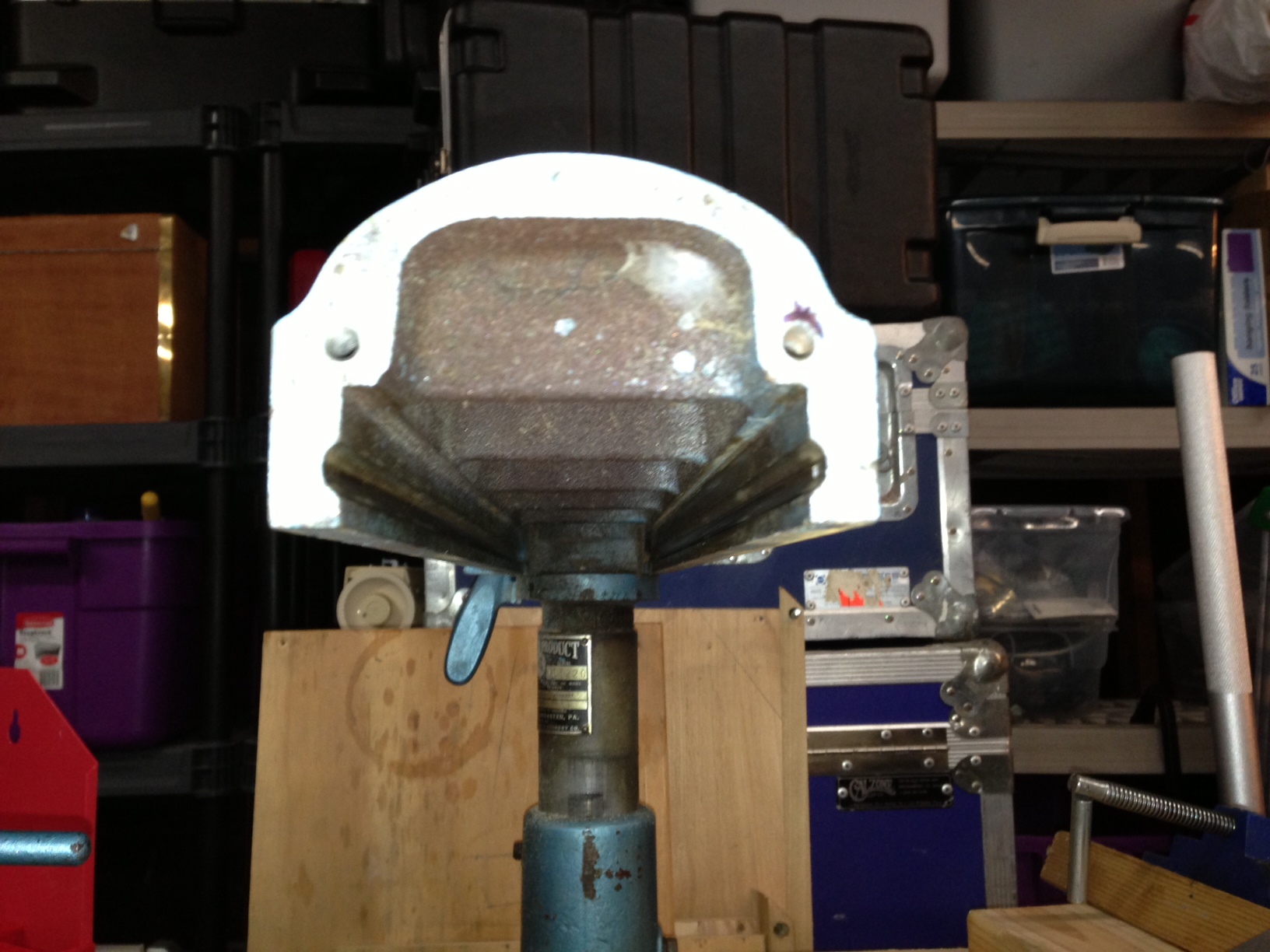

Thats exactly where mine has been for the last several years. I had to climb over a bunch of junk just to take the picture I posted

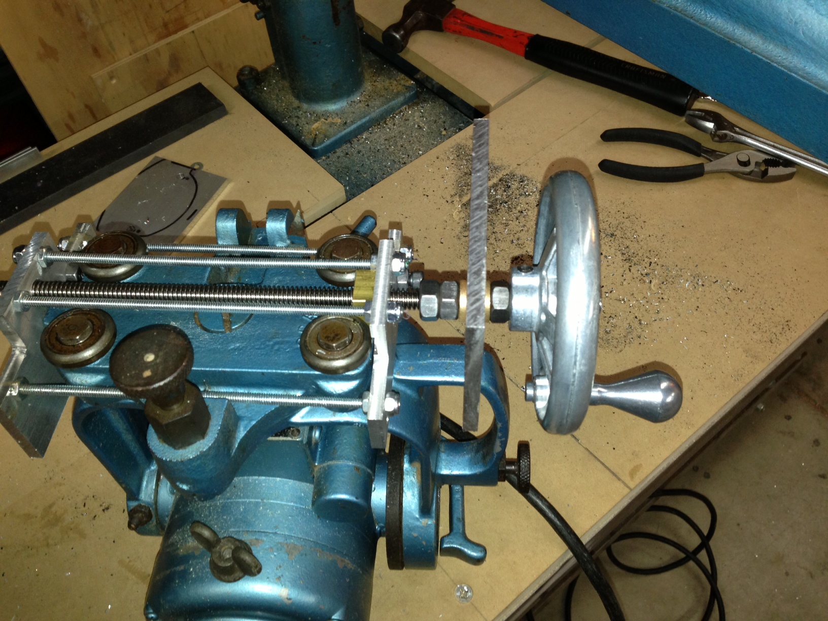

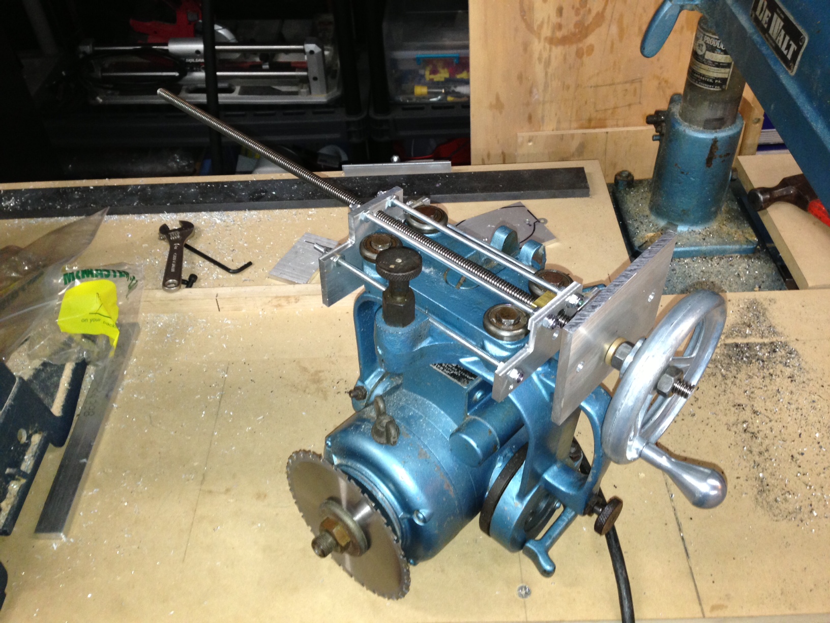

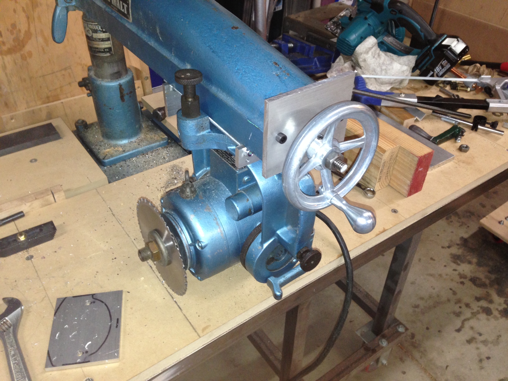

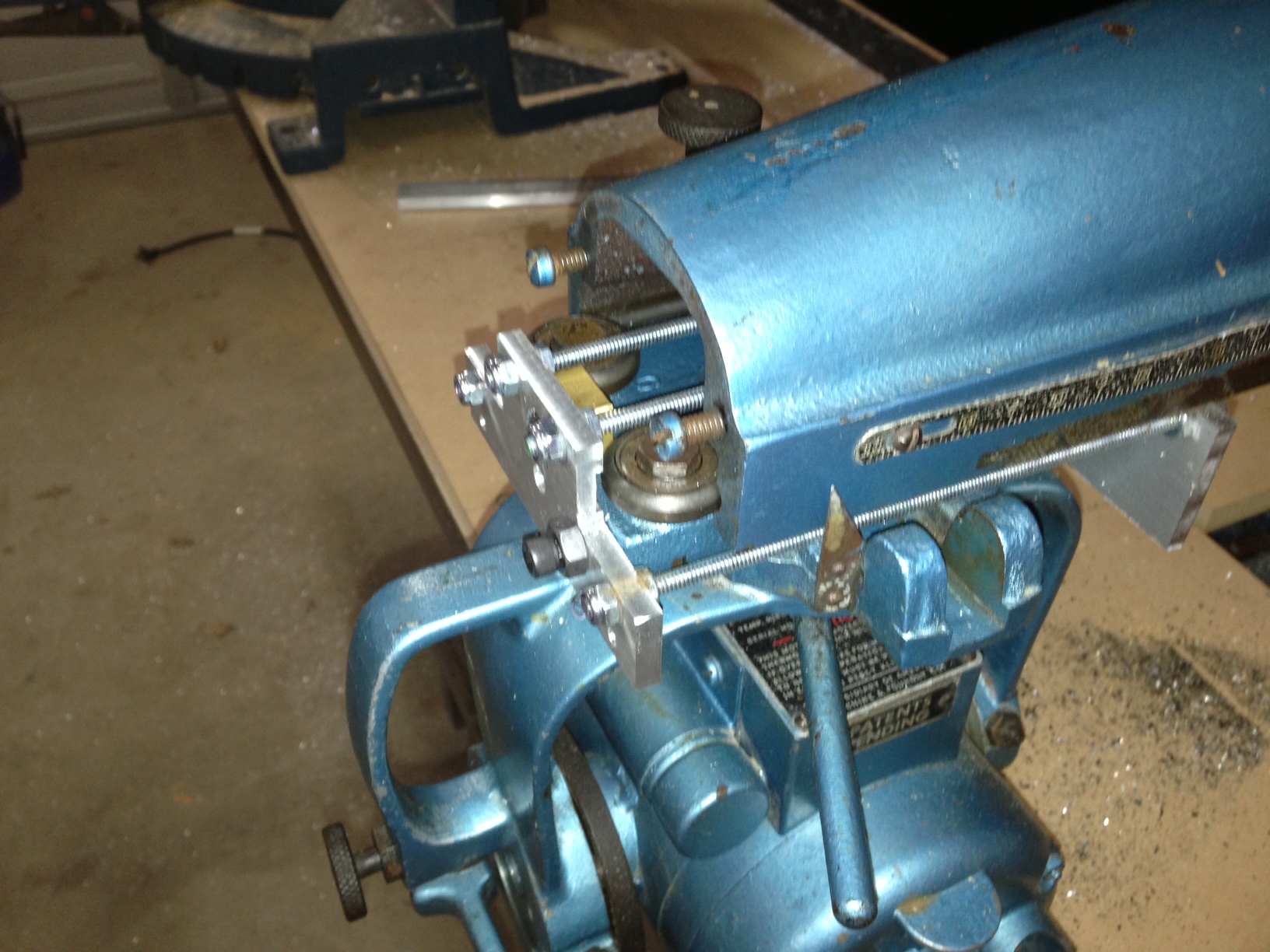

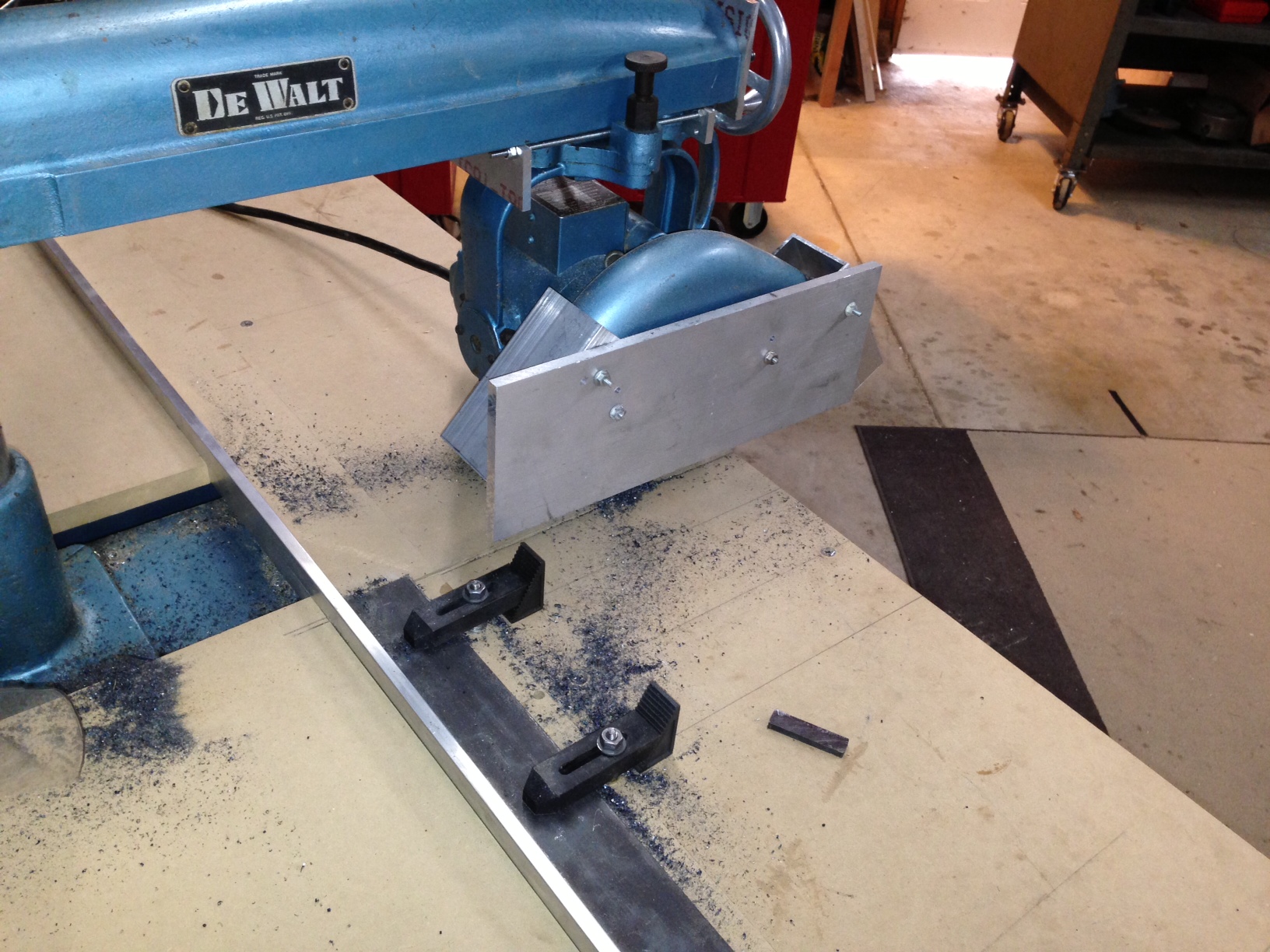

It took longer than I thought to fabricate the lead screw arrangement for the DeWalt metal cutting radial arm saw. There is not much room to work in. So it took a lot of measuring and whittling to get everything in place. The pictures below show what it looks like. It uses a standard 3/8" acme thread lead screw. The hand wheel and lead screw assembly works like a charm - extremely smooth, in fact cutting 1/2 steel feels just like taking a light cut on a milling machine. No jerkiness, grabbing, etc. And your hands are up on top of the saw where the hand wheel is, rather than down on the motor head. No more pushing and pulling within inches of the blade.
To explain the assembly from right to left:
1. jam nut.
2. handwheel with set screw.
3. jam nut.
4. oilite thrust washer.
5. thrust plate (this screws to the front of the cast iron arm in place of the original cover plate).
6. oilite thrust washer.
7. jam nut.
8. jam nut.
9. front guide (this is located by 1 pin and 1 stud using existing holes in the motor yoke).
Also, the front guide carries the 3/8" acme thread lead nut. The front guide and lead nut are pinned together with four #7 tapered pins that are hammered in from the thick end and then peened over on the thin end.
10. rear guide (also located by 1 pin and 1 stud using existing holes).
11. finally, front guide and rear guide are clamped together by four lengths of 10-24 threaded rod with vibration resistant nuts.
When I got started on this I did not foresee making the lead screw assembly, but now see it as an essential part of the modified saw. It provides increased control, quality of cut, and safety.
I need to trim the thrust plate for cosmetic reasons, and make a few other adjustments. Also need to install the upgraded clamping arrangement as previously commented on. The saw already exceeds my expectations with respect to flat cut 1/2 steel which is what I wanted to do. Sometime in the next few days I will go get some square tubing and see how it works on the more complicated cuts suggested by others.
As always I appreciate all comments. In fact it was the safety-oriented comments that got me thinking about making the lead screw assembly.

On JJ's question, I have done it both ways now. With the two milling machine clamps (see picture) to stabilize the work, and the 3/8x12tpi lead screw to stabilize the saw, I don't see a difference in ease of control. That being so, going forward, I will use it the traditional way (pull into work). I agree that is generally accepted RAS practice and also closer to the motion of the metal cutting chop saws.
