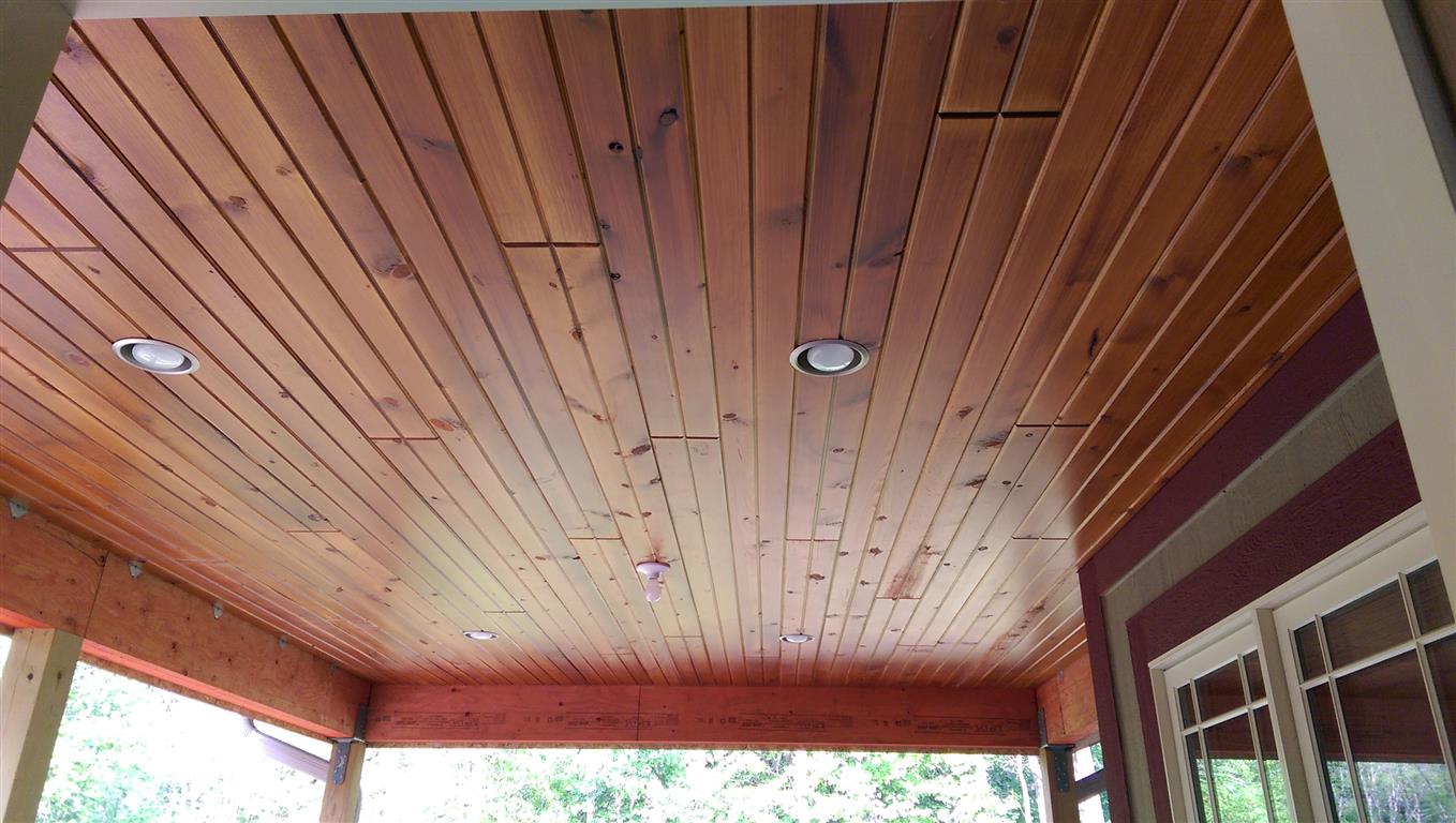

dstig1 whats the finish on the t&g and hows it holding up. Nice job.:thumbsup::drink:

Thanks!
I used Sikkens Cetol Log and Siding in Butternut on the ceiling. The color chip looks light but it comes out quite dark, as you see. All boards were pre-finished flat on sawhorses. I did one coat on the back side and then 2 on the front. Those boards are double wide, so they look like 1x4's but are actually 1x8's with a groove routed in the center to visually match. The ends were also T&G which helps keep everything tight and un-warped. That was almost 5 yrs ago and they still look like new, but of course they are not really exposed in a ceiling.

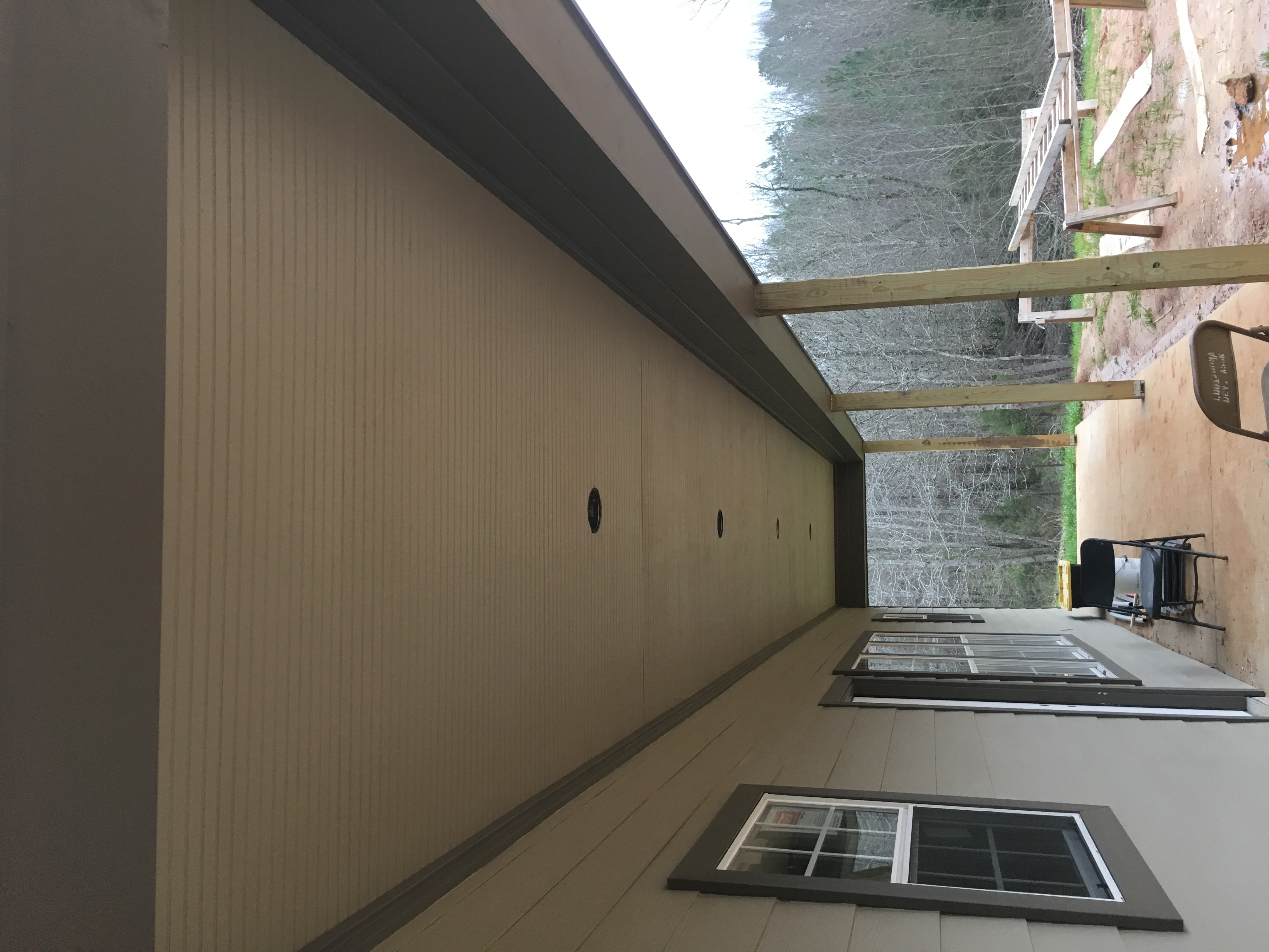

I thought I should update this thread. I finished the porch ceiling on our cabin this weekend. I wound up going with exterior plywood bead board siding. Thanks to all who provided guidance.

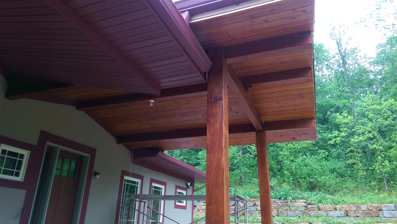

Old houses I have worked on and some new, used doug fir beaded boards about 3x5/8. Clear straight grain. Very nice material. Might not be available these days.
I used same on my porch ceiling, and stained it. Nice looking porch.
