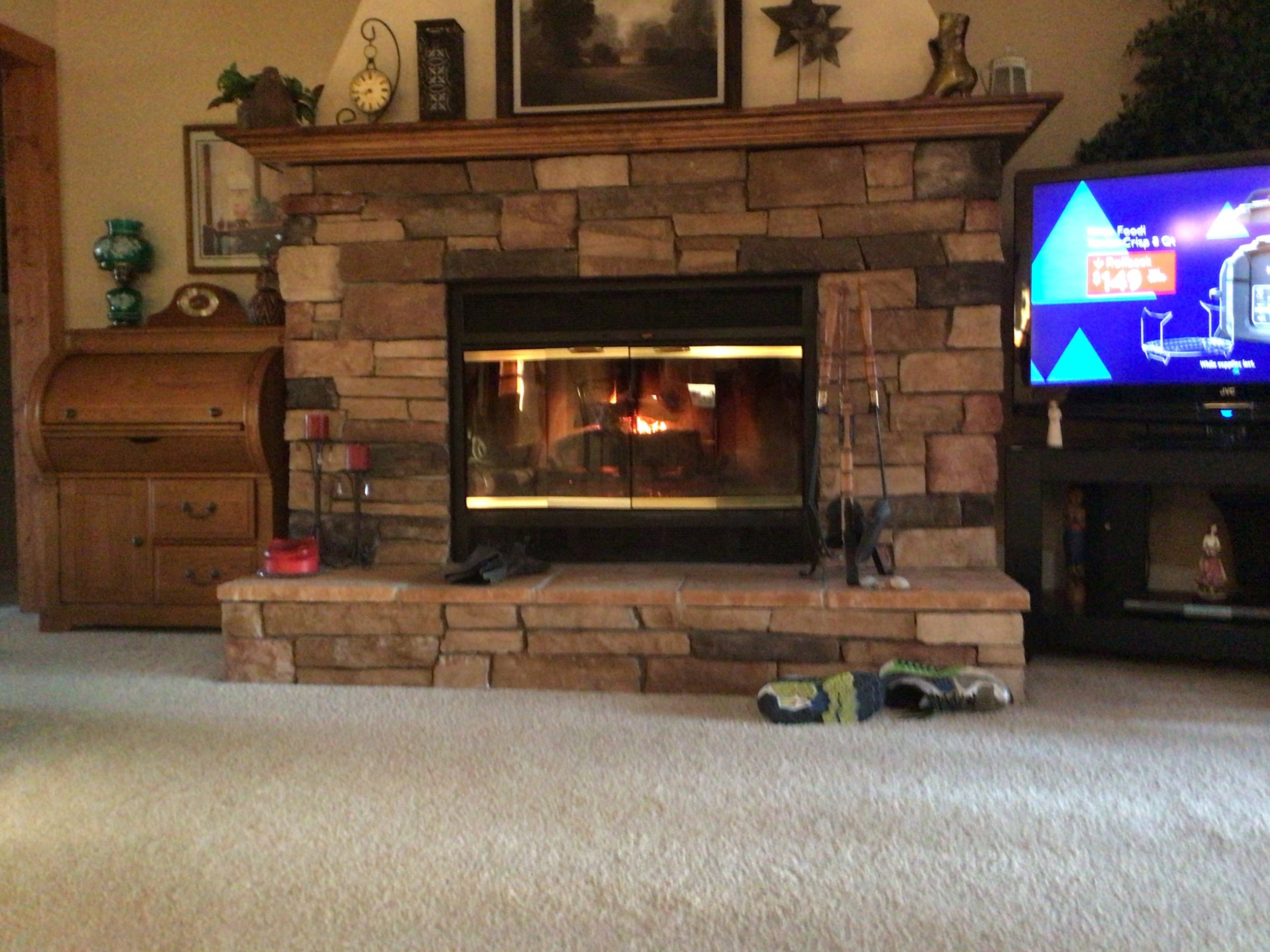

You poor bugger. What a pain you have facing you. In our case, we had the contractor build a chase out of wood, and then use d a wood-burning fireplace insert. Then, we used a fake stone facing on the outside of the fireplace, which looks very good. Inside, we used a stone which just hangs on the wall with clips. Very easy install.

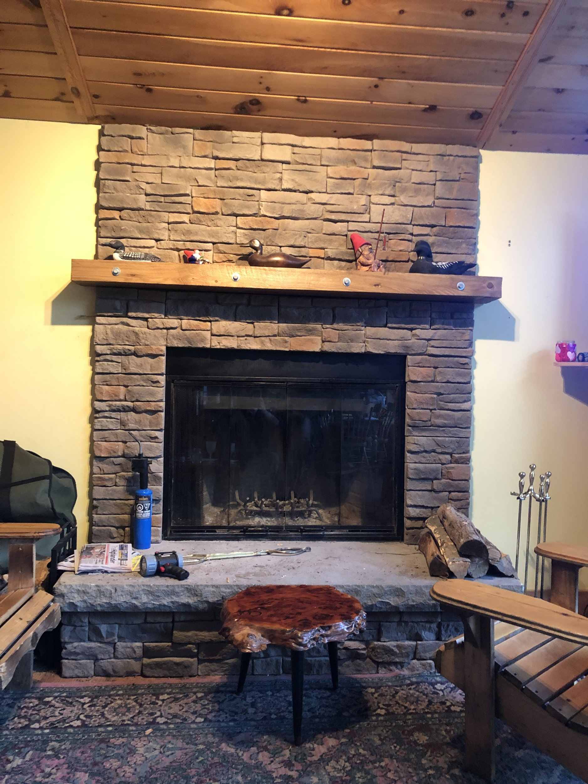

I have a setup very similar to Check. It’s a Vermont Castings insert and a triple wall flu going up to the roof. The stone is what they called cultured stone, it looks real, feels real, but is man made. I don’t know if this setup would be a lot cheaper or not. It’s an option to change the plan or totally bail on the project and sell the materials for what you can.
