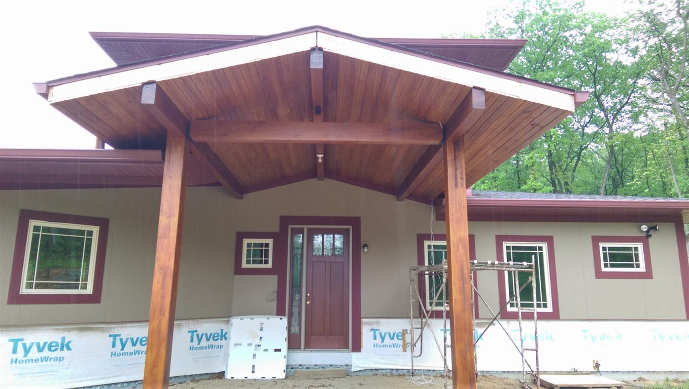

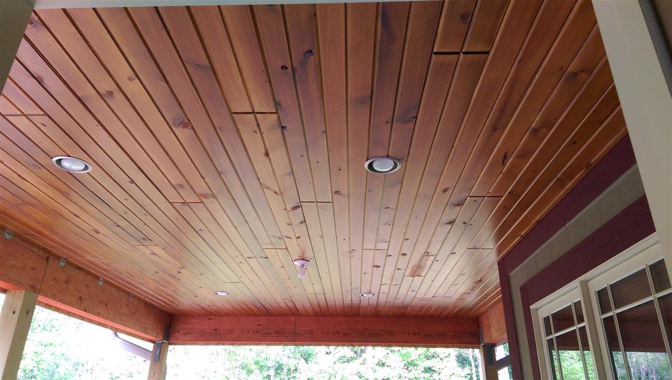

dstig1 whats the finish on the t&g and hows it holding up. Nice job.:thumbsup::drink:

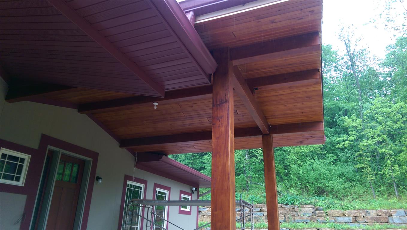

Thanks!
I used Sikkens Cetol Log and Siding in Butternut on the ceiling. The color chip looks light but it comes out quite dark, as you see. All boards were pre-finished flat on sawhorses. I did one coat on the back side and then 2 on the front. Those boards are double wide, so they look like 1x4's but are actually 1x8's with a groove routed in the center to visually match. The ends were also T&G which helps keep everything tight and un-warped. That was almost 5 yrs ago and they still look like new, but of course they are not really exposed in a ceiling.
