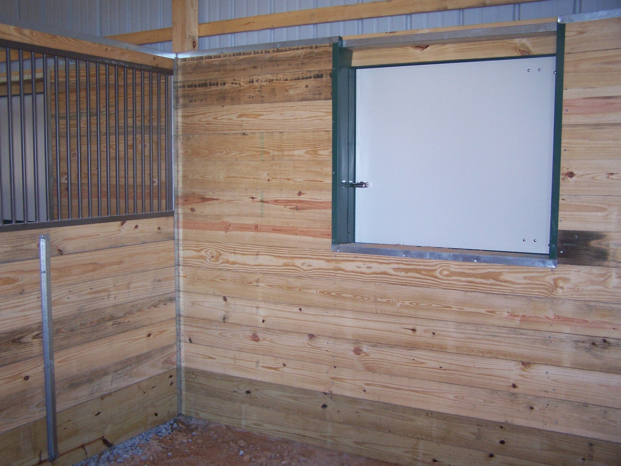

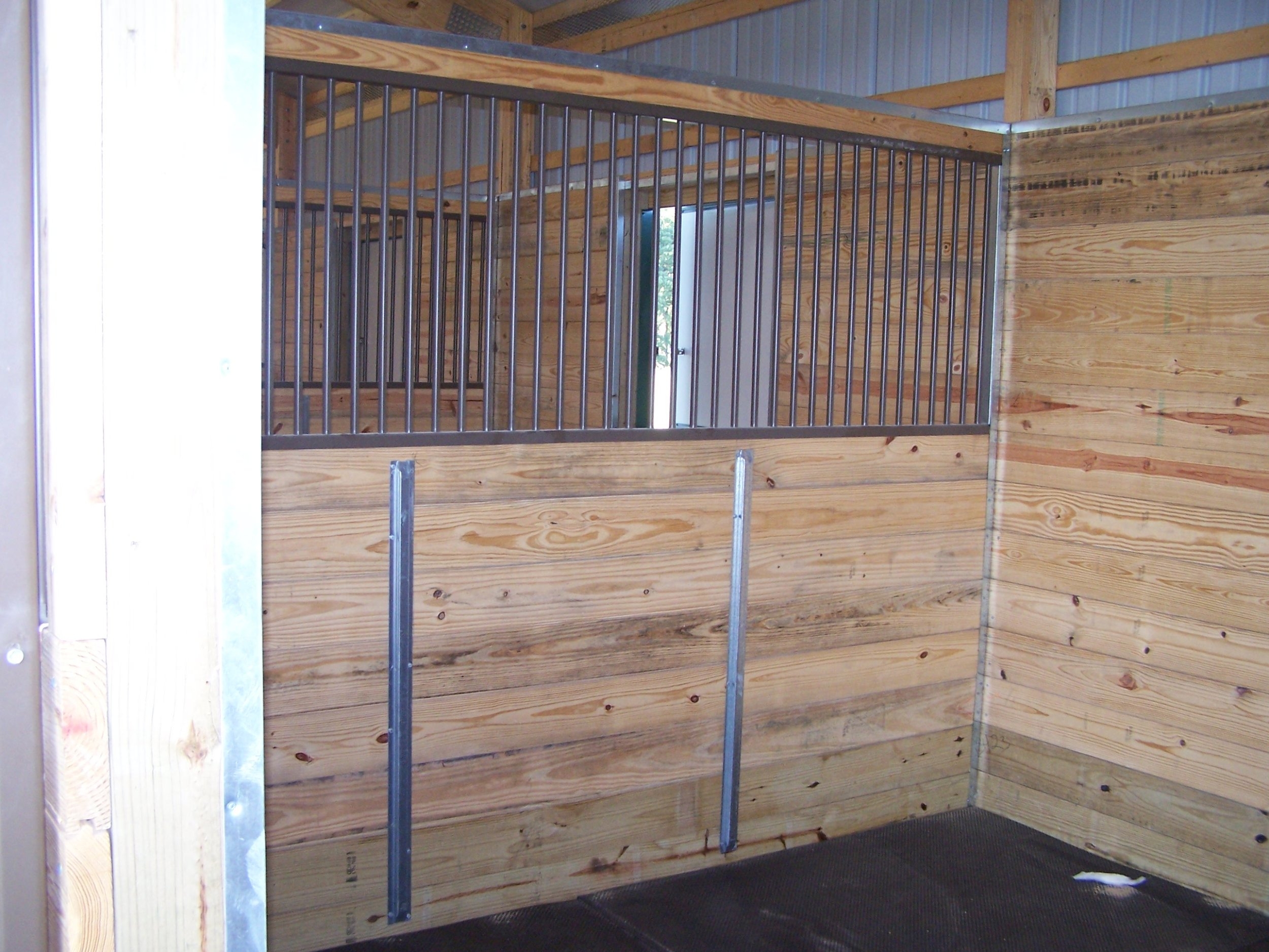

Above that I made the jail cell look but with 2" spacing using 1-1/2" flat strap and 3/8" cold rolled rod. I cut the straps to length and tack welded on the ends to hold in place. Center punched for holes every 2", laid up on the drill press and drilled the holes.
It was a lot of work but bought all of the steel for 4 stalls for less than one pre-made one. I attached a couple of pics to give you a general idea, one including my boy Radar being the camera ham he is. Doesn't look quite as nice 11 years later with all of the Sparrows leaving their mark, but still looks pretty decent.
looks very nice in the pics. I used 1.575” u-channel and 1/2” pipe but I cheated and had my buddy punch out the holes on his ironworker. Definitely cheaper than buying prefab. The u-channel fits the t&g nicely (IMO)
I don’t use rubber mats in stall, ever looked underneath those things after they’ve been used awhile :sick: In my experience, they don’t help with the compaction problems either.
