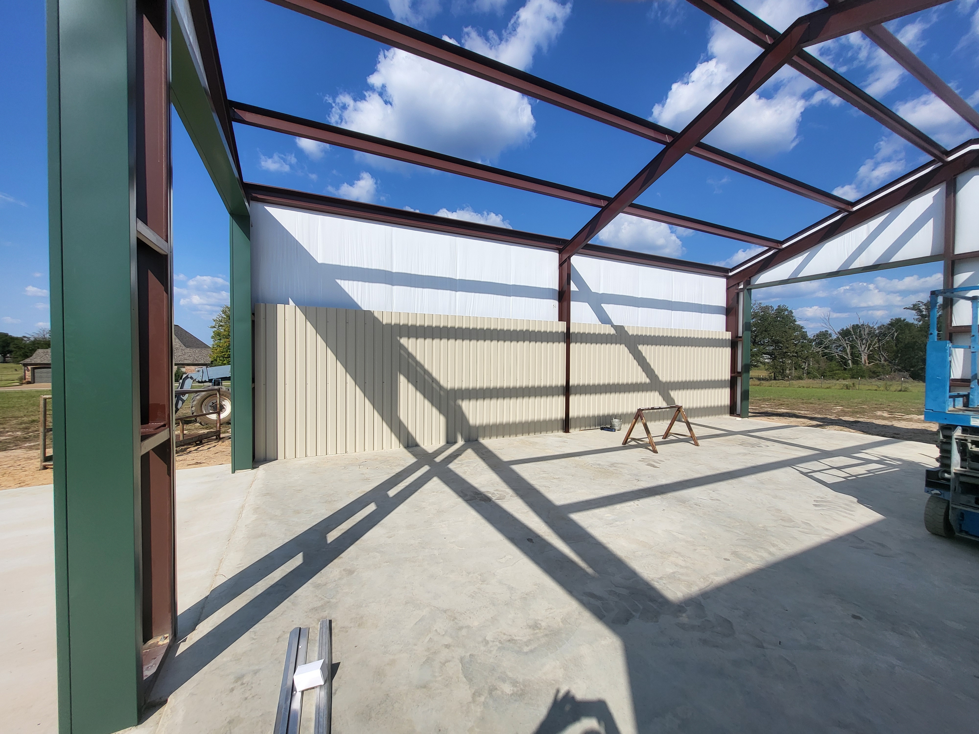

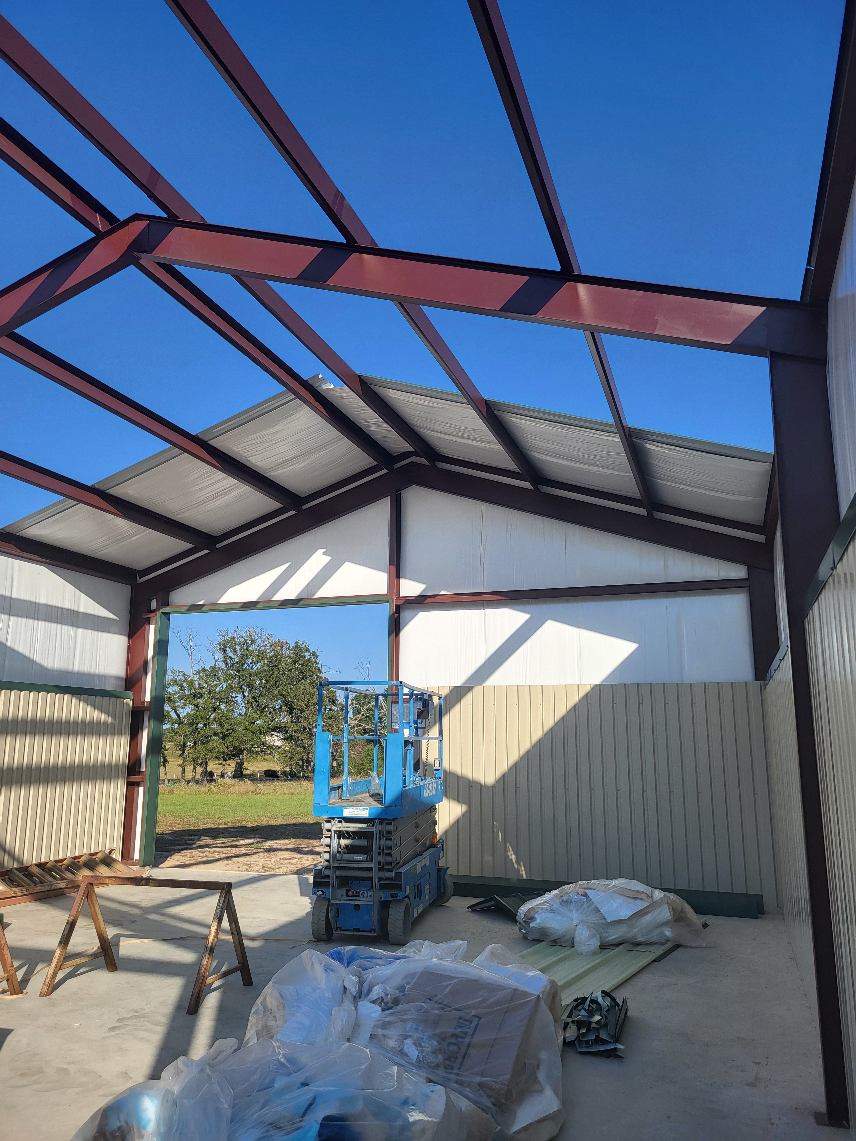

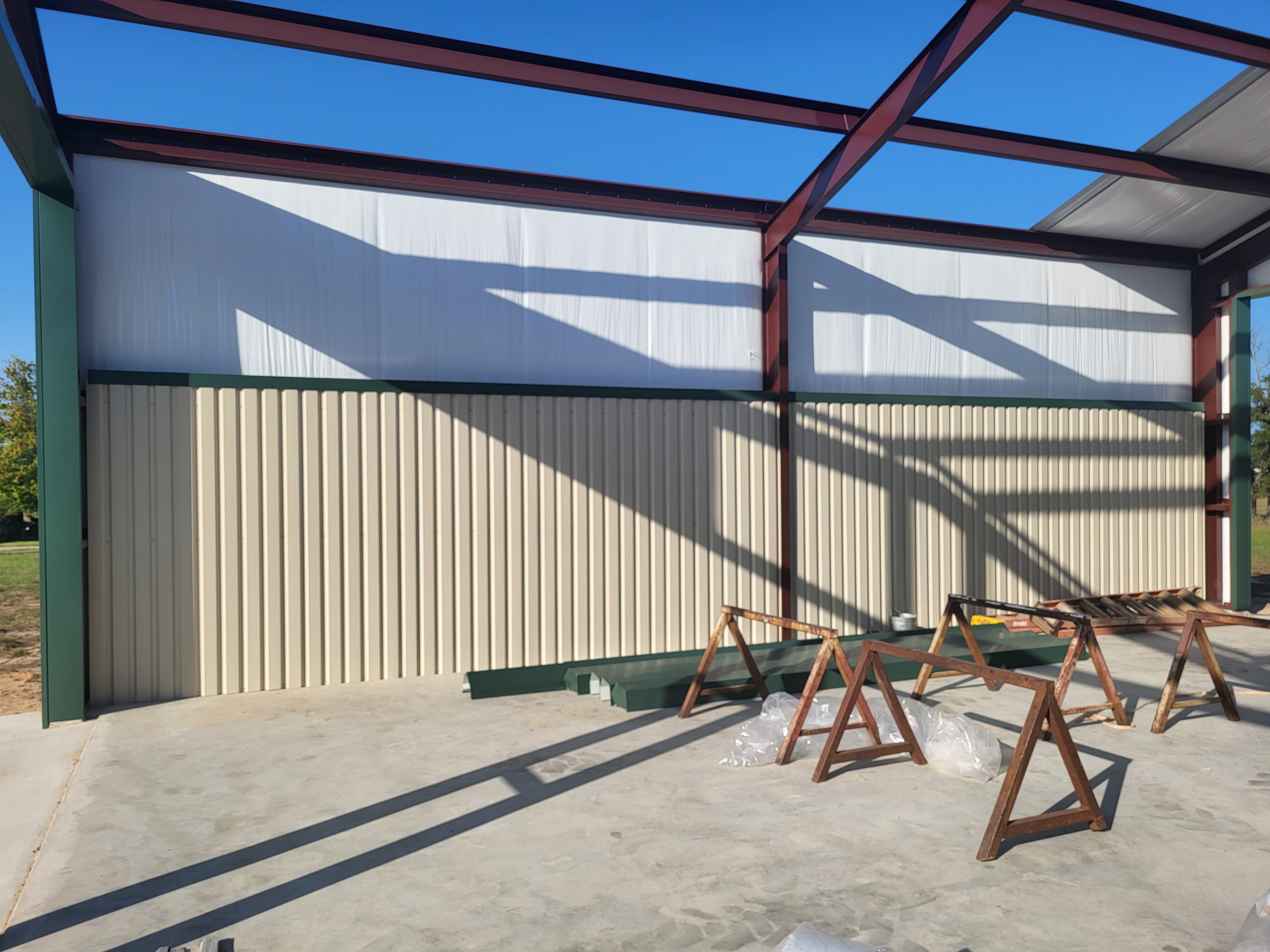

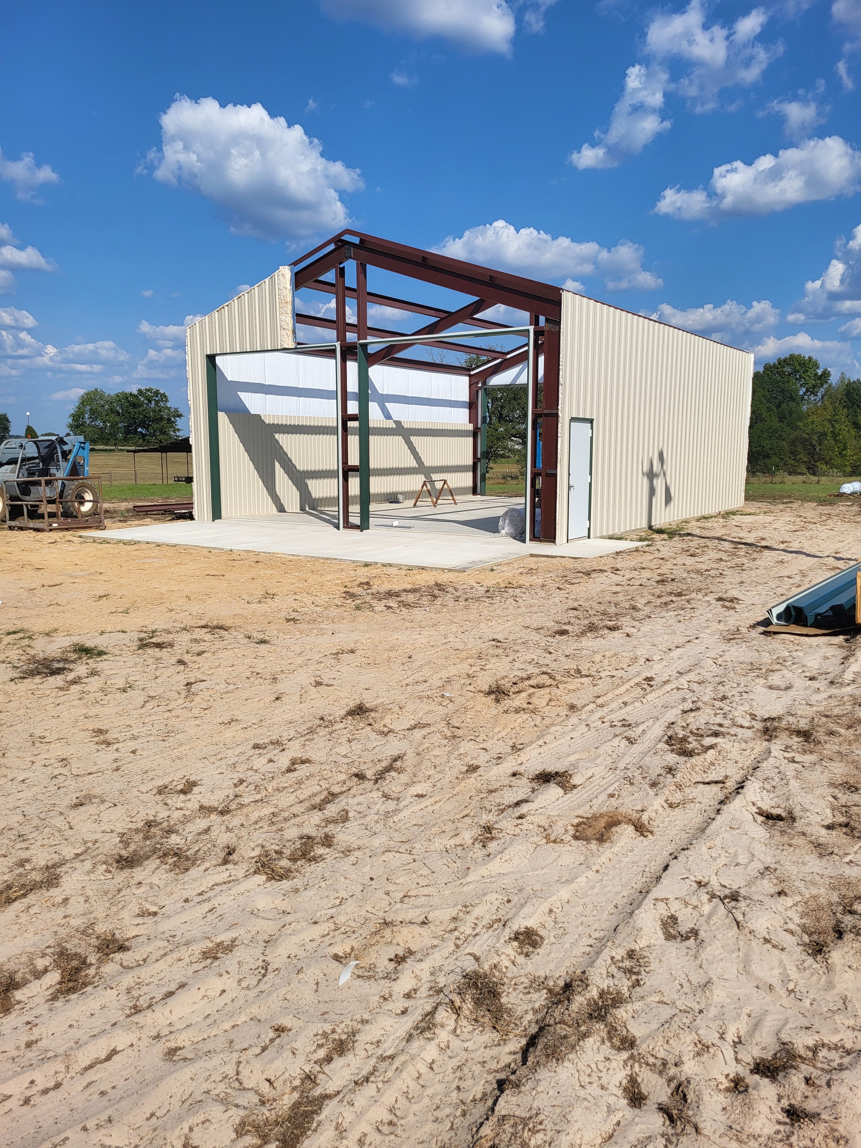

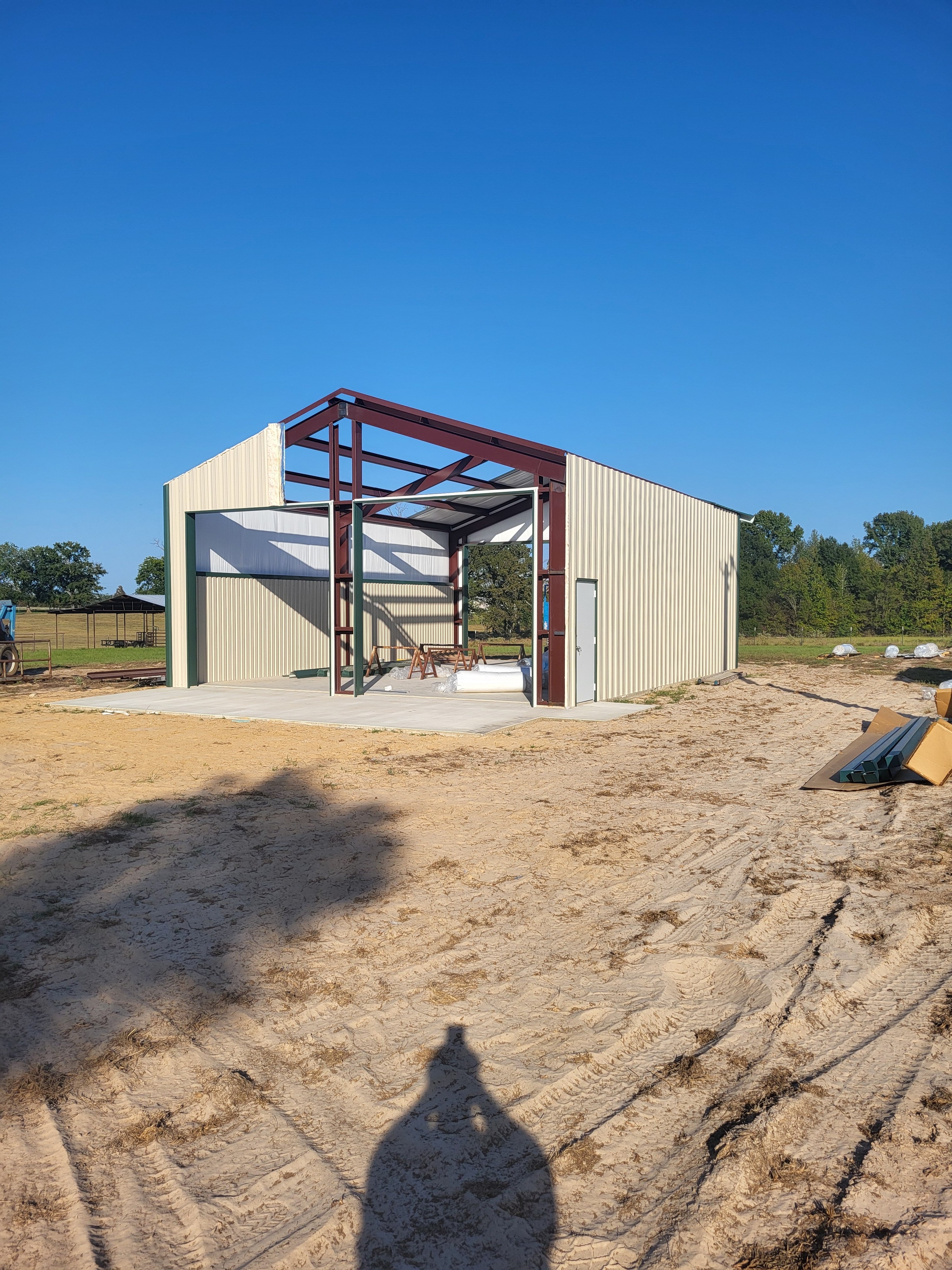

Roof and exterior panels are all up. Still have exterior trim, roof vents, gutters & downspouts, rollup doors, and finish up some interior walls and trim to go. Doesn't look like it will be finished this week.

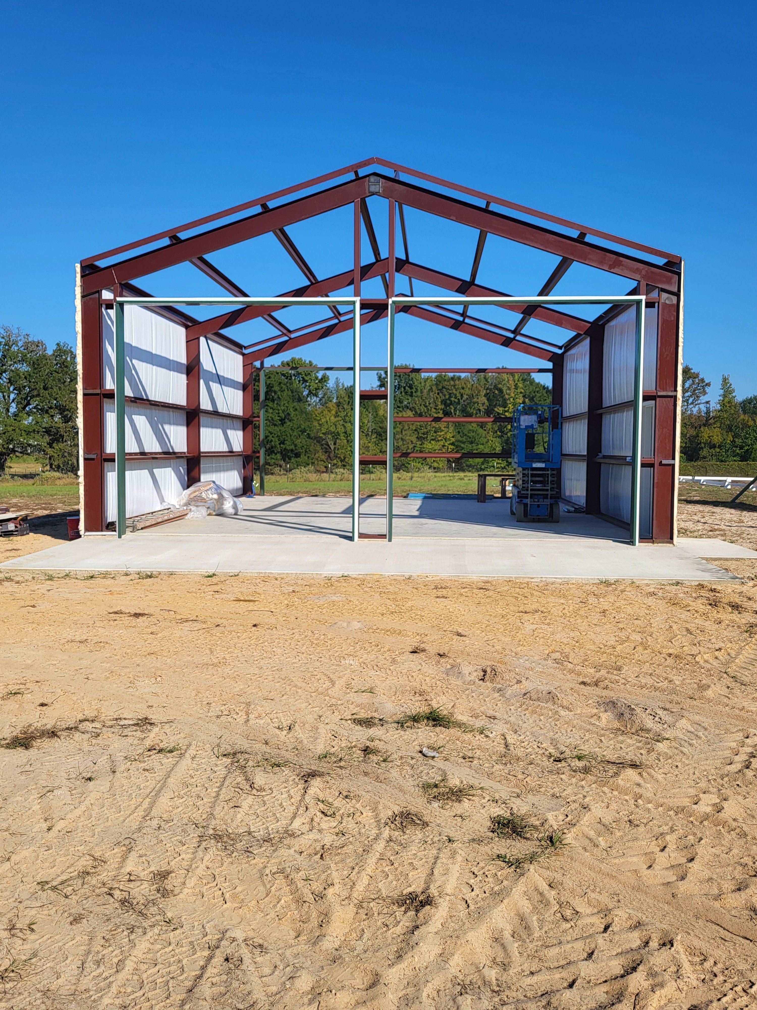

Doors will be 12'X12' roll ups with chain openers. There is no power to the building. It is for hay storage and to keep my 25' Big Tex trailer out of the weather. It is the trailer I use to haul hay and tractors. I have 20A plug on an arena light pole close to it if I need electricity.

I would have to have the power coop run about 300' of wire underground across the field and set a new pad mount transformer to get power to it, all at my expense. Something I may consider in the future but right now I really don't have any need. I shouldn't have to be in there after dark. Being retired gives me plenty of daylight to move hay. :D
The arena next to it has lights so the area around the barn can be lit up. I can put additional lights on the 2 poles next to the barn pointing towards it as well, the mounts and power are already there. I used a double light mount kit on each pole but only put up 1 1000W light per pole for lighting up the arena.

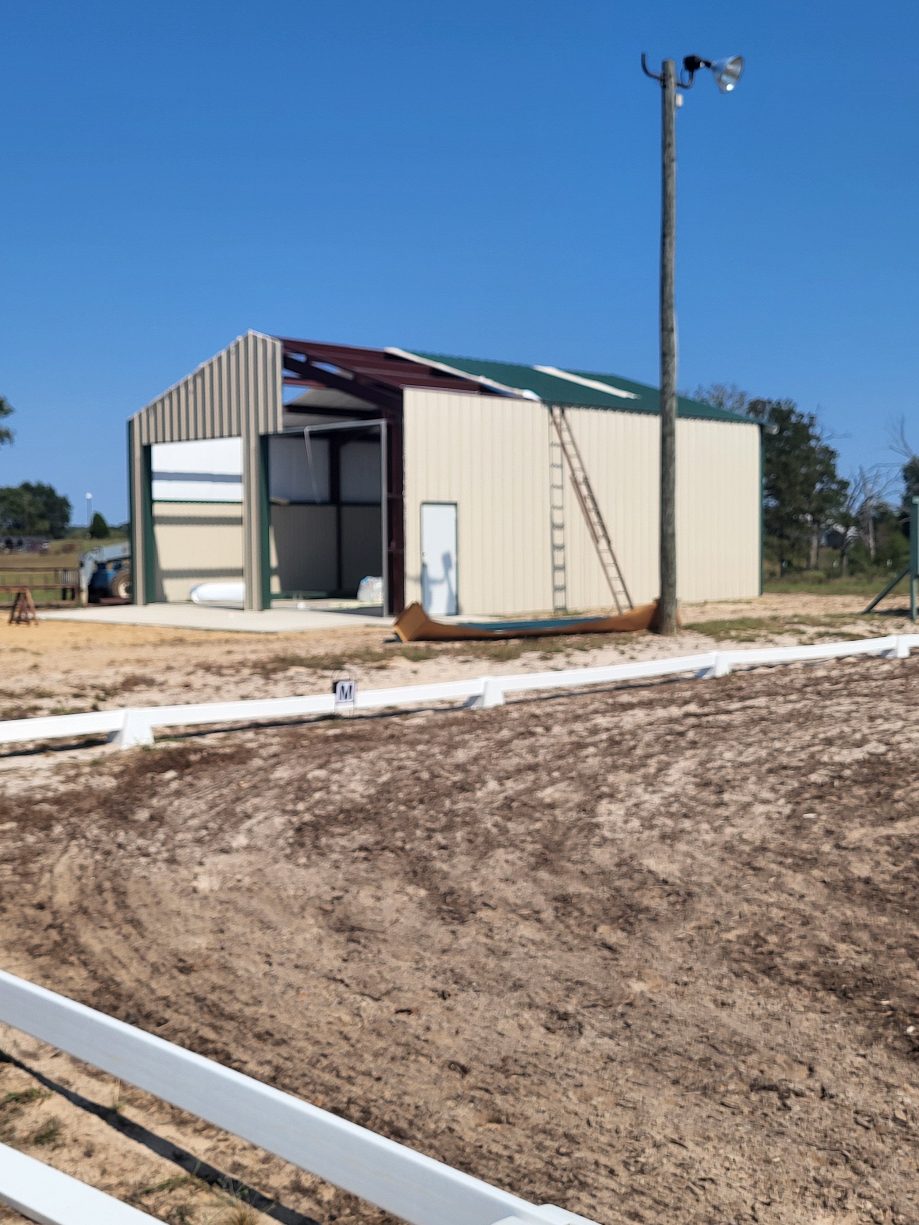

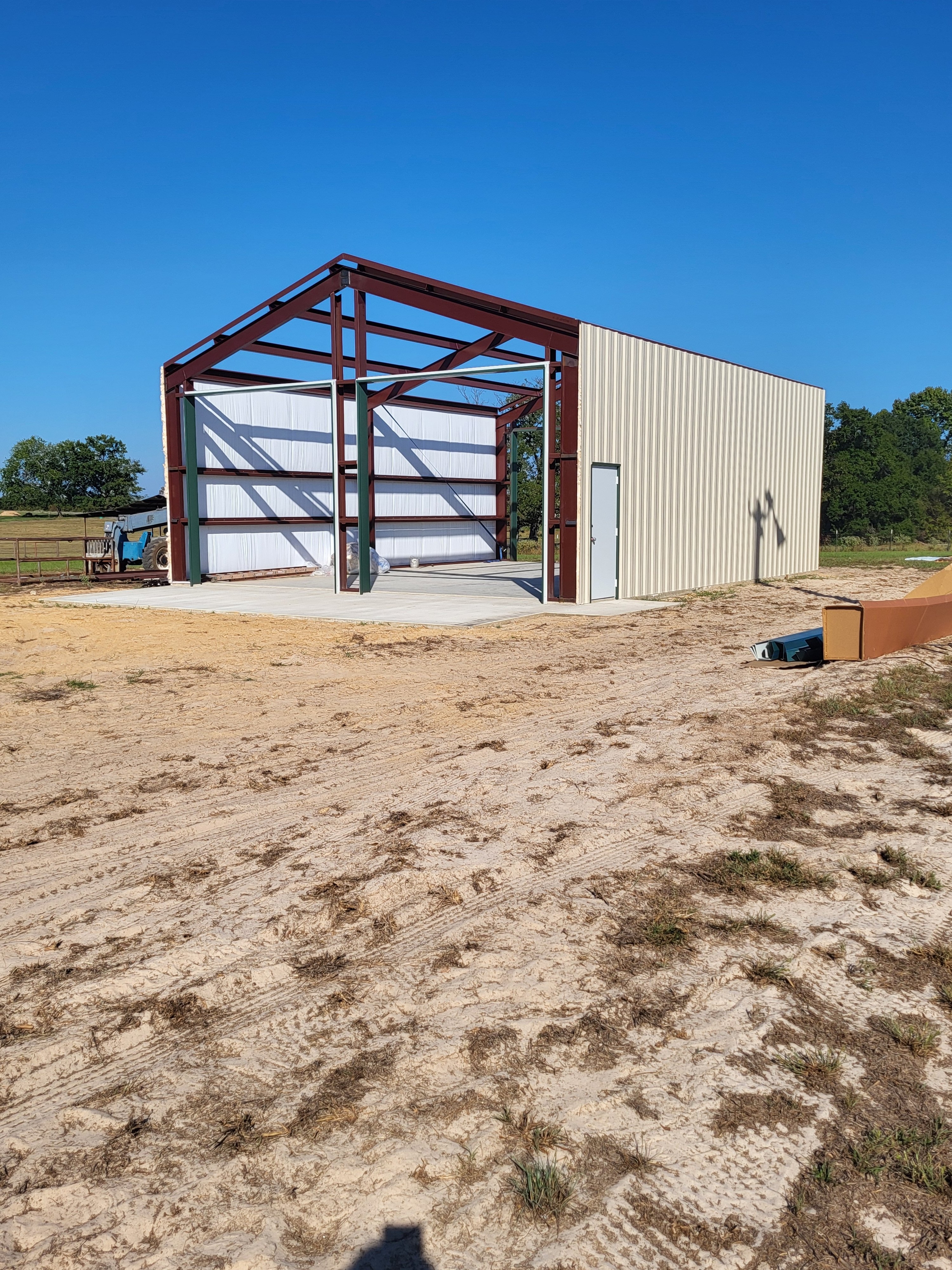

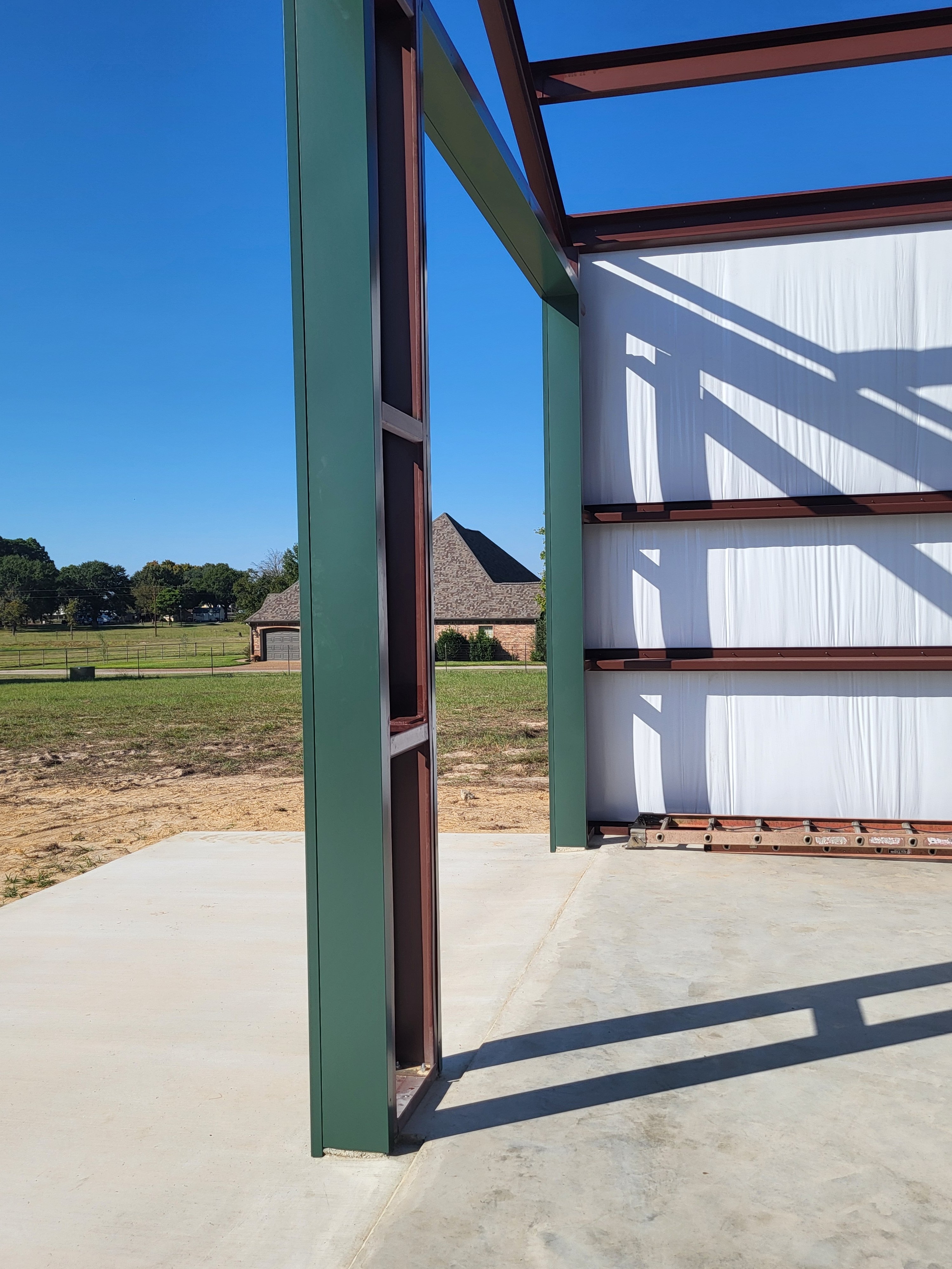

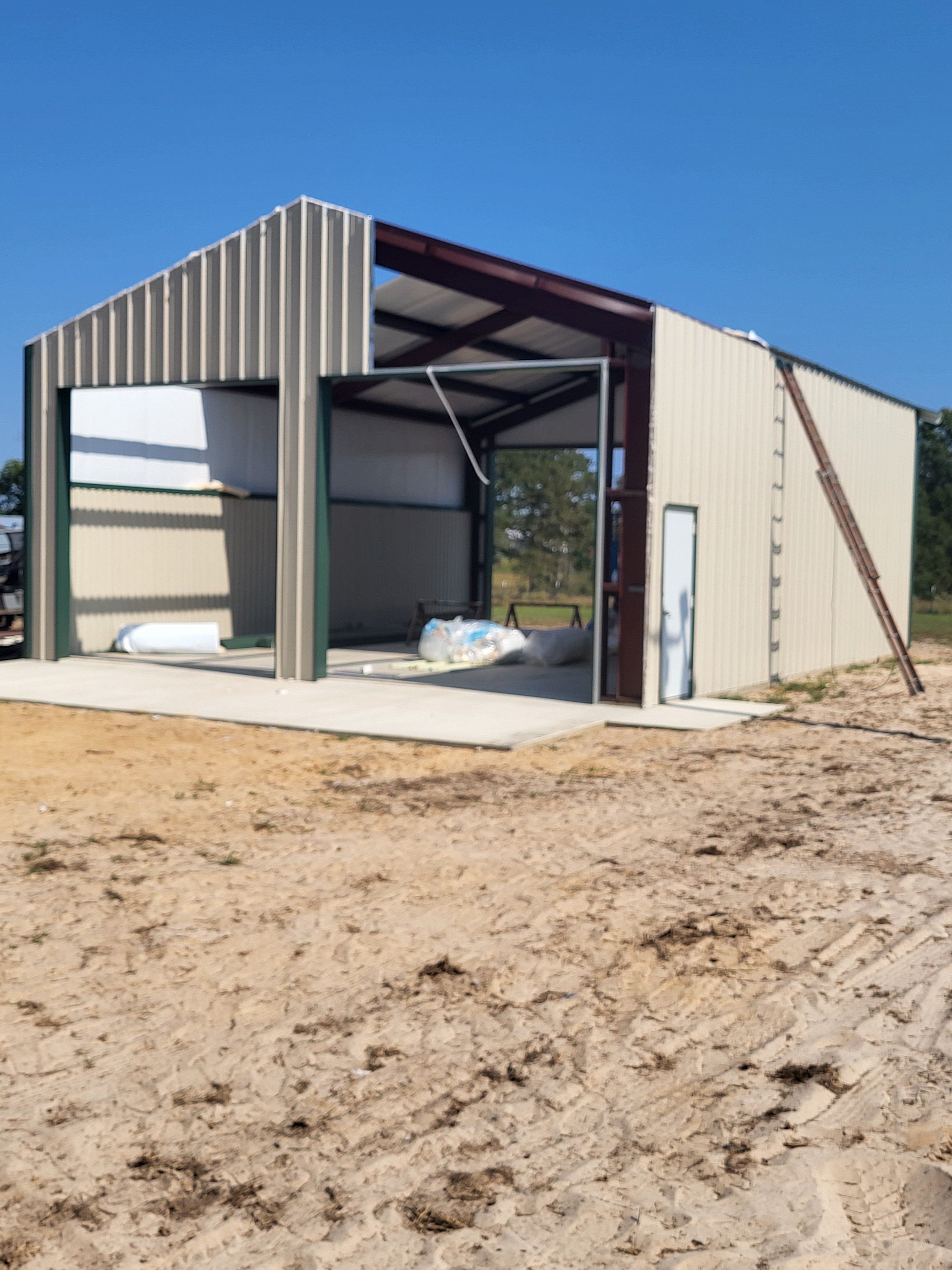

Fabrication guys worked hard today to finish up. Thought we would be complete today. Overhead Door guys were having trouble with the doors sticking. They figured out the factory sent all 3 door frames 1" longer on the left side, so the doors are not sitting square in the tracks. Other than that, the building is complete. They will be back next Tuesday to remove and remount the doors. I will clean up some small trash and smooth out around the building next week. Next pics will be with hay in the barn.
