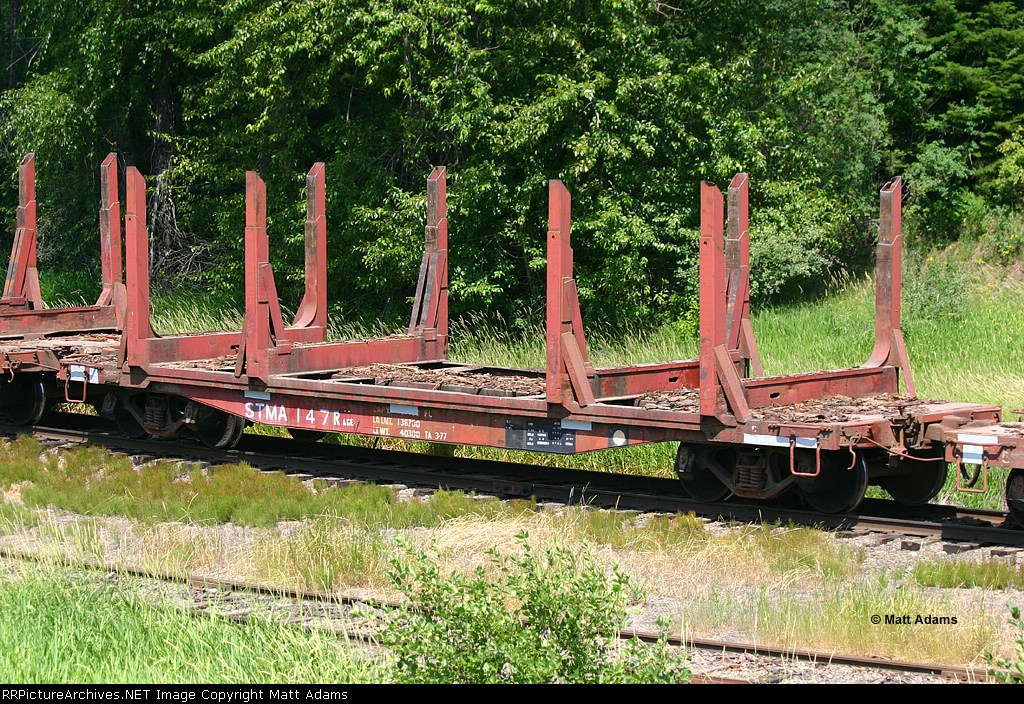

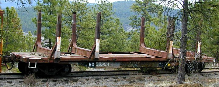

Put on the cross pieces but no deck. Bolt low stakes at the end of some of the cross pieces, maybe 4 per side.
Now you can load and unload the trailer with your tractor forks.
When the work is over, add the top deck.
Sort of like a farm version of a railroad log car.
Bruce

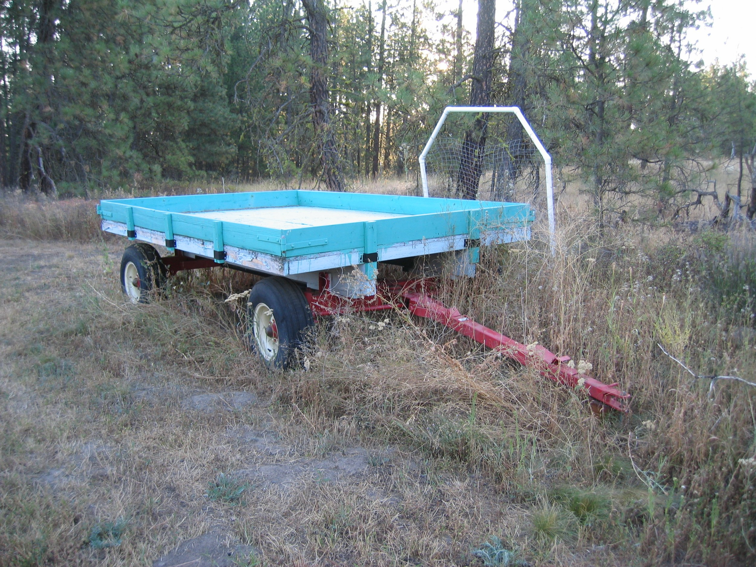

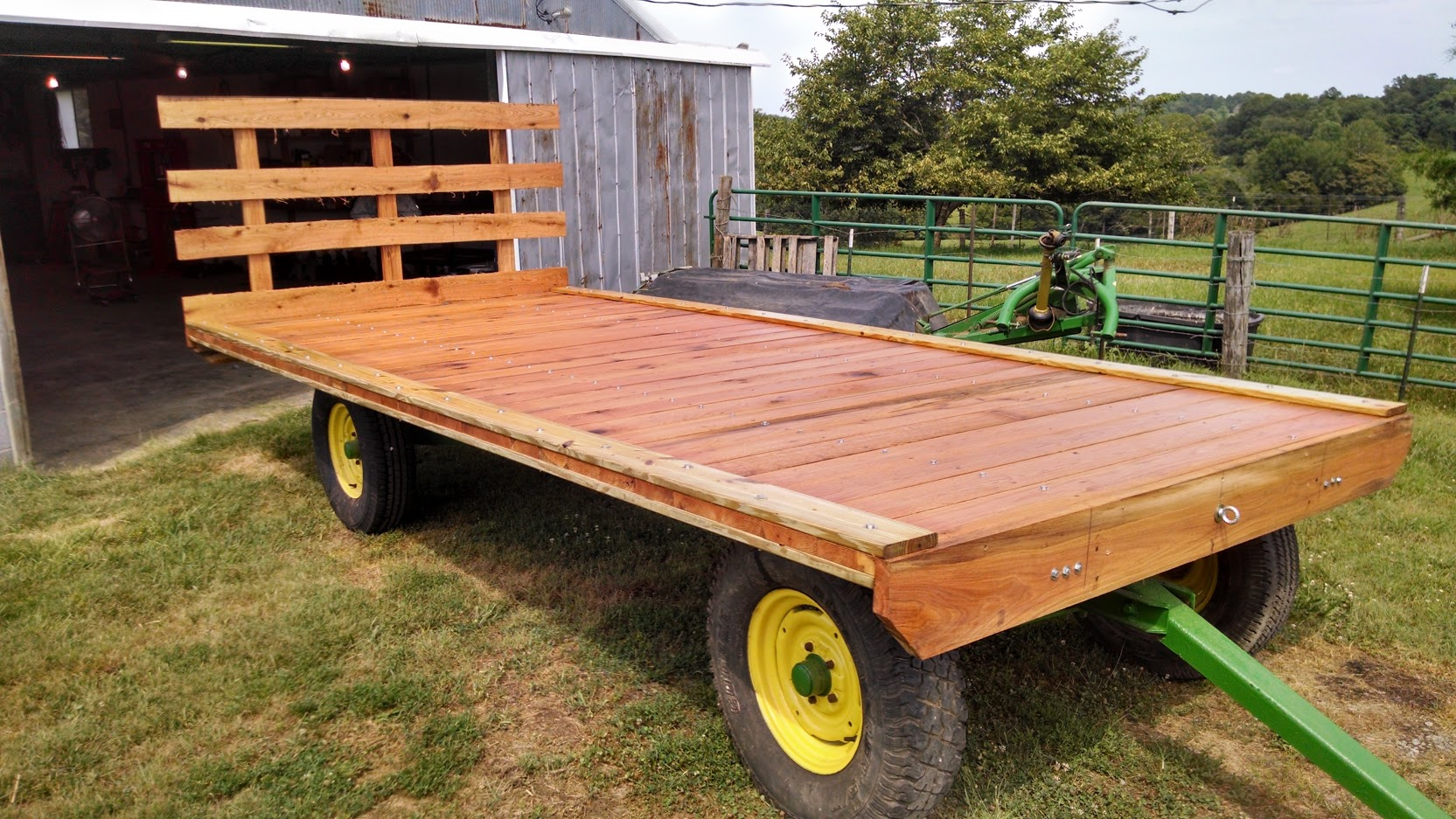

Here is one I built, very similar to the build you are describing. 4x6 runners and 2x6 bed.

In my mind I have exactly what Kessler describes/pictures above! I don't think the log truck/railcar style with standards is what works best for me. The "logs" I will place on it will be sawed logs in whats called a "D" log style-6" thick by approximately 8-10" width having one natural bark edge hand peeled in my case. Other lumber will also be flat and piled on cross cants (4x4's etc.) allowing forks to be used. I don't need sides as oosik shows. I don't know what ton rating is for my wagon- it's either 5 or 8 tons I guess. Lacking a tractor I'm headed for our Southern States store to get them to pick it off my utility trailer so I can assemble the gear there and go back to tow it home.
All my new deck will be wood/ White oak I saw myself. PT lumber right now remains too pricey for my pockets. I won't bother with a rope eyebolt or hay back board as above, I'll leave that for the next person.
Thanks for the replies! I had to look up Thurlow, KY. It's right below Loretto, KY where this gear came from which is 110 miles from myself nearly in the Red River Gorge.

Here is one I built, very similar to the build you are describing. 4x6 runners and 2x6 bed.View attachment 706313View attachment 706313
I have two pieces of steel coming for one ends axle to stringer attachment before I get much done-plus 3 grand daughters to entertain too...
Remember that my own use will be hauling building materials that negotiate woods roads. For later resale my own best size is smallish for sure but reality says few bale square hay much. What little I see in my area is round and over in the bluegrass baled hay going to horse farms is mostly trucked, not wagons as I've seen.
I'm thinking 3x8 white oak stringers.
Deck white oak 5/4 x 6" x 7' length
Deck board pinch boards of 1x6 oak
Overall deck length of 14' via adjustable tube length
Fasteners- I'll use SPAX panhead torx screws for deck to stringers, hot dipped carriage bolts for lengthwise, edge pinch boards
Few questions I've got:
How much clearance between the deck bottom and top of tires?
How much deck overhang past axle top-front and rear? I see your deck hugs the tires in front. Thanks!

There is about 3" clearance between tires and deck. The floor on this wagon is set back farther than normal due to the frame being older and having a shorter tongue. I hook wagons together, so there has to be a certain amount of clearance between wagons for them to turn short. I want wagon decks short so that they are about even height with the bale chute on my square baler.
