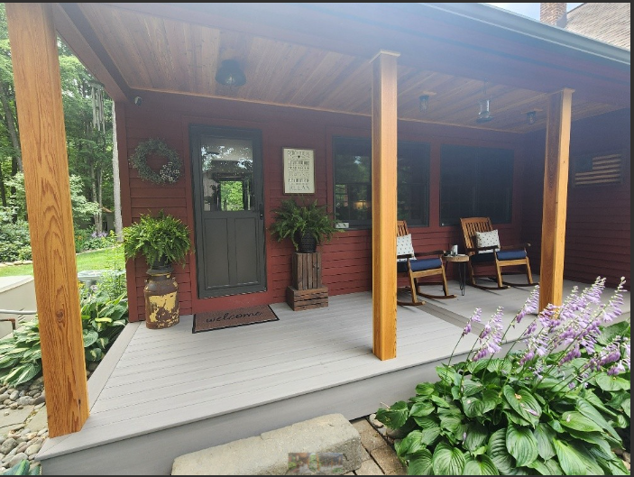

This is mine after the remodel. New cedar ceiling and lights and posts as well.

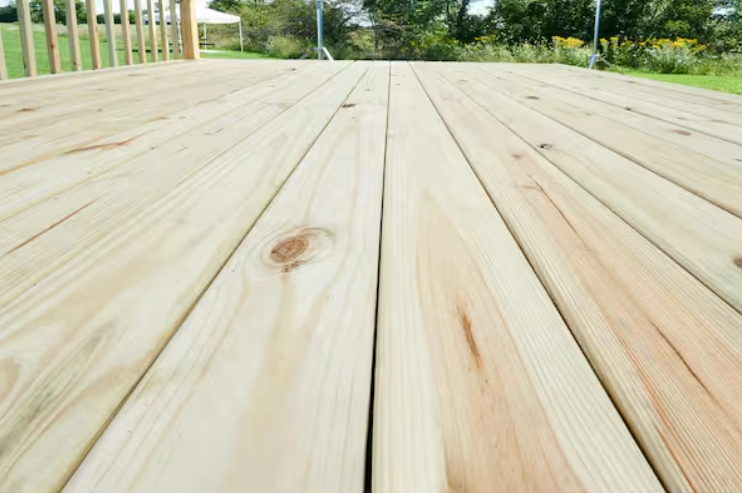

15 years seems like a very short lifespan for a treated deck. Do you have any pictures to show why it failed so quickly?
In my experience, most deck builders are guys that have some experience framing homes, but zero understanding of how a deck is supposed to be built. Most seem to think fasteners can be used to support beams, or they ignore beams and rely on joists to carry the load. Rarely do they use ledger boards and it's very rare to see joist hangers.
I have a deck job in a couple months that used 5/4 treated wood for the decking. It's the worse stuff possible ever since the treatment process changed.
My experience with composite decking has been to give a client a bid with it and another bid using treated 2x6's for the decking. The difference in cost is so significant that I always build the deck with 2x6 decking. Everyone want's composite, nobody wants to pay for it.
I have repaired a few decks with composite decking because it's weak and cannot span very far. Most common repair is to replace the decking with new and add joists between the existing joist for a shorter span.
Eddie, the guy who built it the first time is a very accomplished carpenter. He notched the 6x6 support posts for the rim joists to rest on. No weight bearing on fasteners. I think the issue is the quality of the lumber to be honest. And honestly, the sun on those stairs is just brutal. I used 2x6s for the stair treads and they all warped and twisted and snapped good quality deck screws that I predrilled when I replaced them.
The stringers on the back porch stairs on my house in town rotted in 7 years. It was YellaWood brand. I could poke my finger through the wood. The carpenter who did those was a bit shoddy. It wasn't an amazing job but typical of what you get these days. He did oversaw the stringers. In other words, he did not finish each rise and run with a hand saw. Just ran the circular saw further into the wood. I redid them myself and did it right. But even with semi-shoddy work that YellaWood was utter garbage and should not have turned to mush in 7 years.

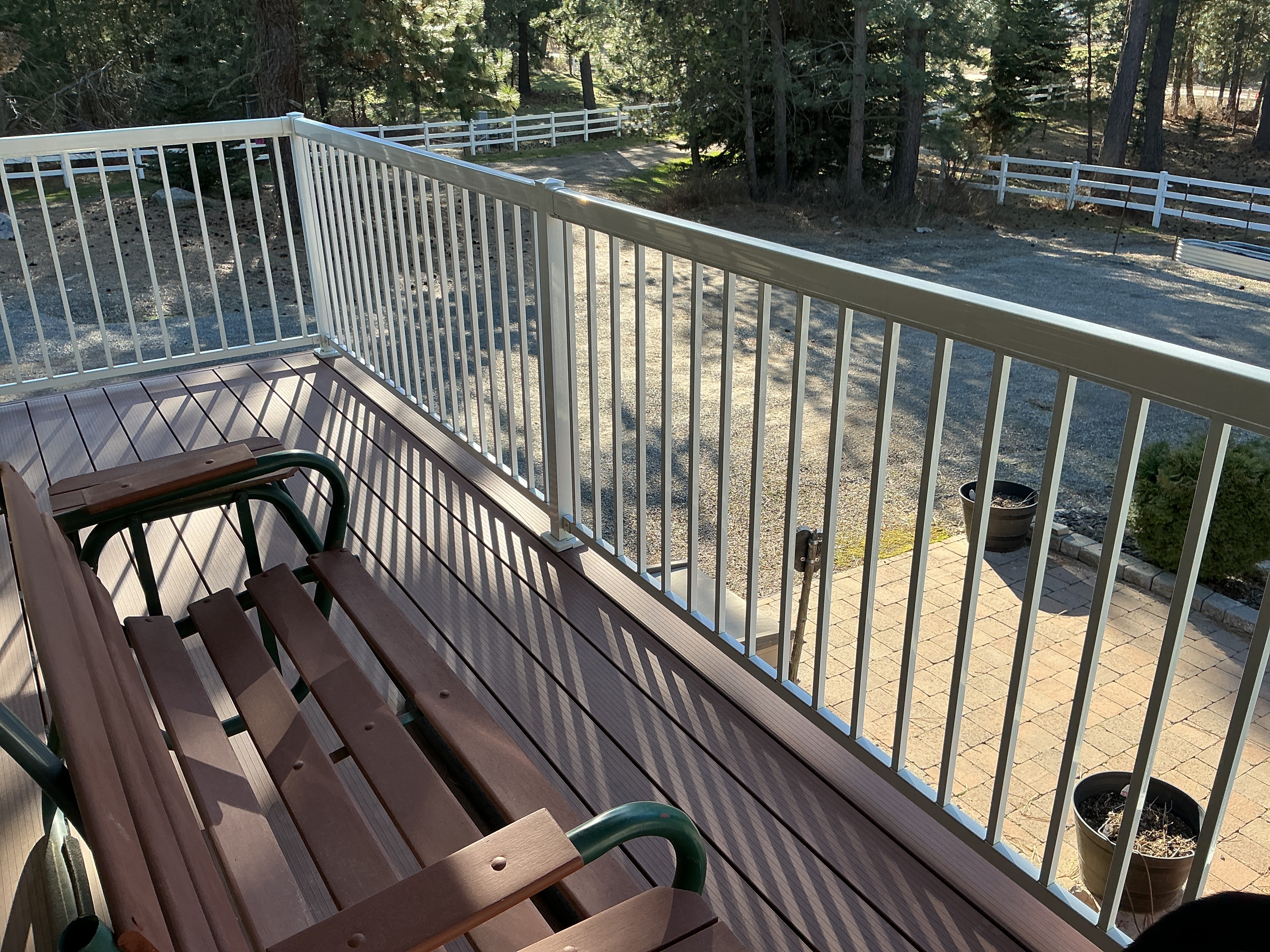

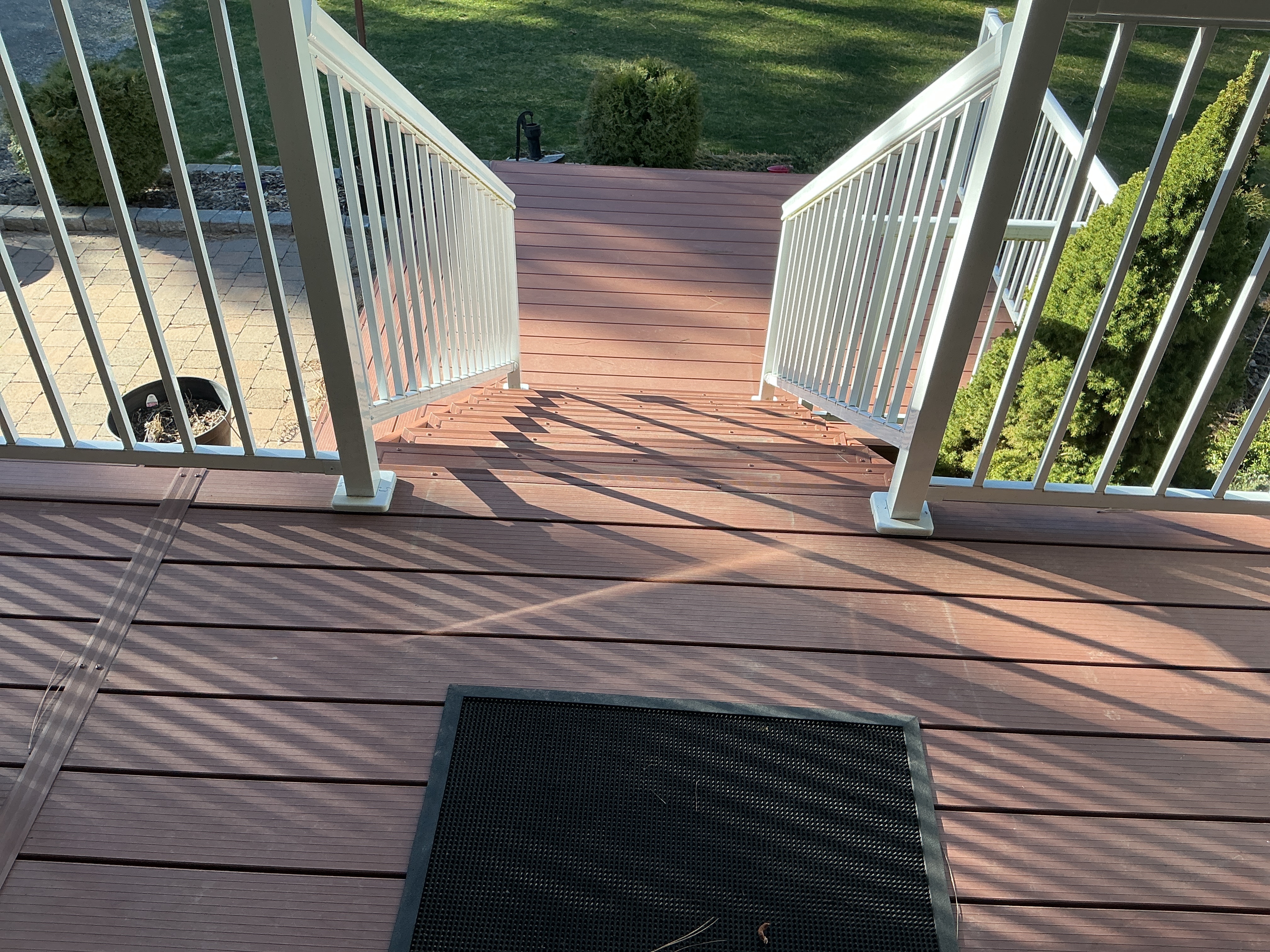

I had cedar decks, and got sick and tired of sanding and restaining them every year. Took a chainsaw to it about 5-6 years ago and replaced them with aluminum decking. Now i simply power wash it once a year.
Absolutely trouble free.
Stays cooler than trex in sunlight. Snow melts off quickly (but i use heated mat cause i dont want to shovel snow). Easy to install. Cuts like wood and all hidden hardware. Product is called NEXTDECK.
