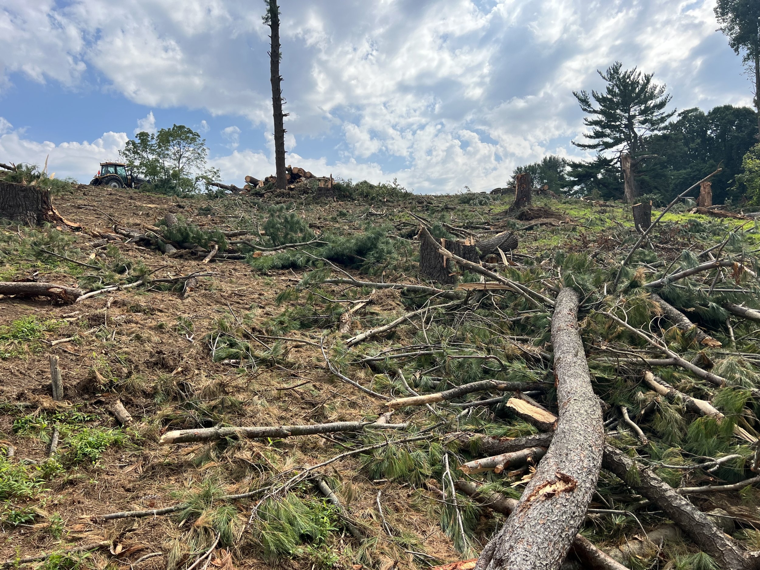

I was offered an alternative to chipping the brush piles that might work.
On the 128 acre property there’s a long “ravine”. It’s probably 1000’ long x 40’ wide x 8’ deep. Its actually an abandoned logging road that cut through the property. Hasn’t been used for many years. New road took its’ place.
The chief groundskeeper told me the owner thinks she would be satisfied if we push/transport all the piles of brush into the old ravine road and just fill it up.
I don’t like it. Feels like it‘s not the best land stewardship, but it’s not my property or money, either.
This ravine already has a lot of fallen & piled brush/large branches along it.
My thoughts were as follows:
1. Rent bulldozer and push aforementioned brush & large branches into ravine.
2. With remaining room left in ravine, transport other brush piles to ravine and push into it with dozer.
I only have a single arm log grapple to move the further away brush piles. Great for logs, but not the best for massive piles of fine, tangled-up brush.
Might need to buy a big brush grapple. Too long on a distance to push with dozer (probably 1/4-1/2 mile distance from ravine).
Need suggestions on “style” of grapple. I’d like something that can open really wide and “bite” into the side of the piles and really get a bunch at once. Gonna look for a used one on FBN.

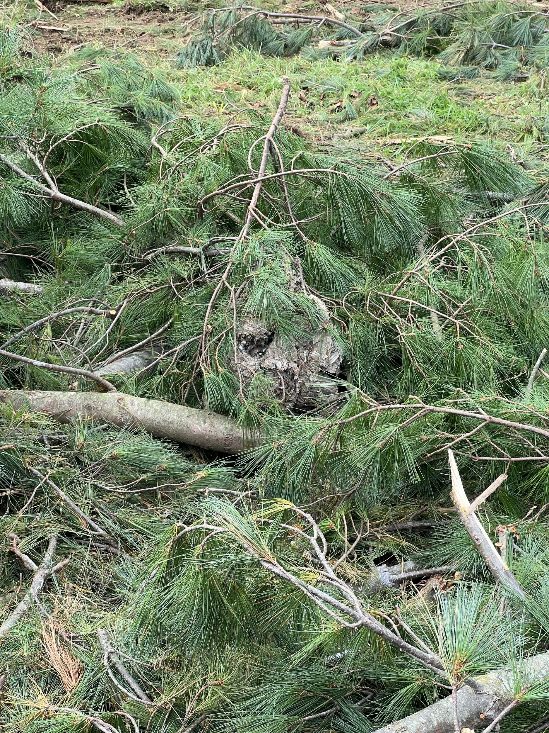

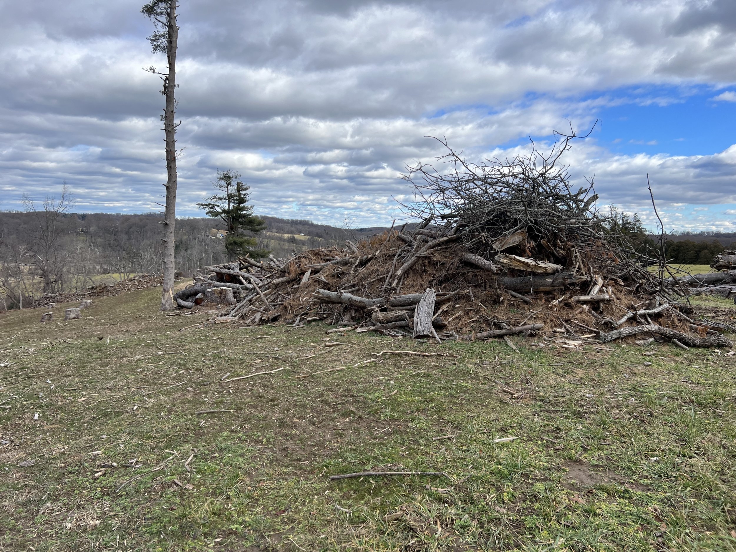

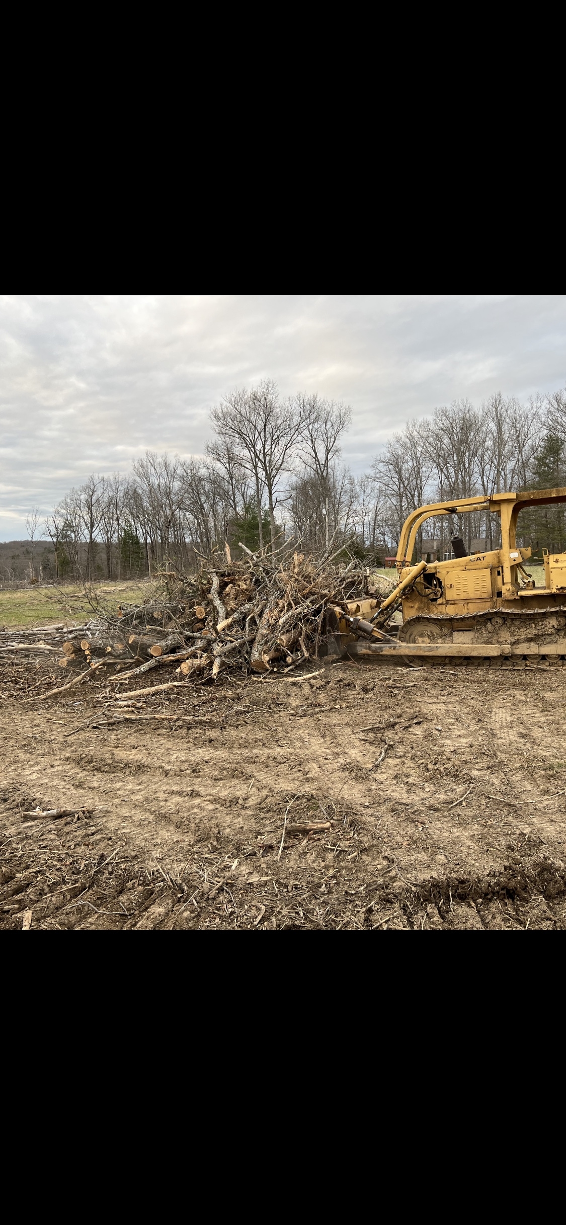

Below is a sample pile. You can see another one about 1000’ behind it. There’s 5 more bigger than these.
Thoughts on brush grapple type?
I don’t know if you have access to one, but what most of our logging contractors use for slash piling is a brush rake on their dozers. They remove the blade and install the “brush bar” in the front of the dozer. It works pretty well to push slash without moving dirt.

Brush actually locks together and pushes good. I still wouldn’t want to go 1/2 mile.

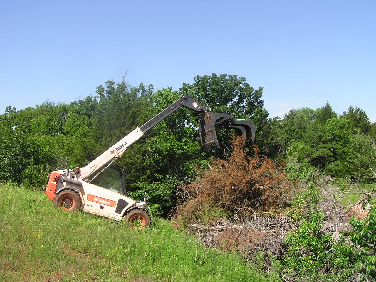

I have the W.R. Long Open Bottom Grapple OBG-1 72" grapple. It works well for getting under a load of brush or logs to carry to my burn pile. And I have carried some heavy logs without damage, to the 2,500# capacity of the loader. My only complaint is the hydraulics for the grapple arms don't have as much force as I would like. Once you get the material sitting on the grapple tines and clamp down the arms, it will hold it OK. Just don't try to go straight down like a clamshell bucket and pick up anything heavy, it will fall out.
W.R. Long, Inc. | Open Bottom Grapple "OBG-2" & "OBG-1"

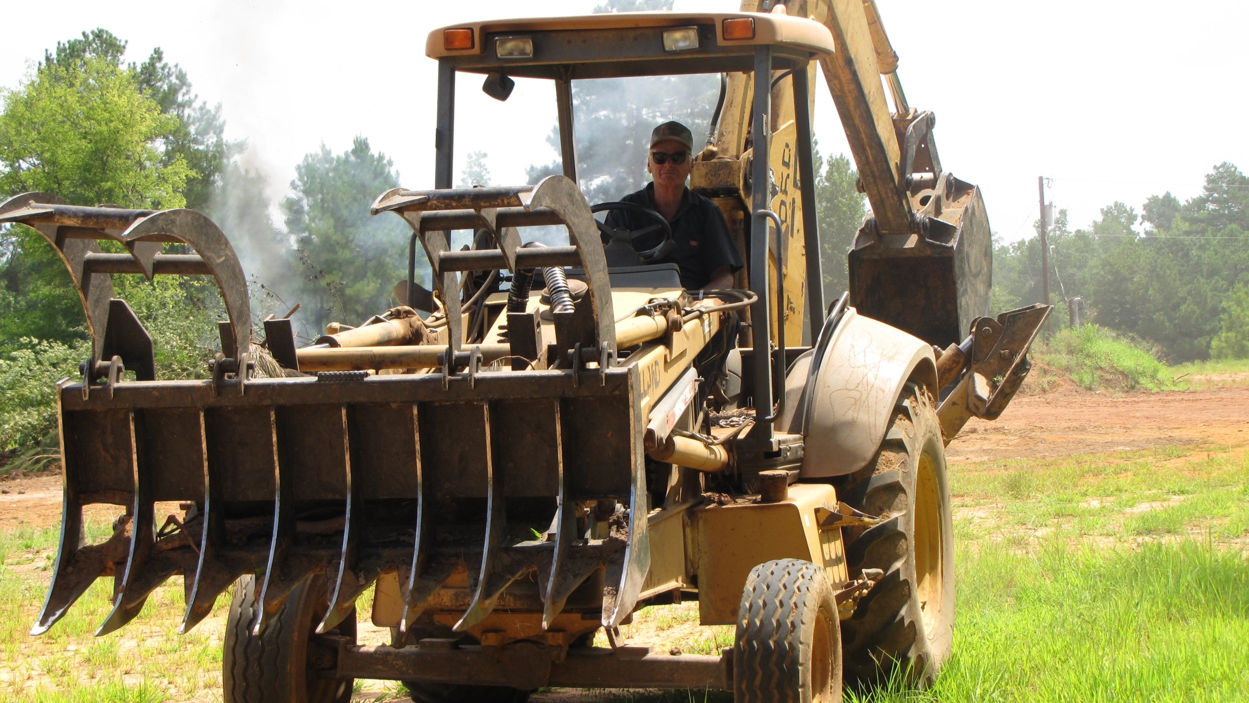

I have a backhoe that I converted the front bucket to Quick Attach so I could swap my bucket with a grapple. I went with a grapple from a company that sells them for skid steers instead of farm tractors. My thinking was that it would be more heavy duty, and designed for abuse.
There are two basic designs to the bottoms of every grapple. The forklift style that you scoop up what your getting, and clamp it in place, or the rake style that relies on the grapples to hold it in place. I went with the rake style, and it's worked out well for me. I can pick up a single branch with it, or I can push a pile together to get as much as possible. For my grapple, it's easy to completely clean up a pile to the last branch.
Double lids allow me to hold an uneven load. Each lid closes until it's maxed out, then the other one closes until it's maxed out.
For long distances, I just curl the grapple up so the grapple is under the material.
I'm trying to remember who I bought it from. I thought their website was called excavator thumb, or something like that, but I'm not finding it. The company that came up doesn't have grapples, so that's not right. They might not be around anymore, or merged with another company. What's important is that you buy something "Construction Grade" to deal with the size and HP of your tractor. You'll destroy a lesser grapple really quickly with what you have!!!!
