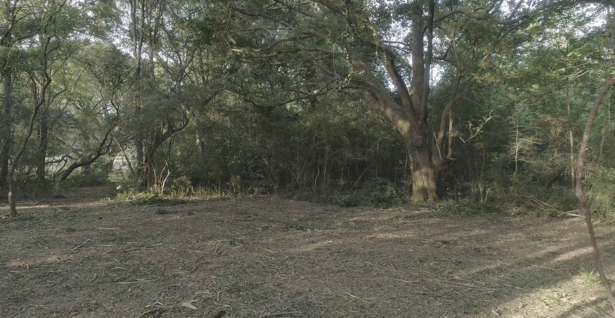

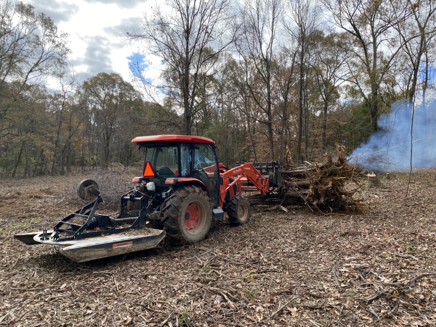

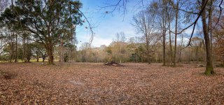

So my father-in-law gave my wife and I about 8 acres as a future house site and this past august I bought a Kubota MX5400 to start clearing it with hopes to build a house within the next two years or so.
I’ve never owned a tractor but have some experience operating them after working for a farm/landscaping company after high school. This property had cows on it approximately 15 years ago but neglected land in southern Louisiana quickly gets out of hand and that was the case with this property, a few mature oaks and gum trees but mostly youpon, tallow trees, and briars so thick you couldn’t see much less walk through the woods.
I talked to several companies about forestry mulching/bulldozing/excavating but with prices between $10-20k and not being in any rush I decided to get the tractor I would eventually buy for the farm and just start picking away at the mess myself. Most of the undergrowth was between 1-4 inches so I bought a heavy duty 66” quick attach brush thrasher and man was I not disappointed, that thing made quick work of everything I put behind it and has held up beautifully. Last month I bought their 60” quick claw grapple because I’d been so happy with the brush cutter and needed something to clear the trees to big for the cutter.
Now 5 months after starting the majority of the land is “cleared” leaving only the mature trees left that I will selectively cut where needed.
To have accomplished so much in such a short time has been far beyond my expectations and I feel accomplished and a sense of pride having done it myself. This brings me to my next phase though, the ground is terribly uneven with divots and bumps ranging from 1-3’ in height. It actually has a natural slope to a Ditch so I don’t need to shape/contour the land as much as I just need to smoothen it out. If this was pasture, it would be one thing but this is recently cleared forest that had dense undergrowth with small stumps and roots systems left behind by the brush cutter. I know the right answer is to hire it out as a bulldozer would make short work of it in a couple hours but having come this far myself I have this completely illogical desire to finish it myself. We’re still a year or two from building the house and at that point we’ll need the dozer to come build up the house pad and we’re going to have a pond dug but I want to make it nice so we can enjoy the property between now and then.
So, tractorbynet do it yourselfers, if you had to buy one implement to flatten rough, stumpy ground (no matter how illogical) what would it be? I’ve done a lot with the root grapple and it works excellent were the roots/stumps aren’t too dense but when it gets thick, the 60’ width is just too much for the tractor to muscle through. I’ve thought about a middle buster or something similar but that seems like it would be an overly tedious process to do several acres that way. I tried my very inexpensive/poorly built box blade but very quickly started bending the scarifiers. I’m wondering if a heavy duty rhino ag 850 series back blade would be worth purchasing as I have some ditching/drain work to do as well but I’ve never used one in a forested area and I’m not sure it would cut through the stumps and roots without damaging it or stalling out the tractor. Any insight would be greatly appreciated!

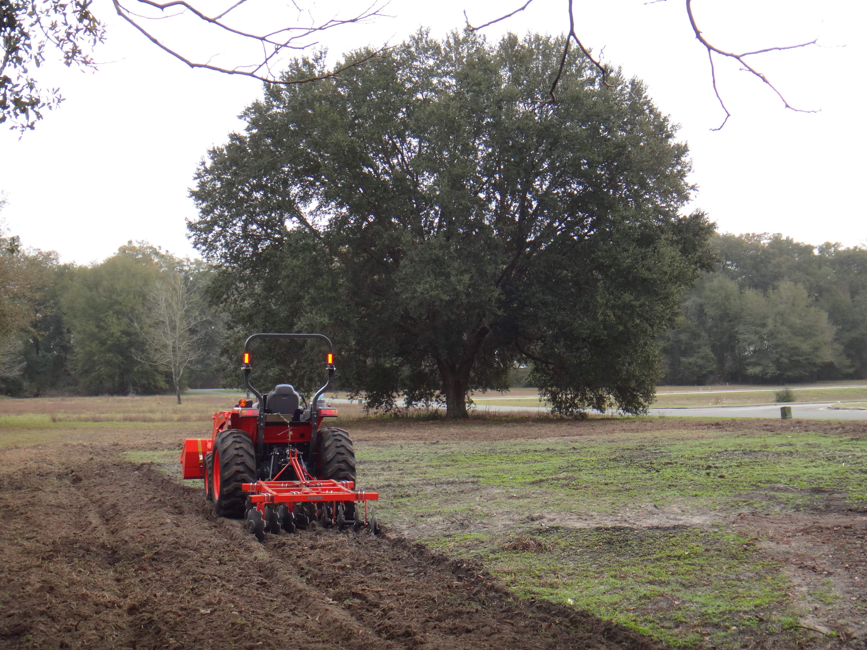

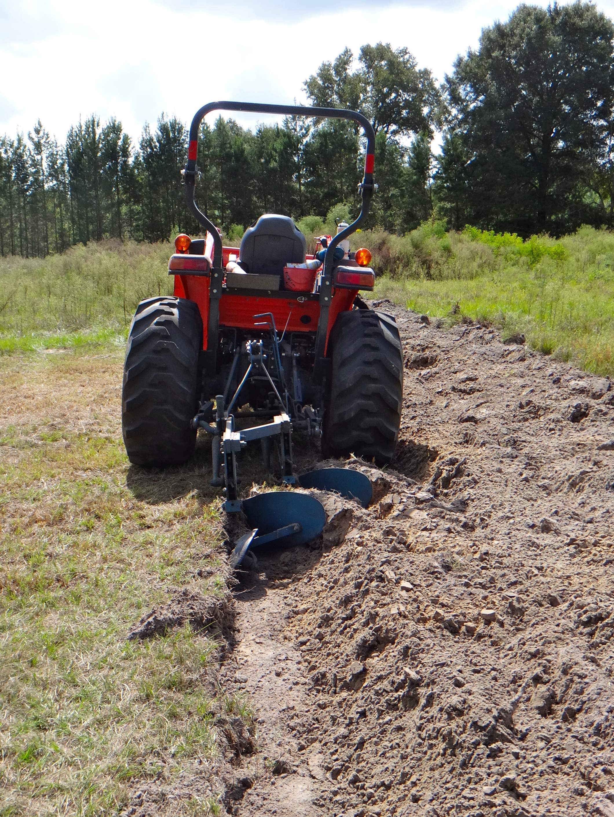

1) 12" or 14", two bottom, Moldboard Plow PHOTO #1
VIDEO: https://www.youtube.com/results?search_query=compact+tractor+moldboard+plow

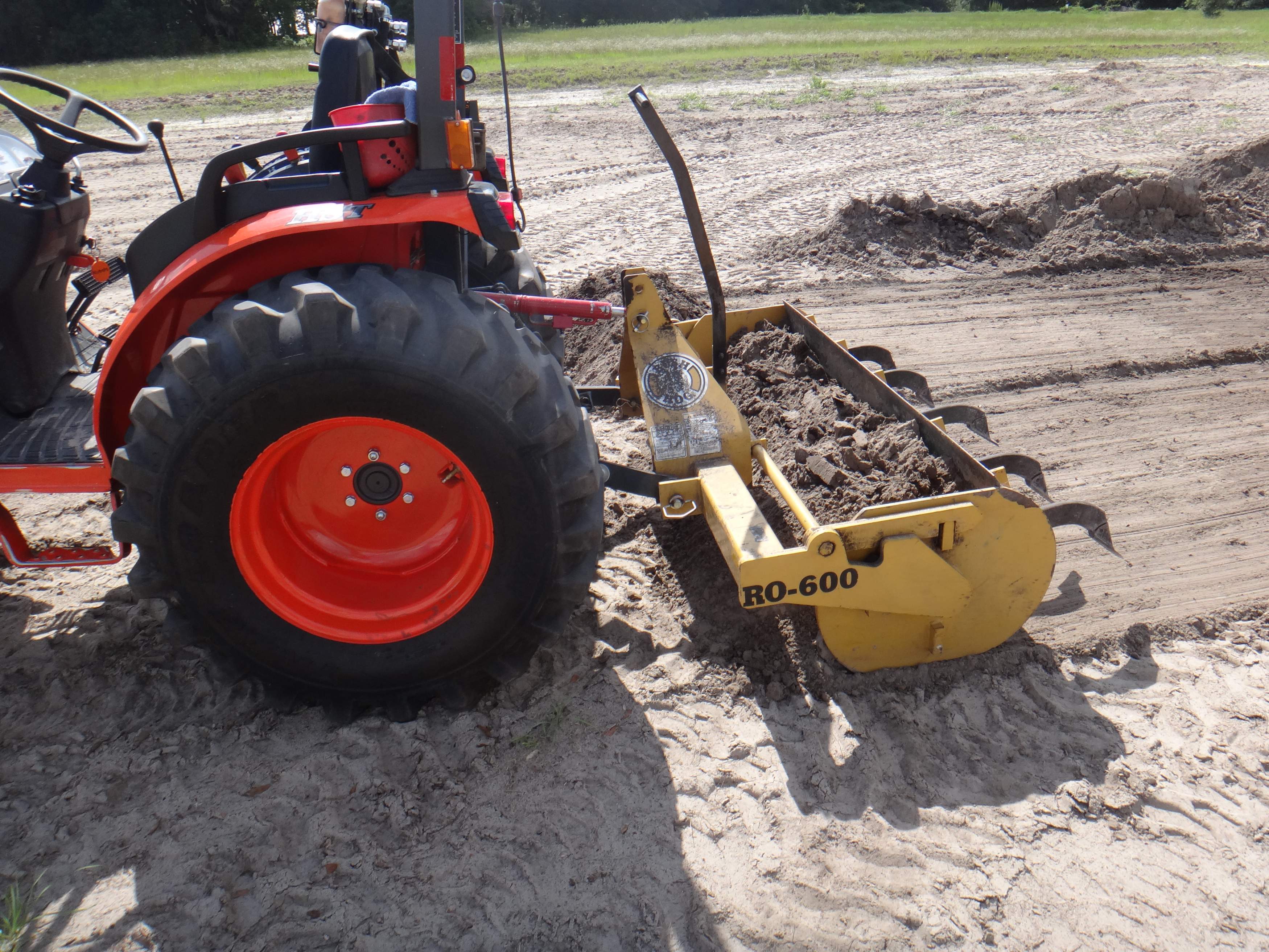

2) Box Frame Tandem Disc Harrow with pans 22" in diameter. PHOTO #2
VIDEO: https://www.youtube.com/results?search_query=compact+tractor+tandem+disc+harrow
T-B-N ARCHIVE: https://www.tractorbynet.com/forums...arrow-selection-compact.html?highlight=harrow

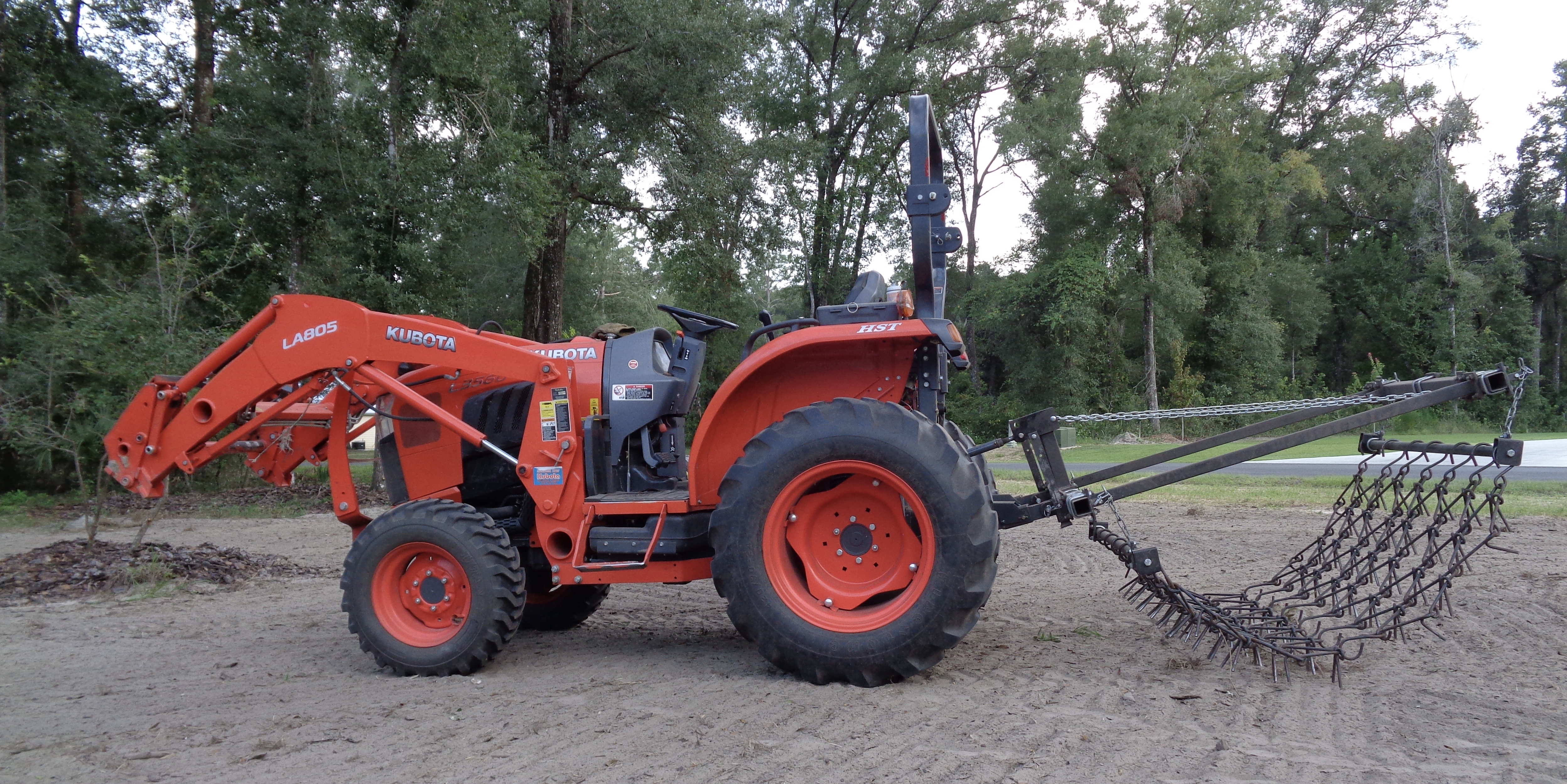

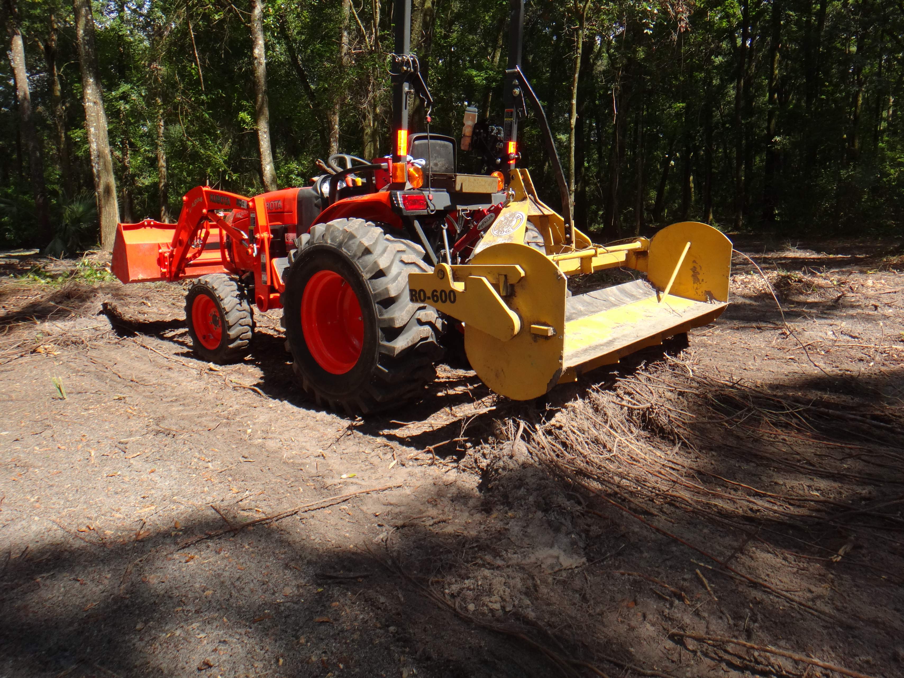

3) Framed Chain Harrow PHOTOS #3 - #4
VIDEO: https://www.youtube.com/results?search_query=compact+tractor+framed++lift+chain+harrow
T-B-N ARCHIVE: https://www.tractorbynet.com/forums...ed3pt57-tph-framed-lift.html?highlight=harrow

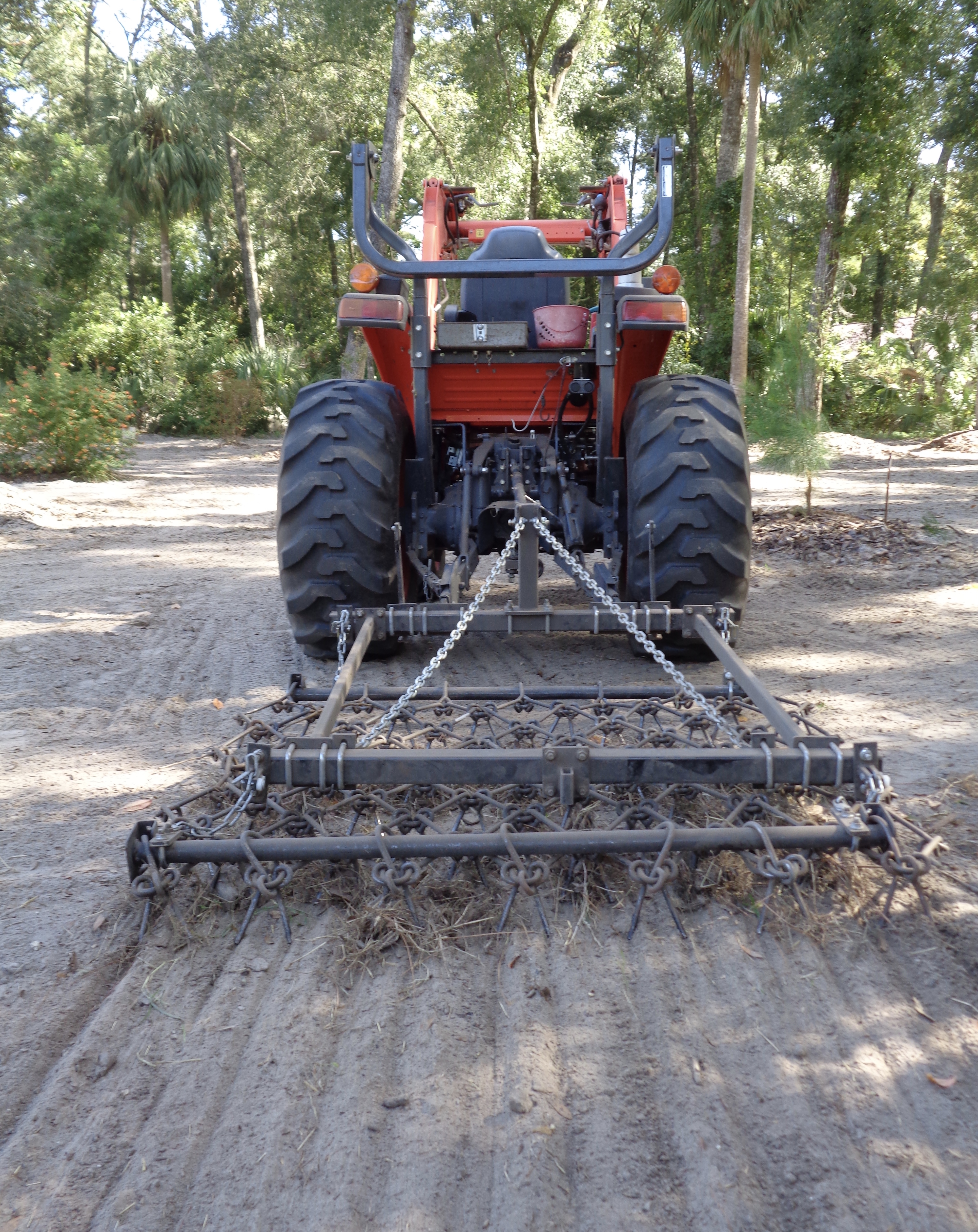

Animal compacted pasture is some of the hardest ground. Almost inevitably it will require plowing. Plow will cut and invert up roots and corms.
Three Point Hitch mounted Tandem Disc Harrows are the classic 'evening' implements. Weight is your friend. An MX can successfully pull an aggressively adjusted Disc Harrow with 22" diameter pans. By adjusting the Disc Harrow less aggressively in increments you can make the land acceptably smooth.
To make the land really smooth and 'clean' you need a "framed" or "lift" Chain Harrow to follow the Disc Harrow.
A "lift" Chain Harrow reliably drops 'trash' accumulated in mat, when harrow is raised and tractor moved a short distance in reverse. Self cleaning is perhaps the major advantage of framed Chain Harrows over unframed, mat Chain Harrows pulled from the tractor drawbar.

My concern would be catching the occasional mature tree root and breaking something on the plow, I think we actually have a two bottom plow buried in the woods around here somewhere from when he had cows. I need something to loosen everything up first and a plow may just be the ticket.
If you have hydraulic Draft Control you will not damage a moldboard plow, which Draft Control will automatically lift when plow encounters a big root or rock. Nor will you damage your MX.
Draft Control kit was a $500 option on my Kubota L3560 in 2013. Draft Control may or may not be standard on your MX. See your Operator's Manual.

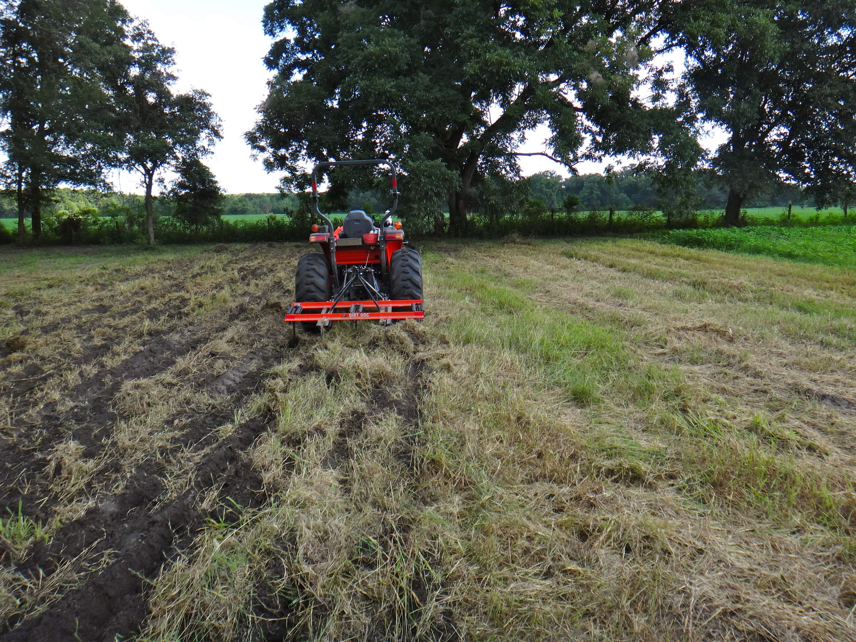

So no luck finding the old two bottom plow this weekend but I did throw the disk on to see what I could accomplish with just that. I was surprised how well it actually did. I found that after a couple passes it loosened the ground up enough that the grapple could tear out the thick patches it couldn稚 before disking. It痴 going to be a long process but I enjoy the time I spend on the tractor anyways so I知 looking forward to it.

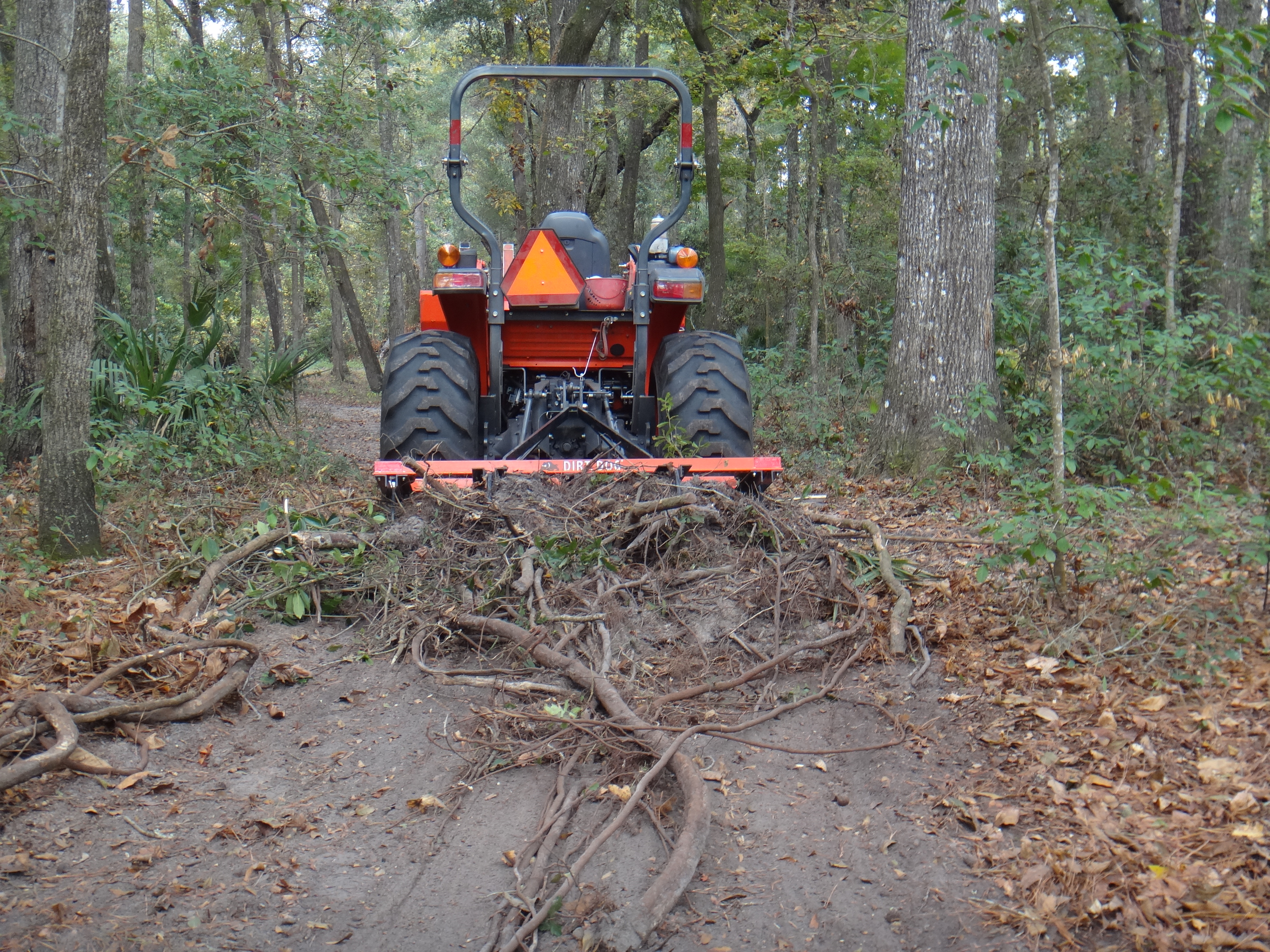

The Field Cultivator in Post #12 is much better for removing roots. However as a leveling rake, the OP's primary objective, a Field Cultivator is not much. A Field Cultivator will drag out roots to 12" deep, 14" under ideal conditions. A Box Blade behind a compact tractor will drag out roots to 5", 6" depth under ideal conditions.
So my father-in-law gave my wife and I about 8 acres as a future house site and this past august I bought a Kubota MX5400 to start clearing it with hopes to build a house. It actually has a natural slope to a Ditch so I don't need to shape/contour the land as much as just smooth it out.
I own both a Field Cultivator and a heavy duty Rollover Box Blade weighing 620 pounds in 60" width. I have broken rippers on the Box Blade.
I have never broken a coil spring protected shank on the Field Cultivator.
