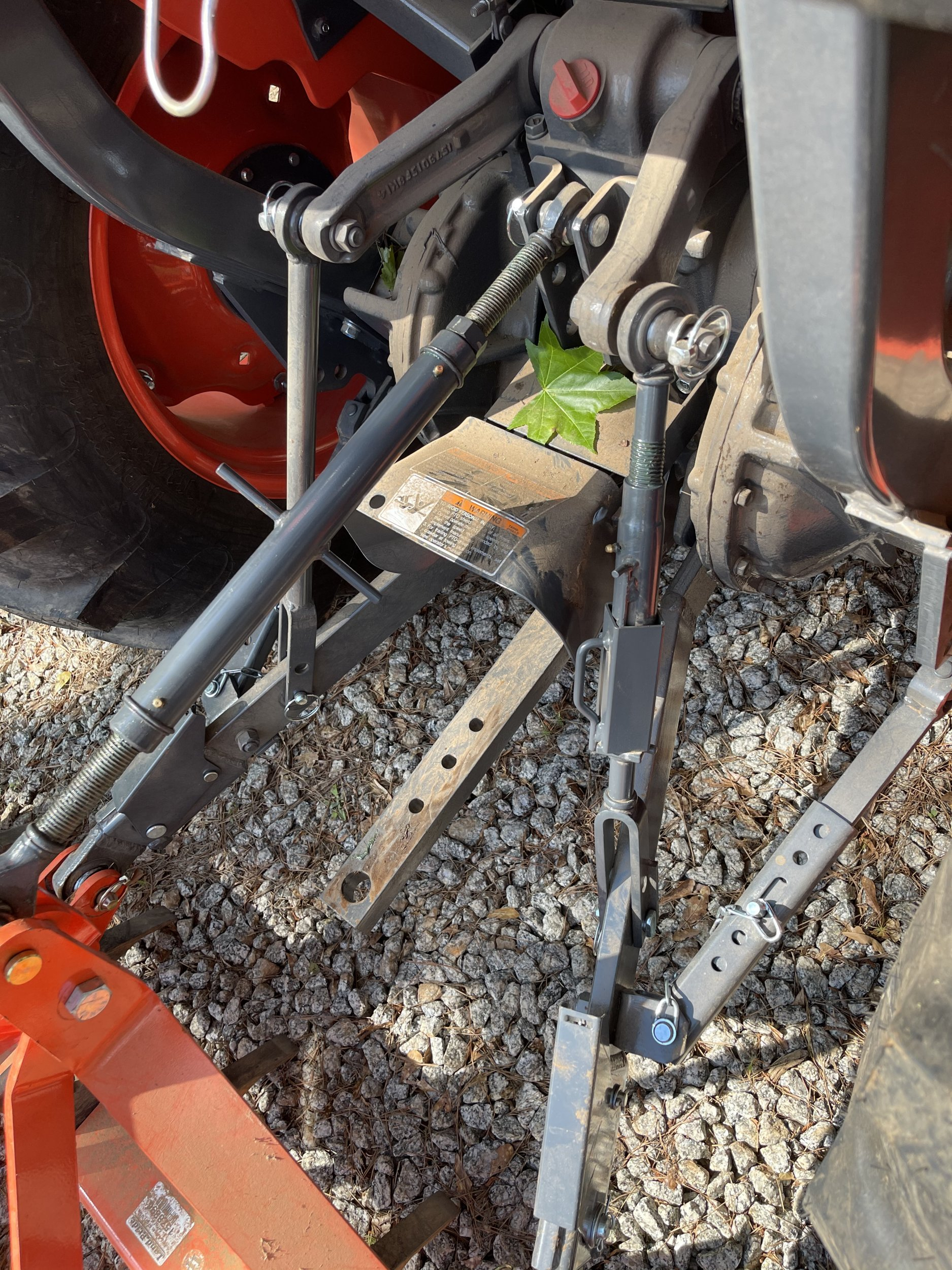

Any tractor (any brand) should be delivered with all pins and points greased. That is a terrible oversight. After that, Kubota usually says to grease every 10 hours. Sloppy shop procedures and oversights do happen. I have a friend who has the same model tractor as I. After using the tractor about 2 weeks, his front hyfraulic 4wd assemblies would not work. Limped backed home and called the dealer. The dealer picked it up, inspected the tractor, and found the tractor was delivered somehow without sufficient fluid in the front wheel drive units. They replaced both sides and cleaned up the hydraulic system (not sure what that means) and delivered it back in about 2 weeks. They fired the person who was supposed to be responsible for making sure it was ready for delivery. Apparently this was not the only time.
There was another discussion here on TBN about all the fees regarding a new tractor purchase. Maybe they shouldn't have charged you the "assembly fee" if the tractor was not ready for delivery. I also have a Kubota and love my tractor from the first time I started it. What you are experiencing (to me) doesn't reflect badly on Kubota, but it certainly does not speak well for the dealer. Anyway, sorry to hear your experience has not been better. I think the MX series are really good tractors. I also remember another post (in a discussion of best tractor) I stated that most tractors are really good if sold by a good dealer. Best wishes, I hope the tractor becomes what you wanted it to be, SOON. Larry

Let's calm down about the grease or lack of it. It was the manual-screw top link, and hand crank on the side link. Possibly the least critical points for grease on the tractor. They should have been greased, but a single pump will last years on those.

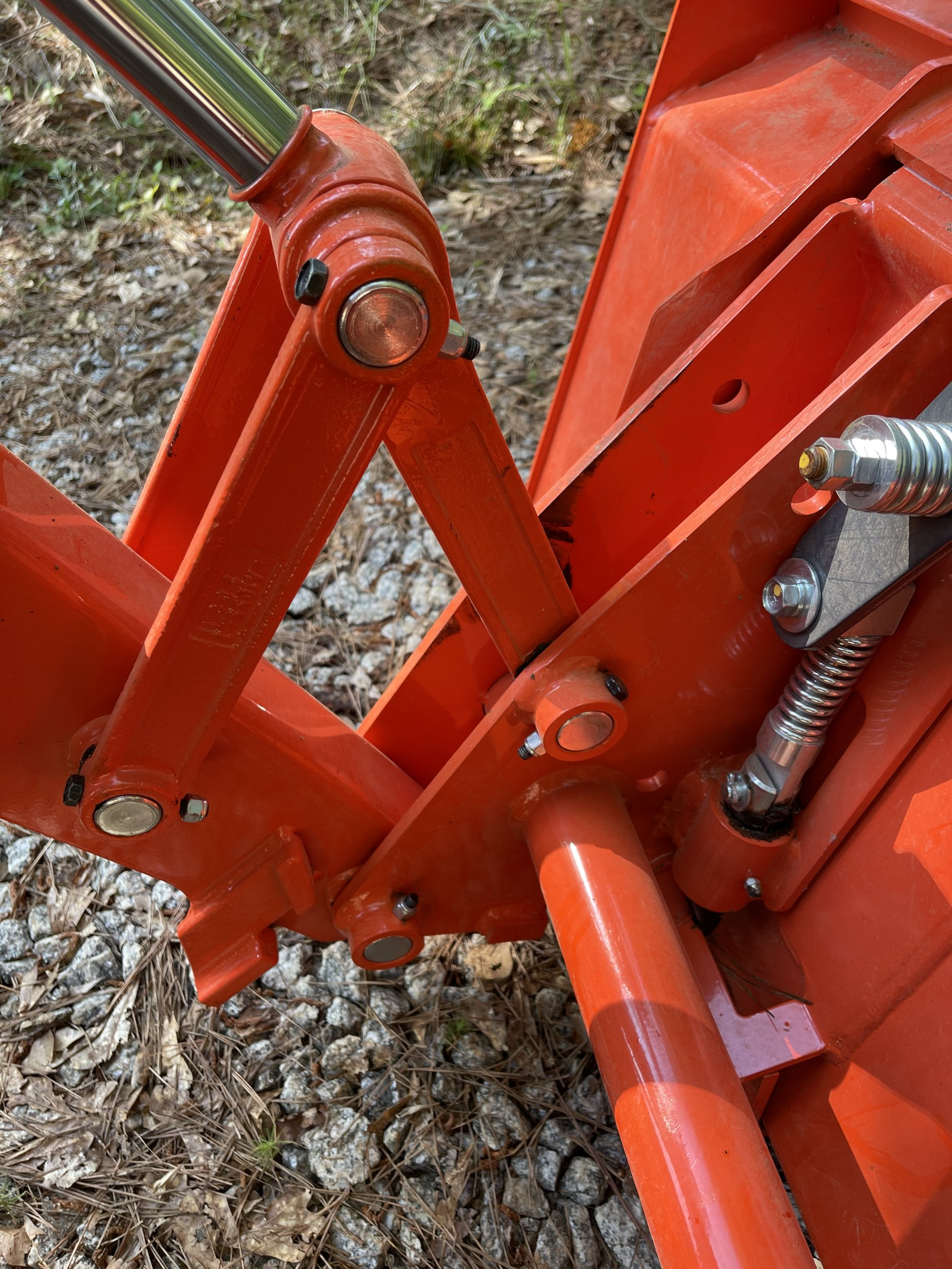

The ONLY thing that the dealer overlooked was ONE broken grease zerk. But now too many keyboard warriors that dont know how to read beyond the first page and get to page 3 where I asked for pictures.....and they finally got posted and we realize these loose bolts and dry fittings is NORMAL. STOP MAKING A BIG DEAL ABOUT IT AND READ THE WHOLE POST BEFORE COMMENTING.

Clicking was the bucket zerks. Mine won’t steer past maybe 1/3 of the way with a loaded bucket. Rpms don’t matter. I tried it a full rpms.
