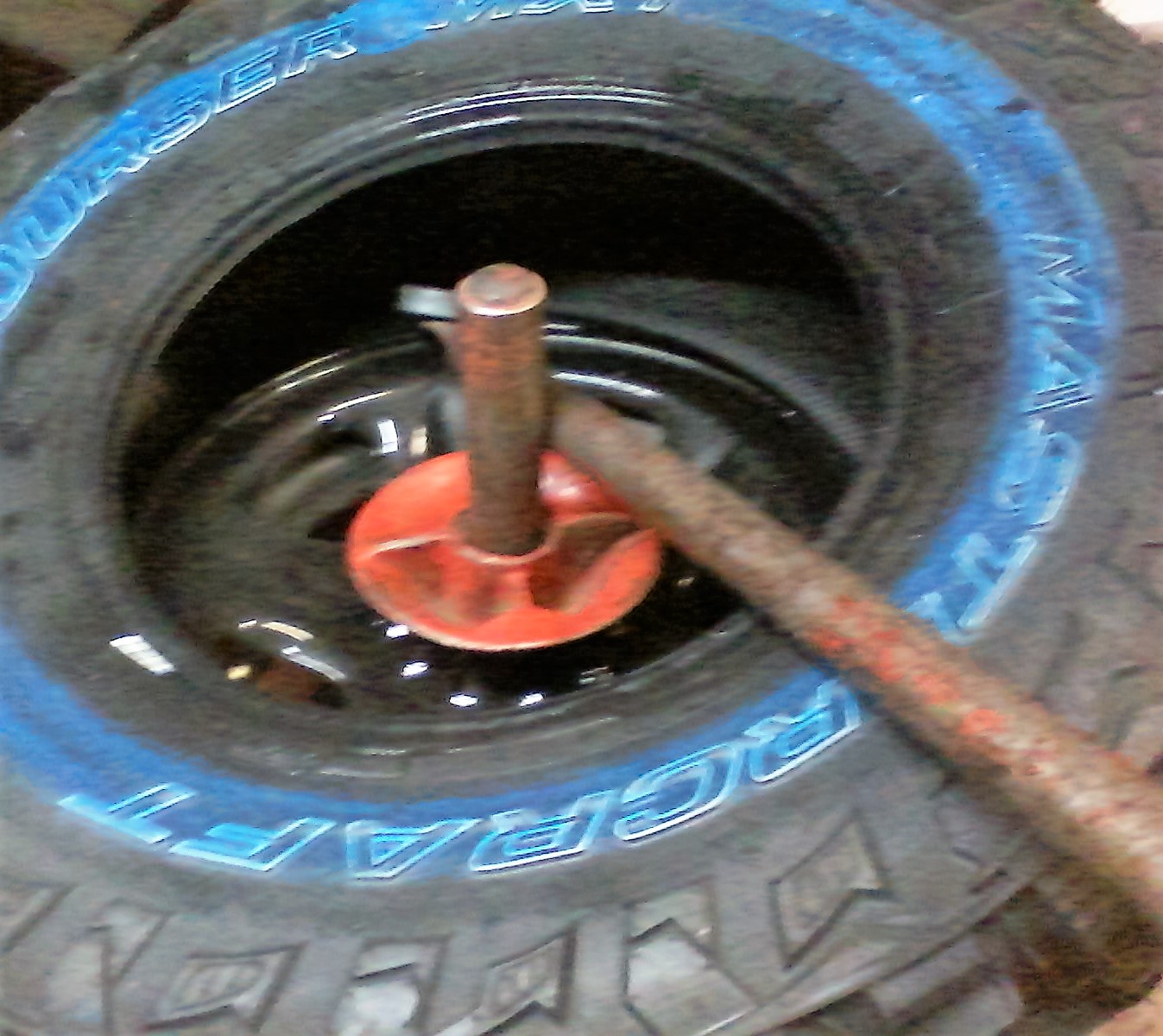

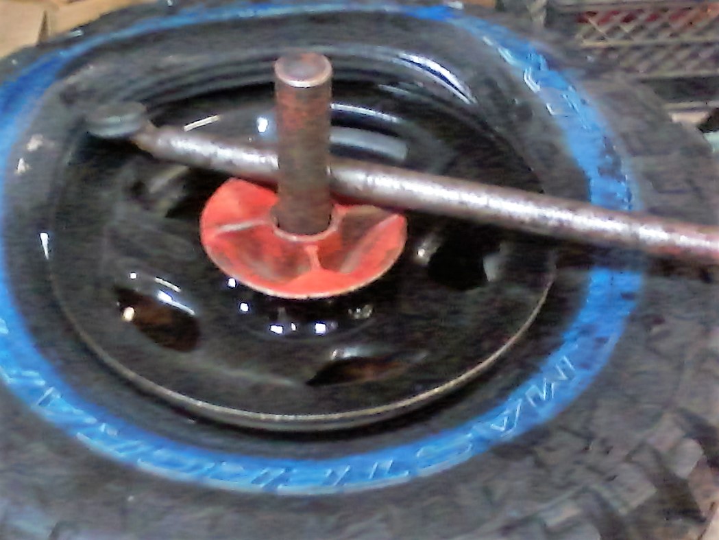

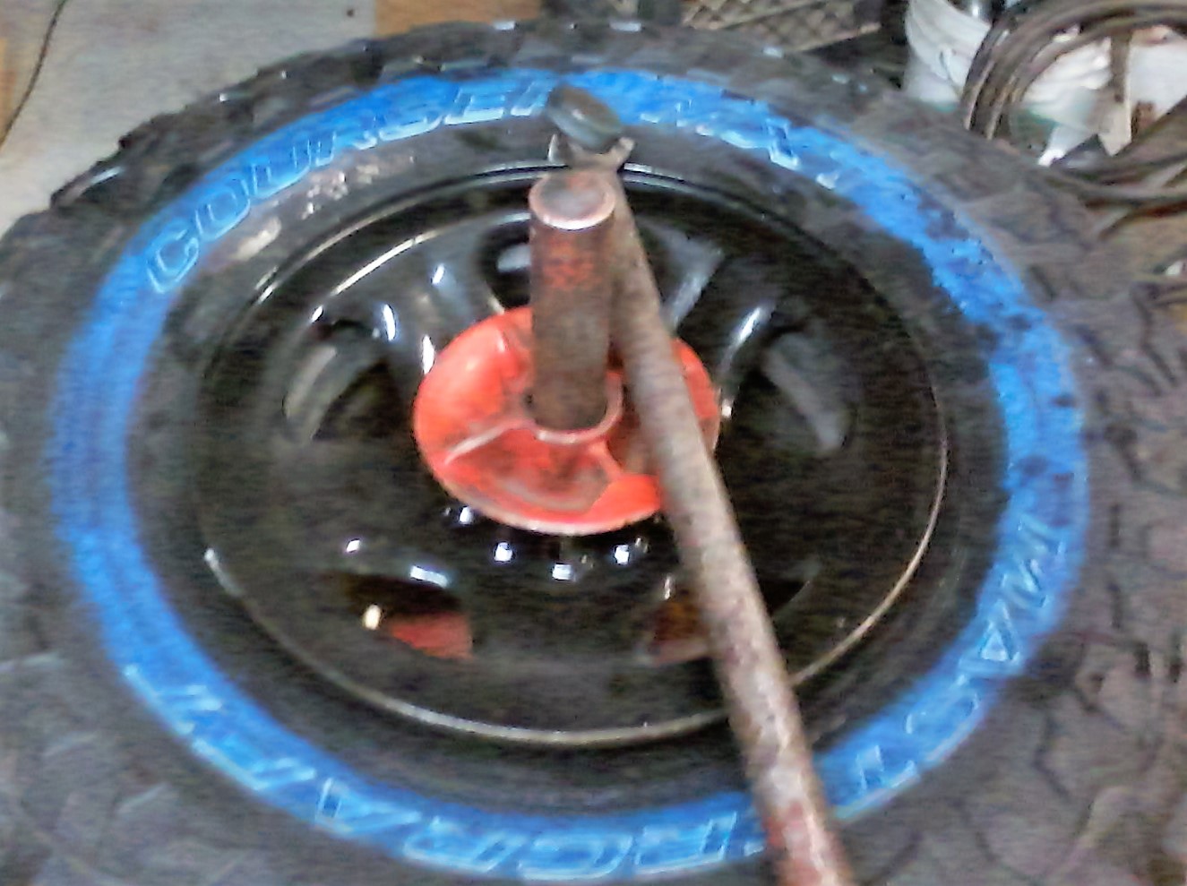

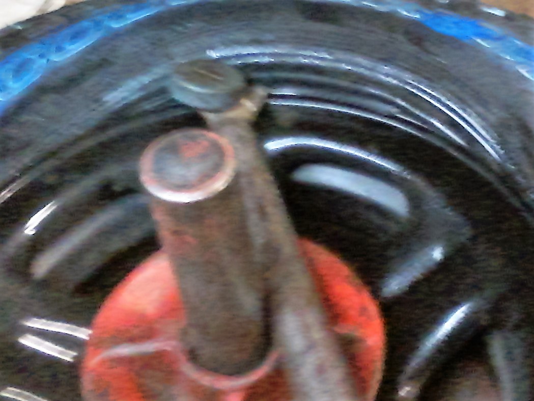

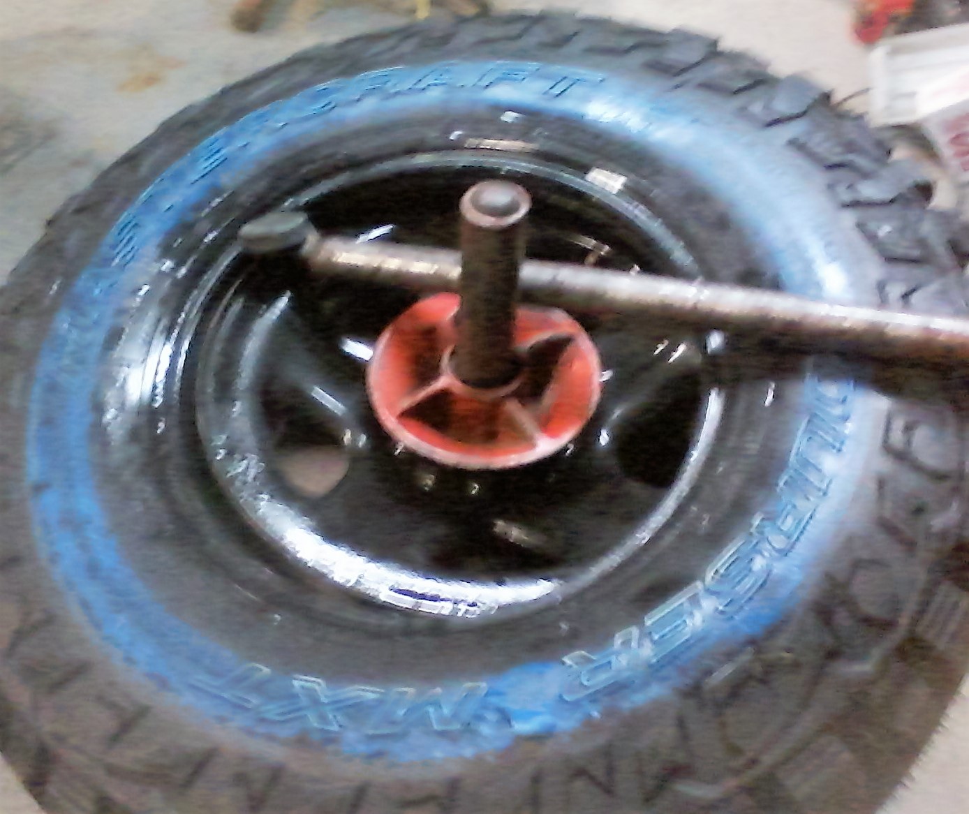

Never had a bar with the wheels, but my guess would be the wheels ride the rim, not the tire bead;
No- the hook slides on the outside of the rims lip
The wheel rolls on the tires inner bead as the bar is pulled against the tire machines center post .
When working correctly the bead slips over the rim behind the wheel as the bar is moved around the wheel
If I get a chance I will take a few pictures of my changer with the bar putting a bead on.

Sorry it took so long some pictures of the manual machine and bar in use: bottom bead being put on
Now the easier to see top bead
hope this clears up how the bar and roller get the bead on the wheel

Very nice pics, very clear to see.
