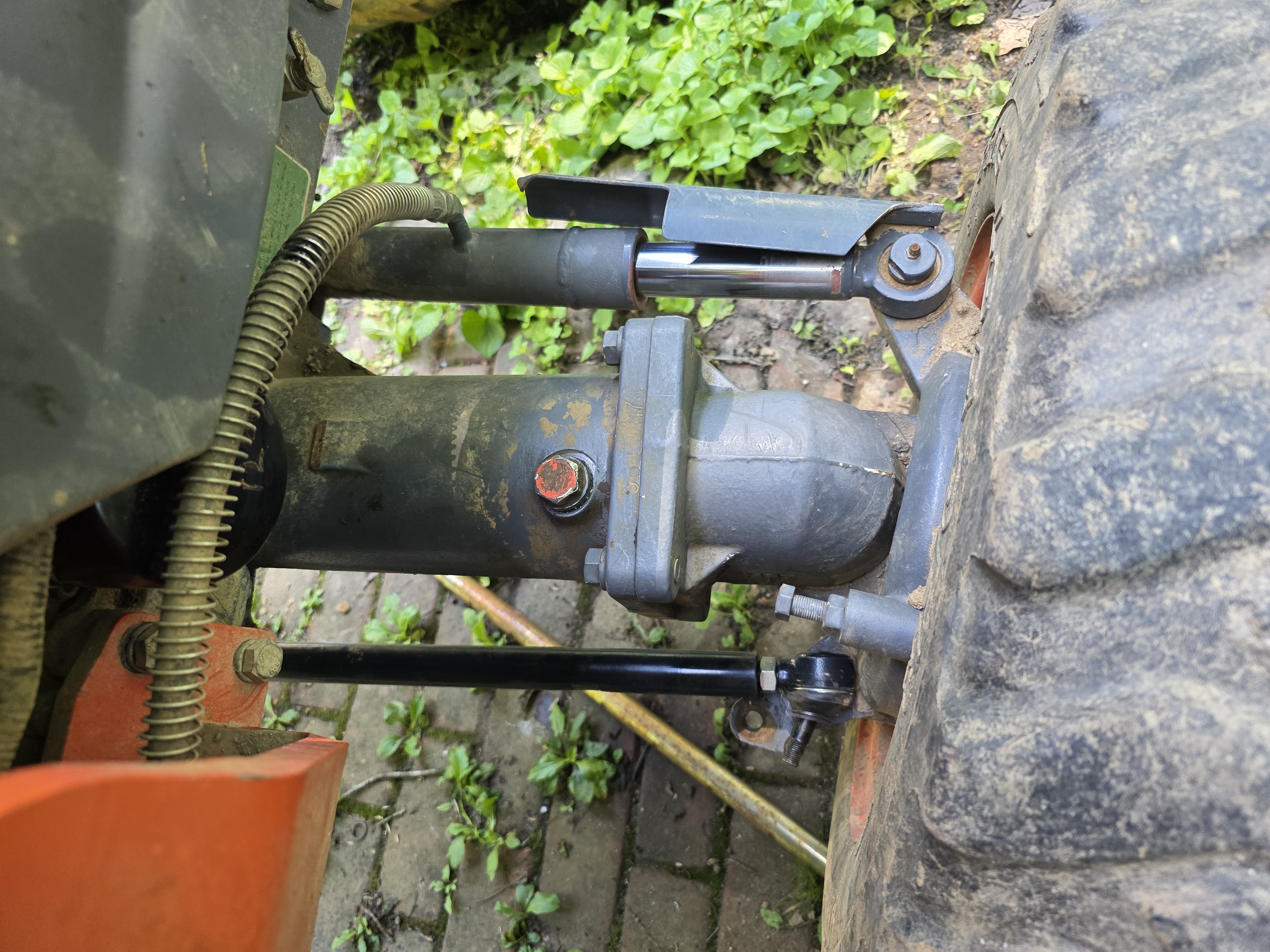

There are two cylinders, one on each side, which each connect to a wheel, and in the middle to a center point. I will take some pictures.

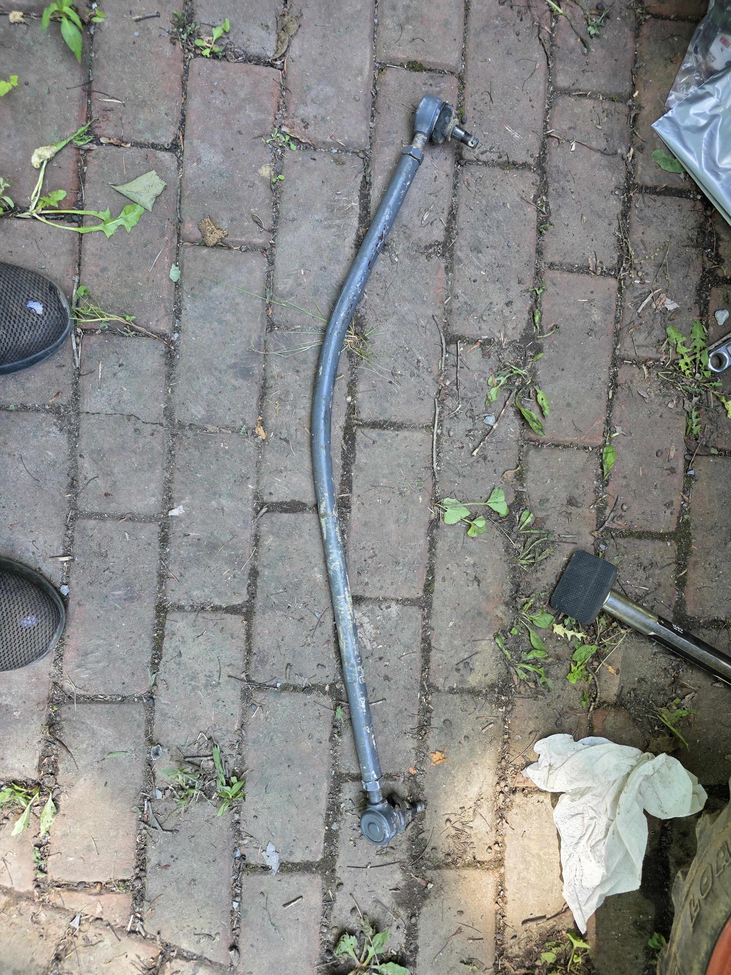

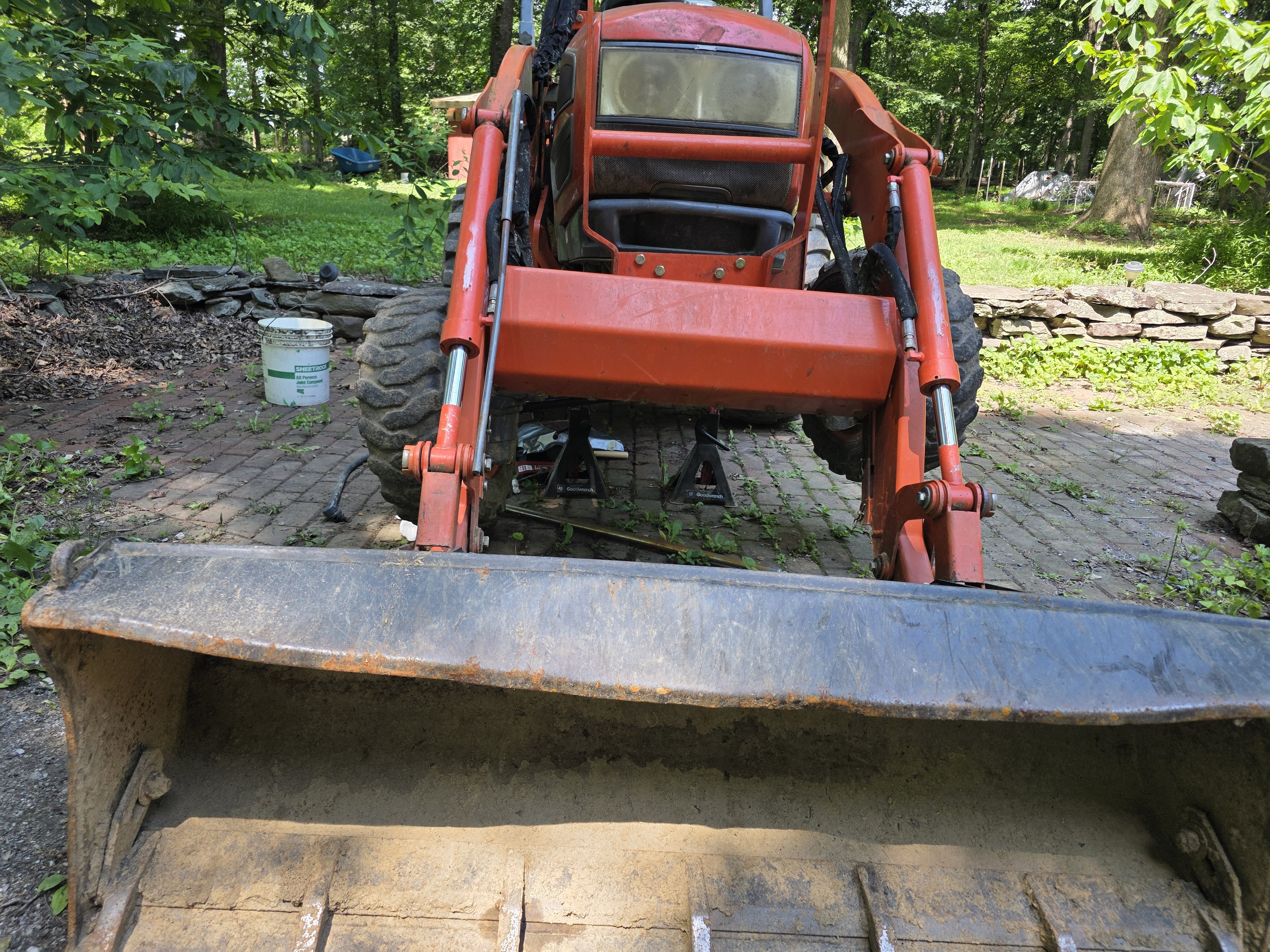

For fun and frivolity, here are three pictures. The first shows the original bent tie rod. The spacing on the tires looks suspiciously like the reduced length of the bent rod. The second shows (but not super clearly) my tractor on stands and the tires a bit toe out (my issue). The last image shows the right front tire and the hydraulic cylinder used for steering on that side (the left side looks similar), as well as the new tie rod at the bottom, resting near the hole it needs to fit into. The left side of the tie rod is seated in that hole, so the distance shown is what I need to recover to mount the tie rod. Then, I will need to expand it by about 3 inches to achieve the correct alignment. That should be nothing more than turning the tie rod to expand its length. The manual states that I need to adjust the toe to between 2 and 8 mm, measured as the difference between the front and rear of the tires from the center of the tire tread pattern.

Im going to guess, that if you arranged to pull the forward part of each front tire toward each other the wheels would come into alignment gradually by hydraulic leakage through the steering circuit. Im talking engine OFF and a moderate pull force of 2 or 3 hundred pounds with a come along.

Looks to me like the loader is racked as well. What were you doing with the tractor? Running into brick walls?
Pushing down trees, I did cave in the top of the bucket a bit. It is a tough tractor, and I haven't been easy on it. The ground isn't super level there, and the jackstands may not be holding the weight evenly.

The walkway is by my driveway, and the driveway slopes downward from left to right in the picture. The left side of the bucket (as shown in the picture) is on the ground, while the right side isn't as firmly on the ground. The Part of it is just the way it is sitting, as you imply. Once I get the tie rod in and get it back down, it's okay.

SPYDERLK, thank you. As I had mentioned, I was trying to figure out how to pull or push the wheels in or out. I was thinking of using spreader bars or clamps, but I couldn't find any that would work effectively. Your mention of using a come-along got me thinking about how I would attach it, and I used a set of fence stretchers. I didn't need the come-along given the leverage they provided. You were right about moving it incrementally. Once I got the tie-rod in, I could twist that by hand a little at a time as well. Thanks again!
