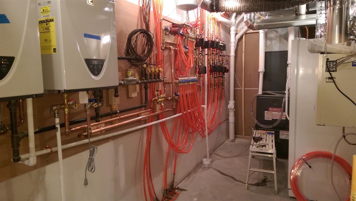

This is my radiant floor heating system:

Who put that system in Mario and Luigi.....:laughing:
   / Making my own 20 KW Genset #47
Nice setup, I hope you have a good schematic of it along with the directions to control and set it up.
If something ever happens and some else has to work on it they would waste a lot of time getting up to speed.
I haven't finished mine and it's simpler then yours but nobody else could work on it efficiently.

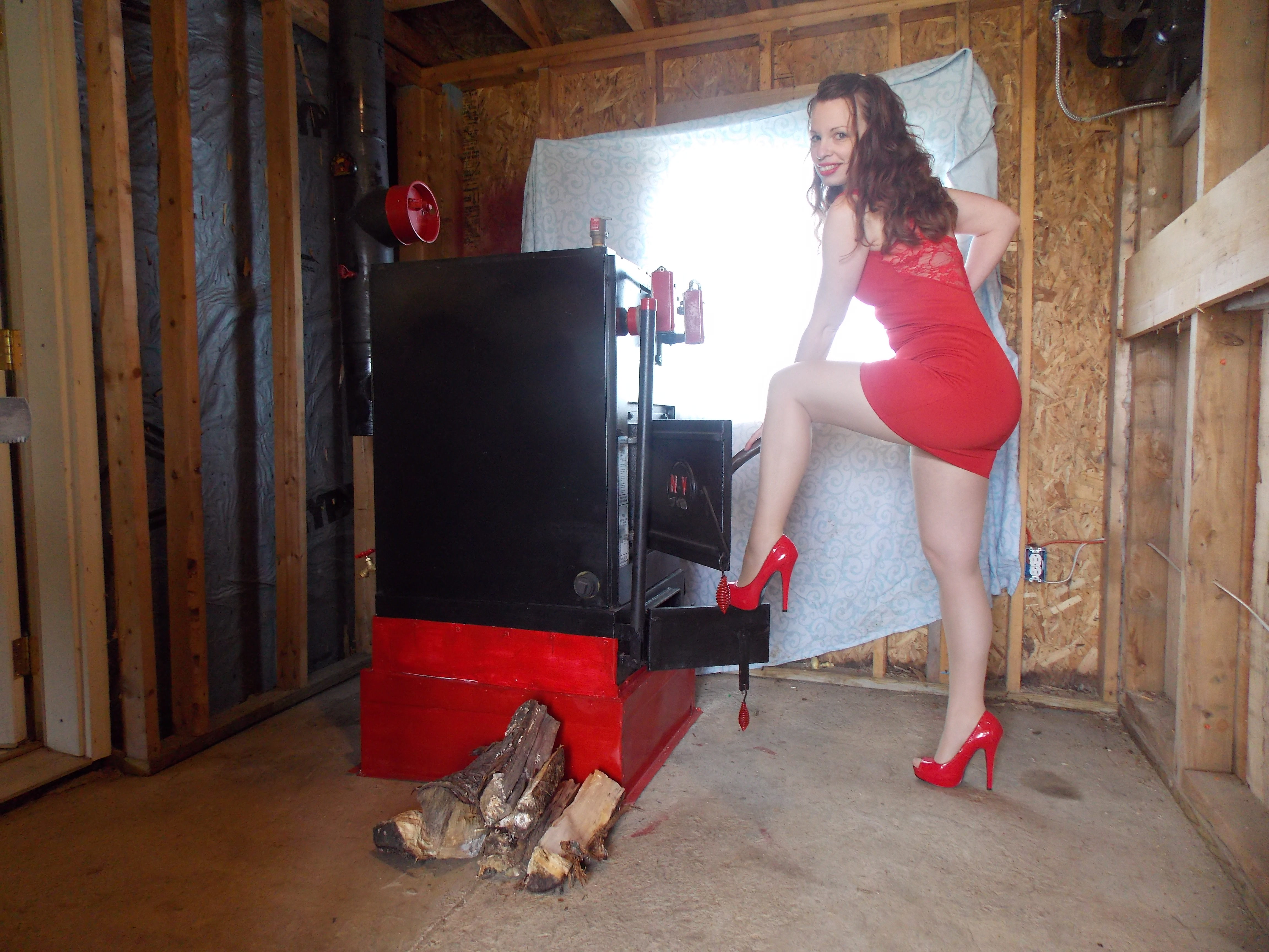

And finally, this is the Firewood/Coal boiler that is sitting next to the genset.
The good thing about the way this whole thing will be set up is; if the engine is down, or the firewood/coal boiler is not being used, the propane boiler in my house will come on, and circulate warm water back through the boiler and engine, and keep them always at 100-150 degrees. That will make the engine easy to start anyway. (Naturally, being a reefer engine, it has exceptionally powerful glow plugs).

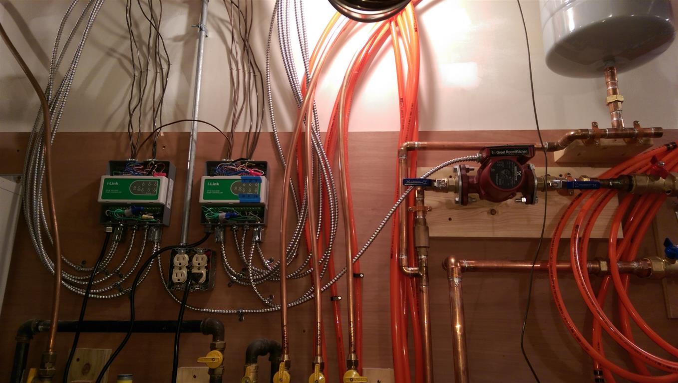

Ha! A man after my own heart.... here's mine:
Edit - that one was before the controls were hooked up. Here they are, positioned between the heaters and the tubing:
The short answer is...no, I do not.
The longer answer is, a few years ago I decided I loved radiant floor heat so much that I would include the front half of the house that was built before radiant floor heat was really well used. The back half of the home had been built after radiant floor heat was well known, so I had half a house on conventional heat, and the back half of the house as radiant floor heat.
But that doubling of size threw off how the system was balanced. I called in (2) different heating techs, four guys in all, and they could not figure it out.
The guys over on the Coal Burning Forum were like, "No one is more motivated to fix this than you, so go for it." So I was grateful for that piece of advice, and in the end I had to go back to my manuals, and reading it through a few times, I figured it out.
But I am slow like that. It takes me a few times to understand things, and how to change things, particularly in the PLC or on programming the boiler parameters. But I did get it eventually. In that way, I am a "chewer", and have to mull things over for awhile.
