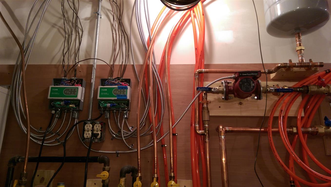

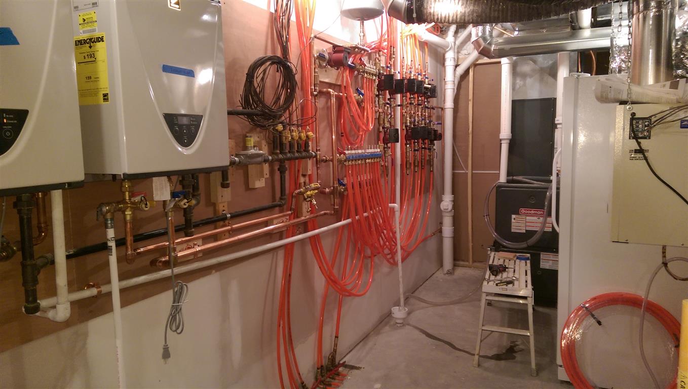

Ha! A man after my own heart.... here's mine:
Edit - that one was before the controls were hooked up. Here they are, positioned between the heaters and the tubing:
Yeah I like this stuff too.

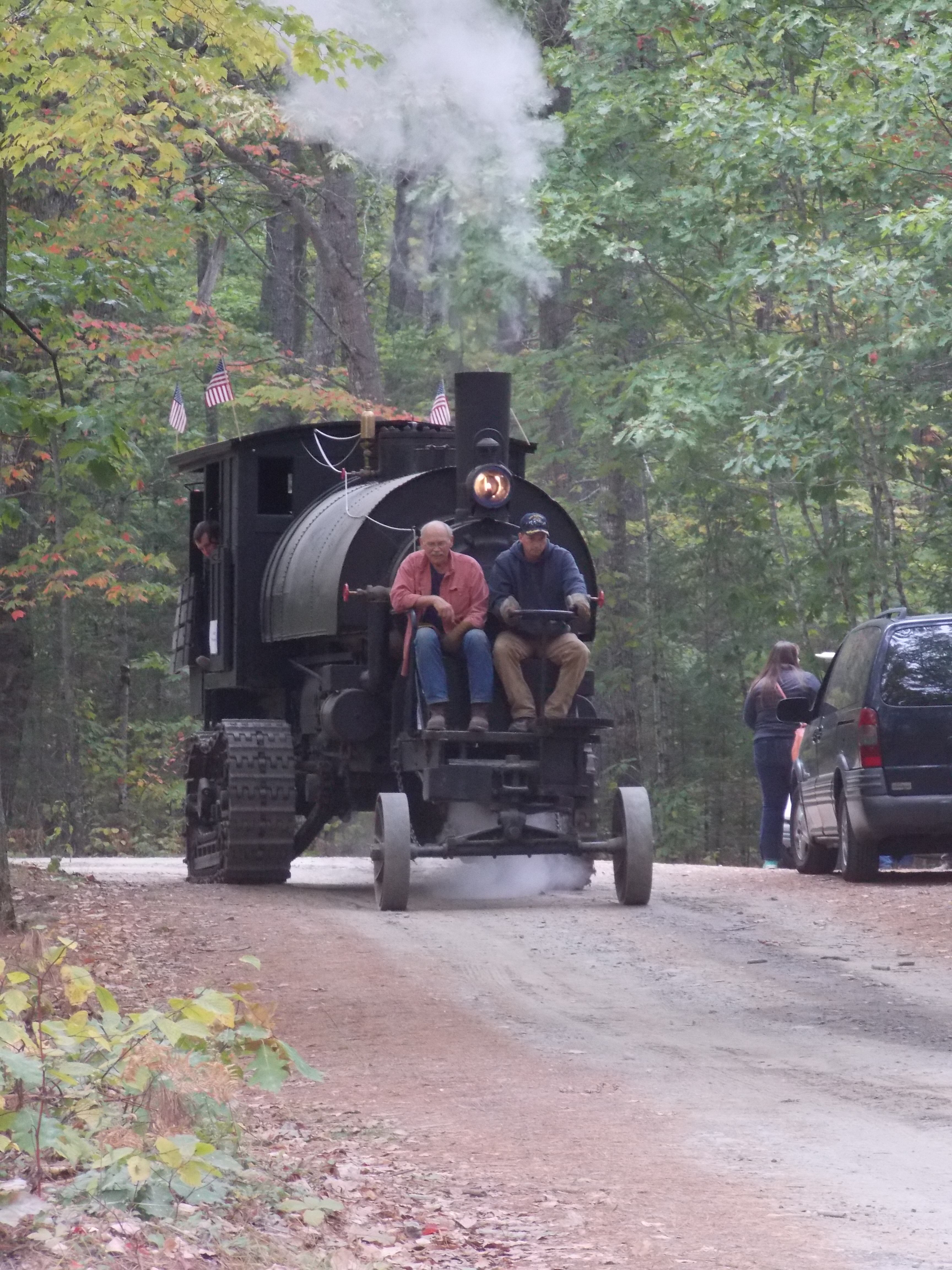

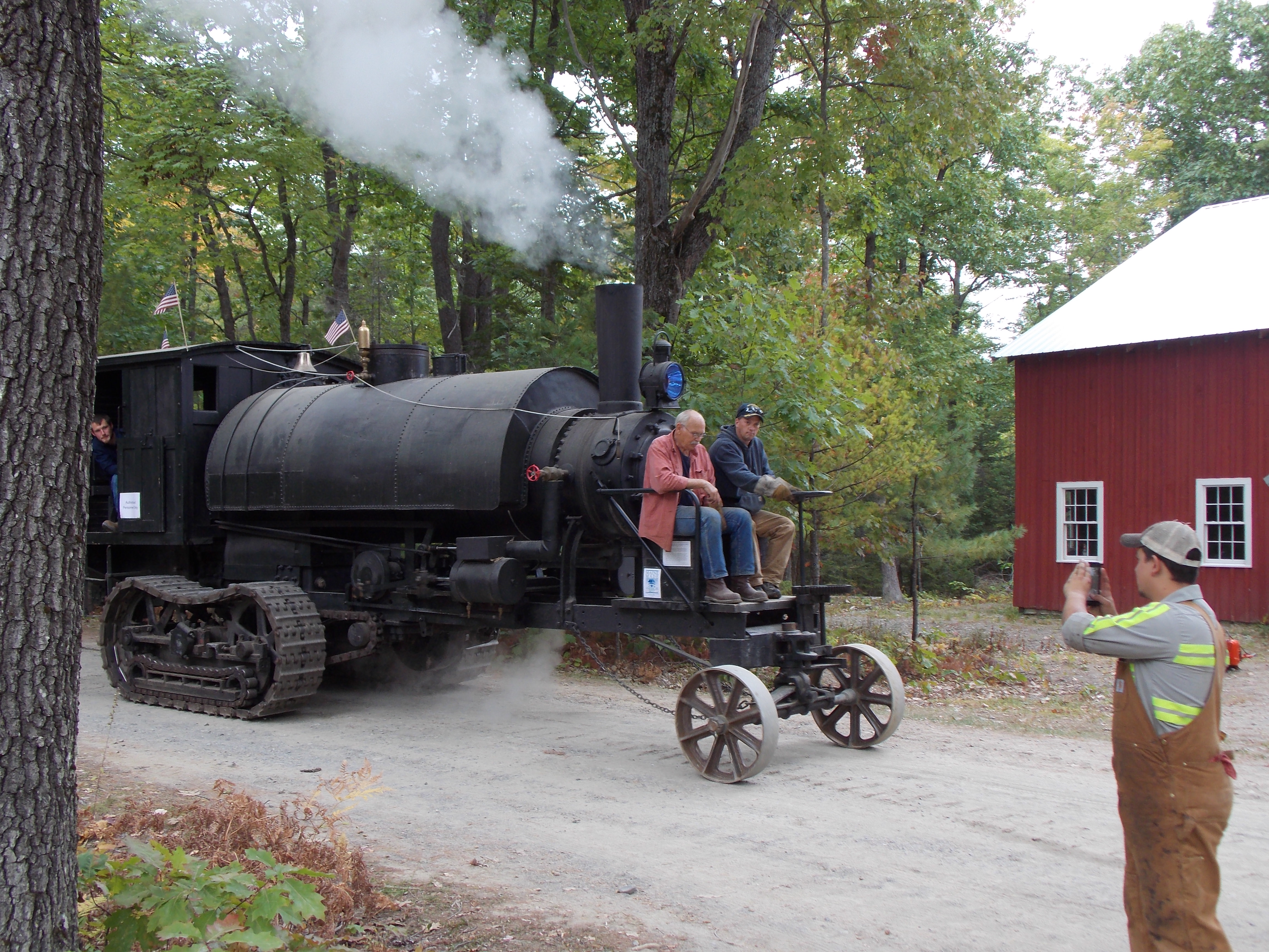

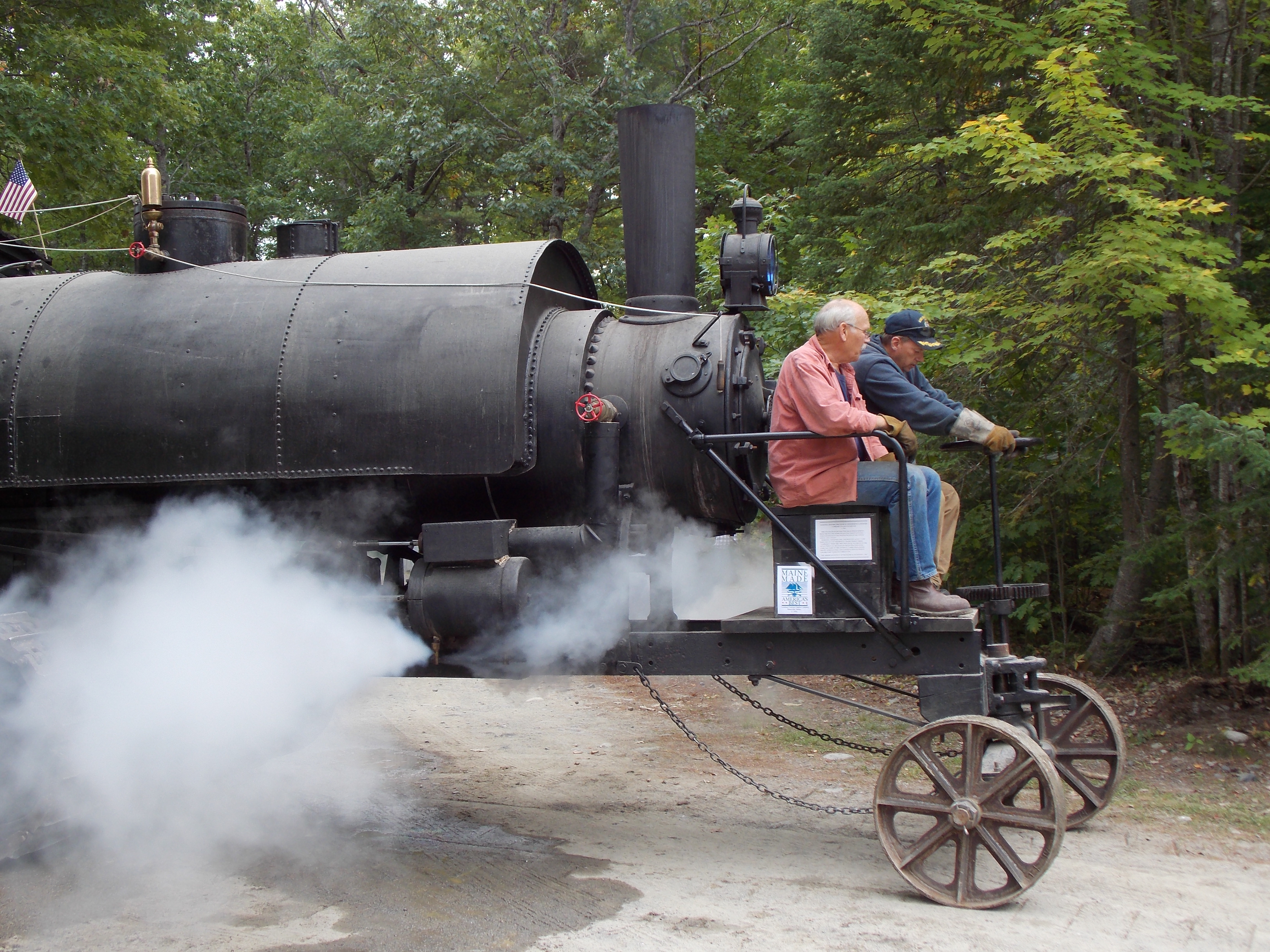

A few years ago I did get to play around with steam though...well sort of: I got to steer the ole gal. And old is the truth. I think it is 100 years old, but the State of Maine rebuilt this Lombard Log Hauler, and said since taxpayers paid to rebuild it, taxpayers could enjoy it, so when they dig it out, they give rides, and let the public steer it if they want to. I jumped at the chance.
I have driven a lot of tractors, but never a steam powered bulldozer!

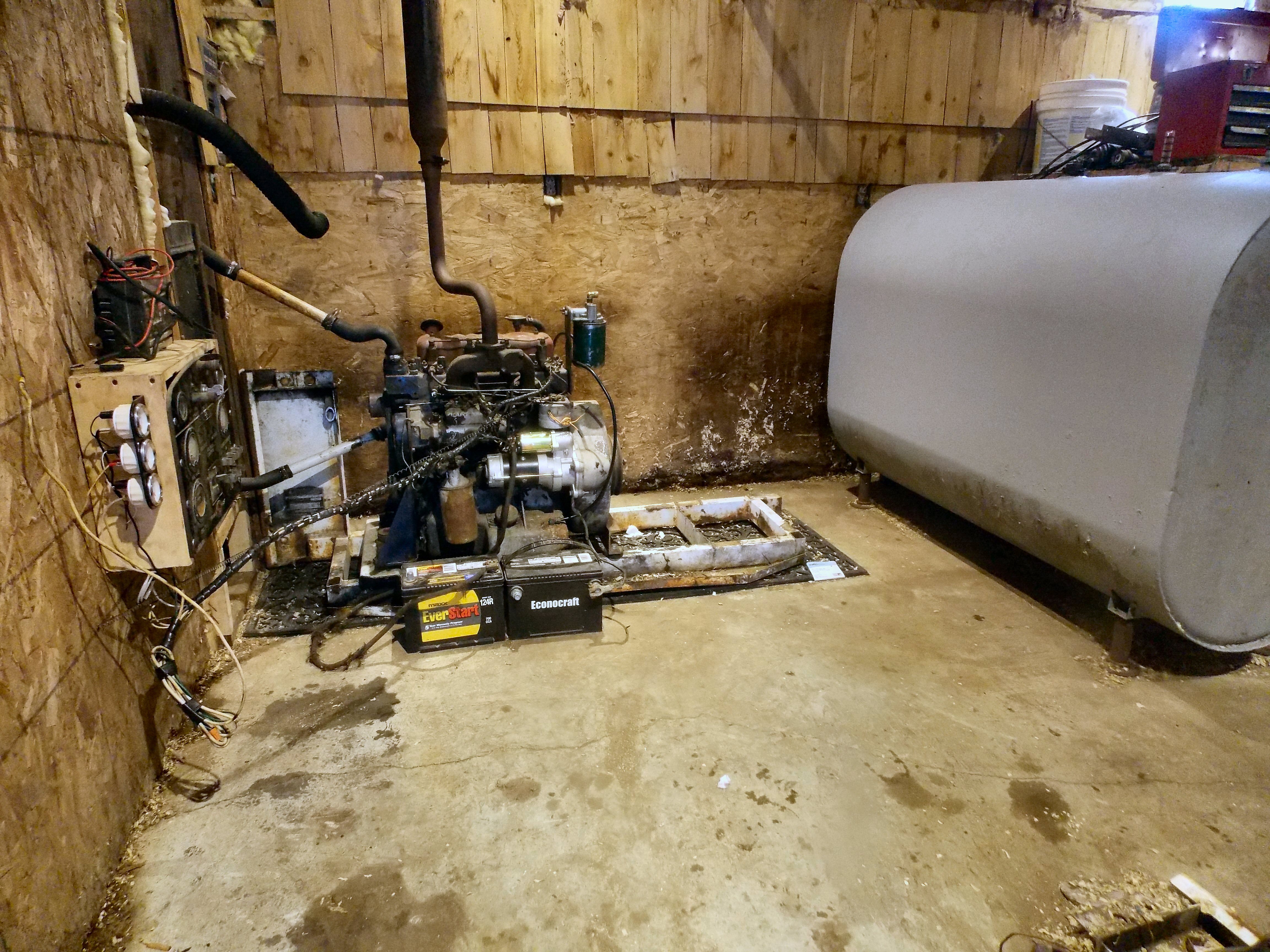

It is amazing the stuff a person can find if they just go looking for it. The engine itself was a barn-find, so I figured in the spirit of things I minds well find as much as I can to make the engine go.
I went looking for some parts for the coolant system and managed to find the radiator and hoses for it. So I cut a hole through the wall for the radiator and mounted that, then cut a hole for the air intake. I then bolted the radiator to the wall figuring it was easier to plumb the radiator lines to the radiator, then it was to duct the expelled heat through a plenum out the wall. It will mean I will need (2) 12 inch electric fans instead of and engine driven one, but with it being a generator, I always have 120 volts available to me.
I even managed to find the right size belt, it having to be super tight since there is no alternator on this thing, but rather a battery-tender to help keep the battery charged. If nothing else, it removes as many parasitic loads on the engine. The only "load" being the belt running from the crankshaft to the water pump. It just had to be stretched super tight over the pulleys since there is no way to tension the belt via alternator. But I actually found a belt I had kicking around. Wonders never cease.
Surprisingly, I thought a longer air intake hose would be easy enough to find, but I struck out. But in looking up at the old sawmill, I did find a pile of exhaust pipe. One piece was only bent to about 45 degrees, and I needed 90 degrees, so I made a makeshift wood bender, and bent the pipe to 90 degrees using my barn posts, and a lining bar. Now I just need a muffler clamp to make the connection leakproof.

My orginal intent was to put a cow stall mat under this engine to isolate it from vibration. Tractor Supply has them for $46, but the other Day we were at Home Depot, and they had these really thick door mats on sale for half price. So I bought them instead. They were $12 for (2) mats and plenty big enough to sit the generator/engine on top of. So I used my trusty lining bar, some wedges, and managed to lift the engine up to slide the rubber mats underneath it.
Now I have to get some anchor bolts and bolt this unit to the concrete floor and walls of the generator shed so it does not move.

Well I finally went out and got some photos of the Cogenerating Unit I am building.
It bothers me to show pictures of it in a way because I always think, "I should do this before I post a picture of it, or I should do that", but then I end up having no start and finish pictures. In that sense, it is always good to show where you started, and the build along the way; no matter how bad it may look!
The only thing I think I will change is the tank arrangement. Right now it is inside the generator shed, which is good, but if it was outside it would give me more room, AND allow me to fuel up my tractor as well. It would also help me align the fuel lines a little better, and be easier for the fuel delivery man to get too. So a lot of benefit, except, fuel can gel when it gets really cold. But I guess there is ways to prevent that.
So this is what I got so far...
