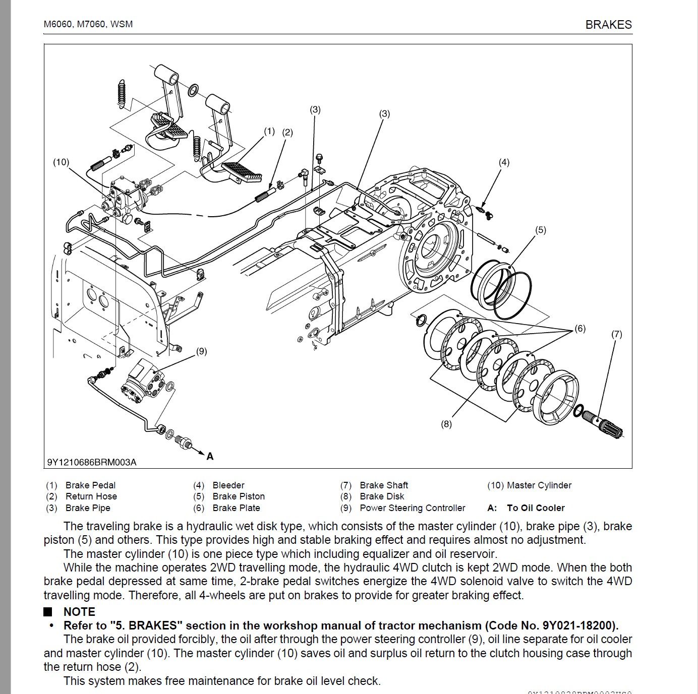

Wow sorry for the late response, I ended up getting an M7060HDC12 new from forum member Art White at Whites farm supply. I have almost 1000 hrs on it now, and it has been perfect. No break issues. What I learned is that the issue seemed to be from improper dealer setup. It seems that the new machines require a very long initial bleeding that I was told requires the tractor to run for quite a while after adding hydraulic fluid. Looks like this step was being overlooked. The 7060 is great, I currently use it most often with a land pride hydraulic back blade rbt 40108 and a 60" HD grapple from titan ripping and tearing on my property.
   / M7060 HDC12 New Owner, or recent shopper info needed #48
Here is how brakes work, probably never bleed at factory. Mine are rock solid

Interesting that the diagrams above show 3 disks per side and the brakes are reported very good and all is OK. Obviously a total different machine but my 2011 MF2660 was delivered with 4 disks per side and would not hold the tractor on a hillside (40% slope). It would creep and could not be totally stopped. Massey/AGCO knew it and apparently delivered thousands of them with such marginal brakes waiting to see who complained (!) When the issue was raised to a dealer AGCO paid for breaking the tractor apart and installing a 5th disk on each side. Major mod to the tractor. I had a friend with the same model, same problem and same solution.
Just interesting that the Massey took 5 disks per side to provide decent brakes yet here is a Kubota M7060 model that does just fine with only 3 disks per side. One has to think "better design."

Yes some Kubota tractors such as M7060 had rear brake disk operating in hyd oil with master filled by hyd oil supplied by hyd pump. JD tractors have had similar type wet brakes/master cylinder since 1961
   / M7060 HDC12 New Owner, or recent shopper info needed #53
Second thread today suggesting a link between Kubota BRAKES and transmission fluid. Are they really running hydraulic brakes using transmission fluid instead of brake fluid !?
Yes they do, the trans oil goes through the steering then keeps the brakes master cylinder replenished.
