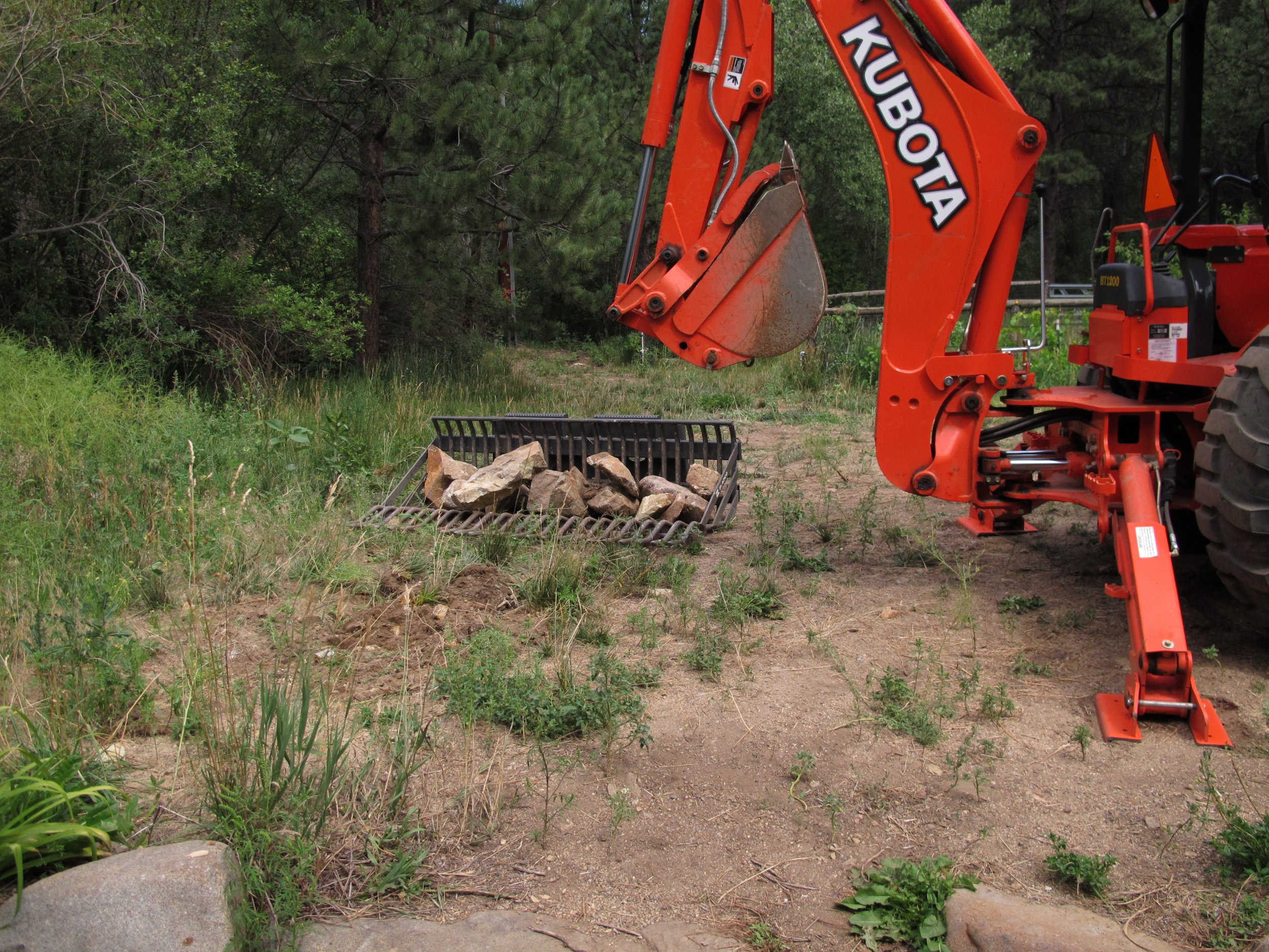

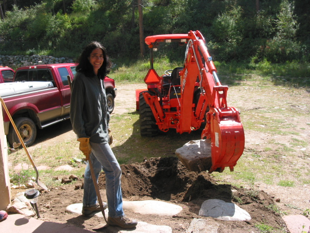

We live on a few acres remotely in the Rocky Mountains. Not farmers, but we have animals including horses at times. We like to build things including our house & pond - and landscape the surrounding acres. We like to build rock walls and make landscape features
We have had a dozen tractors over the past 50 years - mostly used but a few new - and our conclusion is that we needed something more versatile than a traditional tractor and implements. In 2008 my wife insisted that we owed ourself a new tractor and that we get one that would do the kind of work we did ourself....but were getting too old to do by muscle alone.
It turned out to be the year that the M59 came out. We bought it and have used it hard - but never abused it - ever since. It is marvelous machine.
Heavily built, easy to use, nice simple controls, visibility, powerful.... no real downsides.
Has only needed the most minimal repair = one cable, one battery, & one hose - starts and runs strong in any weather. Get the thumb, a large and an 18" backhoe bucket, a rock bucket (SSQA) for the front, the three point kit, and a really nice back blade if you wish. Although frankly I never put the back blade on since the front loader is so powerful and versatile.
You won't go wrong with that machine, and they hold their value. So even if you decide on a different one you will still be in a good position.

Oh, BTW... you hear a lot about digging with backhoes and of course all backhoes do that pretty well. The M59 is almost - not quite - up to commercial duty in that dept. But honestly, we use ours more as a sort of portable crane for lifting, carrying, and placing heavy loads from stacking logs to building rock walls. Some digging, of course....
And yes, a skid steer coupled with a mini-excavator combo will certainly outwork the M59. But not by as much as you might think. Not that we care. We work on our land because we like to do so. We are looking for enjoyment, not for speed. And the M59 is comfortable - even for a short bit of traveling with two in the cab (one standing).
And when it comes time to move buckets of material like dirt and rocks from down the road at the other end of the property the tractor is the much better choice.
