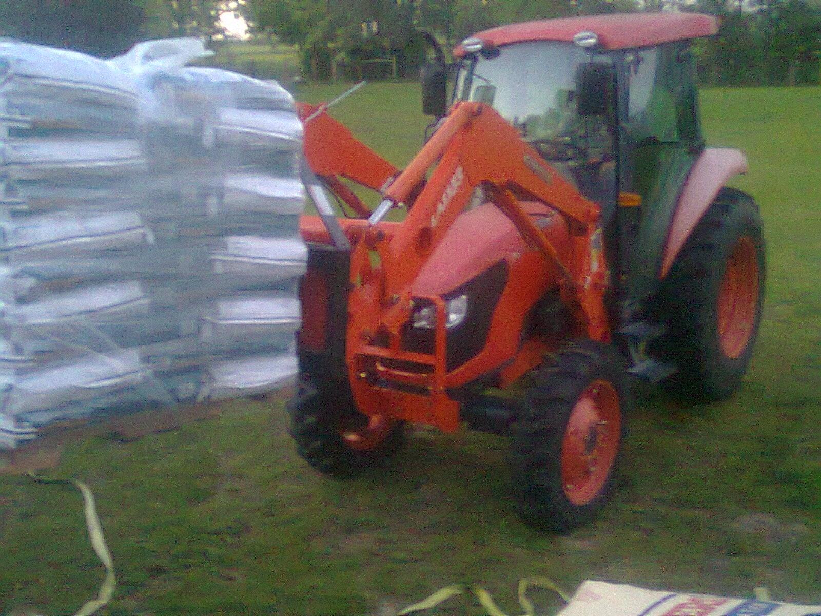

I had rears loaded and it was still alittle light,couple more hundred of wheel weights would be good. I had a 700lb box blade on back
Sorry for all the questions. If that tractor will lift 2400# with only 700 lbs of ballast, I may be good to go.
Without the box blade attached, and just loaded tires, if you scooped a bucket of something like crusher run, what would happen. Would the rear just get light or would they lift off the ground ? I'm guessing but I would think that the bucket is about 1/3 yard so maybe 700-800# of stone??

I load round bales 4x5 around 900-1000lbs with just loaded tires nothing on back without any problems.. The issue when you get around the ton mark is the rears slipping and I could run in 4x4 to help out with traction. I felt comfortable picking my artic cat prowler up with the forks and driving up my gooseneck to load them at same time,with nothing on 3point(guessing 1200lbs). I also widened mine out some for stability,the 5040 was a very stout tractor,that never gave me any troubles.

kubota%205040.jpg only picture have on blackberry,rest on laptop at office.
/ M5640SU #28
Well OK, I'll bite. How did you set it down once you got it up on the trailer?

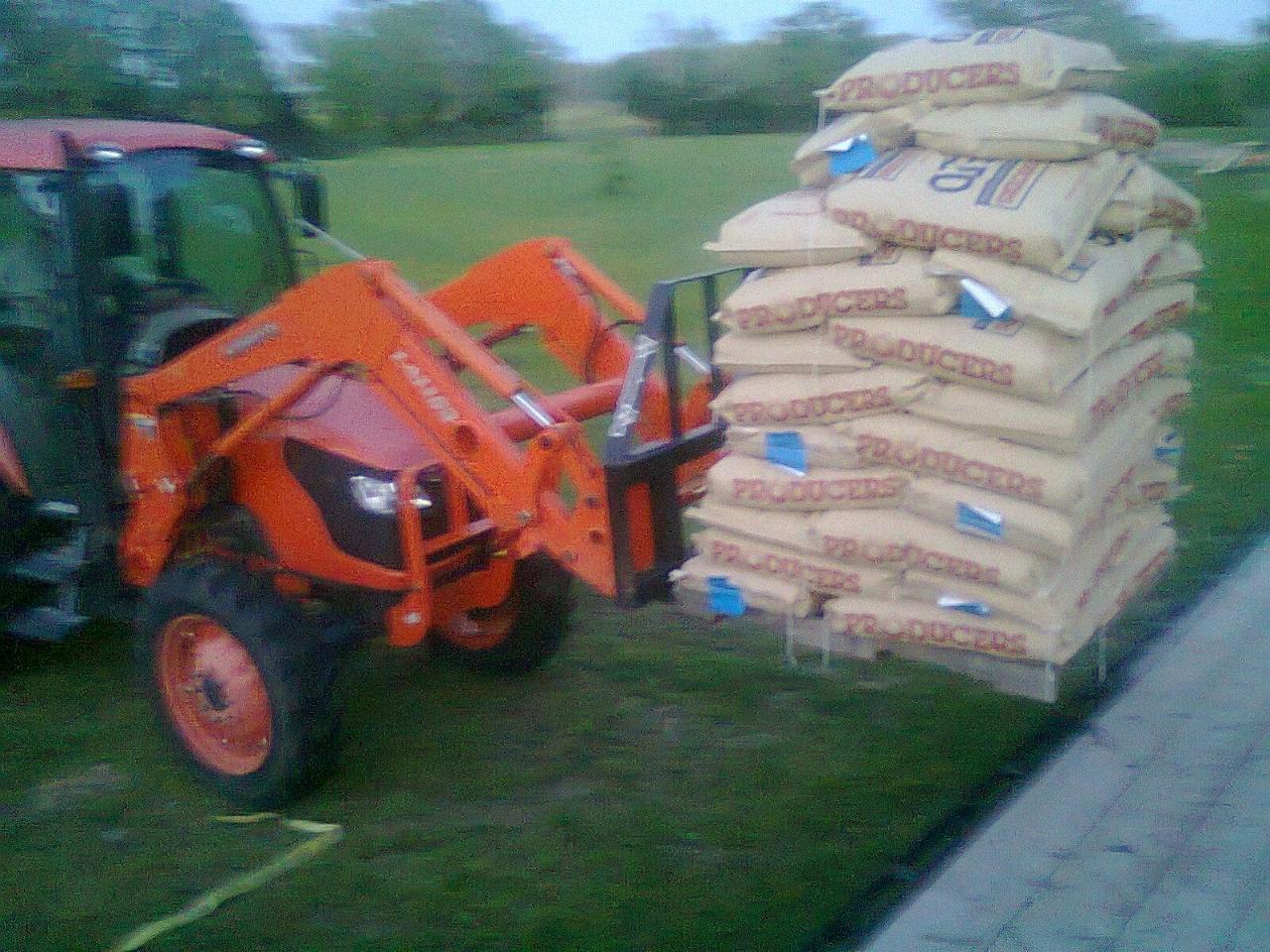

My tractor in picture just had loaded rears,picking up the prowler. Here are some with the 7040 without loaded tires unloading my feed one pallet is 2,000 and the other is 2400lbs
My other 7040 has loaded rears and it handles them way better...

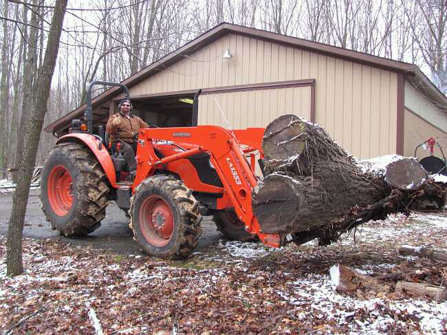

In the attached picture i have an 8ft piece of swamp oak that measured 36" at the small end and about 48" across the y i have no rear ballast as i had to pull out of a tight spot earlier that day. This log wet weighed in excess of 3300 lbs i had no trouble moving it in 4wd. My rears tires were almost off the ground just look at the picture. The rear wheels bounced off the ground upon lowering the loader and stopping to abruptly.
Without 3pt weight my tractor weighs in at about 10000 lbs.
View attachment 305205View attachment 305206
My other 7040 has loaded rears and it handles them way better...[/QUOTE]
Impressive! One picture is truly worth a thousand words.
Now after lowering the load if you needed to travel up a slope, I imagine you would need 4wd, or ballast. Yes?
Just the weight of the cab must help some.
Are those bags empty?:laughing:
