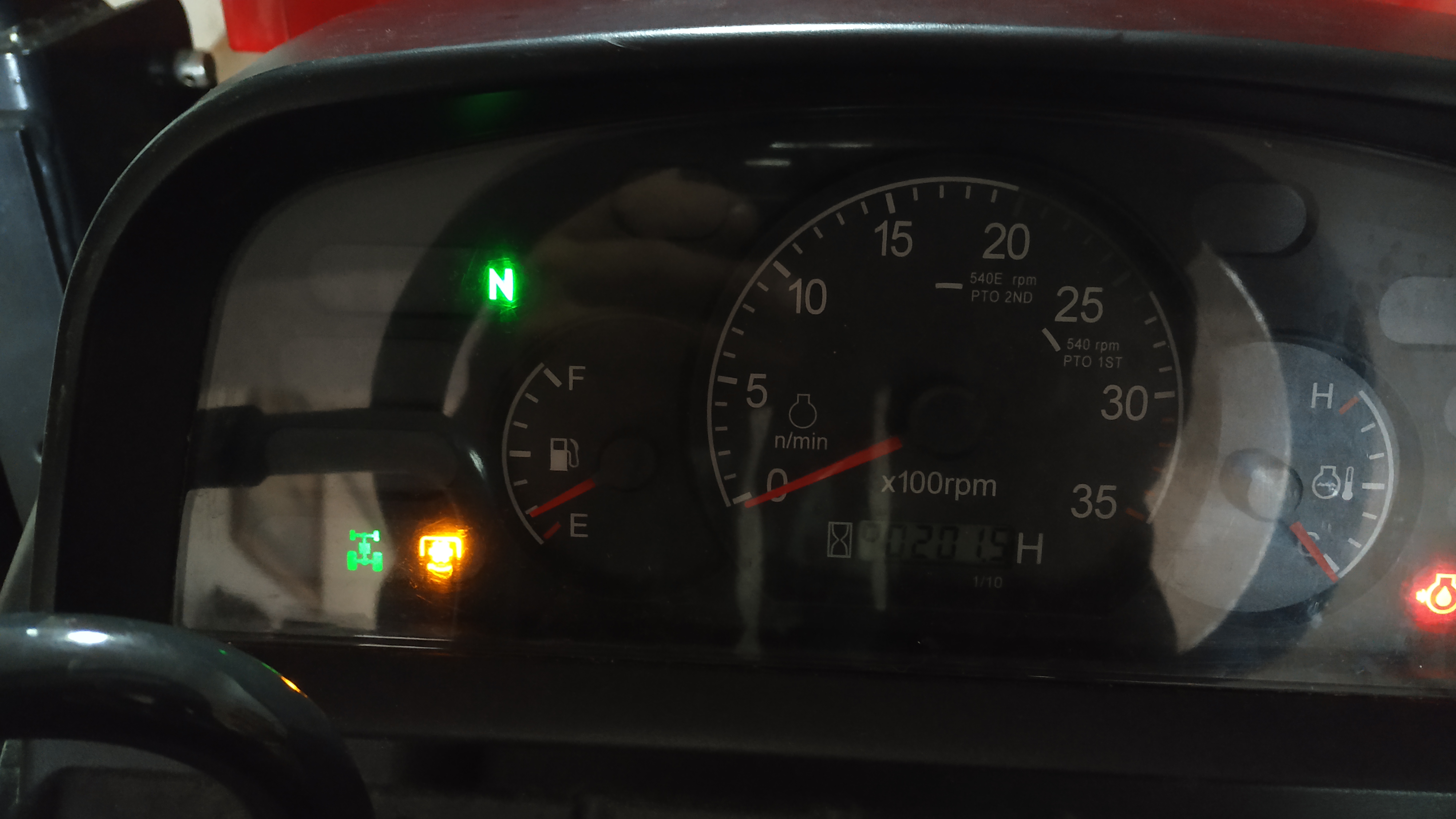

I壇 like to see how. Thanks.
Here is the post I made for the 4WD:
https://www.tractorbynet.com/forums/century-branson/422408-parking-brake-light-5.html#post5683737

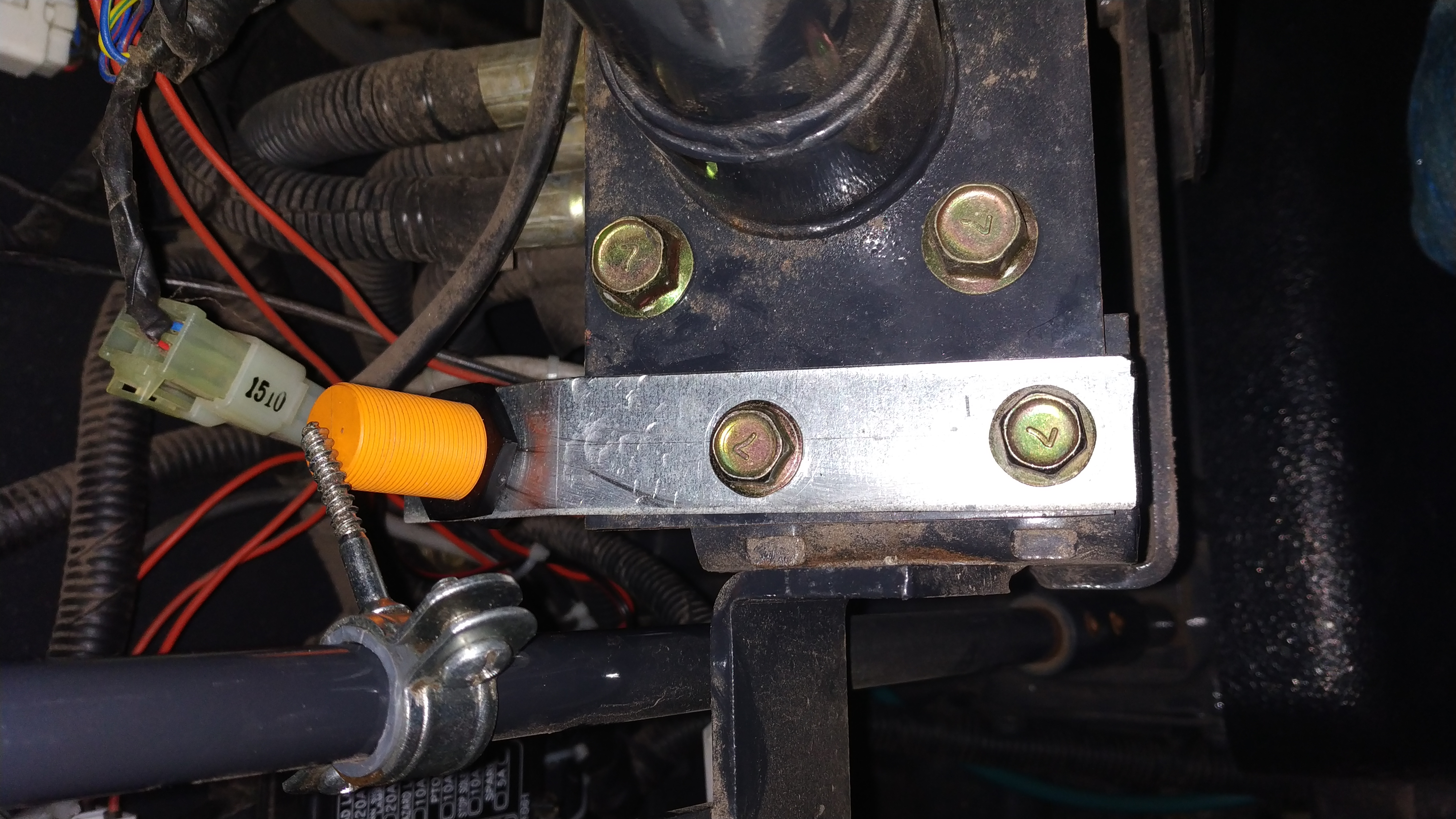

I thought I had one for the Neutral light but turns out I don't.
It's quite a simple setup.
Just a little bracket for the proximity switch near the shuttle lever rod. A simple clamp on the rod moves over the switch, causing it to detect when it's in neutral or not. The shuttle lever just rotates left and right.
I only managed to do this because I had the pinout of the dash plug, that also indicated the polarity of each pin. It also has lights for the High range and 3 pt max height but I didn't bother to install more switches or connect those.
