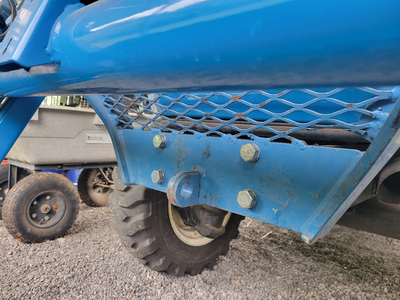

I also want more protection for brush and to add some holes for chains. I hate chaining over the axle to haul.
I had expanded metal added to my bush guard and a clevis that I can put a shackle on to run chain through for transport. Guess you could weld a grab hook there since you take your bucket off.
