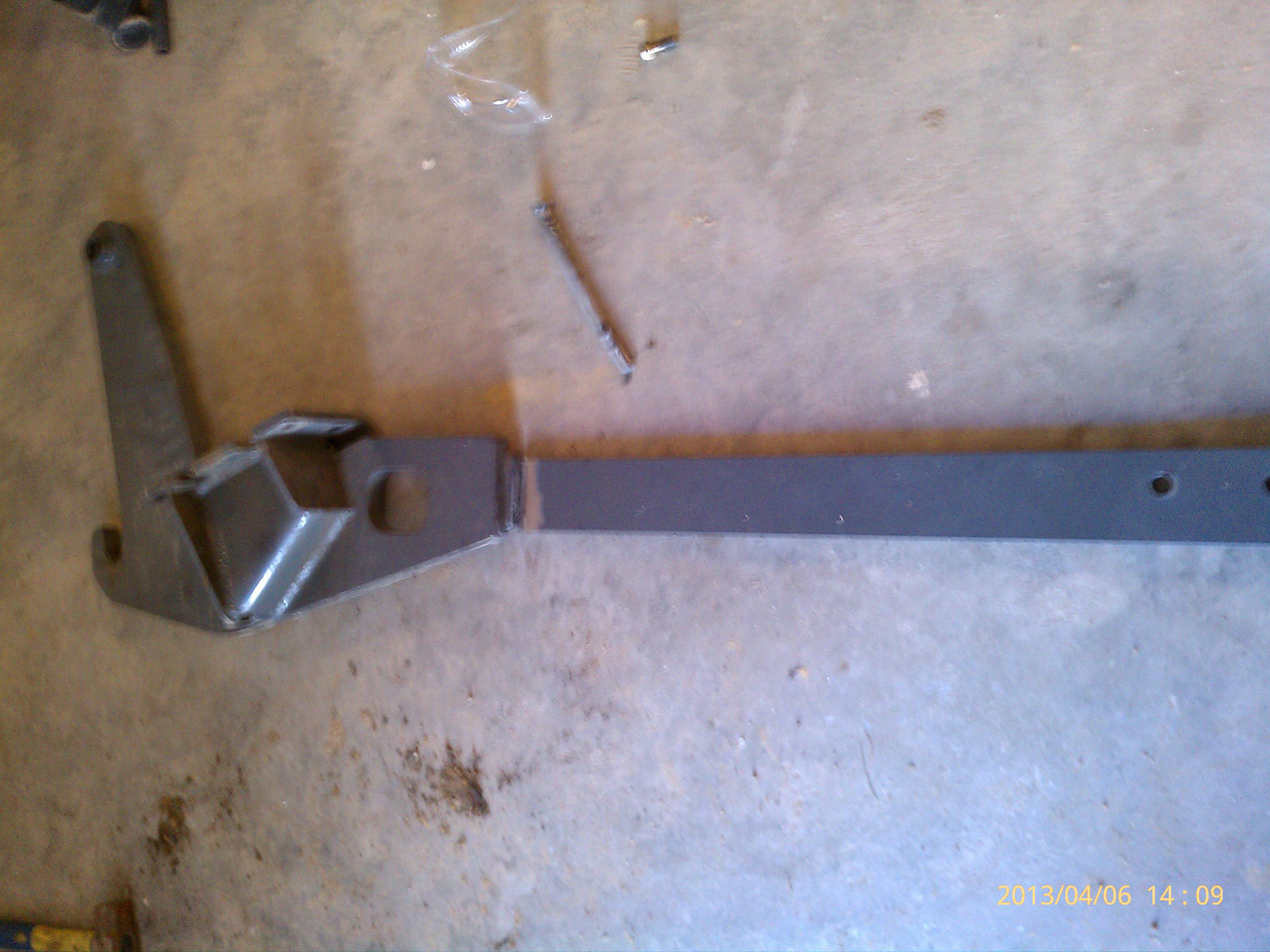

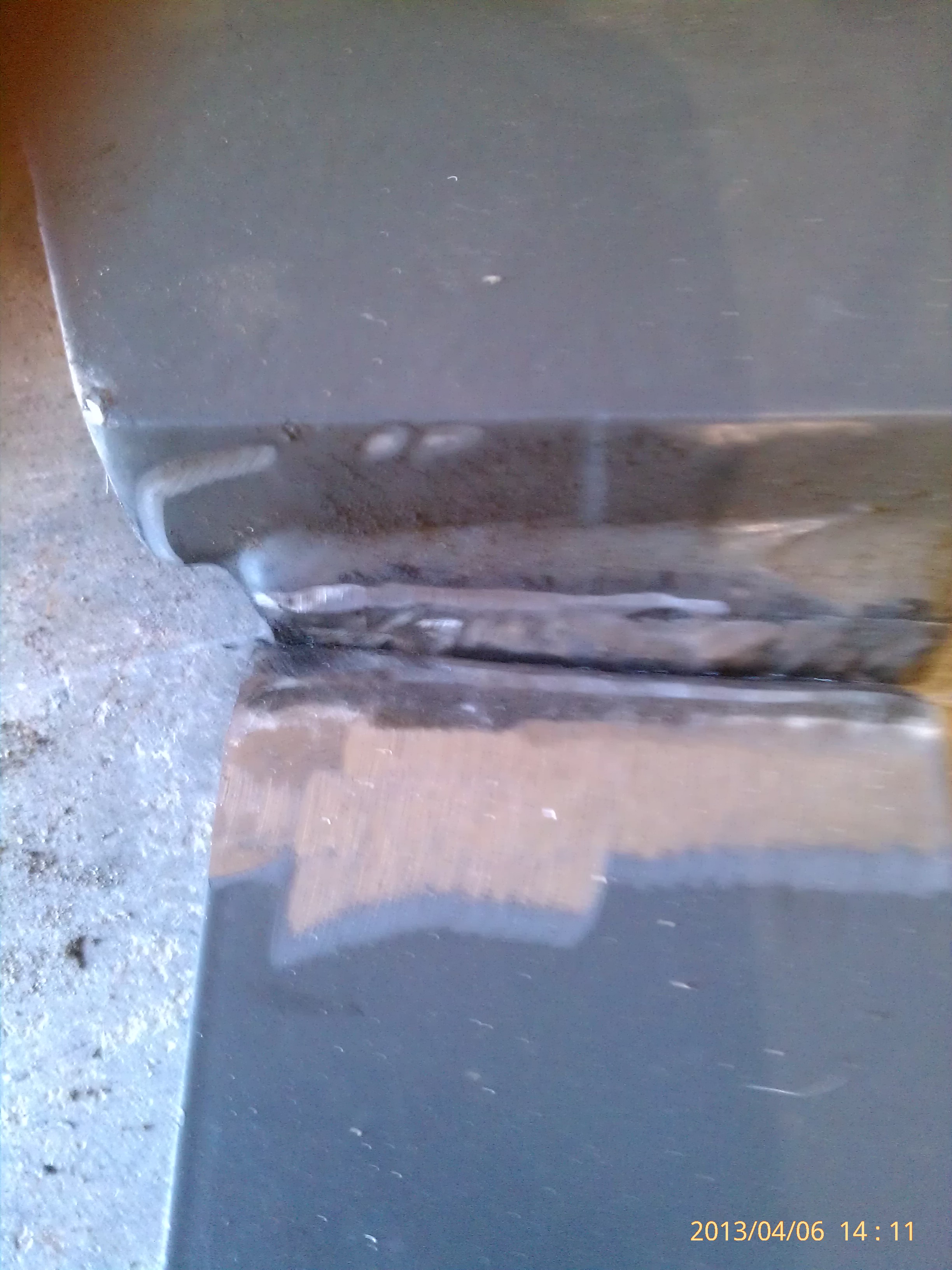

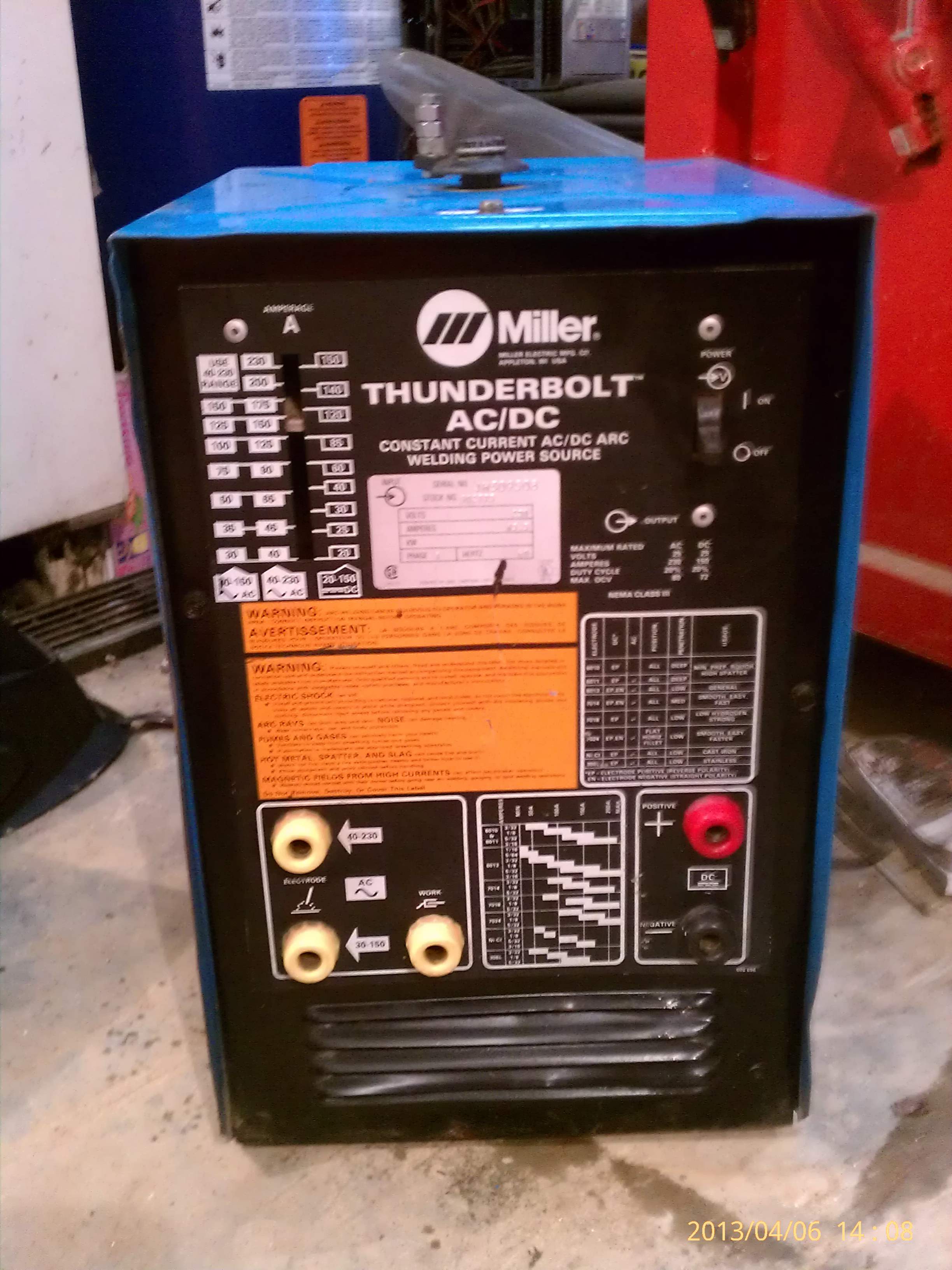

Hi all, My sub frame broke on my MF 1533 backhoe. IMAG0141.jpgIMAG0145.jpg I'm not the greatest at welding so i am asking the pro's how to go about this don't really feel like spending 500.00 for another one, plus they told me its back ordered. I bought this welder from a buddy for 75.00IMAG0138.jpg Thanks to all. Darryl
/ Looking for tips #2

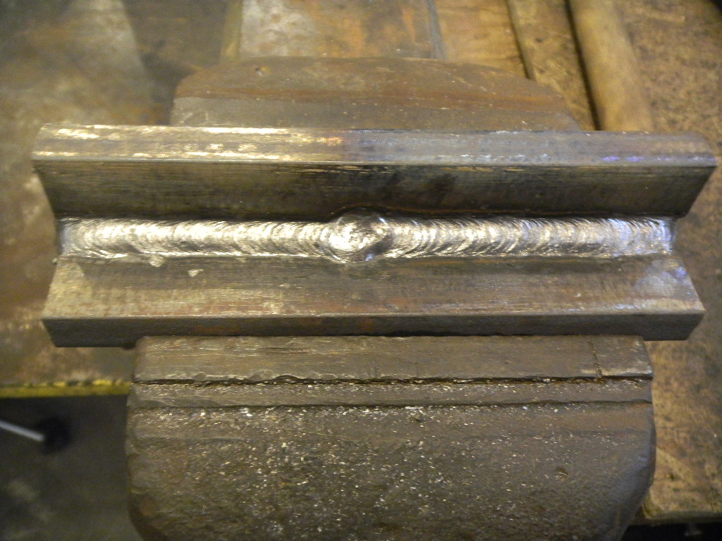

Grind all the broken weld off. Grind a pretty good bevel on the longer piece, and use some 1/8-inch 7018, looks like it will take 3-passes, (or more) all the way around. I would try to have my stops in the center, not near the edge. Maybe this picture will make it more clear about stopping in the center, not on the edge.

I get what you are saying and thank you. how many amps. should I use. And when they say reverse polarity on DC does the electrode plug in - and the ground go in +. I am all new to this. Its 1/2 steel and is this welder good enough? thanks again
/ Looking for tips #4
No doubt that welder is more than "good enough"! And you got that for 75 bucks?!?! That was a GIFT!

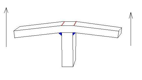

You want the stinger, (electrode holder) to plug into the + side. The ground, (work) clamp will plug into the - side. Roughly 120-AMPs should be fine if welding in the flat position. I've never used one of those welders, seen them is all. They are suppose to be very good machines! Remember when doing multiple passes you want to keep everything really clean! Chip all the slag out, then wire brush real good. Make sure you fill in the craters well. Craters are a notorious weak spot in a weld. You'll want to monitor the alignment of this frame. When the welds cool they will pull. See in this picture the blue welds pulled the square tube down? To correct you would have to put heat on top, (red lines) of the square tube to correct the pull. But in this case you would add weld on the other side.
