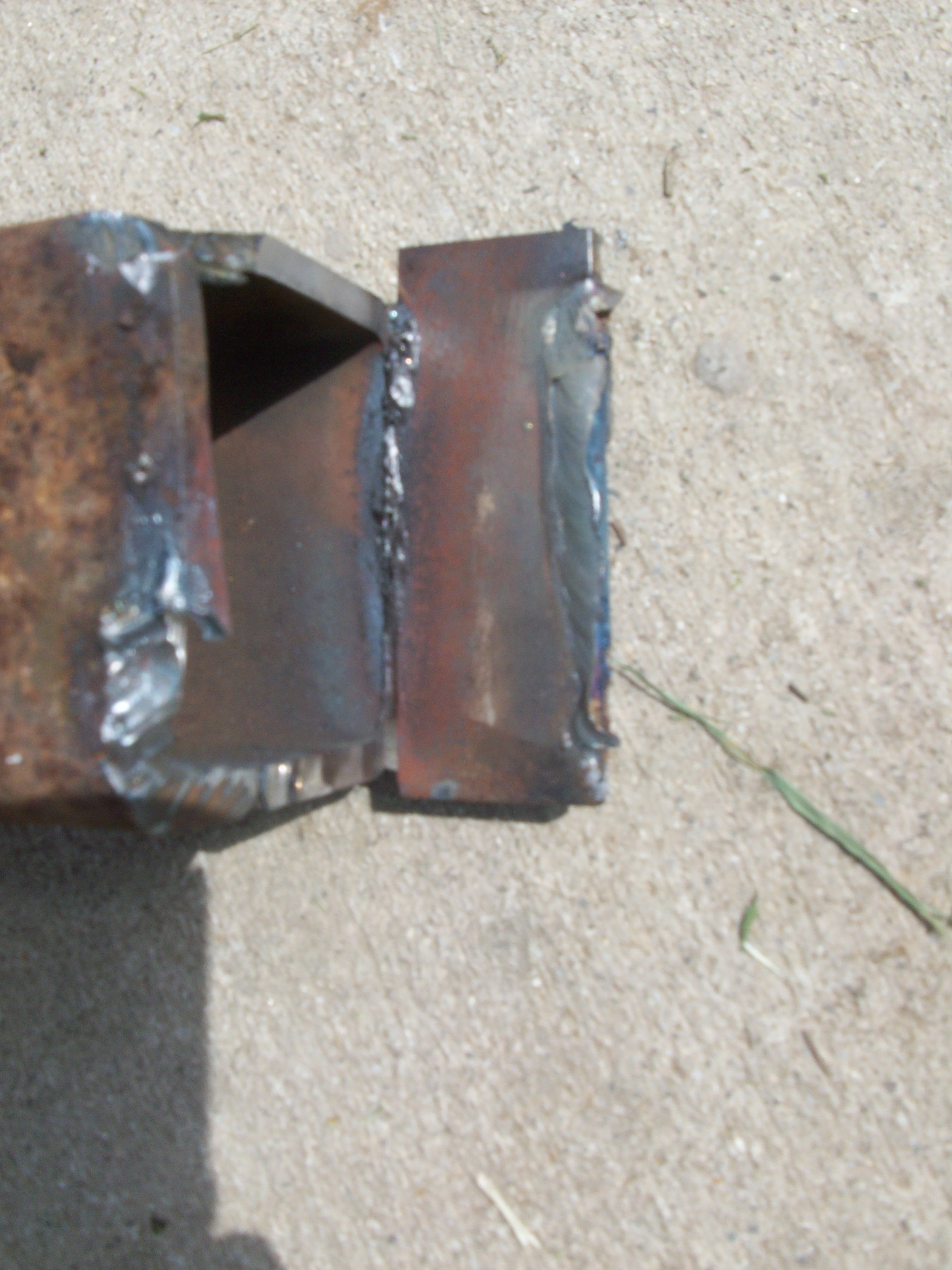

This is an interesting thread. I’ve been gardening all week so thought I’d “experiment” for myself.
I only had a 50 foot 12 gauge cord so keep that in mind.
Conditions:
20 amp breaker
Miller Maxstar 150 STL using 110volt
Lincoln 3/32” and 1/8” rods. NOT from rod oven.
1/4” plate
80 amps for the 3/32”
115 amp for the 1/8”
I LIKE to think I can do better with a 220V welder, adjustable arc force and rods out of the oven but I’m sure a real weldor would do just fine under these conditions.

Here’s the same welder set up with same amperage using the remainder of the 1/8” 7018 rod. This time using 220volt.
WAY easier arc strike and running of the arc.

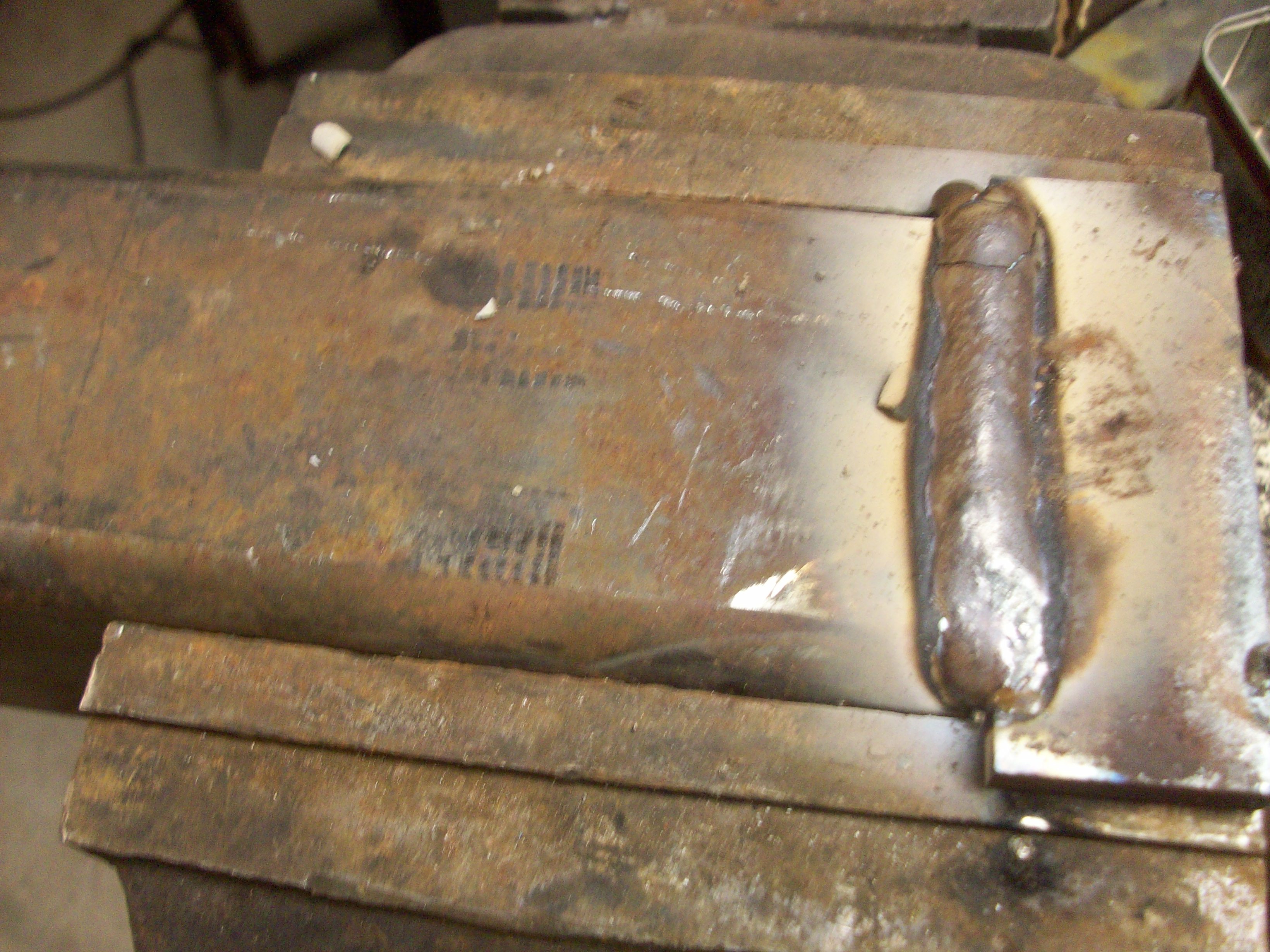

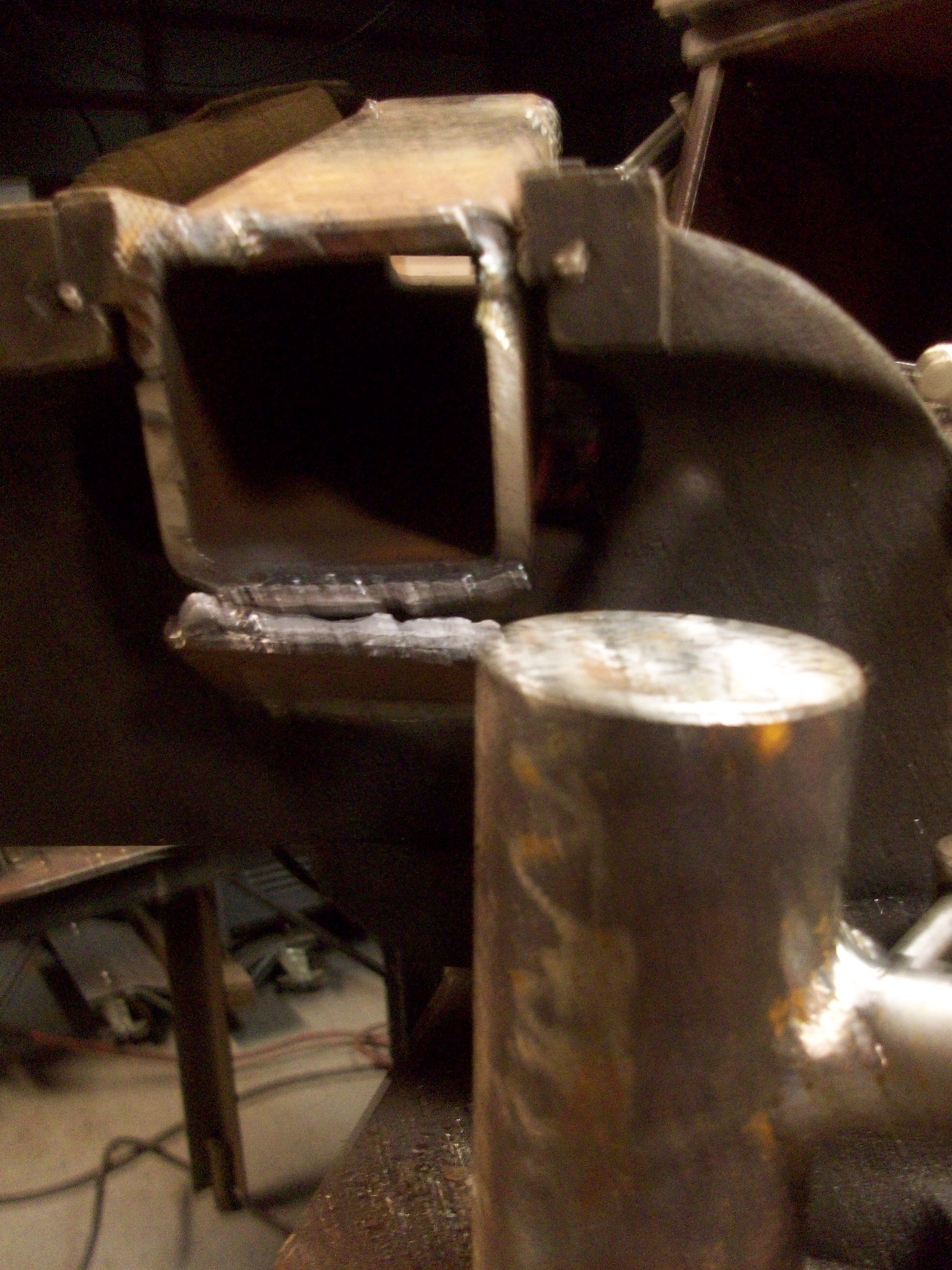

I went back and found some 1/4 inch pieces and gave it another go - reduced the power and just went a bit slower with a small gap between metals using garage kept 7018 same 120Vac thru 100 foot cord.
Got to say i am surprised just how hard it was to break the weld- took at least 10 good blows and thought I was going to crack my vice in the process.
Starting to think these small inverters can do decent 120 volt welds with a long extension cord and get good results.
But just as big Barn posted above on 240vac it sure is easier to strike the arc
(and keep it lit)-especially on the big American welder:D

Looks good Dan. I wasn't kidding. Just as a disclaimer, I have no idea if my displayed 70 amps is accurate. Welder is not yet a year old, but I am impressed with it. Glad to see your results confirm mine. Hope this all helps somebody. Can't wait to see what Ritothebull does when he gets his.:D

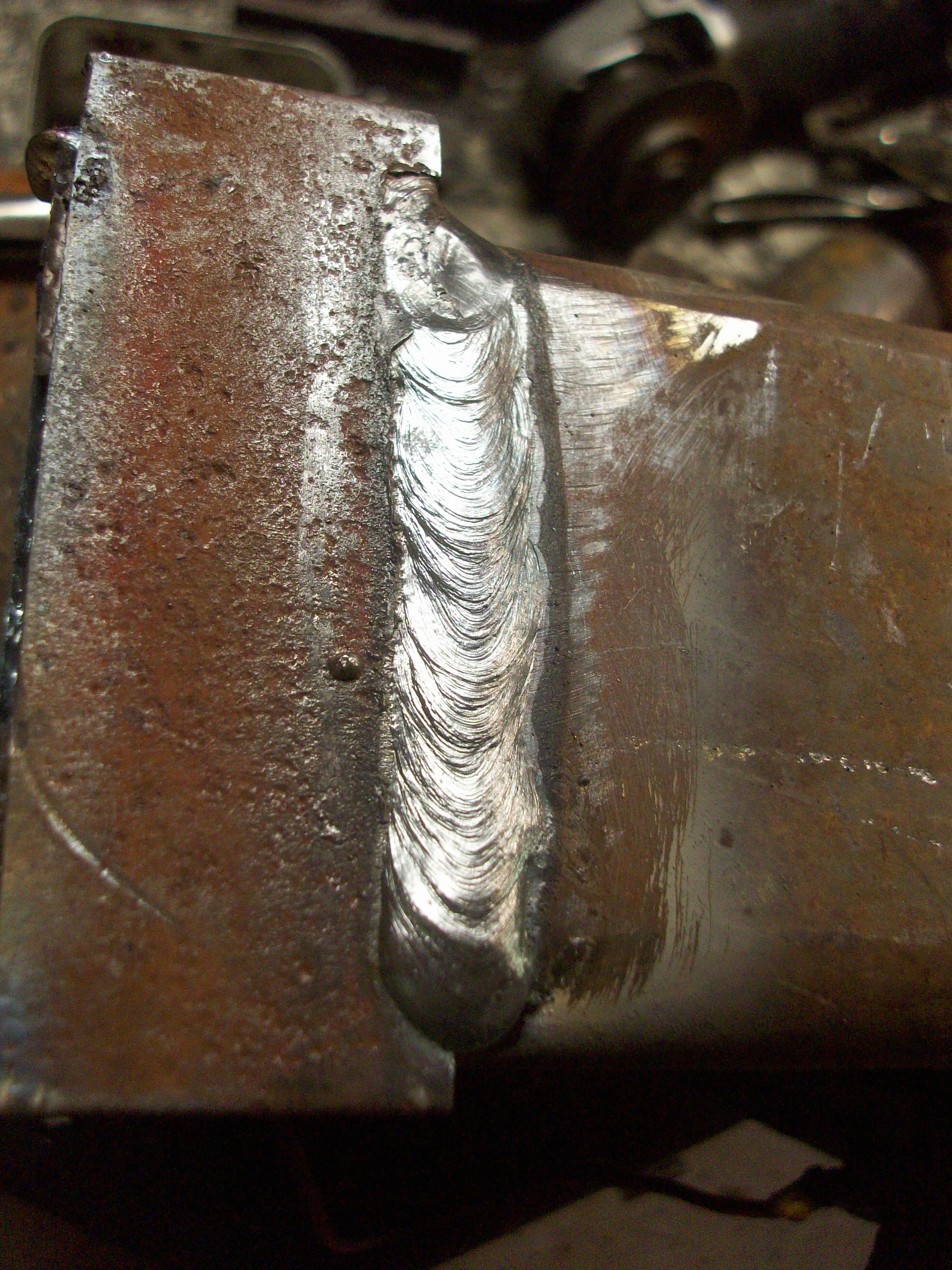

Sure looks like it will work for me, just wondering why your running 7018 on that rusty junk rather than 6010. That's what I use most of the time in the field, my old Maxstars wouldn't run 6010 worth a chit.
I only ran it on "that rusty junk" to show what the weld I did the day before looked like. I ground the shackle parts I welded, but didn't take a picture as I never do. I will make sure to do proper prep next time. Also, I used 7018 as I was welding upside down and that is what I feel most comfortable using. I would use 60xx if welding rusty stuff.
