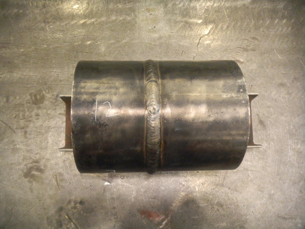

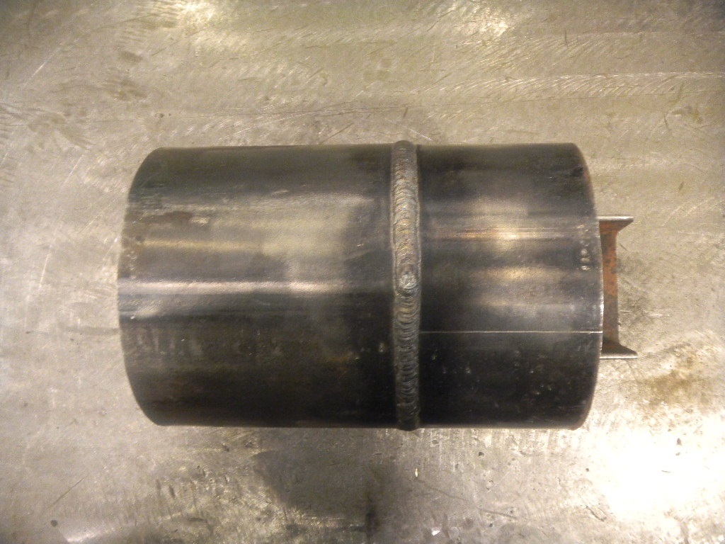

Far as stick welders. Hard to beat the price, and quality of the Everlast PowerArc 200ST. PM Mark from Everlast for a quote.
Here is what the PowerArc 200ST can do with 6010, and 7018.

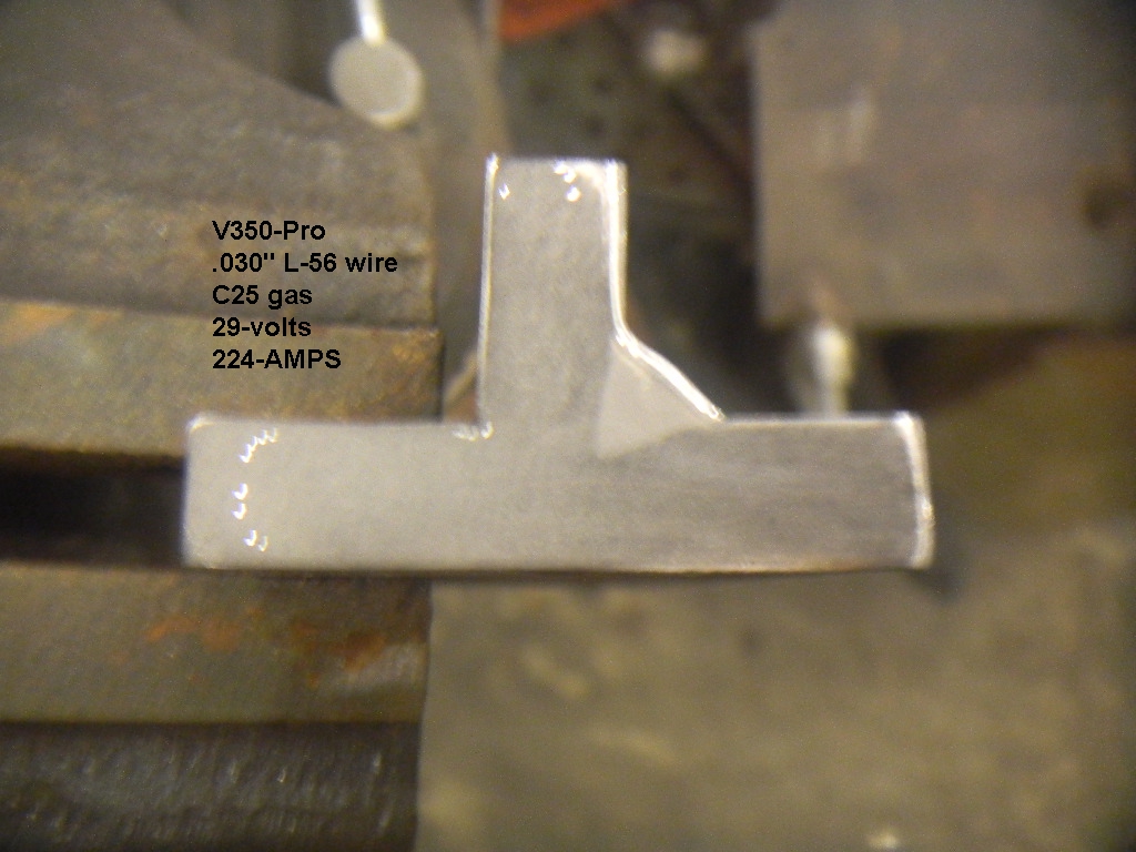

Far as self shielded flux core wire. Hobart's 21-B, and Lincoln's NR-212 work great. We did this seismic upgrade using NR-212.
