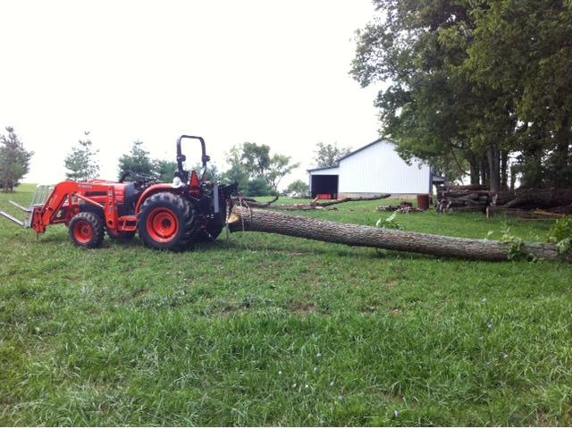

Here's my L3830 logging. For my uses... the industrials are best! :thumbsup:

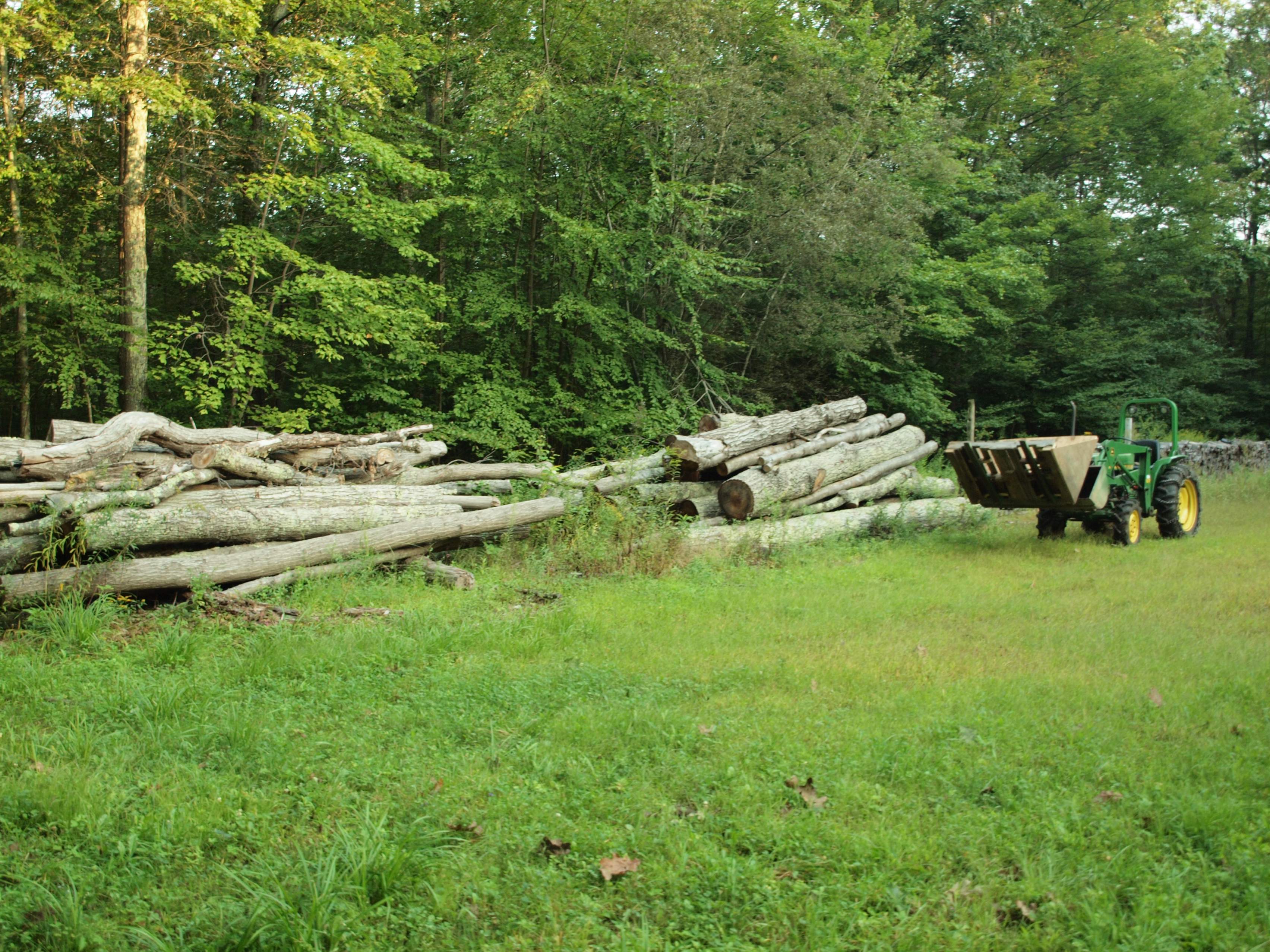

Thanks to all who have responded so far. Allow me to get a bit more detailed knowing I am narrowing the "field of experience" and may get less answers. I have included a picture of my terrain. I know how ags react as that is what I have now. Ags could negotiate this forest floor w/o chains but chained up made them more efficient and more effective in deeper snow. This is a rock strewn, leaf covered and debris laden environment. Is anyone with loaded industrials negotiating the same type of footing or have you found them hopeless without chains on when traveling on this type of surface?
/ Logging with industrials #24
Rock strewn, dips and holes and lightly snow covered I have navigated with my R4's unloaded but with 3900 lbs. The biggest issue I had was the log getting caught on some rock or making a turn and crabbing against another tree the R4's w/o chains would slip but I think R1 would too,
I dont have chains and probably will not get any because I dont run in the winter much anymore - just the fall.
You know what R1's do, and as RD Mcgregor said get R1's with a stiffer ply 6-8 ply.
You have to weigh it out - how much time is in the snow covered, then deep snow and if less than 10% of the time then R4's are fine.
Also, your JD chains - will they fit the Mahindra w/R1 or R4? You are going from a 20HP 750 to a 30HP 3016 if I recall correctly - i didnt check the tire sizes but thats one more thing to consider.
Thanks Carl
I value your input as you have experienced similar terrain. I just got back from the Mahindra dealer and looked at these tires side by side. There is no doubt in my mind that the R1's are traction masters over the R4's. I know I can skid with those in a foot of snow. I am very unsure that R4's can do that even with chains as I have no experience with the beasties. Where the R4's will shine is when I stop skidding wood which I estimate to be in about 5 years. You bring up a good point. The chains, if I get some extenders, will fit the Mahindra with ags. I would have to buy new chains for the industrials which are around $225 for 4 link which isn't too bad in my mind and thus not a stopping point. The Mahindra with loaded industrials will also be around 4000#'s. With ags, it will come in around 300 less pounds. Nothing else fits. My tooth bar, my debris tines will all have to be modified. I'm looking at both tractors not knowing which tires to choose. As I am going over all the pluses and minuses of not only the tires but the entire thought of getting a new tractor, my mind scrambles and goes into a recycling mode just like it did when I was a youngster in school confronting yet another learning situation. I need to step back because right now I don't even want a new tractor if it is causing this kind of consternation.

I log with R4s way up in Canada in deep snow and no chains, only liquid ballast but my tractor is quite a bit bigger than the one you are looking at. Ground clearance may be an issue with R4 on those smaller units in the wood IMO.
Maybe you should consider a larger unit.... Mahindra, seriously?
