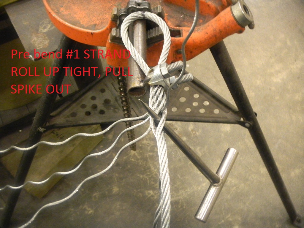

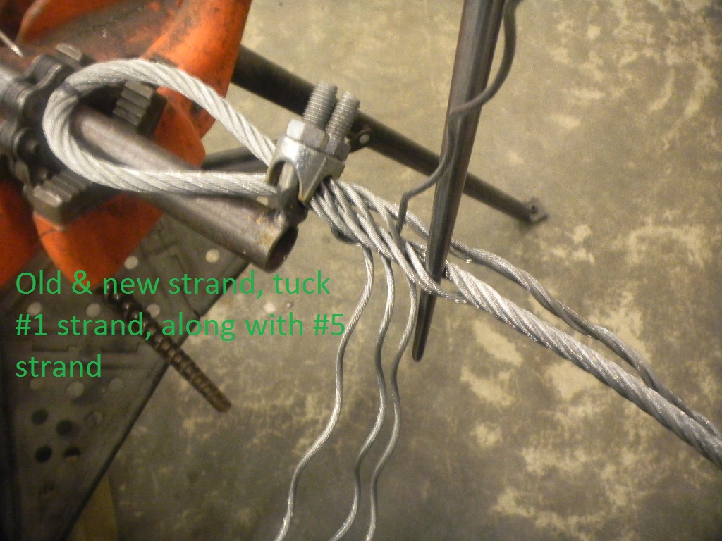

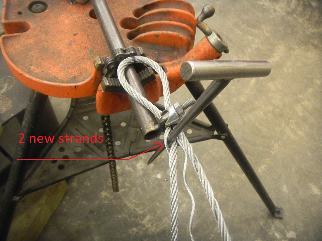

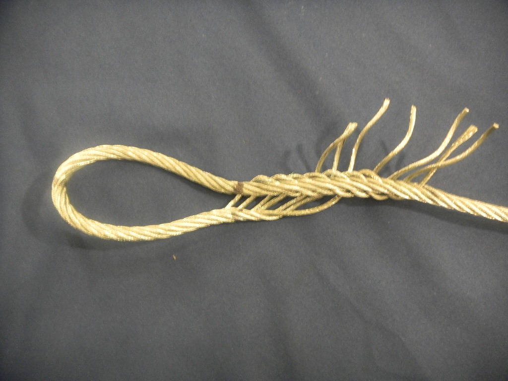

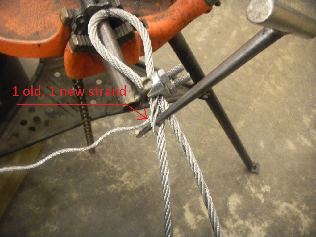

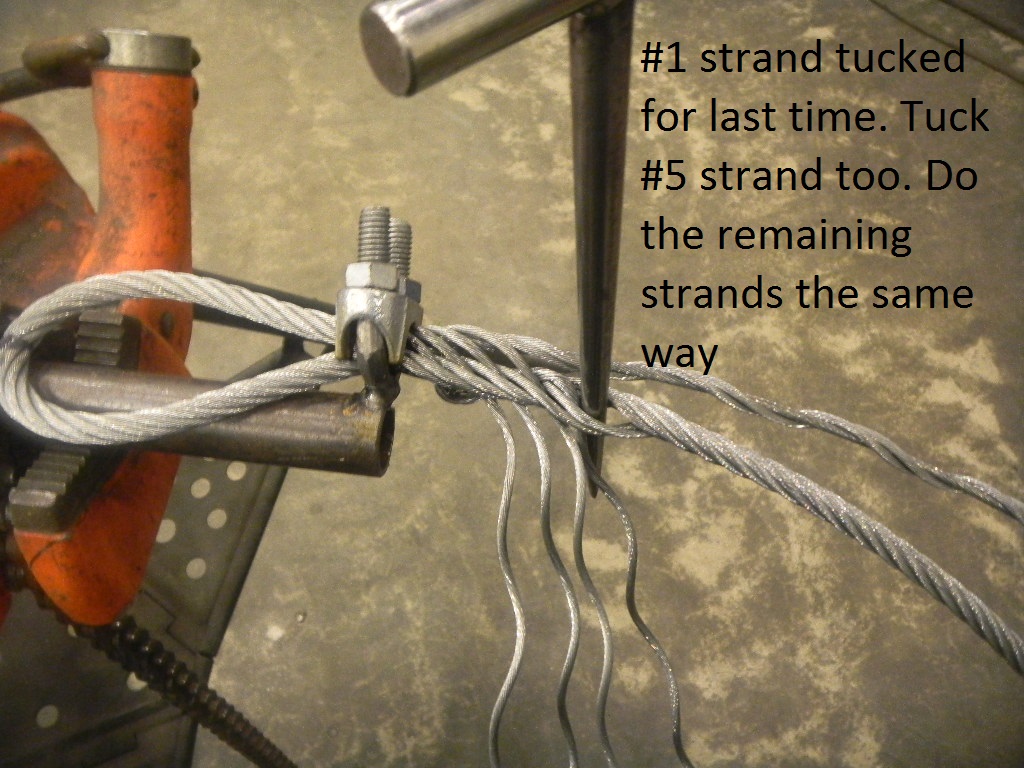

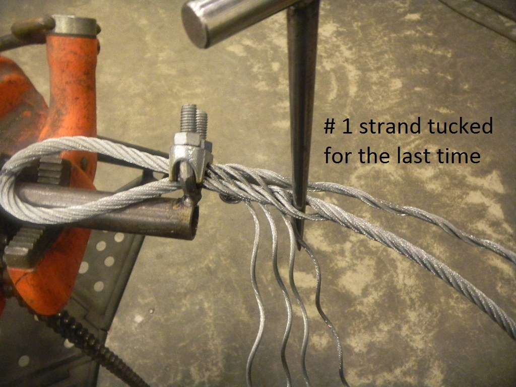

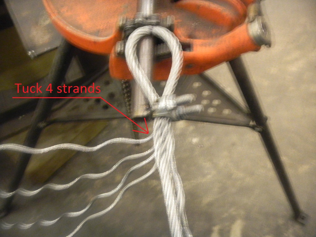

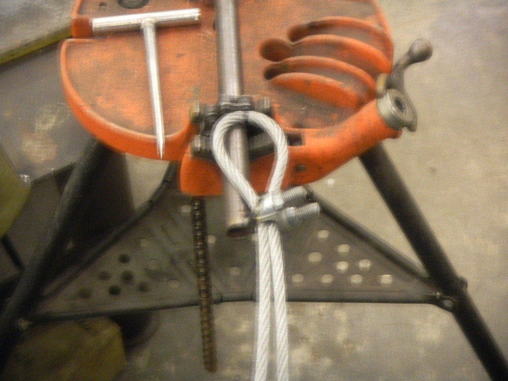

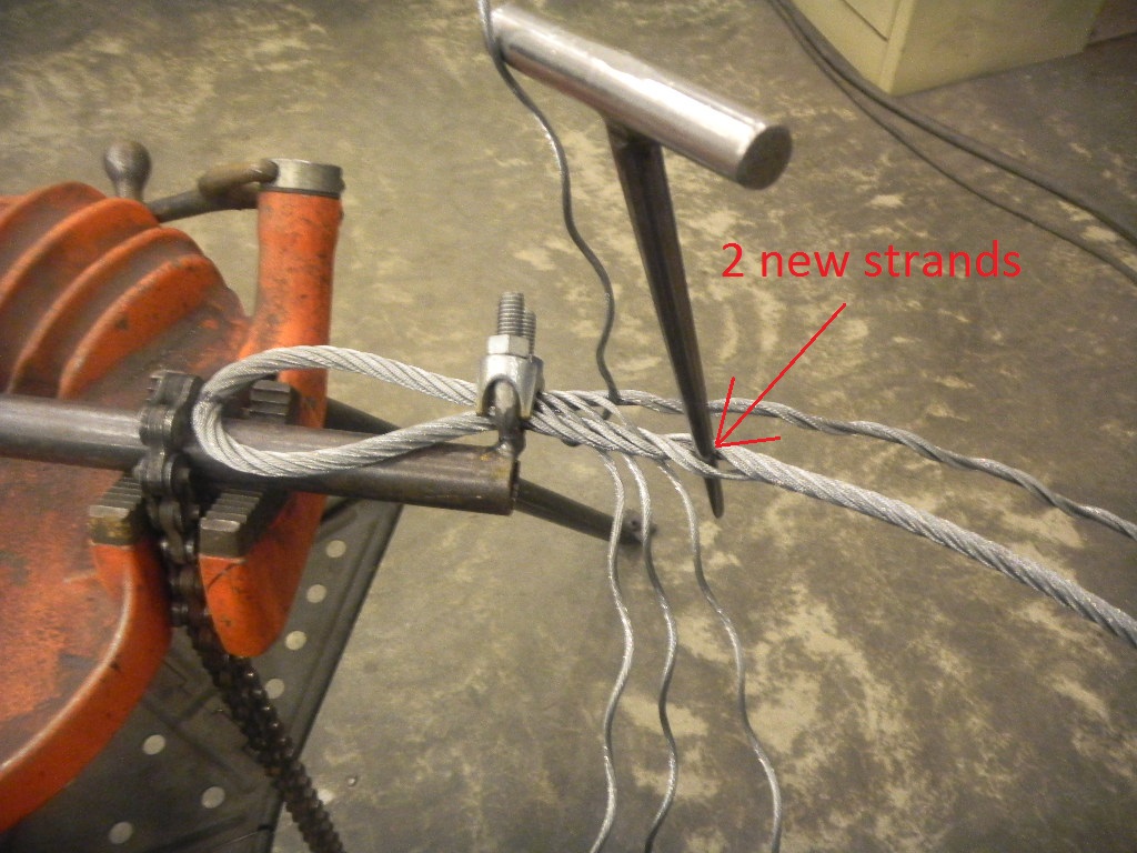

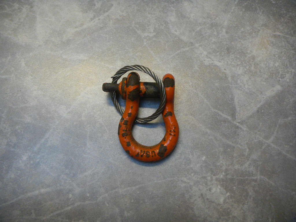

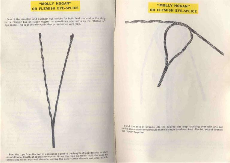

Anyone here know how to make these?

But Jim, not everyone has a press. A marlin spike is a lot cheaper. ;)

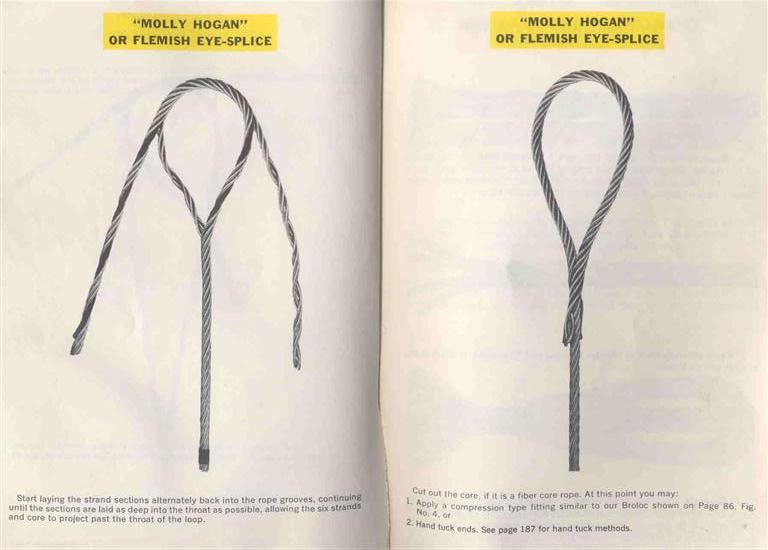

We always called these a Molly.

My father taught me how to do it with nylon rope with and without the metal insert. Being big into sailing that was one of the skills he taught himself at a young age. I've done the method Shield Arc posted but I used a swaging sleeve like in the second post/ video. I only have a 20 ton press so the swage is really just for keeping the ends of the wire from poking out. I just take a thick piece of steel drill a hole through it slightly smaller than the swage (usually do a couple of different size holes if I'm not sure) and then cut the metal in half to make a set of dies to crimp it. If the wire is small enough, like when I had to make my own custom length cables for the garage door, then I'll trust the press to have enough force to crimp it but for something like 1/2" cable I'd rather do too much and know it's not coming apart.

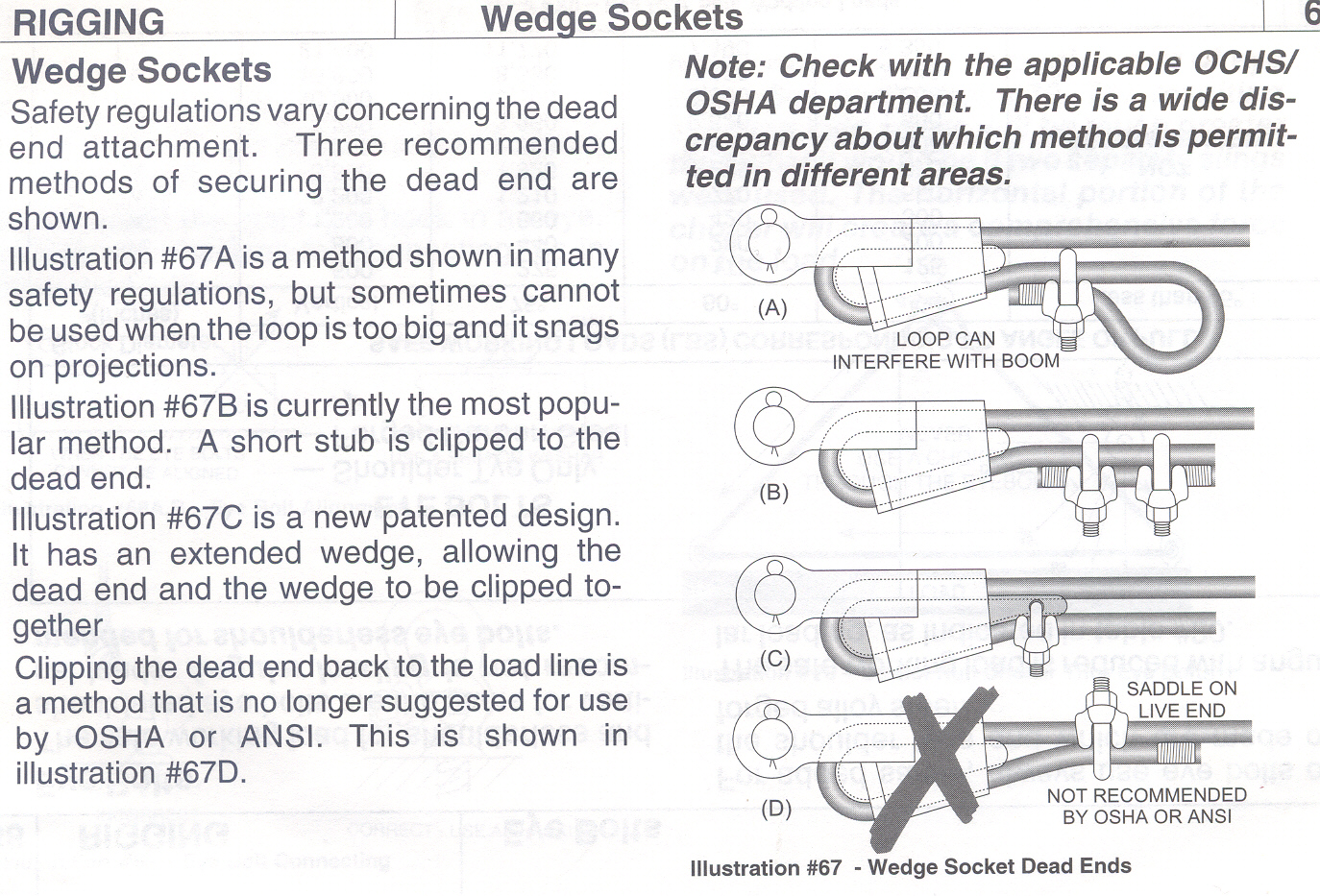

Jim I think it was in the 1980s when OSHA put a stop to installing clamps on the wire rope used for cranes. Their thought process was the clamps break wires in the wire rope. I've seen this happen with Farmer's eyes. Believe it or not. Roll a Farmer's eye with an extra long tail, and use electrical tape, instead of cable clamps.

Those cable eye's in that second post video are nice, if I had that press, I'd probably do the same thing, and if I had enough patience and know how, I'd make them like Shield Arc's way, but in my world I do what I can do and what works. My Fransgard pto winch has 8 mm cable, and from ware and tare, the cable brake's, so I use two 3/8 cable clamps, clamp the cable in the vise, cut it with a welder, the best way IMO to cut cable with no frayed wire ends, while hot round over with hammer, make the eye and put two camps on tight, those clamps are big enough to keep the end from pulliong through the cable slide while winching.

I allway's forget what part is the "saddle", so these give me no problems. An old fashioned "wedge socket":D

I remember watching cable splicing competitions at the Deming logging show back around the late 60's, they were using lengths of used yarder mainline, two inches or more in diameter, the stuff was pretty much like what they dealt with every day on the job. They had to trim then splice or put an eye in it. They would cut the cable with a sledge and axe, the strand weaving was all by hand using a marlin spike and hammer. Those guys could complete the splice in about a minute or less. It was impressive to say the least.
