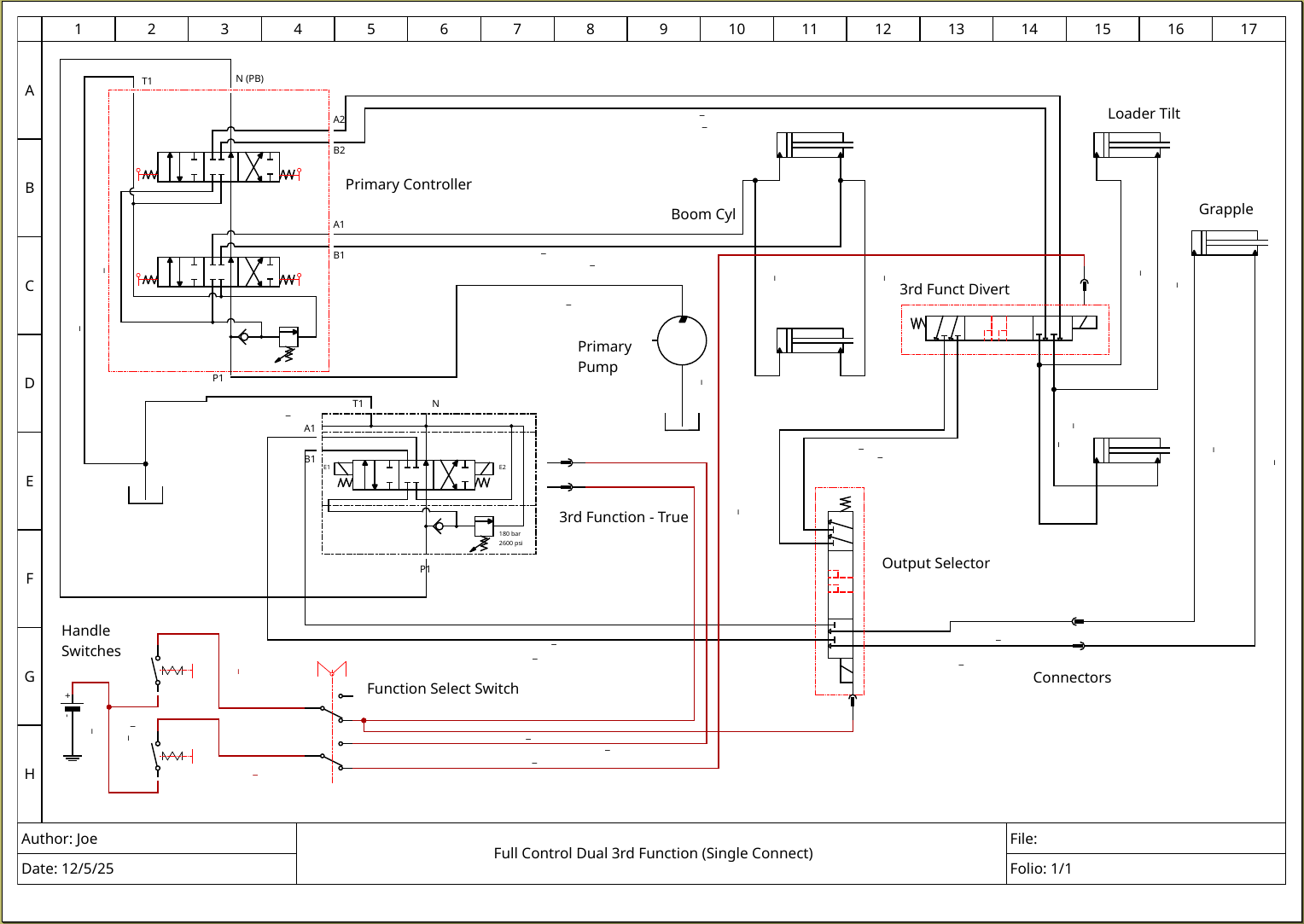

So as some of you know, I recently bought a new Kioti CK2620H. I need a 3rd function for some attachments and didn't get one installed by the dealer. In researching I wasn't sure if I wanted to go with a "true" 3rd function or a diverter type. Both seemed to have pros & cons, so I decided I'd like to make a dual system 3rd function. Basically I'm going to put both a electronic power beyond valve that will work with both joystick buttons, and a diverter valve that works with just one, then a selector switch to see enable one or the other. So far I've just done the design in a schematic and bought the major components. I still need to figure out the actual wiring, mounting and line routing.
Anyone have thoughts or additional suggestions?

You can stack those diverter valves to has many as you need. 3rd, 4th, 5th function, etc. Then just use the buttons from the joystick. Mount the block of valves on the cross member of the loader and you would only need a couple of hoses and a couple of fittings to connect it to the curl circuit.
Personally, I would rather retain the ability of feathering the controls that the diverter allows you to do. It would also make for a clean and simpler install.
I believe there is this slight misconception that a "true" 3rd function allows the operator to use all functions at the same time but in reality it's not quite like that.

What's the reasoning for 2 different types of 3rd function valves? If you need 2 functions I could see it. I've had both types and would only have the live 3rd function.

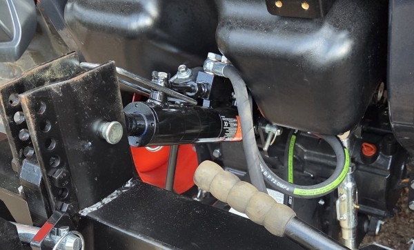

I had dual rear remotes installed by the dealer. I bought the Vevor hydraulic top link and it seems to work great, but I haven't actually had anything on the hitch yet.
Currently, I'm just starting to plan out the physical layout and where all the components and lines are going to route. Been busy getting my old Kubota ready for sale.
/ Dual 3rd Function #7

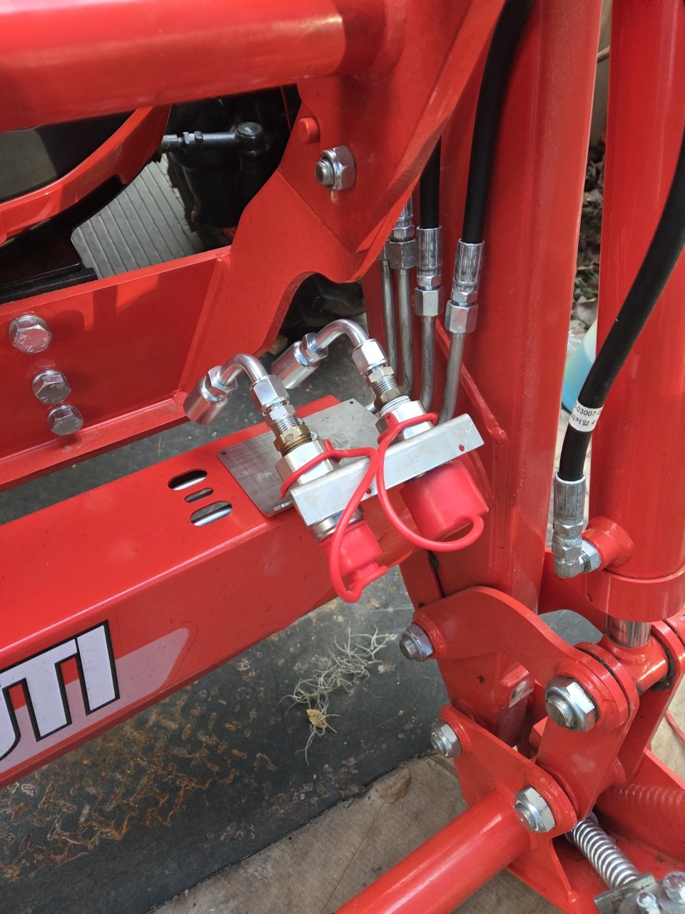

It looks like your about to break off those banjo fittings or pop a hole in that tank. I would not rely on those banjo fittings not turning with out some type of support.
/ Dual 3rd Function
Good call, I ended up turning it over so the hoses were on the bottom. I should also mention that I had to grind the top link ball end narrower to fit into the kioti's link bracket.

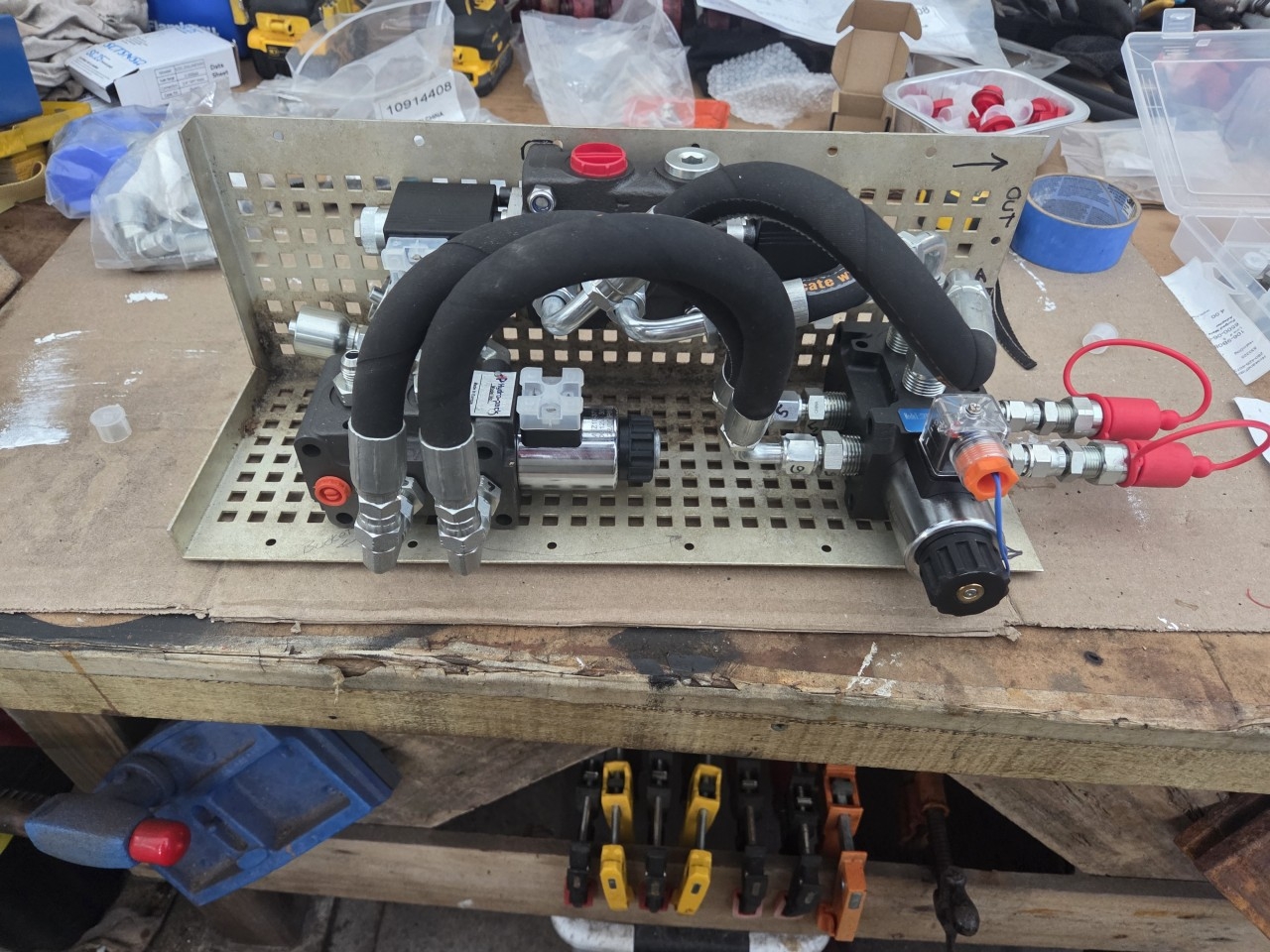

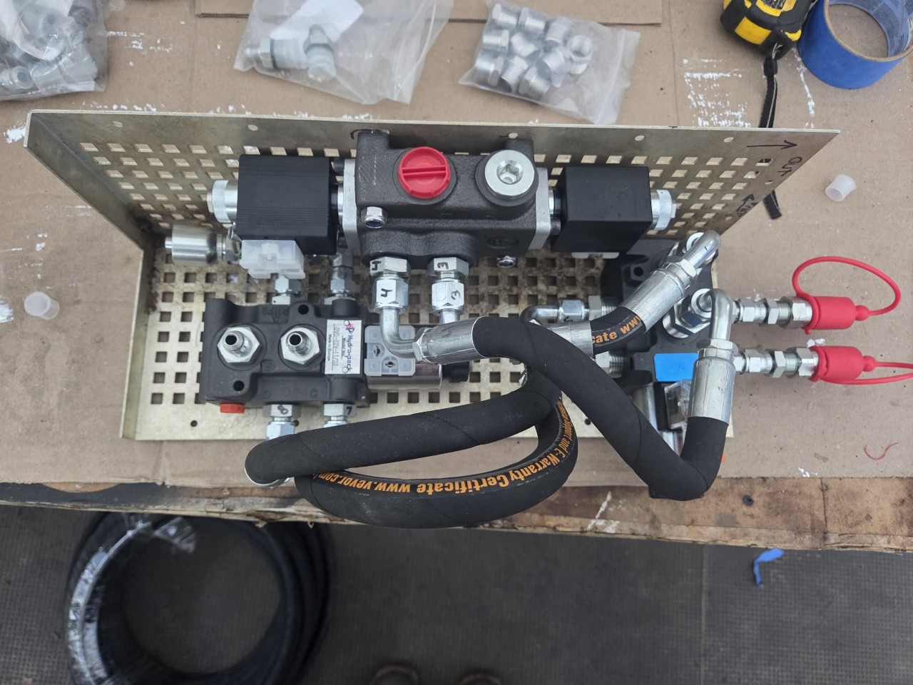

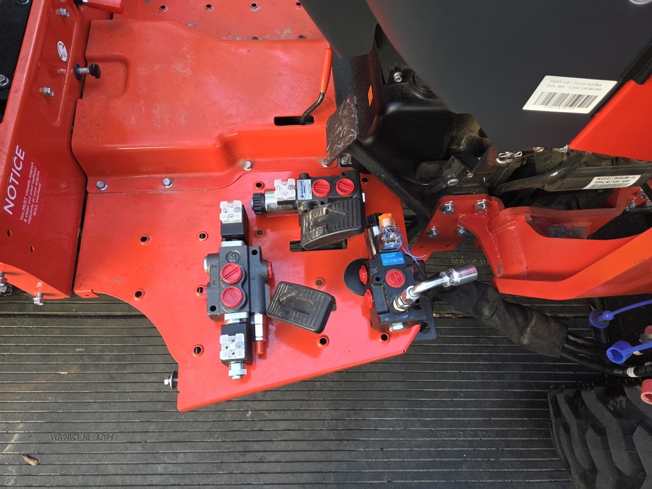

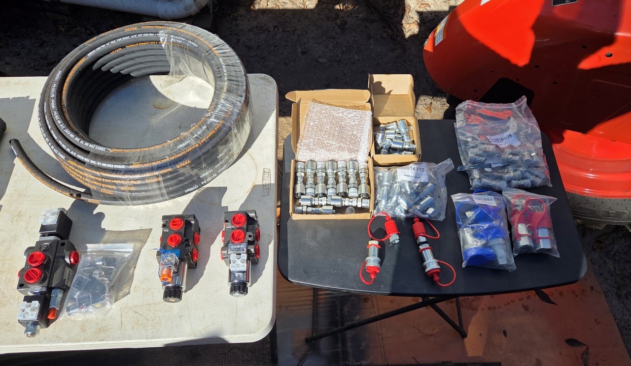

So I've been making some slow progress on the build of my "Dual" system. I am realizing this was probably an "over kill" project, but it was always a more of a "could I" than a "should I". Thought I'd upload a few picts.

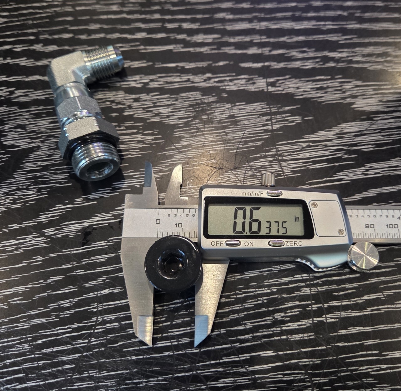

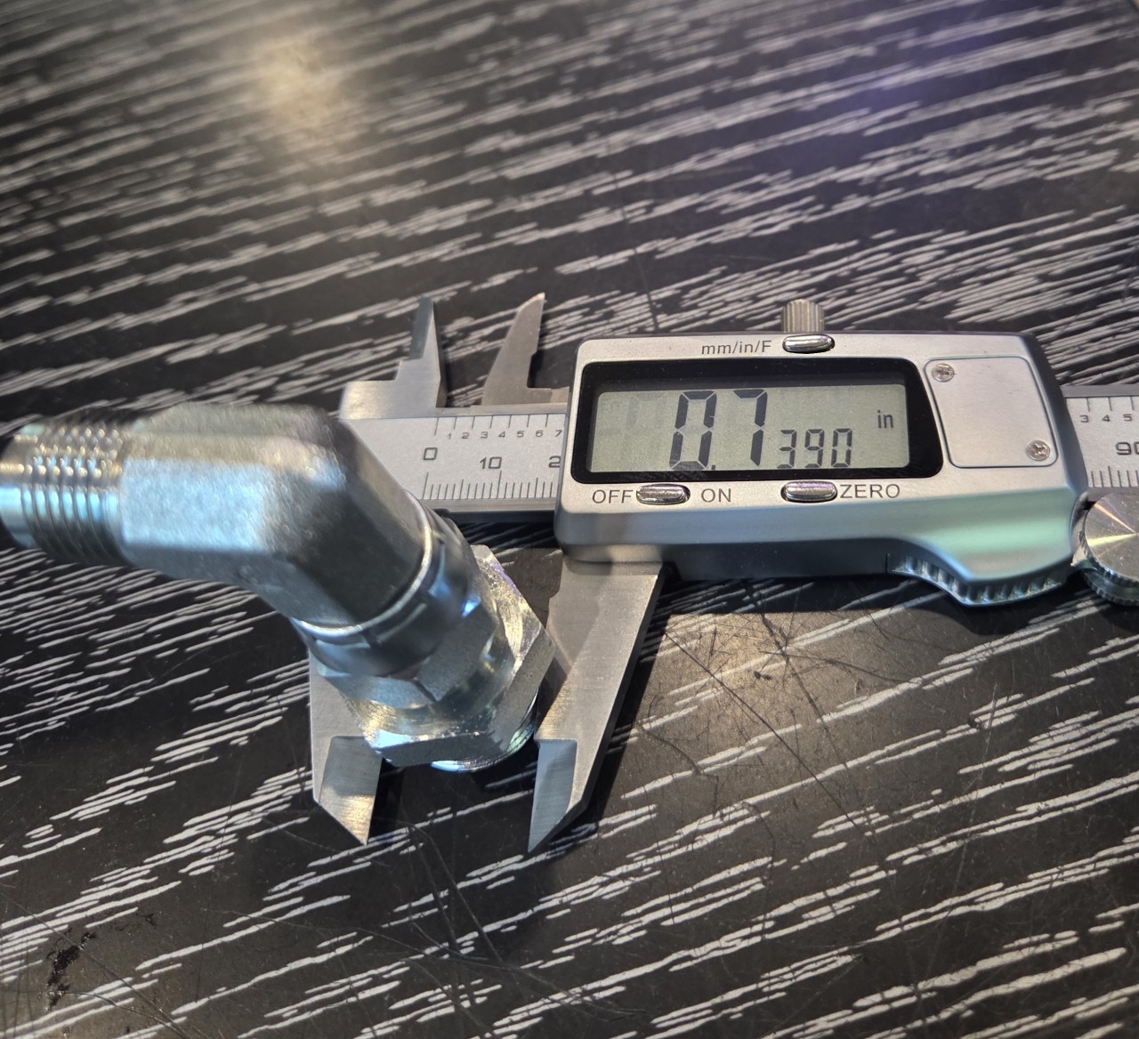

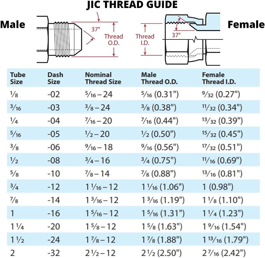

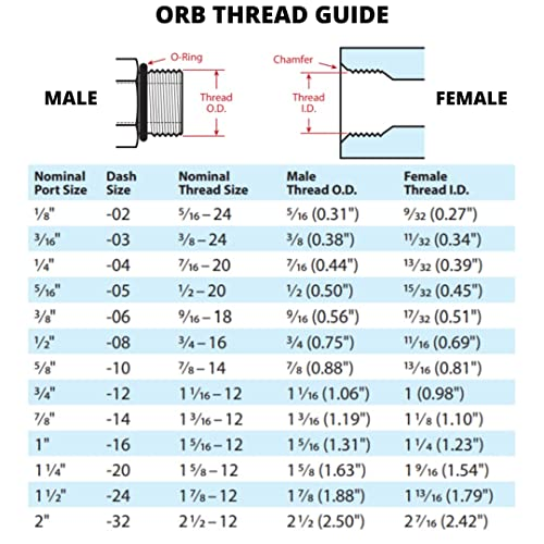

Frankly, the biggest issue I'm having is figuring out all the fittings. JIC, ORB, NPT = PTSD🤪.Then there's fittings labeled sometimes in fractional sizes 1/4, 3/8, etc, and sometimes in "dash" sizes -04, -06, etc. That one I did figure out, dash size are just fractional expressed as the numerator of the fraction in 16ths (not confusing at all🙃).
I'm primarily using 3/8 hose and 3/8 JIC. The components break down as:
  • Controller (for independent 3rd funct) uses 1/2 SAE ORB (-8) for the pump and tank ports, and 3/8 ORB (-6) for the A/B ports.
  • Diverted 3rd func has 3/8 ORB
  • Output selector (just another diverter) uses 3/8 NPT
The existing loader lines are JIC, 5/16 I think, or maybe 1/4. the hoses are 1/4. The loader control valve and rear remote control valve seam to be ORB, but smaller than 3/8.
This is where things get confusing to me because it seems what the fitting dimension charts say and what I'm measuring don't match. If you look at the chart in the image, it says that a 3/8 ORB fitting should have a 9/16-18 thread, with the male OD as 9/16 (.56). But when I measure a fitting I have that is a 3/8 JIC to 3/8 ORB, the outer thread measures .739. See image.
A plug from a port on the loader control valve measures .638, which is between 5/8 & 11/16. Threads seem to be 20 per inch, which would indicate a 5/16 or 1/4 ORB.
I think the JIC chart matches up okay, the existing loader hoses mate to a 5/16 JIC which does measure .494 ~ 1/2. And the 3/8 fittings I have are .55 ~ 9/16. That aligns with the chart.
Any fitting experts out there want to help clear this up?
<snip>
<snip>
Wow, you have quite the mess there.
The first fitting is obviously not correct; it should be 9/16-18 on both sides, the JIC side with a cone and the ORB side with a flat end and a flange with O-ring. Not sure what you have there.
The plug might be 3/8-19 BSPP.
Try using this chart to help identify: Fitting Thread Chart | Hydraulics Direct
Good luck with the fittings and the project.

You can stack those diverter valves together with just two o-rings to seal both ports between both diverter valves.
This would simplify the system a lot, with less hoses, fittings and space used.
Thanks, you are correct, I was just confused. The fitting I have is a JIC 6 - ORB 8 (not 6).
Good call on the plug, after I checked the BSPP specs, that's what it is. I was wondering why none of my thread checkers didn't quite line up, I didn't realize anything used a 19 thread.
Just too many types, undoubtedly a conspiracy to sell adapters:cautious:
