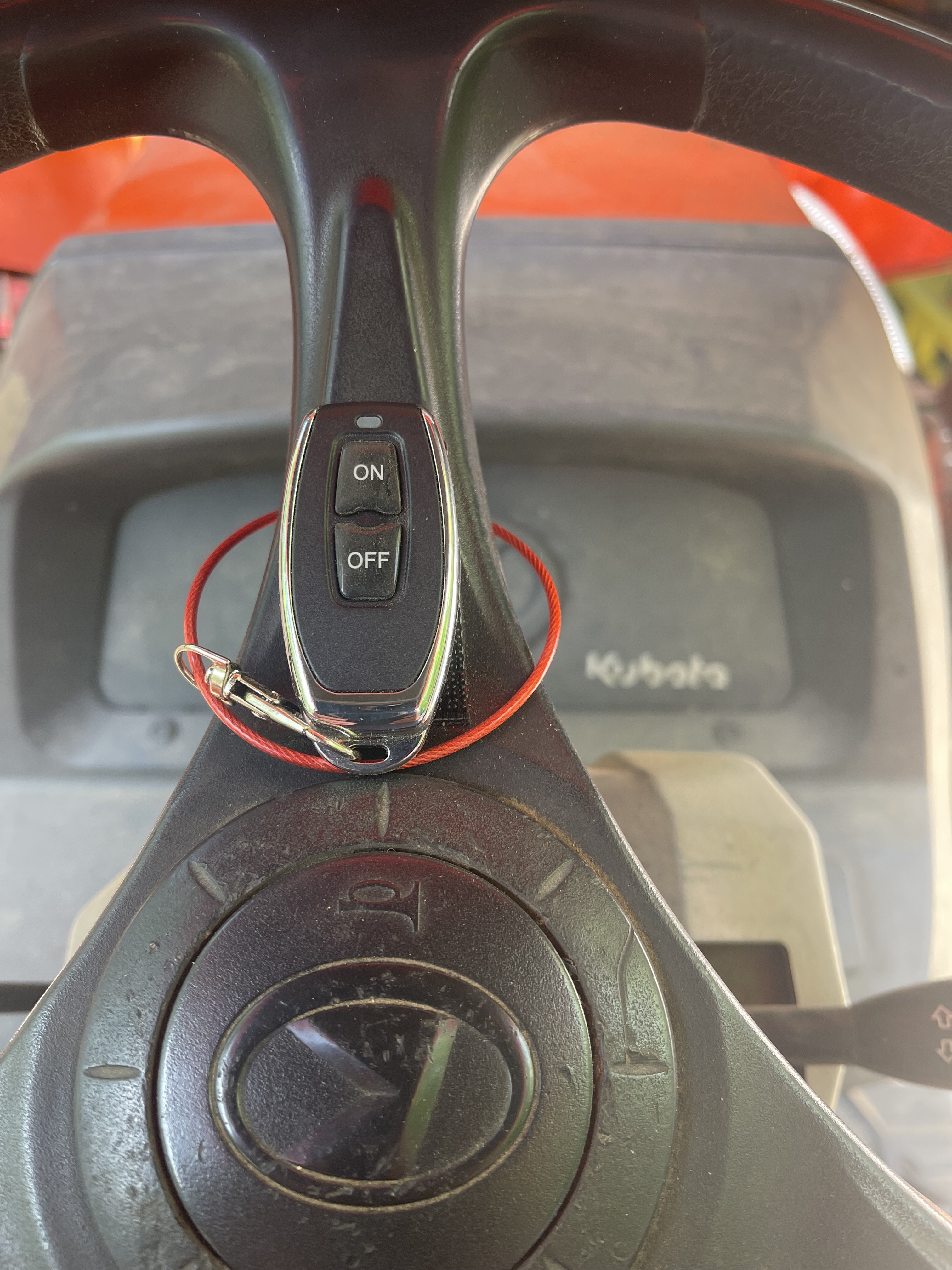

What's your total cost with wiring relays connector etc. end up being?
I didn't build that. Its someone else's video, but its something that I'd like to do to my machine. If you had to buy everything new, I'd say the total cost is well under $200. Probably under $100, especially if you use the $40 amazon actuator (current price is closer to $45 IIRC).
