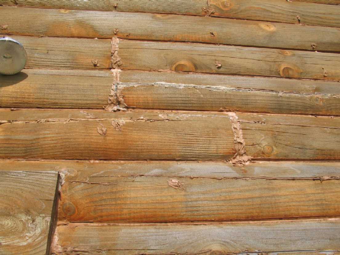

I visited again today and got some more pictures. This first one is a look at the outside logs and the somewhat amateur chinking / calking job.

/ Log Home Owners? #27
That's not chink it's caulk. Chink is a latex based motar that is designed to expand and contract as the logs will do naturally. Caulk on the other hand is not really designed for this application. This may be partly the reason why your seeing water damage. This caulk will not expand as far as the chink will and the result will be voids between the logs which will let water and other things can get in. Having said that, and as bad as some of these pictures look, I think you can still work with this provided that the damage (ie.. rot, pests) is not inside the walls. A lot of work to correct, but maybe worth it. Proceed with caution. Hope this helps.
/ Log Home Owners? #28
I agree with RTVman, he obviously knows his RTV when he sees it. /forums/images/graemlins/grin.gif /forums/images/graemlins/grin.gif This is terribly amateur work, and would need to be removed and re-done right but if the logs are intact, its just some painstaking work. My wife and I filled all the cracks on our exterior surface, I think it took us 2 or 3 weekend and was a pain /forums/images/graemlins/mad.gif. I wish I had a picture handy of my house going up. I stopped at the start of the peak on one side while I did other work and the other peak. I then put that peak up 3 weeks later in one day, I have a picture somewhere. Night and day difference what 3 weeks of sun and rain will do to un-protected pine. Even worse to imagine what 5+ years of neglect can look like at this place, but again if the wood is not damaged down deep, you can recover from this. If you end up going with it, it is important to remove the surface decay either with mechanical means and or bleaching/scrubbing and I would recommend a borate wash after that and think about mixing an insecticide into your outside finish to insure you don't have insect troubles. You may want to find a place that would corn cob it and re-finish it, get their rough estimate and factor that inot any offer you would make, assuming you can ascertain that the basic wood is still OK.

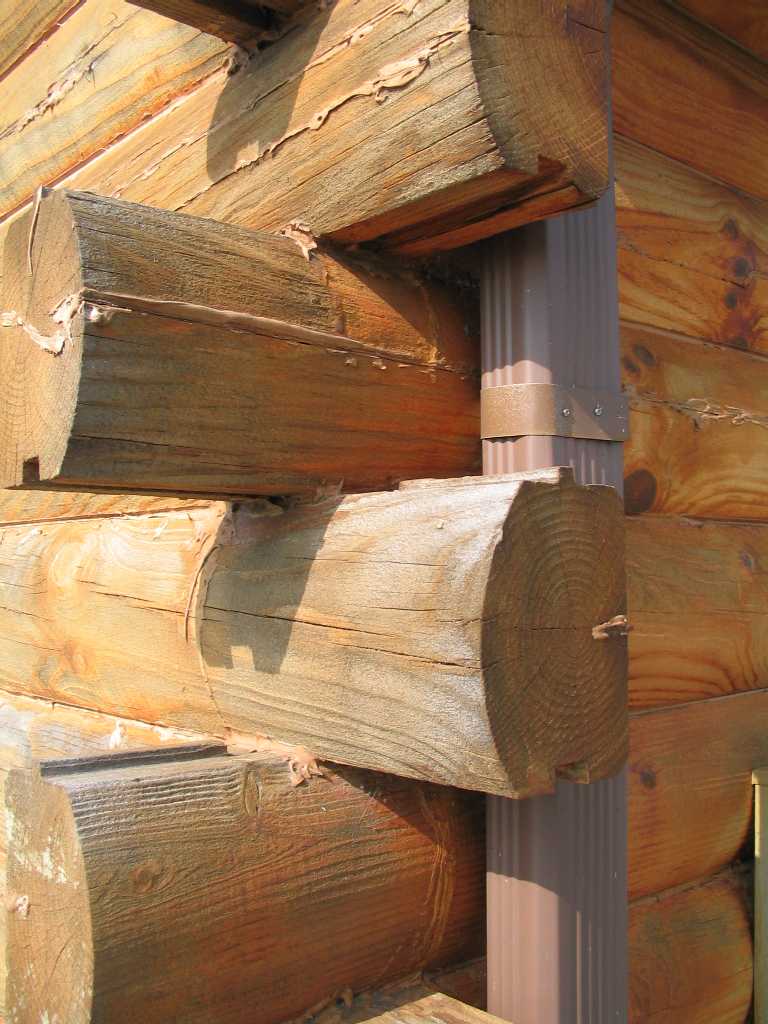

More logs and caulk and (lack of) chinking.
/ Log Home Owners? #33
From the corner construction view, you can see the milled spline and dado (for the spline) on each 'log', that will get the argument that chinking isn't necessary. This doesn't explain the passage of water through the logs and down the inside walls. By rights, the spline should have stopped the infiltration of water. It didn't, and I suspect decay is present.
The species of logs used might be helpful (likely lodgepole pine from Western Montana, or thereabouts).
Someone did make a mess trying to caulk the logs, but I suspect that they didn't really know the source of the water and made the mistake many log home owners make. Better to not entrap the water in the log.
Good luck with your plans for the house.

/ Log Home Owners? #35
I'll be anxious to hear what the dealer has to say. The corner detail photo was the one was looking for. Other than large up-facing cracks and possibly poor fitting butt joints, there shouldn't be any chinking and or caulk on the logs. The tongue and groove design wasn't meant for any to be put in. It likely is trapping water from poor application and causing the exact problem it was intending to keep out. All that caulk should go, there is a high quality product for application to the cracks called Log Builder, I'm sure other vendors may have a similar product, but I used and liked that one, but it isn't intended to be used on the horizontal seams if you have the log profile shown in your picture, I'd bet that started all the issues, largest question is how much damage has been done. Let us know what the local dealer said.
