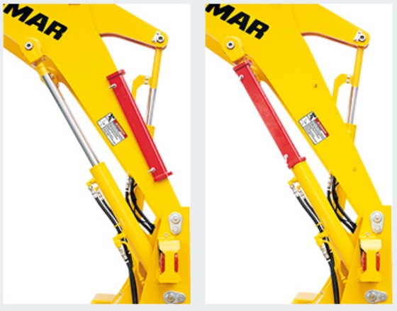

Cut a narrow side off a section of rectangular tubing. Drill a pin hole or two so it can't be bumped off.
Bruce
/ Loader Parked Above Other Equipment
Bruce
I have some lengths of 4" and 3" well pipe lying around. I was thinking the same thing, maybe cut a slot in it wide enough to fit over cylinder pistons.
Could these solutions with the angle iron or tubing/pipe possibly damage the cylinder seals if they press on them unevenly? The rectangular tube you show in the picture looks nice because it seems to have a flange at each end.
/ Loader Parked Above Other Equipment #11
You don't want it to press on the seal. Only on the gland nut that's why there is a flat plate welded on the tube...

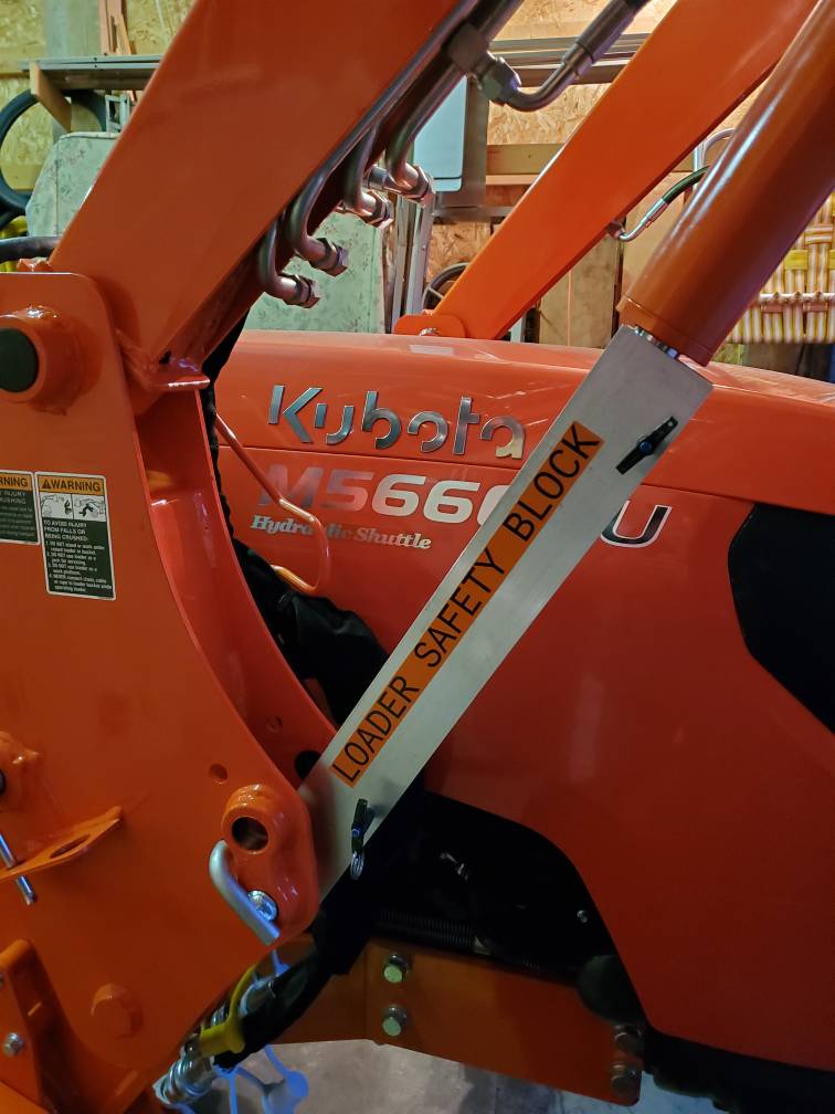

Here is my version made out of some salvaged aluminum 2x4's.
Raise loader, apply safety block, turn off engine, slowly lower the loader boom.
I had already bought a pair of shaft collars like my friend BravoXray above when I found the aluminum and then I changed directions.
I used a 2" hole saw in the Bridgeport mill to make the semicircular cutouts to fit around the rod end trunnion and cut the opening lengthwise on the table saw...yes, you can cut aluminum on a table saw with a triple chip grind tooth pattern blade.
