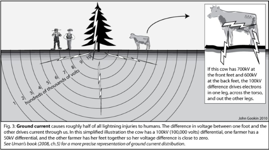

Cows and horses are more susceptible to electrocution when in proximity to lightning strikes than a person is because of the greater distance between their legs.
In fact, a person should stand with their legs close together if lightning is around.
It's called "step potential".
When lightning hits, the voltage of the earth around "ground zero" is also raised up hundred, if not thousands of volts, with the voltage diminishing the farther away one is from ground zero. So a person with their legs together is sort of like a "bird on the wire" and won't be harmed, whereas the voltage of the ground at the cows front legs may be very different from the ground under its rear legs. The ground is a bad conductor so the current would rather flow through the cow than the ground.
Hmmm, never heard the four legged thing before.
