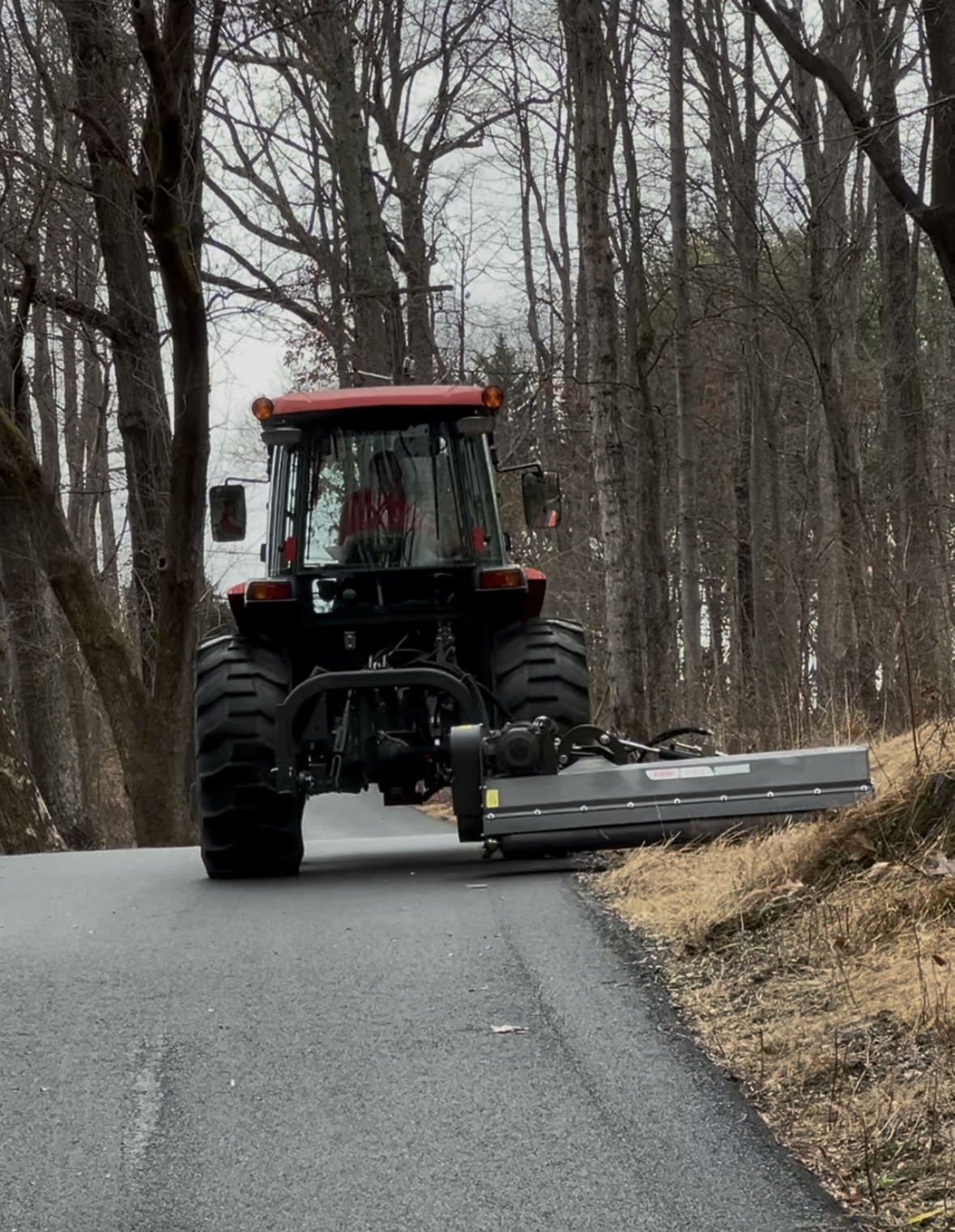

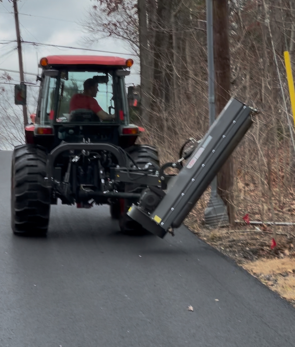

/ Let's talk flail mowers #8,112
I recently purchased a Ironcraft FRF-165 (165 cm / 65”).
I’m running the mower behind a Kubota L5740 with filled rear tires and max wheel weights and FEL. Our tractors should be along the same weight.
I think it handles the mower well, and is pretty stable. (Albeit I haven’t run it on any extreme slopes).
For next size up in the 78” class, the weight of the mower basically doubles. Given the weight increase and having more offset I think the 78” would definitely be too much for my tractor.
I wanted to avoid the China built units, because I like to avoid China when I can, and I wanted to ensure parts availability down the road. The Ironcrafts are made in Italy by Cosmo, but the price is much more economical than a the high-end Italian Del Morino mowers. So far I am happy with my decision. Might be worth considering if you have a dealer near you.

We bought a place in VT with 28 acres of mixed pastureland and woods. Now that I'm here full time, I plan to reclaim some of the old orchard land and clean up the logging trails running through the woods. I also have a pond that would benefit from a ditch/bank mower to clean up the banks. Weed whacking it by hand truly sucks.
From all the advice and experience I've read here, It's clear a ditch/bank mower is the ticket. I can keep fence rows and trails clear with a vertical pass and be able to use the offset to catch the pond and stream banks.
I have a Mahindra 2665 that is 65HP, 50 at the PTO, with a cat II TPH. With the front loader and filled tires, it is somewhere north of 7500lbs.
I've been gumming by with a 6 ft RC, but it is difficult with all the trees interfering with the cab along the edges. It also sucks trying to reclaim areas that have been taken over by brush and saplings.
So, I'm convinced a ditch/bank mower with hammers is the solution. I can swap out for Y blades once things get groomed up a bit.
I'm leery of going smaller than 70" as it takes a lot of time as it is mowing everything (including the Neighbor's 7 Acres) but also concerned about the weight of the larger mowers.
Does anyone have any real world experience with 70-78" mowers on a tractor my size? (@LouNY , you're a bit bigger than mine). I'm worried about stability when offset with the heavier 1500-1800 lb units.
Any specific brands to avoid?
Also, I see some brands have float controller options. Could someone explain to my 5th grade brain how those function and if I need one?
Hoping to pull the trigger this month or next and get cracking this season.
The only two implement brands I would be willing to recommend to
you without blinking an eye are Del Morino and Maschio.
I would only want you to use a 60 inch flail shredder, no wider
Owning and operating a boom mounted vineyard crop shredder involves
operating an implement with no over center control valve to stabilize the
load on the three point hitch and the boom.
In simpler terms imagine holding a 20 foot long 2" by 12" flat at chest height
with your elbows resting on the plank with a 5 gallon pail of gear oil at the very
end and keeping it there.
The flail shredder mower is the object at the end of the lever.
You need to maintain stability to maintain the center of gravity/center line which is the
axle height of your mule, if you could use smaller tires and wheels all the better
as you would lower the center of gravity of your mule increasing your stability ON FLAT LAND.
Mowing pond edges is fine but a waste of time because it weakens the root structure of the
weeds holding the bank. If you want to mow more often have the pond banks cut to below
15 degrees in slope as the rise and run will be safer.
You should have wheel weights on the rear left wheel and if possible the front left wheel and
suitcase weights on the front of the tractor if the loader can be removed.

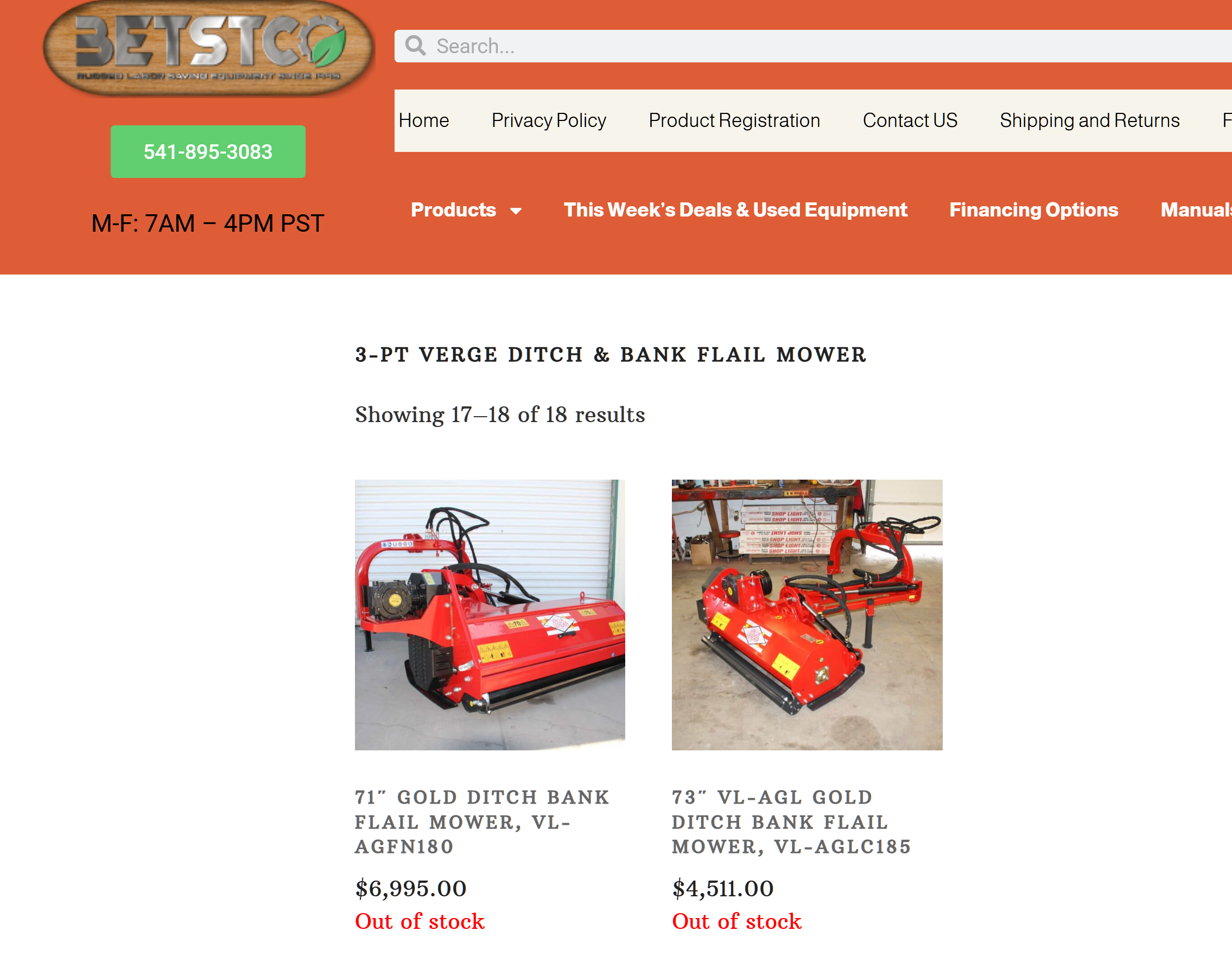

What are the opinions on Bestco? They have a 73" that is under 1000 lbs. (oddly, the 71" next to it is over 1500 lbs. ) where does all that weight go?
@leonz , I realize you recommended a smaller unit, but this one has similar weight to the ones your suggested.
/ Let's talk flail mowers #8,118
The added weight is:
the heavier three point hitch,
longer hydraulic cylinders,
heavier boom steel weldments,
wider flail mower rotor,
more knives or hammers,
more knife/hammer mounts
more mounting bolts and nuts,
wider rear roller,
wider flail mower shroud.
/ Let's talk flail mowers #8,119
The light one;
Blade Type: The VL-AGL series uses standard hammer blade. Each hammer blade weighs 14 oz made of cast steel (cast steel is much more durable than cast iron). Use the hammer blades for clearing saplings (2″ diameter or less) and for grasses.
Number of Blades: The VL-AGL C185 uses 32 hammer blades.
The heavy one;
AGFN takes our AGF mower and adds an openable rear deck for faster mowing when you do not need fine mulching (it is also nice for changing blades) a holder for your hoses when not attached and a floating right side 3-point connection to allow the mower greater flex when following the contours of the ground. AGFN verge flail muchers are super heavy duty mowers designed for Cat-II tractors. They feature very heavy 43 ounce cutting blades that can chop heavy brush including grasses, debris, sticks, vines, branches and other wooded materials up to 4” in Diameter.
Only 16 blades "hammers" but much heavier.
Also the lighter one is rated for up to 2 inch brush,
the heavier unit is rated for up to 4 inch.
