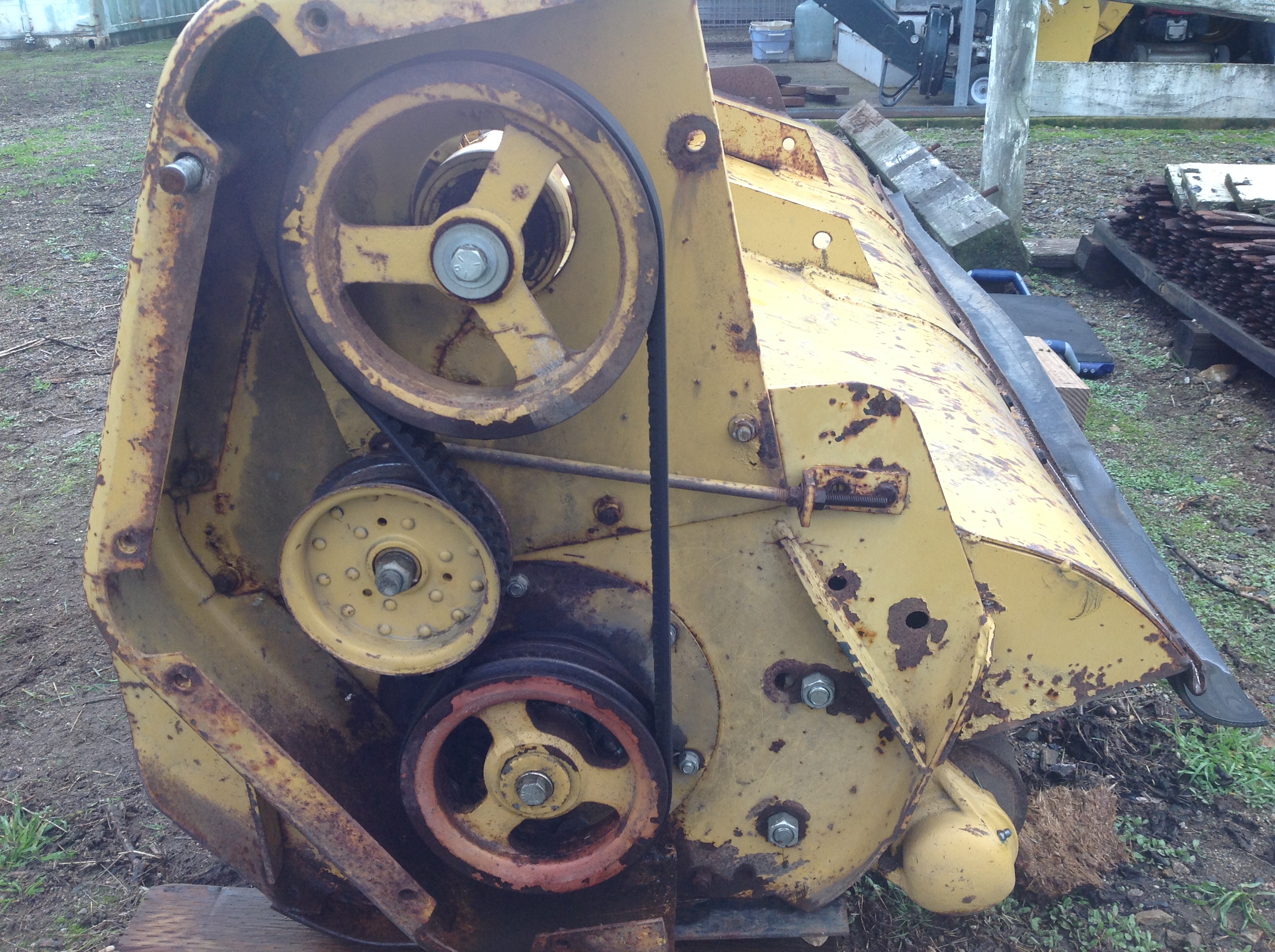

Couple of photos showing how I had to add shims on my mower, in order to get the two pulleys line up properly with each other.
I doubt it left the factory with misalignment like that - who knows what the previous owner did with it during the 20 - 30 years he had it?
It was an easy fix.
